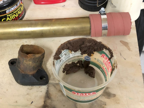

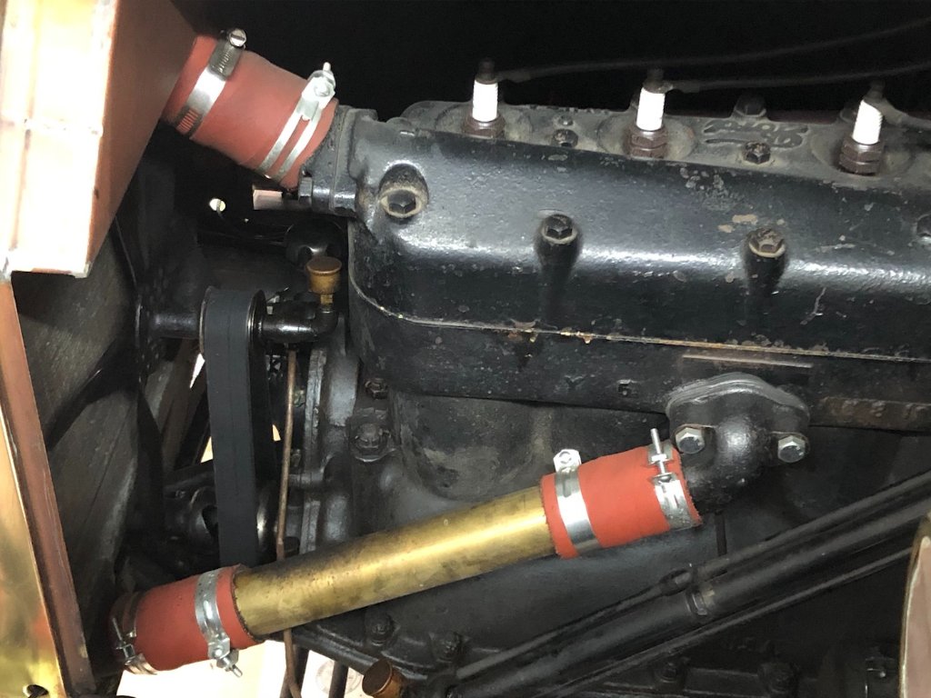

A month ago I bought a 1914 touring car. It has some modifications, one of which is a 1919 (I think) motor with generator & starter. It is an older restoration that has been sitting for some years.
The previous own used a water soluble oil in the radiator and the water drained out clear. As one of the things needed to get this car ready to drive, I thought the radiator hoses ought to be changed. The top one was so hard I had to carve it off with a knife. The bottom two were fine and will go into the spares box. The water outlet had a rusted out portion and a new one has been ordered.
All the hoses & the brass down tube were clean inside, very little sign of rust. I have three drives in the car, one 30-40 minutes with temps in the mid 40s. The car ran cool, I had no reason to suspect trouble.

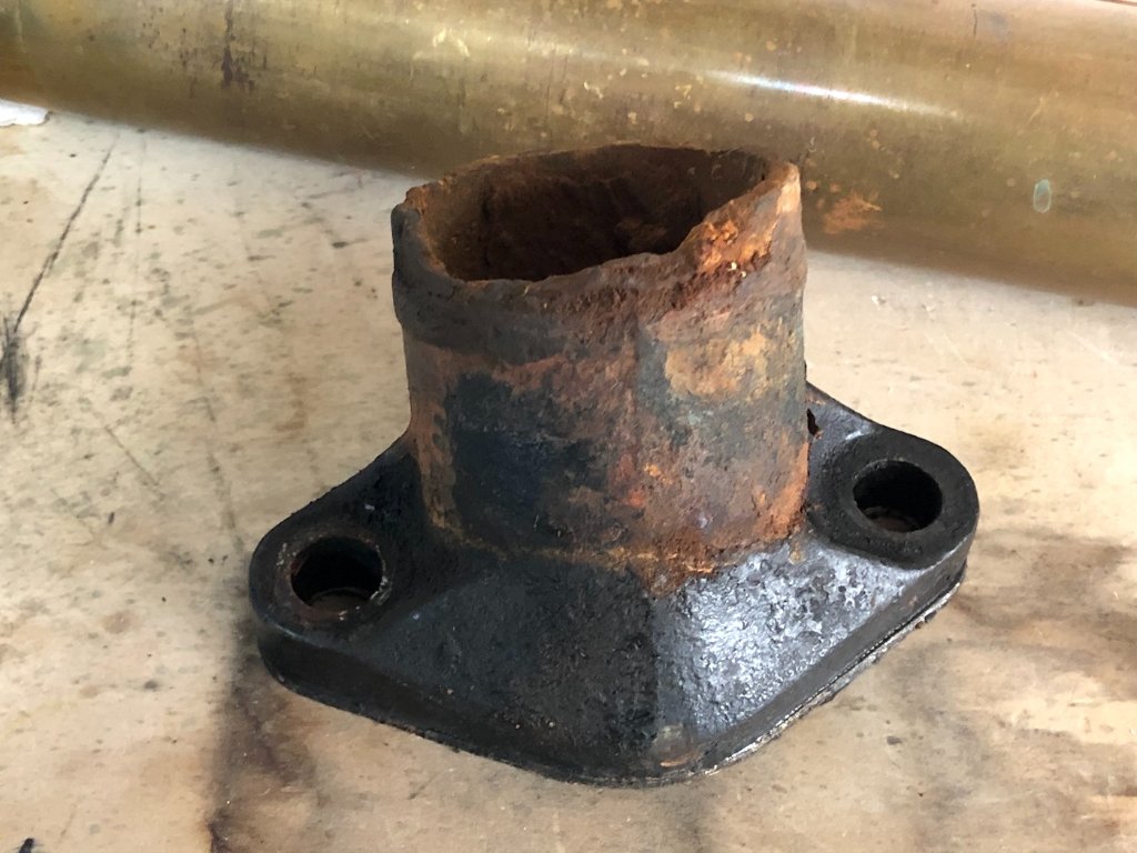

I went to clean everything up to get ready to reinstall the bits and felt inside the lower radiator hose outlet. My finger found a layer of oily rusty sediment. I got out as much as I could and scraped it off my hand into a container. The block inside the water inlet outlet had some also but not as much as in the radiator.
My hand was very messy after this and the old reliable Go-Jo would not clean it off! Paint thinner cut it and cleaned up the mess.
The question now is what to do about it? A traditional back flush with a hose is not likely to make any headway. Will regular fast flush cut this stuff? If not, what will? A pal suggested vinegar.
The car is drivable in winter weather as it is but I would like to get it ready for the summer heat which is just around the corner.

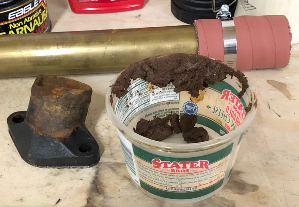

Here are the pics of the oily paste which did not load the first time.

Scrape out as much as you can right now. Then put it back together and see how it performs in warm weather. Oh, also use antifreeze. Although some will disagree, I think what you have is what's to be expected with water soluble oil.

Frankly, as long as it's "all apart", take the radiator into a reliable radiator shop and have it flushed out. Even with brass radiators, a good shop can get the core cleaned out with little to no effect on the brass. You may be glad you did. Strange as it may sound, maybe you should literally soak the engine interior in good ol' lacquer thinner, if it took paint thinner to get it off your hands. Man that is a mess. The lacquer thinner should dissolve it, you may then want to give it a vinegar flush. Regardless, the nice thing about
lacquer thinner, is it won't leave any residue inside the engine...it'll all vaporize away quite readily. If it were mine, this is what I would do. Two gallons will be more than enough.

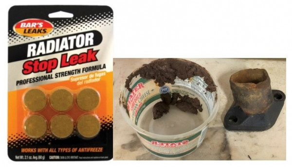

It looks like stop-leak to me. I bought a car a couple years ago that had some pretty nasty antifreeze in it with oily stuff floating on top. The top hose was hard, wrinkled, and shrunken, probably from whatever the oil was staying near the top when the engine was cool. The car had a newer radiator on it. What I think happened is that the previous owner likely drained his antifreeze into an unclean drain pan that had some gas & oil residue in it. He may have changed the radiator and dumped that soup back in, ran it for a couple years then parked it for a few more.

I drained the oil the day after I got the car and before I got it running. The oil was somewhat dark but still very oily. No signs of water contamination. I had a look inside the transmission and all looked good in there. My '23 runabout had a head gasket issue some years ago that I discovered when looking in the trans door to find a light grey paste coating everything and rust under that.
What is acid? Is Prestone Fast Flush an acid? I believe vinegar is an acid.

Paul, you have a perfect sample in your container to use to find a solvent for that crud that's inside your block. There's a couple of safe first choices but may be just a waste of time if they don't dissolve your globs... The normal heavy duty rad cleaner like Prestone, I know guys that have had great results with a new one made by EvapoRust that made is specifically for radiators. You can leave that one in for extended periods of time without damage. I haven't tried it but if it's anything like their rust dissolver or half as good it's a Great product.
I believe your goop might need something more aggressive to dissolve the mess. The paint thinner or Lacquer thinner sounds like it might be great for this one! I'm not a fan of Water soluable oil. Maybe somebody added something they thought was the proper oil or the other comment of a stop leak treatment may have been used. I don't know any modern cars or trucks that use it today. You should check your radiator, it must also be bad?

Hi Gene, I had in mind trying a sample of the muck to see what works. I know paint thinner does the job, we'll see about the Fast Flush. That EvapoRust sounds like it might be worth a try if it can hack the oily part.

Vinegar is diluted glacial acetic acid. Do not use that like Adam states.
You could try a mix of isopropyl alcohol and water with your muck and see if that mixes at all. Stir it up in a cup, not in your cooling system.
Rubbing alcohol is isopropyl alcohol or ethyl alcohol. The isopropyl might work better.

I agree with Gene. Seal the bottom outlet of the radiator and fill with lacquer thinner and let stand overnight flush the next day. It should breakdown and dissolve anything that should not be in there. Running a solution of Dawn dish washing liquid in water through should remove any remaining oily residue. If there is the same goop in the water jacket, seal the water inlet port and fill the jacket up to the outlet port with lacquer thinner and also let stand overnight. Jim Patrick

Jim...nice to see a "second" to my earlier suggestion about lacquer thinner. This wonderful, almost miracle product, is way too often overlooked. It certainly should literally liquify this crap in his engine, flush out easily, heck I would even go so far as to go crazy and spend a little more on a couple extra gallons of lacquer thinner for a final flush. Give the engine 24 hours to "air dry", this stuff vaporizes fast, leaves no residue. Then if he wants he can give it another clear water flush just to feel good. So easy.

Lacquer thinner would absolutely NOT be good for the finish, so better to remove the radiator from the car or cover everything in the vicinity with a tarp to protect from residual splashes or spilling. Jim Patrick

Good thought on the rad Jim. And I've "repurposed" lacquer thinner like you suggest too! And no need for apology...meant no complaint!!

I'm with this analysis and sequence of events. The residue could be stop leak because it didn't dissolve completely in the soluble oil mix mixed the the water neck rust. While engine oil mixed with antifreeze can cause sludge - antifreeze was not present in this caseAdam wrote: ↑Thu Jan 14, 2021 4:28 pmIt looks like stop-leak to me. I bought a car a couple years ago that had some pretty nasty antifreeze in it with oily stuff floating on top. The top hose was hard, wrinkled, and shrunken, probably from whatever the oil was staying near the top when the engine was cool. The car had a newer radiator on it. What I think happened is that the previous owner likely drained his antifreeze into an unclean drain pan that had some gas & oil residue in it. He may have changed the radiator and dumped that soup back in, ran it for a couple years then parked it for a few more.

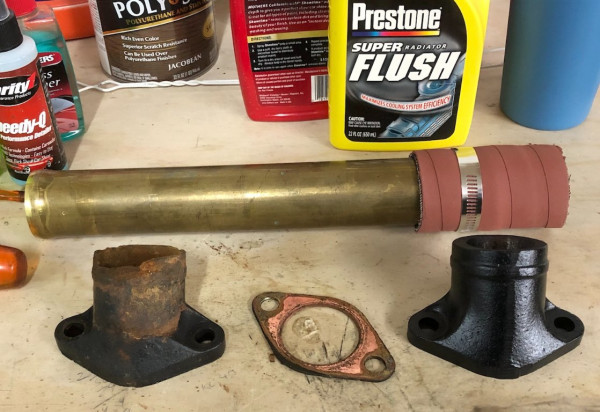

The fact that Go-Jo would not clean my hands makes me think there is more going on than just water soluble oil. I have no experience with stop leak products but someone may well have tried to cure a leak coming from that rusted out water outlet.
Paint thinner does solve it, I'll try Fast Flush on some of the goo Saturday. We have a weather window now and for the next several days so I really want to put it together and get the car out on the road even if I have to pull it apart later for a better clean.
I love the idea of the liquid rust cleaners. I just did my '39 Caddie which the water soluble oil had allowed to get rusty over the last couple of decades. These products might have saved a lot of work.

I agree its probably old stop leak that just settled in the bottom of the cooling system. Personally, I would avoid the lacquer thinner solution. If you still have a sample of the crud, try dissolving it with some Zep Super Purple cleaner. Its avail at Home depot etc. Its a strong detergent with a very basic PH. If that works, fill the cooling system with a 75% solution and let it sit overnight and then flush it out with water. We flush machine tool coolant sumps in this manner and those can be pretty nasty in terms of gunk and goo.

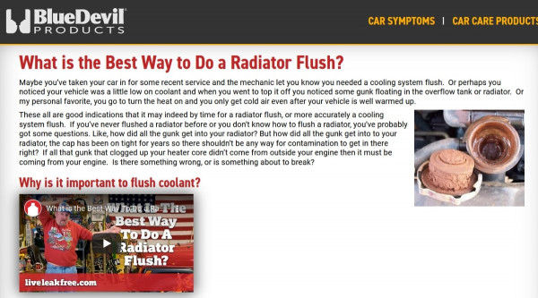

Blue Devil Products has been discussed in the Forum last year I believe - looks to be a possible answer.

I ran some tests to see what would solve this goo. The Prestone Flush I had on hand is old and so may not be fully up to snuff. I poured some out into a container with warm water and put a plastic stick with the goo on it. The Prestone didn't touch it. I bought a couple of gallons of the Zep Purple & repeated the test. At first, there was no visible result but returning after lunch revealed that the fluid was rusty colored and the goo on the stick was smaller.
I was very high on trying the Zep out until I put my glasses on and read that it was not to be used on brass or copper. Drat!

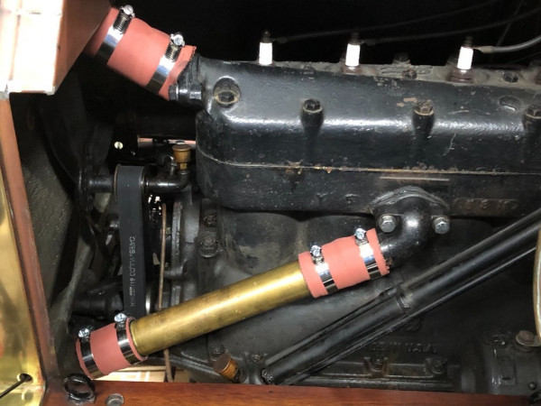

The cooling system was back together so the Prestone Flush went into it and I went for a drive. The motor ran for about two hours, mostly driving on country roads between 25 & 30 mph. The MotoMeter indicated that the temp was just below the circle throughout the drive. On coming back and shutting down the motor, the reading went up into the bottom of the circle as shown in the picture.

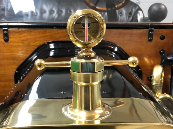

A laser thermometer showed readings around 180° on the upper tank & about 90° cooler at the bottom of the radiator. The air temps on the drive ranged from about 45° at the start & dropping to 40° by the end of the drive. Are those readings about right for a cooling system in good shape?
The Prestone is still in the system now and I intend to give the car a short drive this afternoon and drain it out.
I'm still thinking of that Zep and wondering if it might be safe to use for a short time, a few hours for example?

Those temperatures are about normal. However the true test would be a hard run on a very hot day. It will be a few months before that test can be made. Does the ZEP have any listed neutralizer. Rinsing it out might not be enough to keep down the damage to the brass and copper. If it contains lye, you need acid neutralizer such as vinegar, but if it contains acid, you need something like soda.

Thanks Norm, our ink expert here at the office who is familiar with chemistry says its a base. Soda ought to neutralize it? Do you think it likely that any harm could be done in the few hours it would be in the system?

I did not try lacquer thinner or MEK (I have both on the shelf) as I know paint thinner cuts it and have little doubt that those solvents will as well.

Sunday with the car back together, I went out for a long drive and then parked the car overnight. The next day it was back on the road for another nice drive. Once again, the temps were below the circle on the MotoMeter and the motor acted fine, no signs of getting hot. On coming back it was time to drain the Prestone flush out. No surprise here but the drain dripped a few times then stopped completely. Even poking the hole with a rod failed to release the warm flush.
The lower clamp came off & then the the inlet fitting to the block was pried off releasing a torrent of rusty warm water all over the wood hood shelf & fender. Pulling the hose assembly off allowed more water out. After letting it cool & drain for half an hour or so, a couple of gallons of clear water were poured into the radiator flushing out both the block & the radiator. Now the drain cock cleared. Two more gallons of water poured through seemed to clear the flush out pretty well.
Feeling inside the lower tank revealed less of the goo than had been present but it still wasn't clean. The Prestone worked better than I expected.
I'm too big a coward to risk the brass radiator with the Zep so I ordered a jug of the Blue Devil flush and will try that next. It will take a week or so to get here and then we'll repeat the process.
