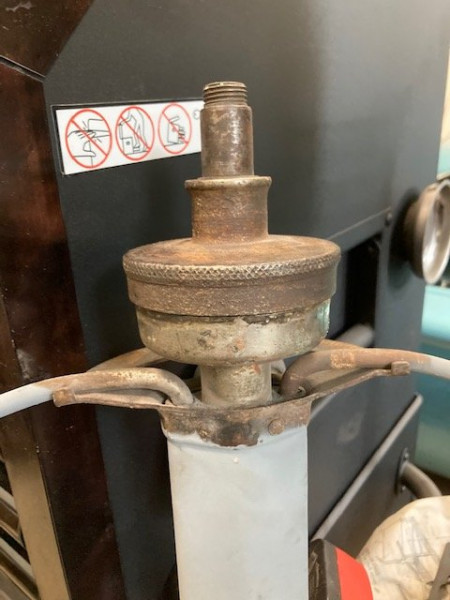

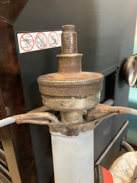

Hi For my planned Speedster I have a somewhat cruddy but otherwise ok steering gear cover, controls, and quadrant. Any suggestions on improving the appearance of these? I suppose I can paint the whole thing white which is going to be the speedster color. I do have a brass quadrant. How hard is it to remove the rivets, pull the steering and control rods out, and change out the quadrant for my brass one?

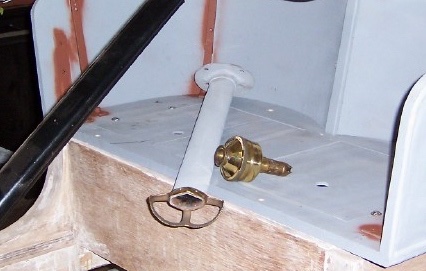

Easiest piece of bling is a brass cover from an earlier box. It doesn't have to be the really early one that goes with the two piece riveted steering box.
The brass quadrant is another operation altogether. Removing the present one is the easiest part. That will also allow you to pull the rods and steering case. The case is brass and could be polished at this time. Removing and replacing the rods is not something I would do.
Then you have to put it together again, and you are faced with lining up 6 holes in 3 different components, not something I am capable of, but which is critical to a good, tight column. As the columns seem to be assembled as a a one off, each has different rivet spacings.
So, on my rebuilt 1912 column, the following was done.
I silver soldered shut the two holes on the lower side of the quadrant. I welded shut and refinished the 4 holes in the steel column tube. I drilled and tapped the rivet holes in the brass steering box and screwed brass metal threads in to fill those. Then what you have left is the two top holes in the quadrant to guide the drill, and all new material to create perfectly aligned holes to take new rivets. It is best to have a second set of eyes to help keep the drill aligned for the driling.

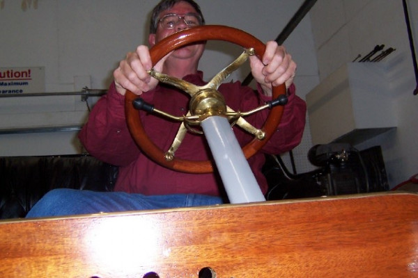

Went through two of those expensive repo brass cast quandants as miss-drilled the holes. Polished later case, repop brass cover, painted throttle and spark rods, cut short for Baklite knobs, fancy repro brass spider and wood rim
Steering gear stop in later case.

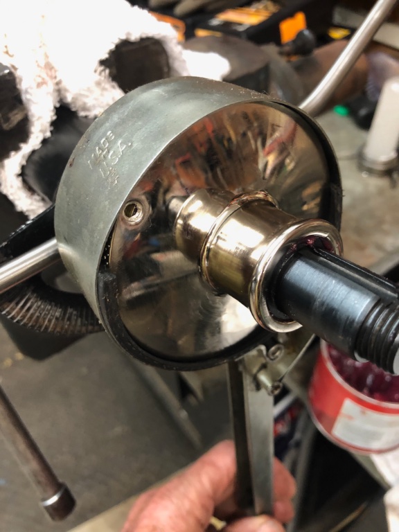

- Posts: 4084
Re: Improve Cruddy Steering Gear Cover, Controls, Quadrant?
Ignacio
For stripping nickel plate off the steering gear case, there is mechanical or chemical means. Soaking in Caswell nickel stripper (google 'caswell plating', search nickel stripping powder) or muriatic acid. Acid leaves a red brown surface that has to be removed. Or glass bead surface and finish with fine grit paper, 1000, 1500. Then both methods need polishing on high speed buffer soft wheel with a hard bar of polishing compound.
These methods need the part to be removed for reaching surfaces, so the quadrant rivets are drilled out, and the steering case and throttle and spark rods removed from the column tube. On mine, the steering case finish was about worn off nickel, a trip to the buffing wheel and got it done, using white rouge and red rouge.

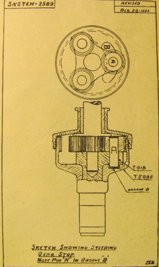

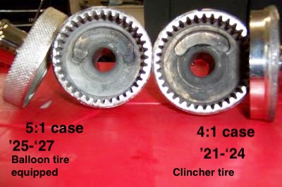

As for determining the date of your steering gear cluster case, remove the top cover by backing out the tiny single slot locking screw on the edge face, and twist off the threaded cover. A padded oil filter wrench is a handy twist off tool for stuck covers. The covers are steel, plated, and the steel cover and brass case sometimes weld their threads together
Then look at the case after clearing out the grease and removing the triple gears in the cluster, and note the groove in the base of the steering case. Later cases with the 5:1 triple gears have a longer groove. The 4:1 have the shorter groove. No groove means the case is pre '21 and doesn't have the improved safety that Ford added. Important....4:1 - 5:1 gears, along with 4:1 - 5:1 steering posts (shafts) cannot interchange with each other!
Oil filter wrench as tool.
