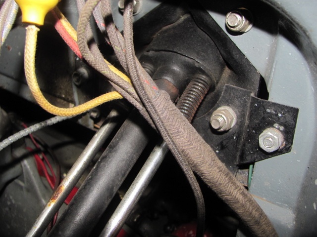

Mounts to engine side of the firewall;
http://www.mtfca.com/discus/messages/50 ... 1226597205
With the floor boards out you might be able to reach under and hold the bolts.

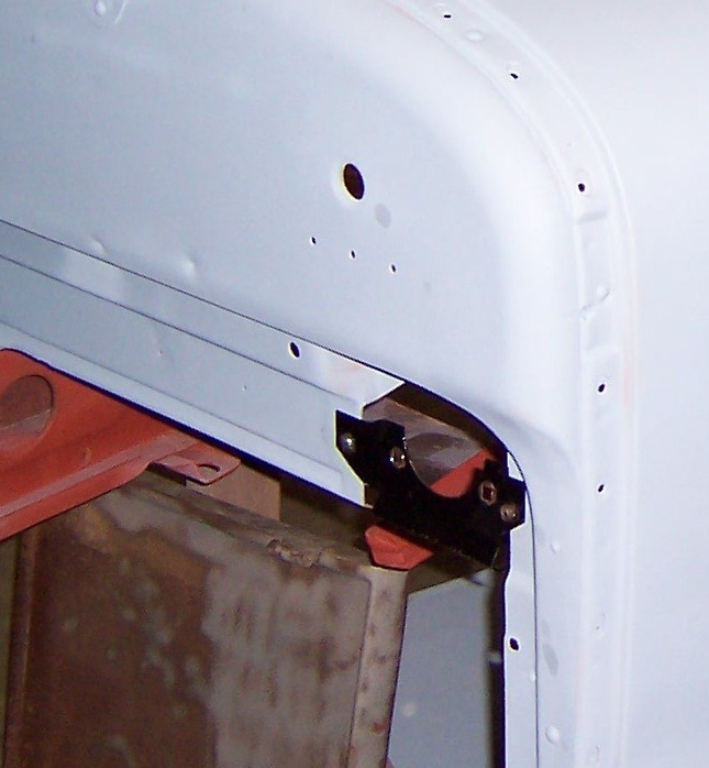

The lower bracket should fit to the outside of the firewall. That way the angled flange on the lower edge aligns with the lower firewall edge on the Inside of the firewall.
That is where the top floorboard rests. The bracket is offset to align the steering column flush with the firewall.
Factory original Nov. '25 production, un-disturbed, prior to restoring.

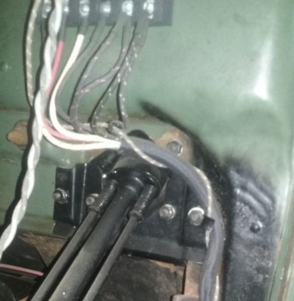

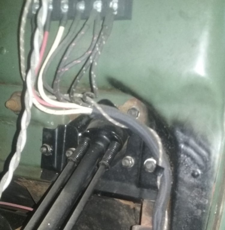

My 1926 coupe. Different looking bracket, same mounting.
