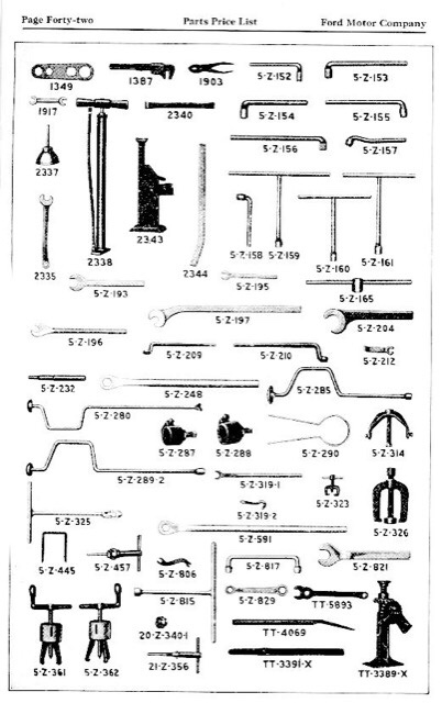

I recall in the past seeing a lengthy list of Ford tool numbers. I have a variety of marked Ford tools but have no idea what they are or if they are T or maybe A tools. Most are not shown in the repro parts list book. Anybody have a link to such a list?

Is this what you are looking for? Jim Patrick
Posts: 6792
Re: Ford Tool Number List
Post by Scott_Conger » Tue Jan 26, 2021 9:35 pm
Ford Z tools.PDF
(430.21 KiB) Downloaded 185 times
Model_T_Tools_All-842693.pdf
(49.51 KiB) Downloaded 191 times

That's the list. Looks like it came from Vintage Ford magazine. I knew I saw it somewhere. Thanks.

Model A club has this listing of how to identify what year Ford tool with the prefix number on the tool. Goes thru V8 years.
https://www.mafca.com/tqa_partnumbers.html
Posts: 7411
Post by Steve Jelf » Wed Jan 27, 2021 10:39 pm
The Ford Z tools list with illustrations is copied from the Model T Encyclopedia, where it is more readable.
