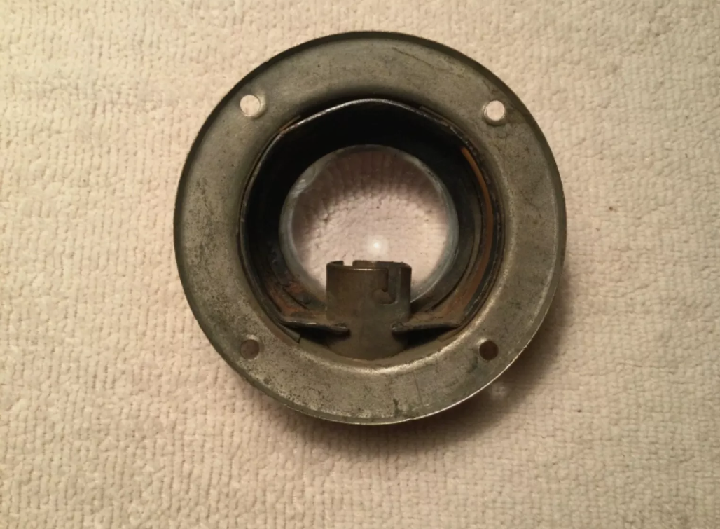

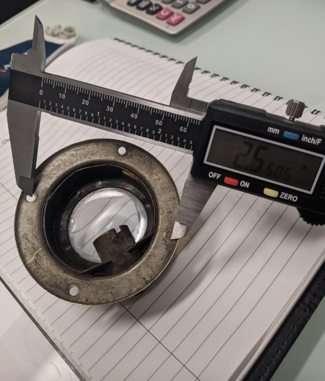

I recently acquired a motometer glo-light and am curious on what size motometer would this accessory fit. I would like to purchase a motometer and add to my T roadster build.
I measured between bolt holes and got an measurement of 2.55 between center holes. Measuring at a criss cross pattern. The overall outside diameter of the glo-meter is roughly around 2.88.

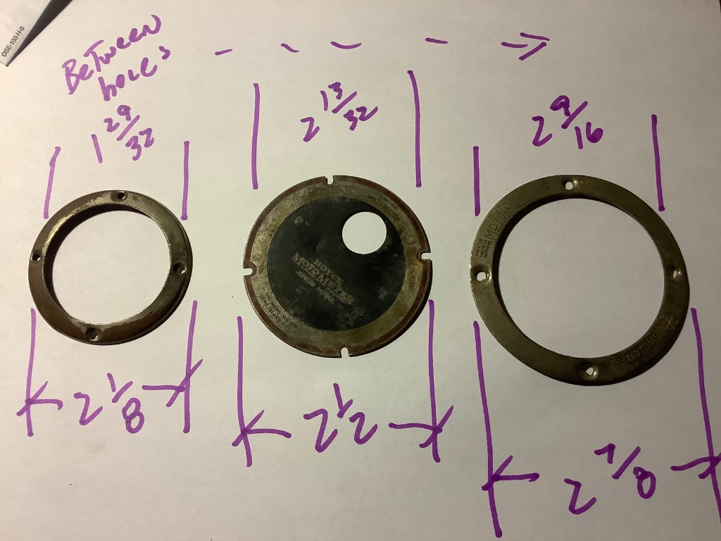

Post by Dropacent » Wed Jan 27, 2021 5:54 pm
This may help. The middle one is marked “junior”
