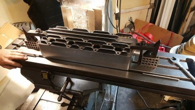

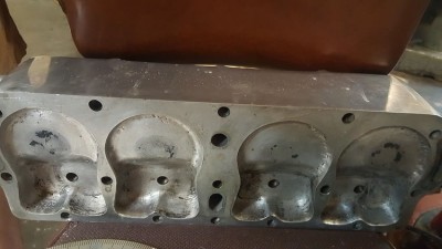

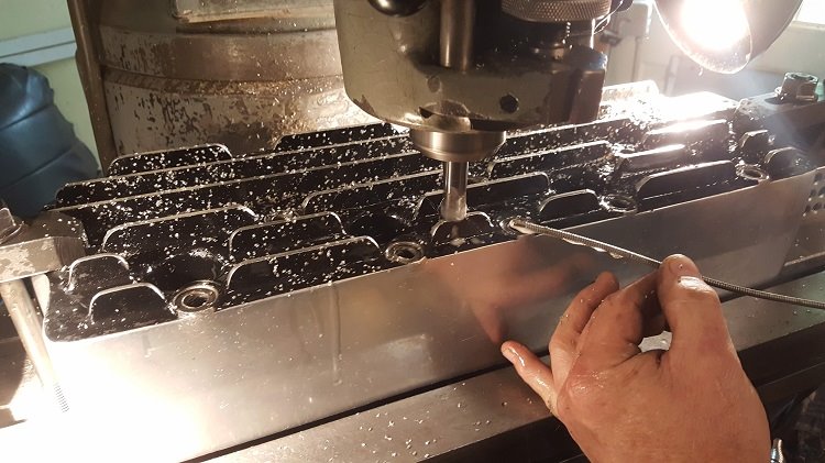

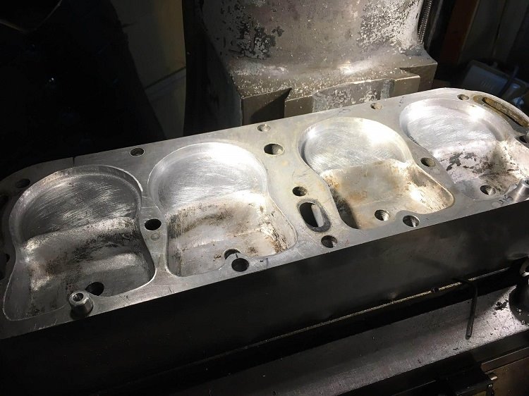

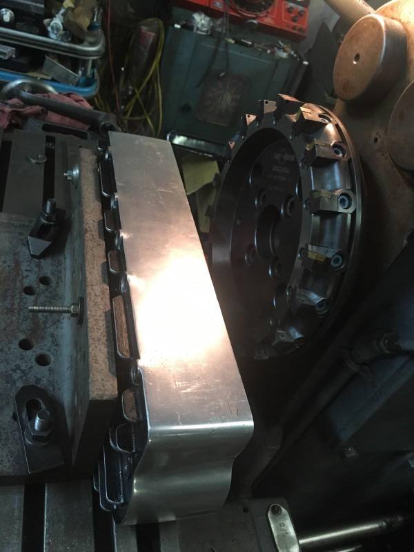

I received a few questions about the head I am running. I too do not know much about it. I have attached a few links to the information I have obtained on it. As you can see in the pictures, I had to perform a lot of work to get it into working condition. Leveled both the top surface and shaved the decking surface. Where the head bolts go through, we milled them all level. We cleaned up the combustion chambers as well. I did not purchase it from any member on here and do not know the people in the links personally.
