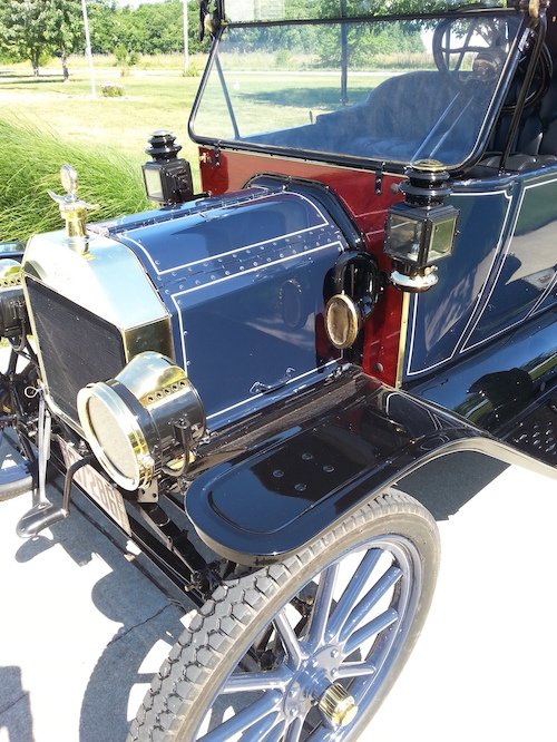

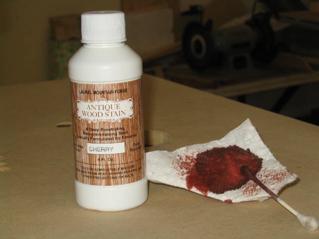

I don't remember anything about MinWax stain, but I do know, and a huge consensus is, that Laural Mountain Forge Cherry stain is as close to original as about you can get.

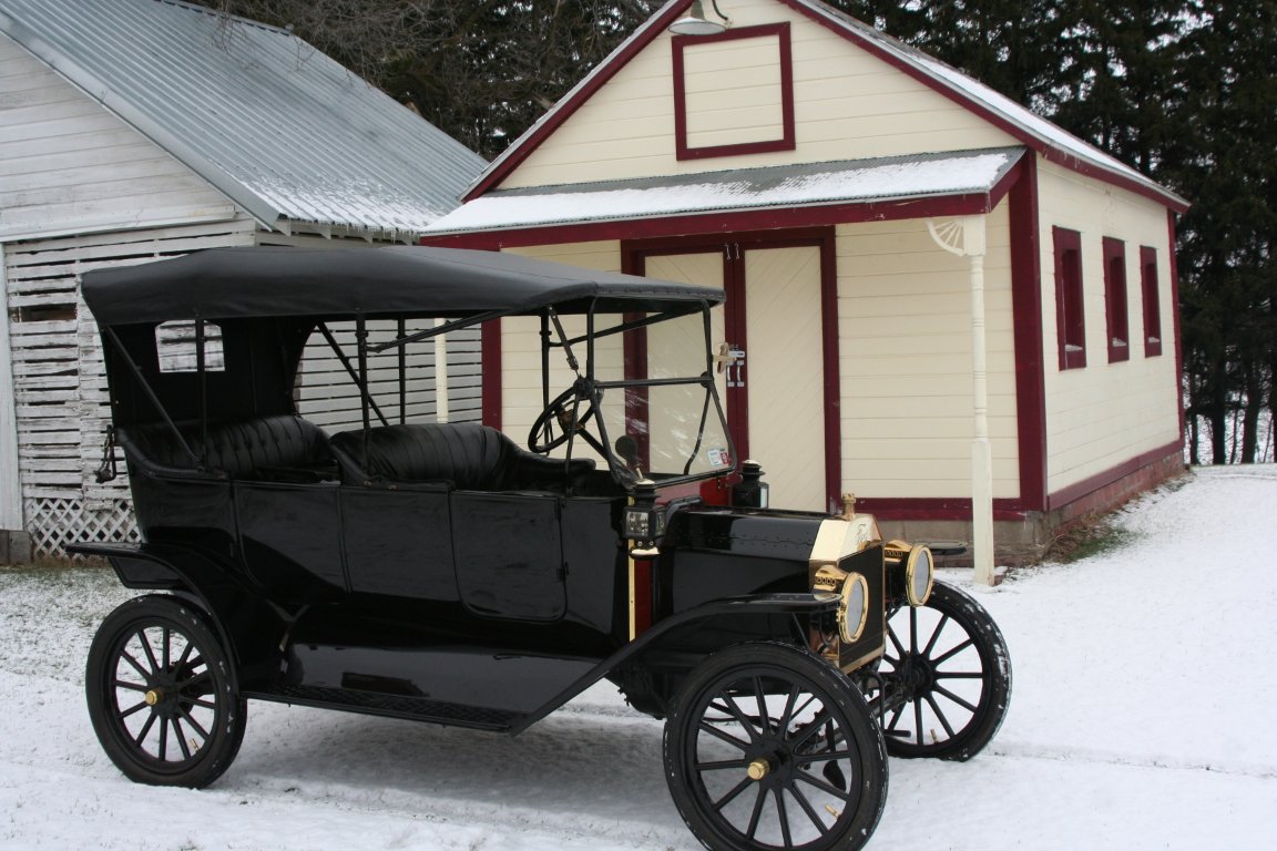

I think you may be asking about Pratt & Lambert's Cherry Bark. That has been discontinued. I used it on my own '14 dash. At least one other poster here (besides me :D ) bought all the remaining stock at his local store so it's still out there.

I recently used some Cherry Bark stain on my KW coil box. It is nice, but I prefer the Laurel Mountain Forge stain. I believe it is closer to what Ford used.
