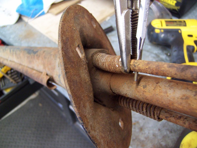

How are the springs on the throttle and spark rod removed, what holds them in place ? I wanted to remove the two rods so I can clean and remove the rust them, replacing the springs and cups possibly replacing the two rods. To remove the rods I think I need to remove the 2 levers by drilling out the pins ? Is it advisable to do this, the appear to work OK but are pretty grungy looking.
- Posts: 4045
Re: Rebuilding / Restoring Steering Column Quesions
Better to clean them in place. Then paint, to make em look good under the hood.
Removing the column rods means removing the cluster from the upper quandrant , completely disassemble the steering column.
To remove the rods, follow instructions in Ford Service , Chapter XXV.
It is possible to drive the arm pins out with a small punch. If you drill them the holes may become enlarged. The spring cups cover some similar pins that also can be pulled out.
- Posts: 7393
The little cups at the bottom of the springs have pins in them. Pull back the cups and remove the pins. To remolve the rods from the column you have to drill out the rivets holding in the gear case, pull it out, and pry open the claws that hold in the rods. Anneal the claws (turn them red and let them cool) before reassembly. Parts dealers have the proper rivets. All this is done with the column out of the car, of course.

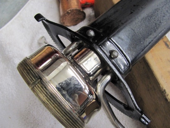

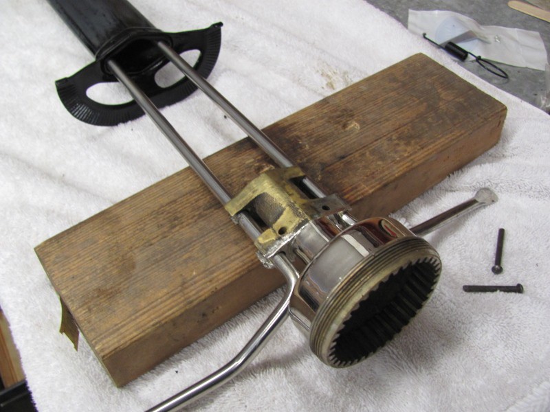

If you remove the round headed riveted pins, after restoration and during reassembly, you will never be able to get them to look original again. Yes you will be able to put it all back together using long round headed slotted machines screw, nutted or bradded on the bottom, but the original round headed rivets will be a thing of the past. Don’t ask me how I know. Jim Patrick
PS. It would be great if someone would develop a fastener for this purpose with round headed male and female shafts that slides into each side and secures in the center of the column. Something like the photo I am posting only without the Allen wrench hole.

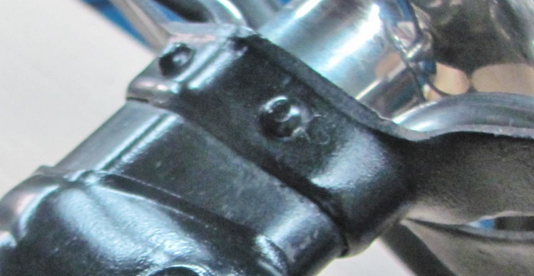

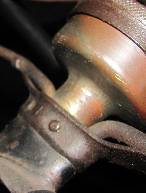

"Yes you will be able to put it all back together using long round headed slotted machines screw, nutted or bradded on the bottom, but the original round headed rivets will be a thing of the past."
Jim, with all due respect, anything other than solid rivets or solid taper pins at the assembly of the column tube, quadrant, and steering case won't give the necessary strength and security to this important spot. Stay with Ford fastener design.
Using the vendor style rivets is easy, they work, and look like factory.
New rivet along side a removed original New replaced rivets, finished job View of original rivets on unrestored column for comparison/b]
