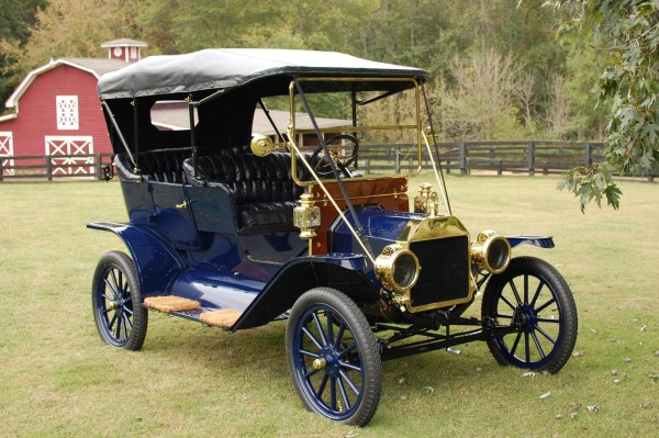

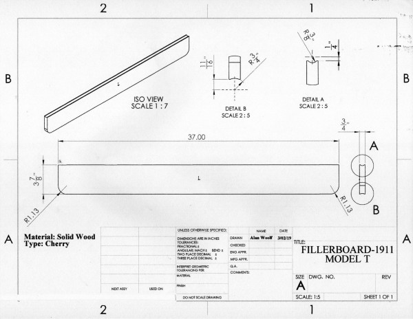

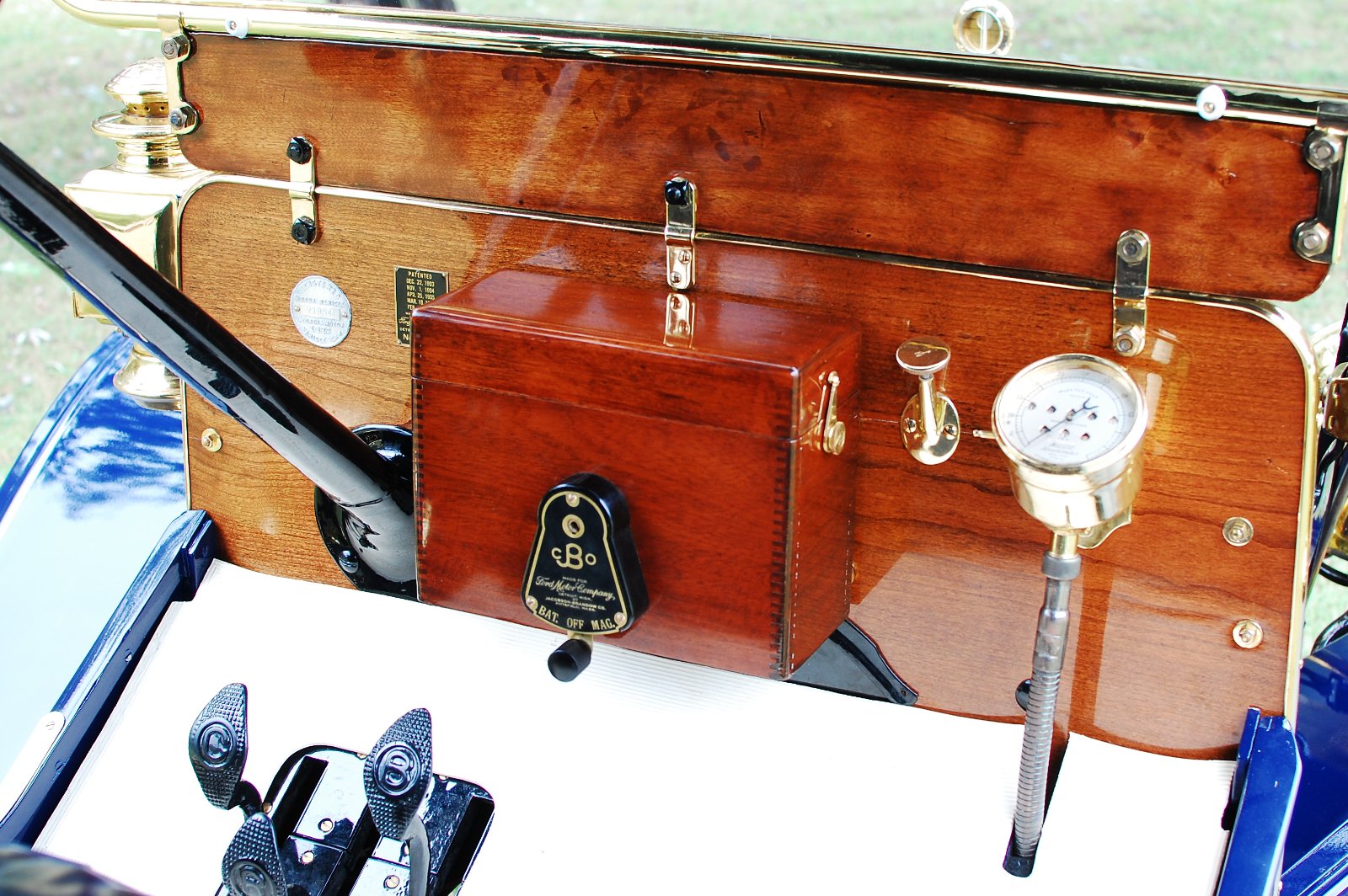

I am starting this topic to help answer Art Ebeling's question about Dash Fillerboards for the 1911 cars. My brother owns a 1911 Touring built in August 1911. This was the car that came out of the Ford dealership in Dublin, GA. During the restoration we were able to use the original fillerboard. I created a drawing from the original fillerboard on his car to answer Art's question. It is attached below and can be downloaded and printed.
The car was built in August 1911. There is no brass trim on the fillerboard. The board has radii on top and bottom. The radius on the bottom does not match the original brass trim very well. This probably typical of most cars. The radius on the top matches the windshield tubing.
BTW if you want to see more photos of the car it was the cover car for the Model T Times in March of 2019.

The measurements are what I needed and your help is greatly appreciated. Art

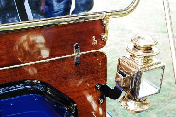

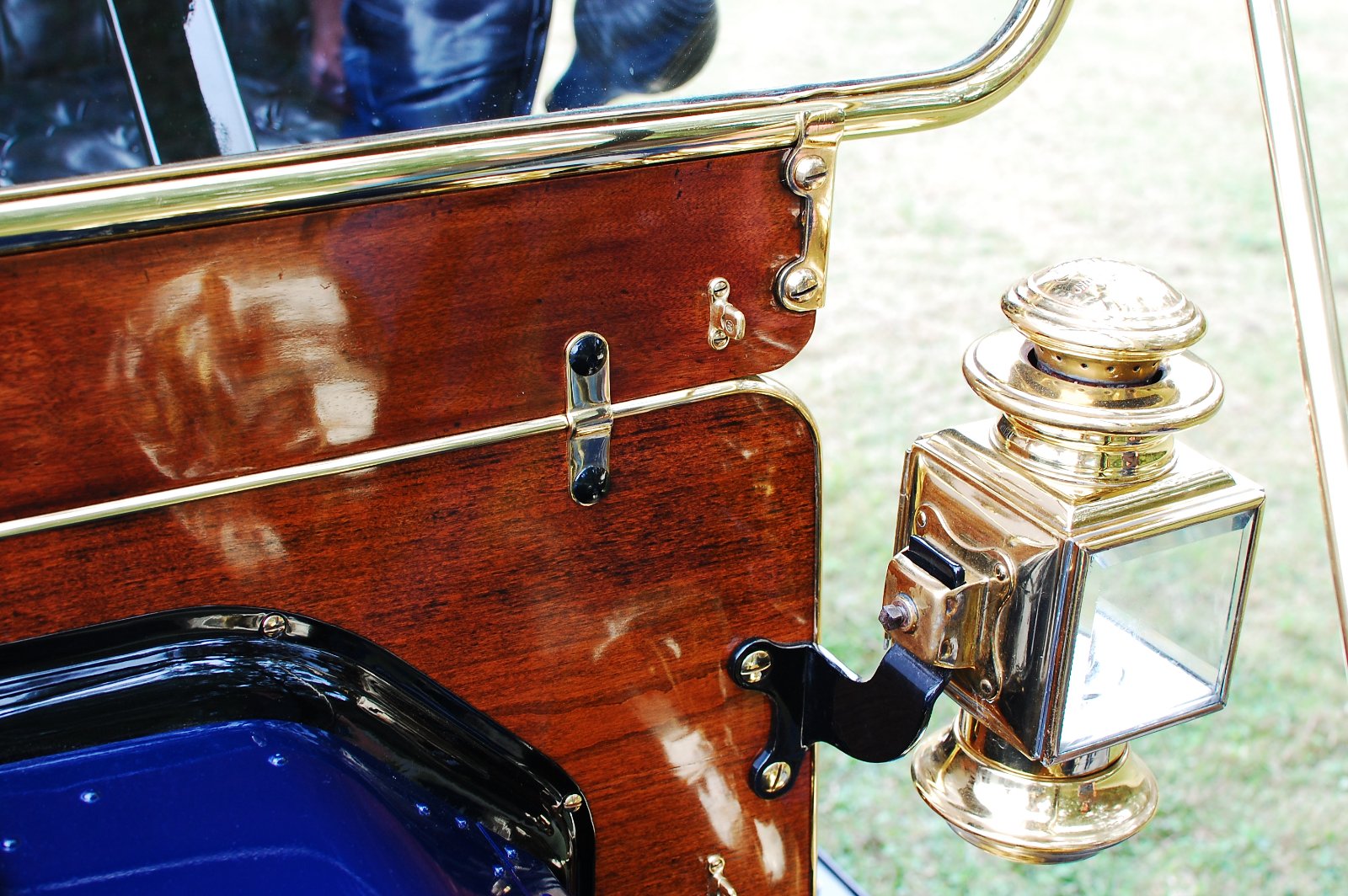

Hi, lovely colour of timber firewall. Sorry to get off the topic. Would that be aged cherry wood?

It is cherry veneer over a baltic birch core.

Thank you Dan, I have a raw cherry wood veneer, untouched at this stage. How did you get that rich colour. Have you let it age, with a top clear coat?

Thanks Michael. We used raw cherry veneer to cover the baltic birch core. Since we had the original firewall, we were able to get a sample of the original stain, which when matched, turned out to be a black cherry color. Very fine steel wool was used to rub the stained veneer surface, lightening the color some and allowing the grain of the cherry wood to show through well. We applied 4 coats of Gleam marine spar varnish with UV protection purchased from a company called Total Boat. The varnish was wet sanded between coats with increasingly finer sand paper, ending with 1500 grit. After the final sanding, I rubbed the finish by hand with fine polishing compound to get a nice gloss.

Thanks Dan. I am going to do mine the same.

Using the plans in post 1 from Alan, this is how The finished fillerboard turned out.Thanks for the help. Art
