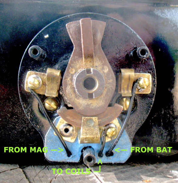

The internals of the switch send the electricity to the coil box. Inside the switch functions just like the coil box mounted switch, the headlight function is inside the switch but a separate part. The earlier cars 1919-21 still used the coil box mounted switch with a combination horn button/light switch on the steering column with the dimmer coil on the dash, later the dimmer was placed where the ammeter goes. I had a starter coilbox and temporarily ran a wire from my mag to a house light switch (no headlights) until I found a combo switch for the column and a coil box with a switch on the front.

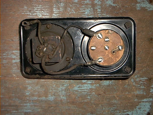

I have a starter equipped '17 but have retained the original coilbox with functional Mag/Batt switch. The headlight switch is a small push-pull switch on the firewall to the right of the coilbox.
Do you plan to add a switch to your coilbox or?

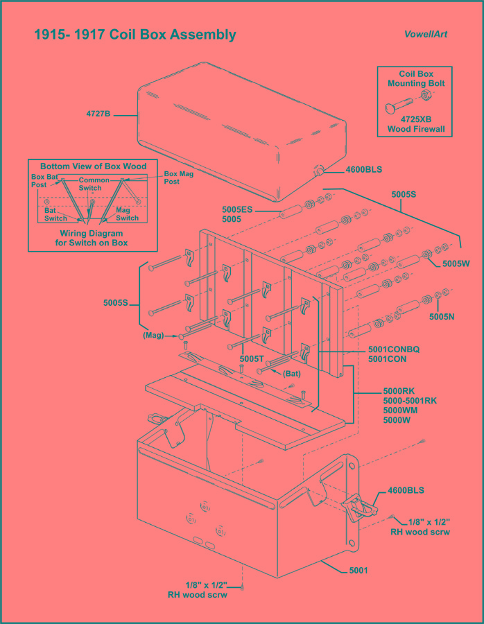

Attached is a drawing showing how the box is wired when a switch is mounted to it. Switches are available from the vendors.

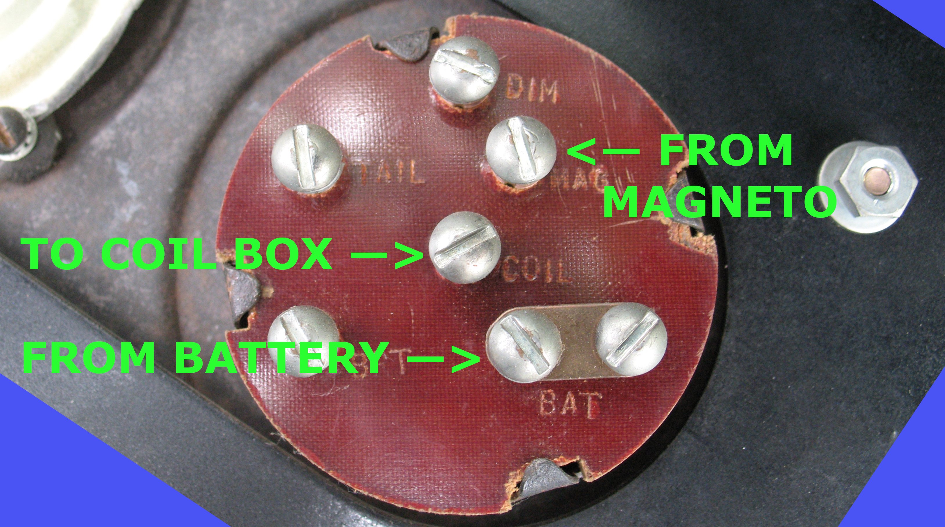

In both setups two wires (MAG and BAT) go to the switch which sends current from one or the other though a wire to the coil box strip. Both arrangements do exactly the same thing. The only real difference is the location of the switch.
In the non-starter configuration the MAG and BAT wires connect to separate box terminals which go to the switch.
In the starter system the MAG and BAT wires connect to the back of the dash switch which sends current through a wire to a single box terminal that goes to the strip.

The strip on the bottom is not connected directly to the power supply, the switch is in between it and power supply. What are you using for a switch, original style that would have been on cars with starter equipment and mounted on the dash or just a simple on-off-on(if running both magneto and battery) or just on-off (if single source) toggle type? In ether case all the switch does is turn the car off or chose between the sources of power that feeds the coil box. Does your coil box have 9 or 10 terminals? For cars with starter equipment normally the 10th or battery terminal would not be used if even installed. The 1919 to 1925 car coil box would not be the same as 1915 to 1919 that were equipped with switch on the front. The earlier boxes were wired as shown in the cut above with the switch on the front. In that case, the terminals on the coil box would have been the connections to the supply power supply too the switch and not connected directly to the strip until the switch was turned to the chosen power source. The 1919 to 1925 would have a single wire going from the strip on the bottom to the terminal on the lower left and if it did have the 10th terminal on the lower right it would not be used.

Tim, thank you for that wiring diagram. The bottom of the coil box wood was the missing piece. I was losing my mind trying to figure those bottom grooves out. I had mine improperly connected, which is why I was so dang confused. That clears up my entire issue.
I guess I have 1919-1925 coil box, as the switch is absent from the front. It came to me with nine terminals.

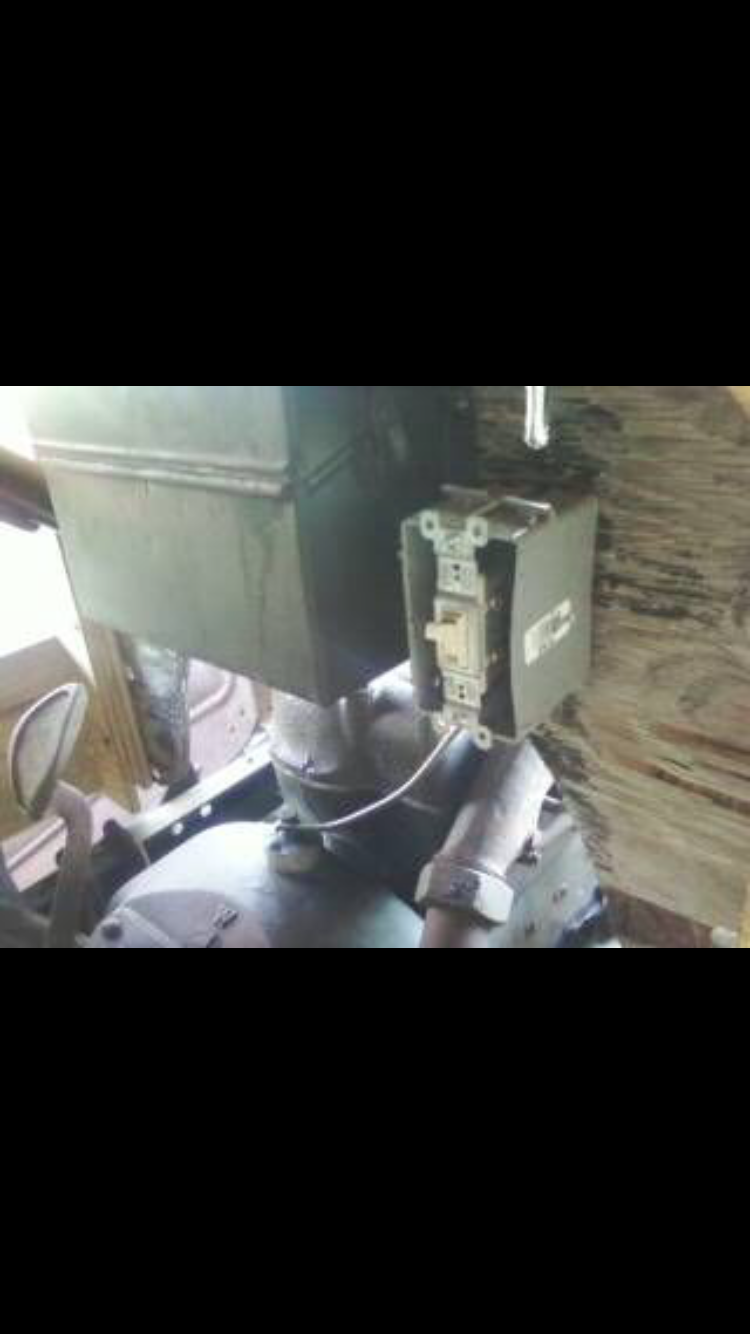

Corey, Ryan has indicated that his "bitsi" car has no starter or generator, he is looking to run the lights w/o a dimmer & use the magneto for lights & a magneto horn. George

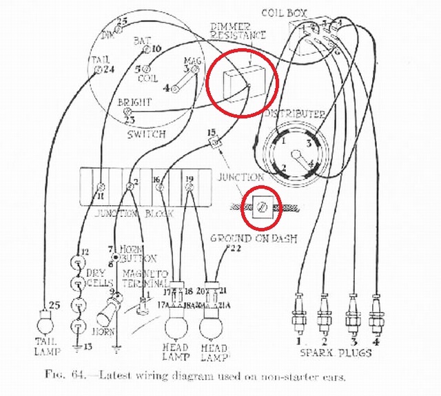

That’s how mine is but the dimmer coil keeps the mag from burning out the headlights. It’s not used on the battery headlights. I thought he wanted to run on mag but have battery powered lights.

Ah, I didn't know a dimmer coil was used on mag lights. I do know of potential burnouts for mag lights, depending on the voltage and how much power the mag is putting out. I just assumed the dimmer coil was for the dim setting for the headlights. Lots to learn!
- Posts: 7392
Re: Non-Starter vs Starter Equipped Coil Box

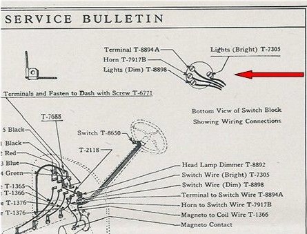

The dimmer was added in late 1917. Before that the current for headlamps went directly from mag to switch to lights to ground. The dimmer was to reduce bulb burnout, and from that you might think that bulb failure was a frequent problem, but my experience with 1915 lights is that the bulbs do eventually go, but they last a long time before they do. Of course you can make them really last if you use the 24v bulbs sold by the parts dealers, but with those you won't have enough light to see anything.

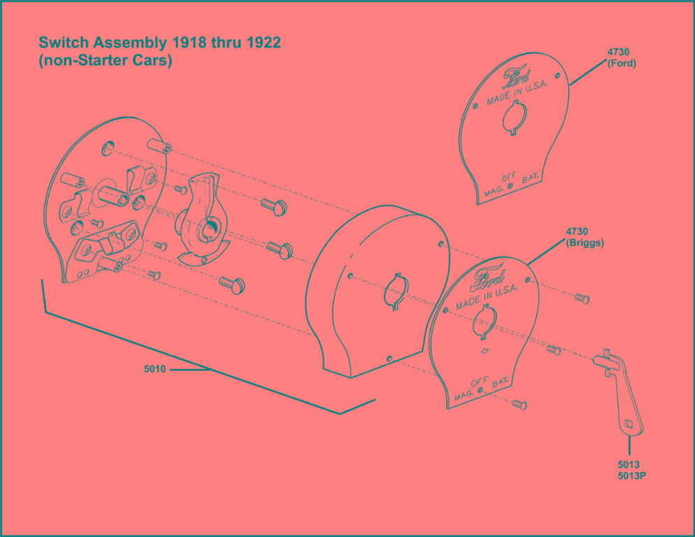

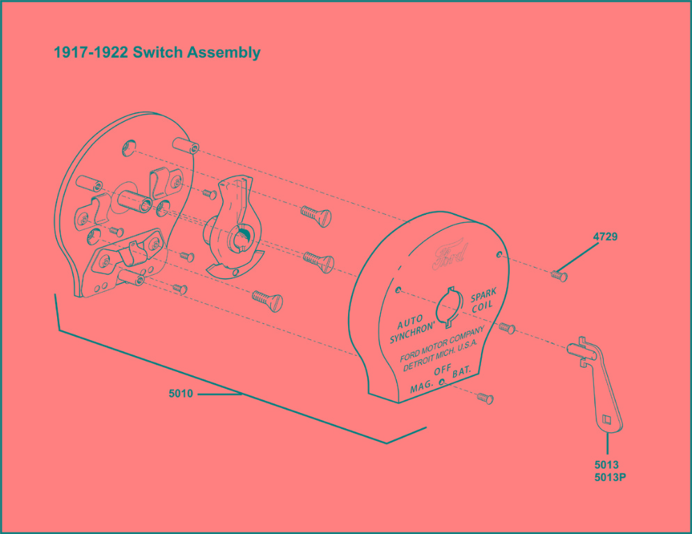

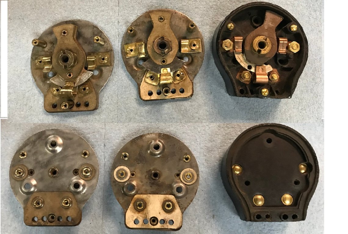

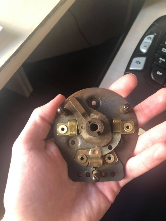

Coil Box Switch Repair

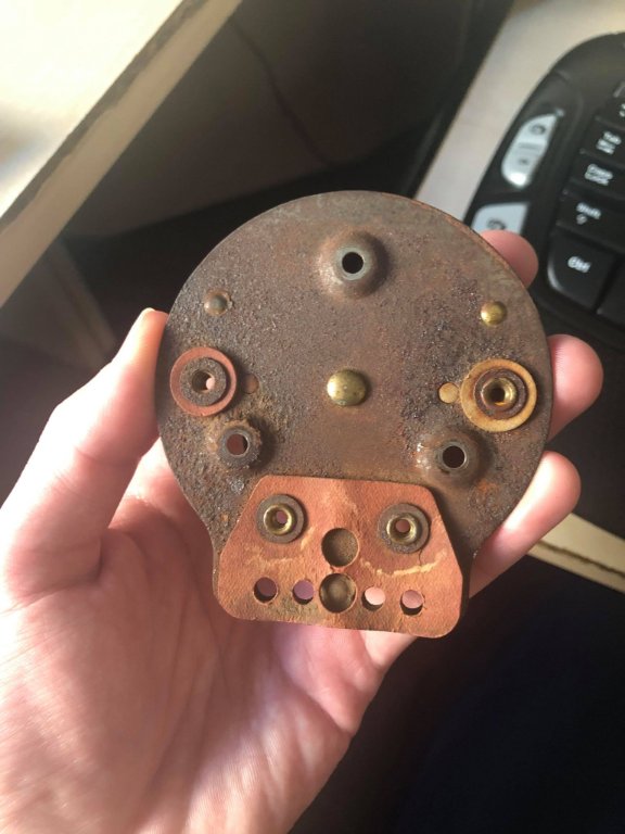

I've a question for my switch and figure I could reuse this old thread.
In order to properly clean this, I'm going to have to undo the rivets. However, it is incredibly unclear to me the general construction of the switch. If I were to drill from the back side, would I not damage the threads for the brass that ultimately hold the screws and the wires? And why does it look like there are two layers of rivets?
I see nothing about the split insulators (the two donuts for the side terminals, and the larger one on the bottom), as well. All I can see in the catalog is this following one.
In fact, the more I look through online catalogs, it seems the modern replacement internals look nothing like the setup used here.
I've got so many questions about the switch that I don't even know where to begin. I am starting to lose my mind over this and I'm really hoping forum members could please enlighten me on how to fix and make useable what should be a simple routine. It seems like such a waste of a useable piece to replace the entire thing with a plastic one.
- Posts: 5497
Why not just take a meter or test light and check for shorts to ground before taking it apart? Once the cover is on, no one will be able to see what is inside.
- Posts: 6537
You have a later style ignition switch (see diagrams). These don't come apart as easily as the older rubber housing style. So unless you have a new set of matching rivets I would not attempt to take the switch apart. I have done a descent cleaning on this style by using a Dremel tool's wire brushes. Looking pretty isn't important as its covered up by a metal cover. So as suggested check for shorts. Consider a method to seal the fiber insulators. Might also gently wet metal base with some rust restorer (Evapo, KrudKutter) after sealing fiber. Best to do minimal cleaning. I'm still working on mine...
ryanf1023
Topic author - Posts: 124
- First Name: Ryan
- Last Name: Fenrich
- * REQUIRED* Type and Year of Model Ts owned: Speedster Project
- Location: Edmonton
Thanks Frank. I didn't know there were multiple types.
Is there an easy method to remove the switch lever? If I could remove that and clean the bottom contact and the switch lever itself, that would solve my issue and I could move on with the project.
- Posts: 6537
I don't know of anyway to remove the switch lever other than to take the main contact apart (not worth it). I used some fine emery cloth (or 1000grut wet dry sandpaper) to clean the lever and between the contacts jaws. As long as the contact clips are tight making good contact and you have continuity that's all that's needed. One drop of oil on the brass switch post should do it.
