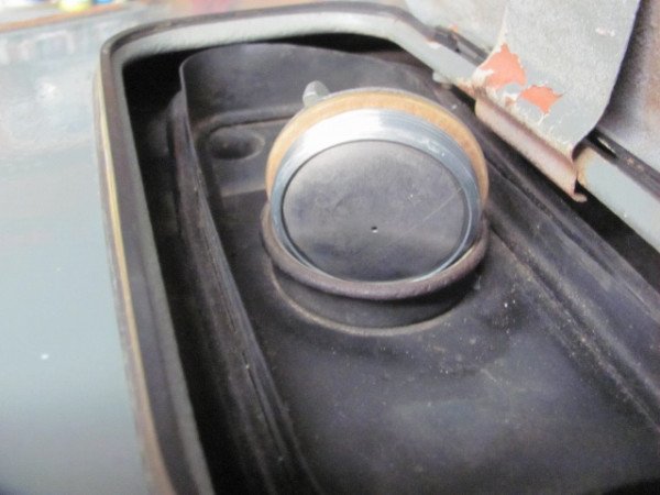

Need more discussion on how to get the gas cap off my 1927 coupe tank.

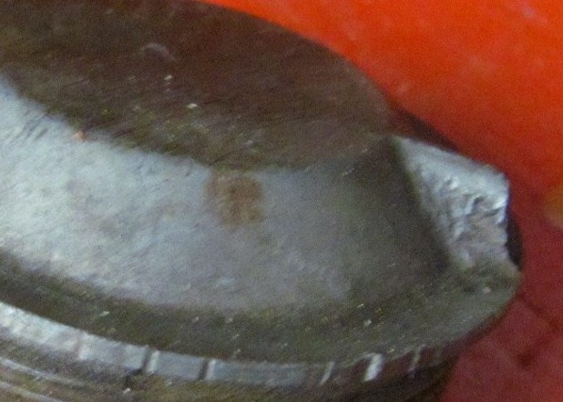

That aged zinc cap with split easy with a small chisel. Tap it on the side, and the threaded ring will break away. Then pry it up with a small blunt tool. The pieces will be big. As Jack posted, any small pieces that could fall in will flush out fine when cleaning the old tank insides.

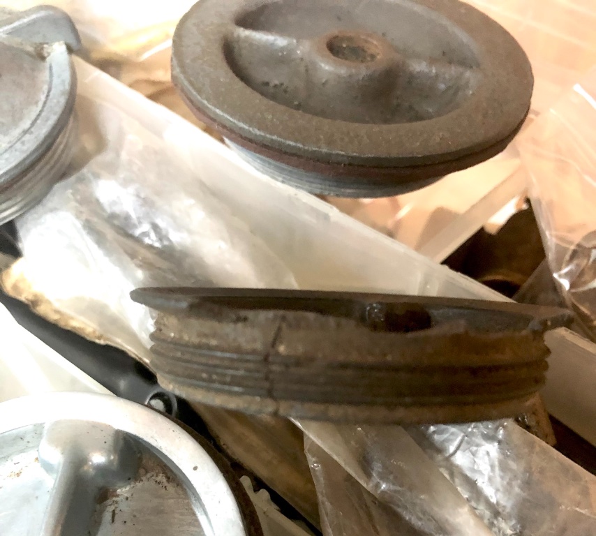

Some get ragged on the edges even when newer, from screwdriver tip jabbing with a hammer ;) ,as those caps can stick. I always coat the threads from time to time with Vaseline to lube them.

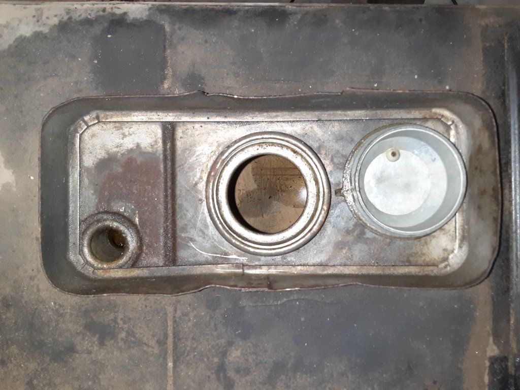

You have never indicted what style gas cap you have either in this discussion or the previous one. If we are to assume it is a "complete" pot metal style cap with the bottom plate as shown in the picture - that would help prevent pieces from falling in if you gently attack the top. BUT as Adam said in the previous discussion "There is a paper “gas cap gasket” that goes on the cap. 90% of its job is preventing the cap from “taking a set” and getting stuck. " So have you tried running a knife edge around the cap to separate it from the gasket or tank?
Jim's suggestion to epoxy a nut to the top of the cap is also a good idea to prevent pieces from falling in.
I would have a vacuum handy to remove any pieces that break off as you go.
If you remove the tank work on it (drilling or shipping) upside down so nothing falls in

Anyone who knows Model T's knows what a 1927 gas cap looks like! That style cap was introduced in 1925. I have an original on my car, and it works fine. Some of them survived, but most haven't. As I noted in an article I wrote years ago for the Vintage Ford, you will often fine the anti splash insert at the bottom of the tank. Mine fell out a few years back, and I dabbed Krazy Glue around the edge, and it has held for years.

Bruce has never never indicated what cap style cap he has (in words or pictures), only that he has a 1927 coupe tank! As you well know not all Model T's have been maintained with the correct part/year. I inserted the picture of the pot metal cap, not Bruce. So we still don't know

If its an original style pot metal cap with the baffle plate under it - its a keeper. Someone might buy it just for the plate to refurbish an original scripted one. May just needs a clean up. as is

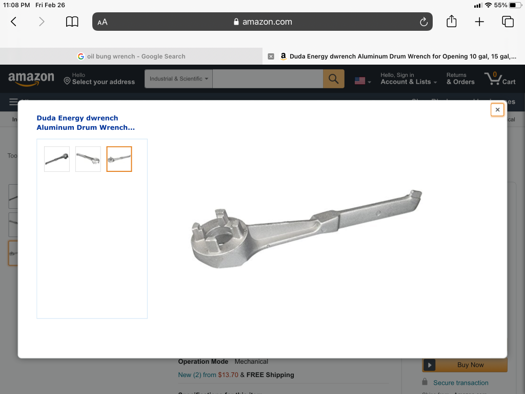

What does a wrench used to remove caps from an oil barrel look like?

He posted today, it is like 4th one up. Guessing not as he is asking what a bung wrench looks like. Sorry but that cap would have been off 3 weeks ago if were mine. Maybe it has been in the car for over 60 years but at a point somethings need to be replaced like paint. If it does not screw out now, it isn't going to screw back in later.

Post by BobShirleyAtlantaTx » Sat Feb 27, 2021 12:10 am
Oil drum bung wrench.

Post by BLB27 » Tue Mar 23, 2021 11:11 pm
I got it off!!
I applied "Yield" to it. My grandson and I each used a punch and hammer on the wings and hit at the same time.
