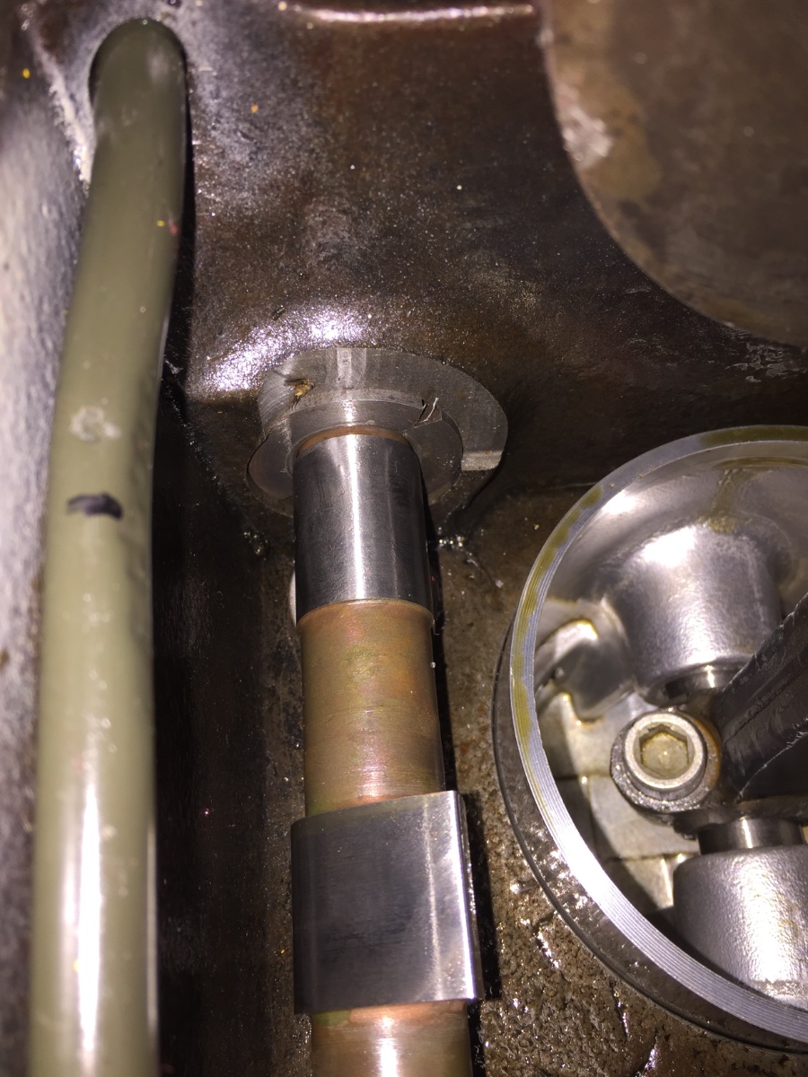

If you are talking about the shrink and pin on “truck” counterweights, those increase the “major diameter” of the crank and may require additional efforts

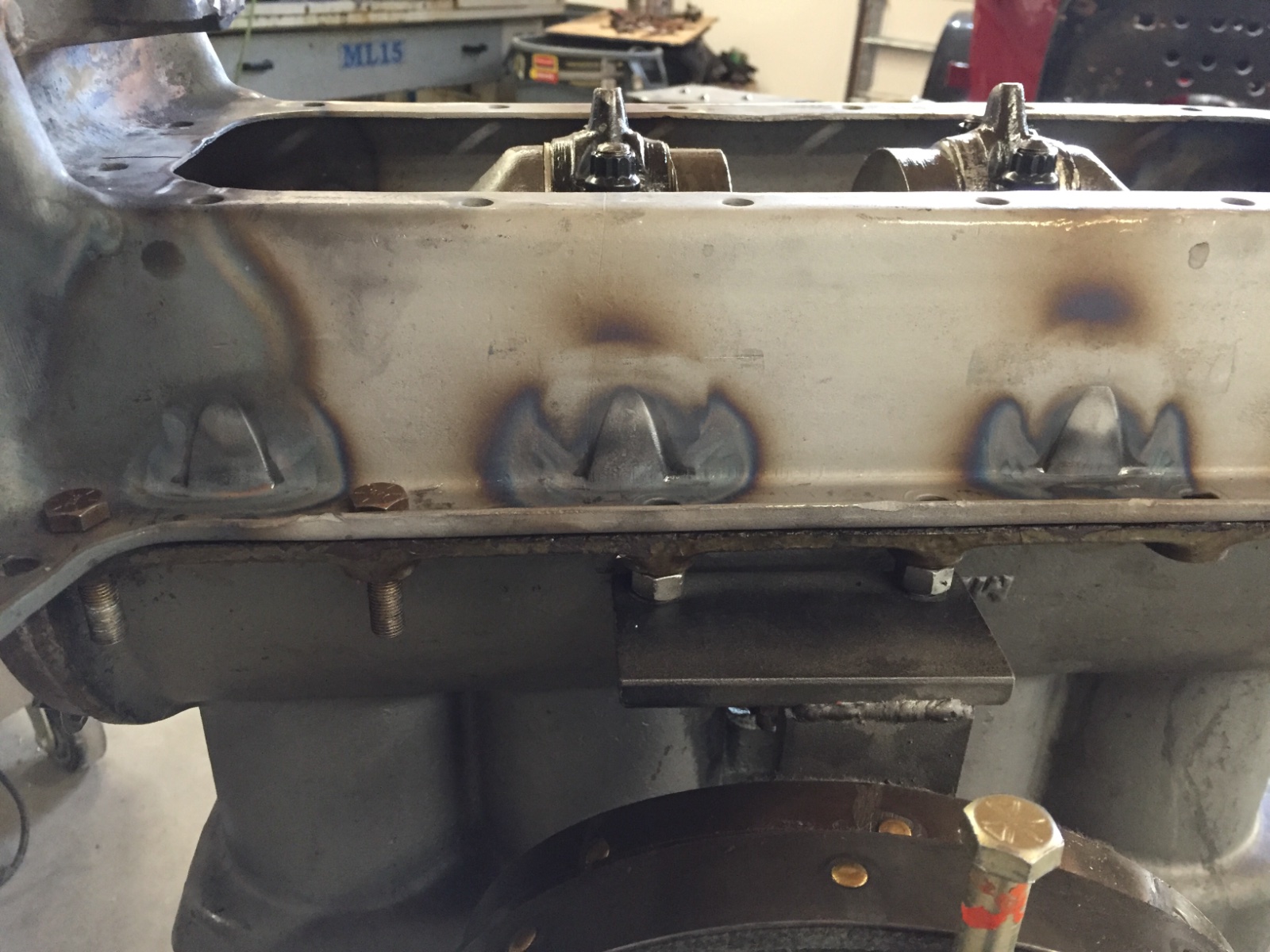

Block mods are mostly just boring out the main journals, trimming the main journal lengths, and sometimes grinding down the front cam bearing boss to clear the crank. The pan gets a bit of work too. I’m putting one together now, will get some pics tonite

Further to the original question, no block or pan modifications were needed for the counterweights. The usual pan denting for the rod bolts with a stroker crank (which I believe even the Scat stoker requires)

Thanks for the responses, Les, have you installed A cranks without counter weights as well as ones with? Was the benefit of the weights worth it? Just curious. Kevin, if you have any pictures of the crank in the block to show the clearances from weights to camshaft boss please share. Thanks Brian

Kevin Pharis
- Posts: 1642
- First Name: Kevin
- Last Name: Pharis
- Location: Sacramento CA
Re: A crank T bock with counter weights
Here is a pic of the front cam bearing in the motor I’m working on now. Boss was clearanced with a long endmill. Doesn’t take much, maybe an 1/8” or so
