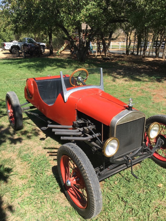

Has anyone figured out how to put dual carbs on a t? You obviously would need a special intake manifold.

Just curious - Is the engine in the OP modified? I don't see what would be gained by adding another carburetor to a stock T engine (except a complicated carburetor linkage, two mixture rods, and a PITA to keep the mixture adjusted properly). Aggravation equals the square of the number of parts in the assembly. I have never heard anyone suggest that a stock T engine is undercarbureted.

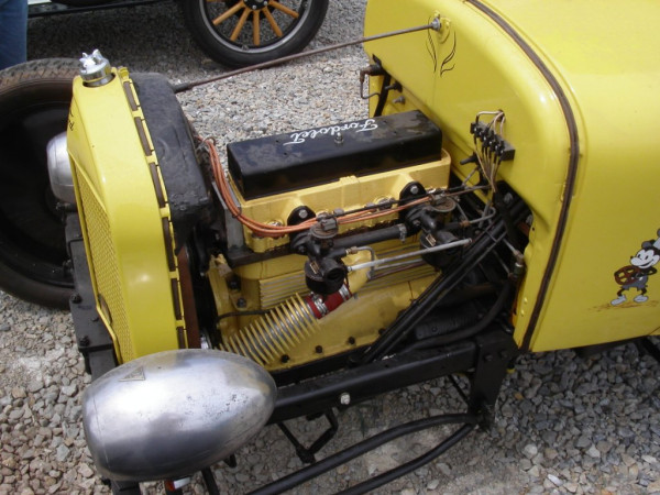

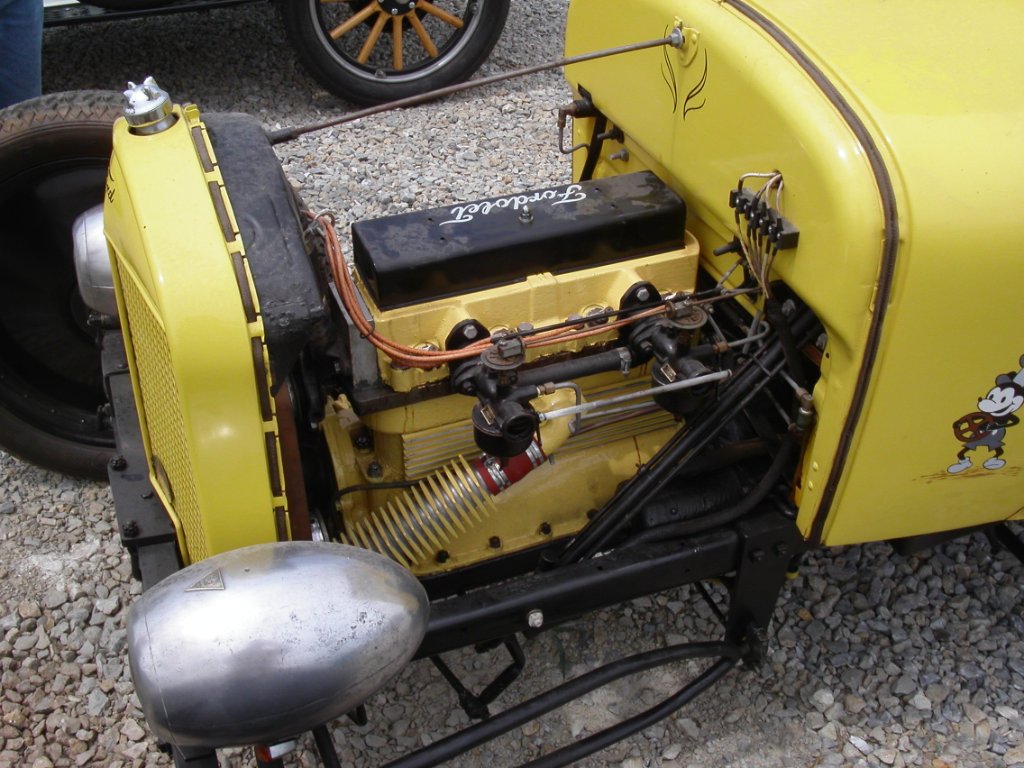

Here is a dual NH setup.

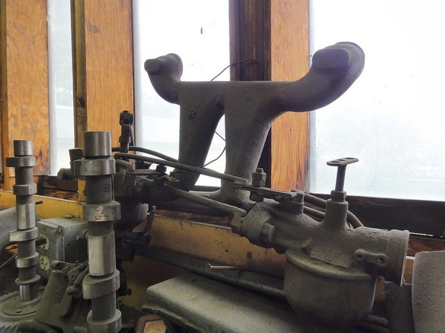

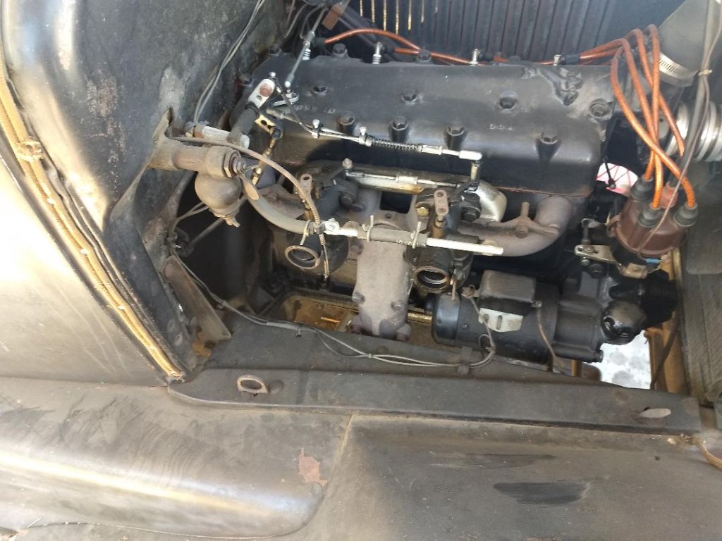

I built a dual nh side draft unit for my 27 roadster p.u. WHY? -i wanted more carburation than stock, period correct, NO FUEL PUMP, different look.i could not find pix of anything like it. so i invented one, and it had to fit under the full hood. Uses 27 vaporizer exhaust manifold capped. exh runs out thru center vaporizer plate and down. intake is made of 2 stock intake manifolds.one manifold has elbo section cut off to log. spine of removed piece was cut to fill the opening & brazed in. looks like a winfield up draft manifold without intake spigot. 2 carb flanges are mounted just inboard of intake ports. unit mounts upside down like that winfield manifold in downdraft congiguration. throttle arms linked & syncronized.
only weird thing - a little fuel slops out carb bowl breathers in a hard left turn.
Performance - had it to 70, feels like it would go faster. ran out of open freeway & i could feel my soul starting to leave my body. loves crusing 60 all day.
of course, motor has distributor, cam, hi compression head (6.5-1 lizzard), big valves, porting, rux with 308 gears, full balance engine & trans.
This carb setup lacks the kind of performance snap a previous version ran with a vw carb. less snap may add longjevity. but, no fuel pump & way cooler.
Before the nay sayers start churping: the front end & steering are restored, tight, front axle has more rake. runs straight arrow at speed.
(before addressing the front end, she had a mind of her own @ 60.)
A few of the o.c. club drove up to the national tour above frisco. this was the only one to make it up & back. not even a band adjustment.

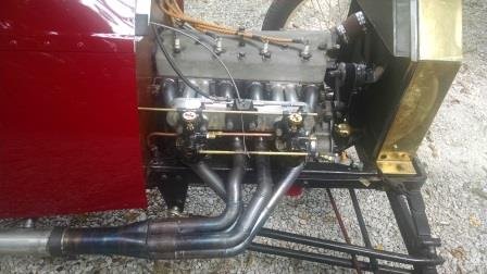

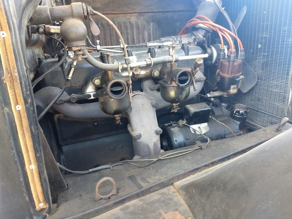

Here is my setup with two straight through NH's. Inlet ports have been modified to give 4 intake ports.

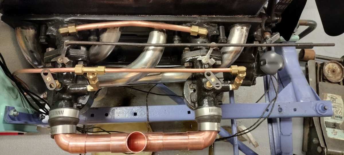

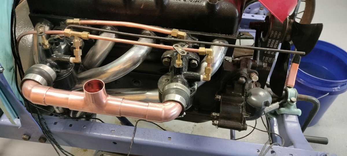

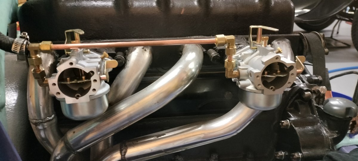

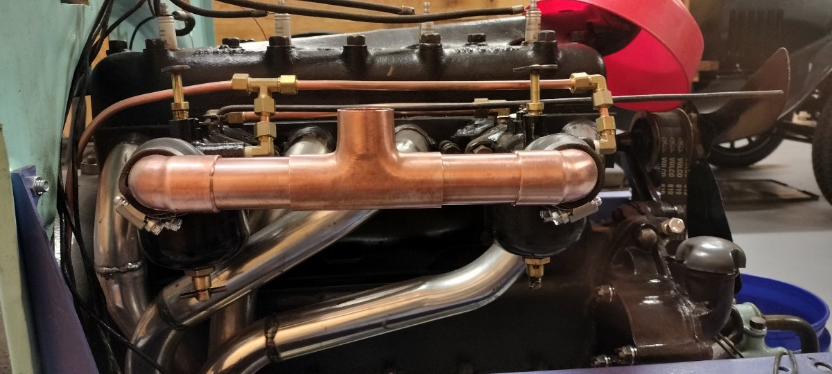

I know this thread is old but I though I'd post my setup on here too. finding info on dual carb setups is a bit challenging and finding pictures is even harder. Mine is stock except the custom header and plate. I cut off a couple flanges off some intakes i had laying around and welded them to the plate. I have dual NH's as well. they run pretty good but not a whole lot of tuning going on there! I couldn't get enough velocity to pull fuel in without making a tube for the air to pass though. I'm curious how to be able to get it work without the tube. nothing i have tried seems to give me enough air flow. maybe it's because i have the carbs so close to the intake ports. but none the less here are some pics. I half wonder if that equalizer tube is actually causing issue. if it's pulling air from there instead of the end of the carb i'd lose some velocity. if i moved it to the front it may change it enough to let it run. any ideas would be welcome. i'd love to get rid of that tube in front.
Chad_Marcheese
- Posts: 257
- Joined: Tue Jan 15, 2019 6:06 am
- First Name: Chad
- Last Name: Marcheese
- * REQUIRED* Type and Year of Model Ts owned: 1925 Cut Off Touring / Pickup, 1923 Speedster Gow Job
- Location: Upstate, NY
Re: Dual carb?
Your balance tube between the intake stubs needs to be bigger. That much I can say, and you need to make it a minimum of approximately 5/8- 3/4 of your intake stub size.
So if your intake port is 1.25", your balance tube needs to be about 7/8" to 1" OD exhaust (or copper) tubing---I use that because it is thin wall. If you do that, you can probably get that setup to work well. I have seen where intakes are made with the same size tubing for the intake stubs and crossover, that's fine too. It just can't be tiny like the small copper tube you have now.

Adding a higher compression head with better combustion chamber design is probably the most cost-effective power modification you can make to a stock T engine, assuming you have an engine/transmission in good condition with aluminum pistons and in good balance. It's very important that the ignition system be functioning at 100%. Most stock T ignition systems aren't. Adding another carburetor to an otherwise stock engine could be expected to degrade performance and driveability. If you want a fast T, over 50 MPH, you need a better crankshaft to allow the engine to run safely at higher speeds and not waste HP shaking the car and rattling your dentures. Beyond that, for a road-driven car, a Model A intake/exhaust and properly selected camshaft, valves, and valve springs might be the best path forward. Attention would need to be given to maximizing oiling and cooling.
- Posts: 6710
Re: Dual carb?
I applaud the creativity involved, but that is way too much carb and way too little pressure drop to run things with a stock engine.
If you're looking for "cool", you've got it. If you're looking for "GO" then find yourself a Zenith S4BF, Stromberg OF, or a U&J, then sit back and smile (yes there are other great carbs, but the 3 I mentioned are not too terribly hard to procure if you make an effort). The OF will mount directly on a FORD manifold, while the other two will require the correct matched manifold that came with them, making the OF probably the most economical choice overall.

Did you say your motor is otherwise stock? If thats the case, 2 nh's are of no advantage. Too Low velocity until you get over 4000 rpm. Which you will not achieve until after the explosion. You are over carbureted.matthewejacob wrote: ↑Sun Aug 21, 2022 12:40 amI know this thread is old but I though I'd post my setup on here too. finding info on dual carb setups is a bit challenging and finding pictures is even harder. Mine is stock except the custom header and plate. I cut off a couple flanges off some intakes i had laying around and welded them to the plate. I have dual NH's as well. they run pretty good but not a whole lot of tuning going on there! I couldn't get enough velocity to pull fuel in without making a tube for the air to pass though. I'm curious how to be able to get it work without the tube. nothing i have tried seems to give me enough air flow. maybe it's because i have the carbs so close to the intake ports. but none the less here are some pics. I half wonder if that equalizer tube is actually causing issue. if it's pulling air from there instead of the end of the carb i'd lose some velocity. if i moved it to the front it may change it enough to let it run. any ideas would be welcome. i'd love to get rid of that tube in front.
To run those carbs you need to match the engine to them. High compression head, big valves & a performance cam, & balance work.
I have some pix of my dual NH set up on another computer. Stay tuned, I will post tomorrow. I have been running for 15 plus years.
Previous to them I ran a 28pict VW carb. Plenty of carb on a T. The T performed much noticeably better. Accelerator pump!
I removed it to 1) get back to "period correct", 2) The VW needed an electric fuel pump that needed replacing every other year. (they only fail in the middle of a long drive) 3) The snappy acceleration concerned me regarding pinion key strain. (I know I dont have the self control.)
Previous to my build, I couldnt find any pix of dual side draft NH's, so I thought I would build one.
The intake is made of 2 stock iron manifolds.($4 worth of parts) 2 intake flanges brazed on & the open, cut off section filled with a chunk of the second manifold. Exhaust is a capped off vaporizer manifold with exhaust out the center plate via some odd adapter(may be a tractor or sleeve valve motor) The mount pattern is a match. 2" exhaust pipe. Fuel levels are matched & carbs synchronized. I have 2 long mixture adjusting rods to set the carbs for max performance on the fly thru the windshield.
The motor sports a high compression iron lizard head, big valves, 280 cam, 3.07 geared rux & a Scat crank.
The T is a 27 roadster pickup fully loaded. Chassis tuned for speed.
Performance: Less than the single VW carb. There is a gain in top speed over 1 NH. (Has the ability to breath) She will do better than 70 once I get thru the harmonic imbalance spot. The motor prefers mid to higher rpm ranges(Fuel velocity I suspect), but generally runs well in the whole speed range.
Truth be told, performance is a bit disappointing, but it is a heavy T, not a speedster.
Performance with a different carb(s) would be better, but it is period, different, "cool" & "sexy" when the hood is up.

- Posts: 5138
Re: Dual carb?
Pictures added of a dual nh set up.
Art M

Re: Dual carb?
Speedy,
Your engine looks very impressive. I wonder if a 290 cam would significantly improve performance. Not trying to re engineer your details. Just wondering about 290. Maybe there is a reason that I don't know anyone who has one.
Art Mirtes
Art Mirtes
- Posts: 5138
Re: Dual carb?
Thanks Art
This motor has been an experimental exercise. As far as a 290 cam goes, if there was some different overlap/duration difference other than just .010 more lift, there might be some improvement. I dont know. It has a 280 with 1.75" intake valves. I figure flow volume wise I have a higher equivalent lift. maybe .310-.320. Was advanced 1/2 tooth until the cam gear broke. The next change, I may try advancing 1 full tooth, If those smarter than I think that it would run better. Cams are a magical mystery to me.

Re: Dual carb?
Wow, didn't think i'd revive this old thread that much! Thanks for all the photos and comments. speedy, you are on the mark about the velocity. It dawned on me that I may have been losing vacume from that crossover pulling from the other intake and I went out there, removed it and it, plugged the ports and it fired right up. You are also right about the velocity at low rpms, I can't get it to "lope" real low like it did with that 1" copper but it idles low enough that it's acceptable for me. I'm not looking to build an actual racer, just though it would look neat with that set up. Money is always an issue and I'm trying to get it to a point where I can drive it, then start tinkering with the engine some more. I did put high compression pistons in my 25 depot hack and I've been really pleased with the results so I may either do that or get a high compression head for the speedster. (the head doesn't require me to crawl under it)
I'm glad to see a few more pictures on here of the setups. I think just letting it breath with the header and dual set up alone helped wake it up a little. It's way more responsive than a stock set up and i'm fairly content with it so far. But that may change once i drive it. I really wanted to get rid of that copper pipe, but... i may find that it just runs better on it who knows. I think the hardest thing about those NH's is that there just really isn't much fine tuning you can do with them. They love fuel and even the slightest adjustment on those mixture screws (especially with two of them) makes big changes.
I want to do a lot with it but baby steps. I have a body to build so right now my money is kind of being set aside to get that done but I needed to get it running first.

I think a crossover is needed, but as another poster said, it must be larger. It will at least make carb setting less critical. My setup has it.
Re read what I said about carb tuning. Fuel levels exact match,(plastic hoses from the drain valves for a visual level match) syncyonizer used to set both idle screw stops, & 2 long mixture adjusting rods to set on the fly for best performance. Set & forget.
I had a crazy thought regarding you doing this on a "stock" motor.
Back in the day holly & edlebrock made a tripple carb set up manifold for ford 6 log manifolds. I had one on the wife's 63 falcon 6. You could make all 3 run or not cut the front & rear holes into the manifold & just run the center carb only. Looks real cool.
Why not set up a tripple NH?? run the center carb only. The outers would be for show only. wouldnt that be uber extremely cool on a speedster??

Re: Dual carb?
ha. yes that would look really cool. I'll try and make some of those changes to see if i can fine tune it a bit more. It actually runs surprisingly well without the crossover. I'm like you, I thought it should be there as well. So i'll try to enlarge it and see if it makes a difference. problem is, once i do it, i can't go back! that was quite a bit of welding to get all that on there to start with. I wonder if I made sort of an H pipe to put in between the carb and the flange if that would do it or if it would look funny. not sure i have enough meat on those two flanges to cut out and inch hole in them. they are model a flanges at the header plate and model t flanges where the NHs are mounted and are welded together. I suppose i could just remake that whole thing as an H pipe and be done with it. it's just i'd have to cut those two flanges off and start over. or at least cut the model T flanges off and re-work that thing.
And Chad, thanks for pointing that out. I had no idea that it was to small. I'm gonna work on this weekend and see how I fair. I'll update once i get it going.

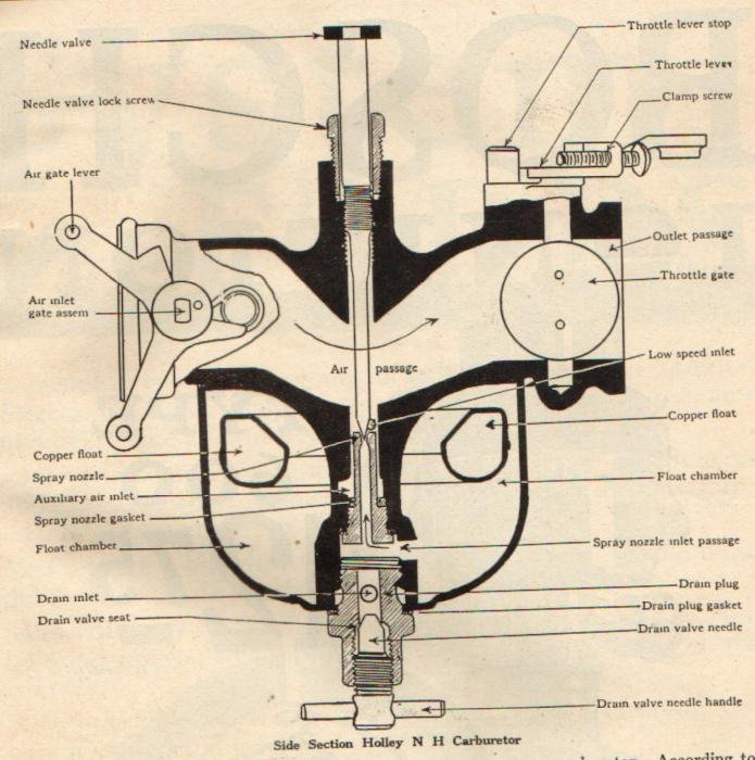

Matthew, far be it from me to tell anyone what the definition of "fun" is, but there are some easily researched basics regarding carburetion which you are not taking advantage of.
The NH does not have an idle circuit beyond that of a primitive bubbler with no air control. The NH has a fixed venturi which cannot be tuned to the displacement of the engine, and believe me, there are some pretty hard rules governed by physics which are not working in your best interest.
Back when these cars were made, Zenith (for example) made a number of carbs which were generally dimensioned at the throat in around 4 different sizes depending on the vehicle's displacement. From there, each of those 4 different (throat sized) carbs were further broken down by a somewhat inflexible progressive venturi calculation (called the "choke" in the 1920's) based on the stroke and diameter of the pistons (and the "breathing" of the engine through the valves was calculated/designed by the auto manufacturer). The choice(s) of slow speed jets was by factory "suggestion" and had to be fine tuned to the car/cam. You have no such venturi or idle adjustments with an NH.
The venturi of the NH is proportioned to the swept volume of the "T". Adding another NH without reducing the size of BOTH venturis will create a car which will run better (if you're lucky) at very high speeds but tend to be a pisser at low RPMs (so, let's add yet a third NH?). Believe me or not when I say that CFM through the carb is NOT the determining factor for performance, but it is definitely true.
like I said, if piddling with these things is your thing, go for it, but I can't think of a much worse carb to start with, given it's design limitations. There were some really cool, beautiful, and importantly, POTENT accessory carbs made for "T"s which will make the thing really rock, with a good head and cam.

Scott, I understand what you are saying. I was just trying to keep it period correct looking, I may forgo that with the NH's for reasons you were stating. they are just very crude carburetors. I'll say more about this further in. Yes, it screams at higher RPMs, sounds great. But lower rpms its pretty doggish.
So a few more thoughts, tonight I made the crossover pipe almost an inch in diameter. had no effect. still won't pull in fuel. it may just be the limitations of the NH. can't get enough air across to pull fuel in. so... my thought is this. I want it to run well, not JUST be pretty. I want that too, but you can't always have your cake and eat it too.
I have two brand new walbro carbs. they are just kohler twin cylinder carbs. they are similar to the carbs mac's sold a while back that are no longer available. just looks like they've had minor updates. those things have a low and a high adjustment, much more fine tunable. and they are made to bolt directly to the head so velocity, theoretically, should not be an issue. I found one guy that has done this. still looks cool, but you can tell they are modern carbs. I may go this route, in fact, i'm gonna try it just to see how it behaves.
The thing will run fine without the crossover, it's just much harder to adjust them and get them in sync, if that's really possible with and NH. i either have the front two cylinders richer than the back two or visa versa. it's just kind of a cat and mouse game. I love the way it looks, but I just don't think the trade off is worth it.
It's eventually going to get a new high compression head but there is so much other stuff i need to do first. I'm curious about pistons vs head. my 25 has HC pistons. it runs well, but honestly i often wonder if i made the right call. my grandpa's has a scat crank. and that made a world of difference. it's smooth, it pulls up hills nicely. just really transformed the car. I'm eventually putting one of those in the speedster. the hack doesn't really NEED it. I can only afford to make that purchase once. but all that is down the road. I understand on a stock motor dual carbs are more eye candy than anything else. But it will look good!
you guys have all been a great help. I don't know what we would do with these forums. I've solved many a problems on here. just the first time i've actually posted. I'll keep coming back here to post the progress just so it's noted somewhere for others to stumble on.

The Model A had a sort of rams's horn intake with a single carburetor. They worked well for low speed torque. Would a split rams' horn arrangment work better for a performance engine? Instead of a single, shared riser, have separate "horns" for each port, and 2 carburetors close together on separate risers, with the diameter and length of each horn and riser tuned to suit the engine?

Re: Dual carb?
had a chance to put the new carbs on. world of difference and it runs with the crossover tube on it now. much more tunable. I have to get my radiator fixed so i can run it long enough to tune it. that's another issue. its a honeycomb rad from the 1910's and no one around here seems to know how to fix it. has one small leak on the side. anyway, different issue. here is a pic of the set up now minus the tube. i have to make a proper one. this, i think is doable.
