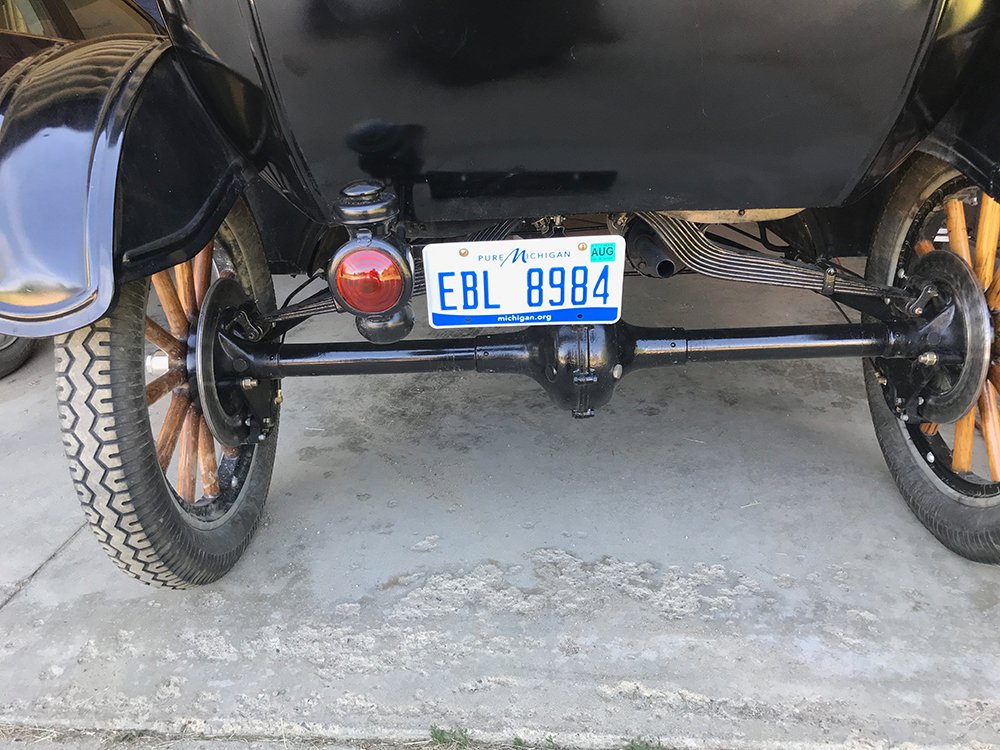

I installed disc brakes (and floating hubs) after an experience on the Covered Bridges tour in southern Indiana.  Without going into detail, I had experiences both going down a steep hill and climbing a steep hill where I   a.) almost didn't get it stopped in time to avoid a collision & b.) would not have been able to hold it from rolling backwards when the engine threatened to quit.
Driving with disc brakes is more like driving a modern car. With gentle pressure you'll slow down nicely and can ease it to a stop where you want it to stop. They work well when wet and are effective in reverse, unlike some other systems. By careful adjustment, you can leave the transmission brake as a backup in the unlikely event that the disc brakes fail.
One advantage of having a separate braking system is that you are not stressing the transmission brake drum on a steep, long descent. The disc brakes dissipate heat nicely and have never shown any tendency to fade. Me, I consider them to be one of the smartest additions I made to my Model T. What good is being able to go unless you're able to stop just as reliably.
Note: when someone points out the disc brakes on my Model T I just tell them that Henry was ahead of his time......

Jonah D'Avella
John W. Stoltz's Model T Ranch Brakes
They're hardly noticeable between the original brakes and John's...they're about as noticeable as the Rockers, yet work a lot better and a lot cleaner looking installation too!
									I'm running 3:1 in a stock rear axle...wouldn't mind having a Ruckstel though...just can't afford one. I also rarely drive my car over 35 mph and the modern Rockies only work going forward, not backwards. So forget them holding you on any hill...they wont! But those Model T Ranch brakes sure will, but then so will Larry Sidemore's AC brakes and the Original Rockies (which work totally different than Bud's version of them), they actually have 2 cam levers on them to adjust the both the forward braking and the reverse braking. I was suppose to draw them for Larry "Original" Smith, but the drive I had all the pictures on was destroyed in the Creek Fire a few years back, so I've been slowly reacquiring what I've lost in an effort to fulfill my promise to Larry and draw those Rockies of his (much better set up than Bud's Rockies, I especially like the cable and pulley equalizer, always pulls even, none of that screwing around with rods and clevis pins nonsense).What size rear end did you have?
Fun never quits!
