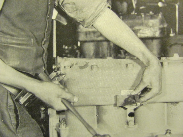

- Posts: 4087
Re: Stamping a new serial on a blank engine block.
Factory stamps varied, but some are fairly nice, on this photo the skilled stamper is using a metal guide, for a very important engine, all other stamping was free hand, typically with a skilled worker on that task.
Here is the dedicated stamping worker in 1915, one view shows his box containing metal numeral stamps, and the other shows the same worker stamping the numbers on the block. Likely chosen for ability to hit the hammer blow correctly for a deep stamp that is placed best he can.
Ford Service, showing wood box of stamps. Have done blocks with Harbor Freight 1/4" high numeral stamp set, works fine. You have to have a good hard swing, but the iron block takes the imprint OK. Just don't use numerals with serifs on the ends, as those are old time looking, but Ford didn't use that font style on T serial stamps.

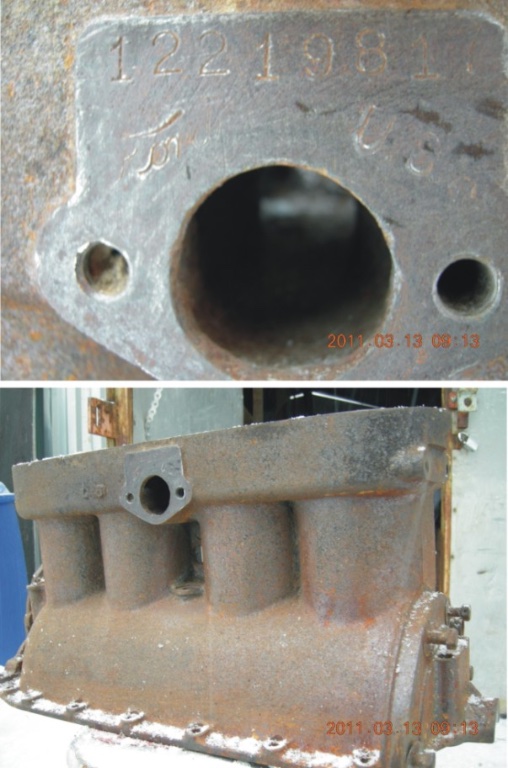

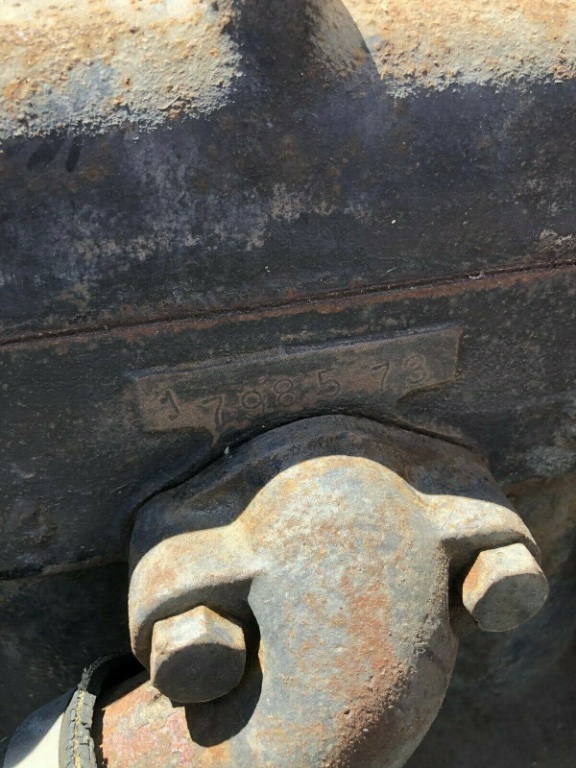

not straight and a double strike

That is an UNUSUAL number stamping set in that Ford Service bulletin...
- Posts: 4087

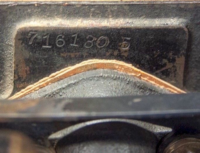

I used to have an engine wth an upside down 4.

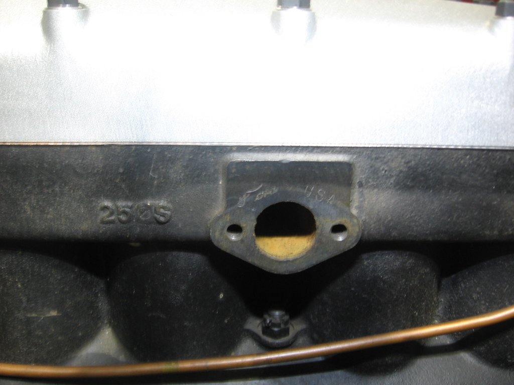

It's too bad someone altered the casting date on the '16 block Steve posted... you can see the weird shape of the "6" turned into a "5"... At least they didn't mess with the serial number, but I'm not sure how one could change it back to a "6" easily... It also shows the unusual "serifs" on Fords 1 and 2 from that era... finding those stamps might be a challenge!
Kerry
- Posts: 1463
- Last Name: van Ekeren
Susanne, I reckon it was an 8, the engine number pad is a give away too being the longer one.
Dropacent
- Posts: 3384
- Last Name: Morsher
- Location: Norwalk Ohio
My educated guess would be that isn’t a FORD stamped serial number

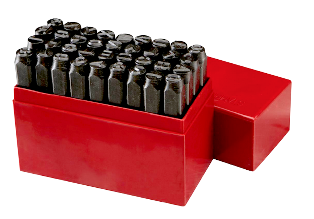

If you want to have perfectly aligned numbers, there are stamp holders similar to this one that would hold all the numbers perfectly in line.

There was an art to those replacement stampings.
RustyFords
- Posts: 1559
- First Name: Don
- Last Name: Allen
- Location: Houston, TX
Had to have been loud in there....none of them are wearing hearing protection.DanTreace wrote: ↑Sat Feb 06, 2021 10:26 amFactory stamps varied, but some are fairly nice, on this photo the skilled stamper is using a metal guide, for a very important engine, all other stamping was free hand, typically with a skilled worker on that task.

Just get a set of stamps. They do not need to be exact Ford repro stamps. If building up a car be sure to check to make sure number is good.
The reason to check the number is my 26 is registered with #14625. Obviously three digits missing. Took 3 tries to pick a good number. And FWIW, neither Washington, Oregon or Arizona cared that the number made no sense.
- Posts: 7411
The numeral 1 has both serifs on many engines, but in the service bulletin photo of the stamp set it has only the top one.

`You have to remember that blocks have a date code cast into them.
Don D
- Posts: 290
- Joined: Sun Jan 06, 2019 4:36 pm
- First Name: Don
- Last Name: Demio
- * REQUIRED* Type and Year of Model Ts owned: 1919 T
- Location: Tennessee
FYI, here are several photos of an unstamped Model T block with a mold mark of 25 S and the Ford script and USA in the area partially covered by the lower water inlet. If you can look closely you may be able to see the boss machining marks that come down and arc to the left.
- Posts: 4087
Dom
That script just confirmed to the buyer, it was a genuine Ford block, ready to be assembled by the dealer shop or another repair shop back then.
Ford must have figured that was needed to guarantee the buyer.
There were ''spurious" parts out there by golly.
Or perhaps these blocks were the ones sold to dealers, that came complete with most of the internals to assemble into a completer motor. At this time seems the factory could not ship out complete finished and serialized motors to dealers. So bare blocks with parts were sold.
Here is another with that Ford and USA, but with a serial number stamp. Since its an Improved Block, was stamped with Ford, as even the later cylinder heads didn't have Ford script on top!

My recently acquired '26 frame is stamped, and I thought it interesting that both 8s are upside down. Apparently this happened frequently???

OK, What is the last stamp (letter/figure) in the red box? Is it the number 6 or 9 or is it a . (dot)....N.....
Don D
- Posts: 290
- First Name: Don
- Last Name: Demio
The far left stamp in the red box is an &. The ampersand is also known as the and sign.
- Posts: 7287
The red box has 9 rows of 4 stamps = 36, 26 letters, 9 numbers and the ampersand = 36. I wonder if they are the same height as the original T numbers. My set are old style numbers, but there is no C stamp for the Canadian numbers. I found a Q stamp in a junk store and ground the pigtail off with my Dremel tool.
