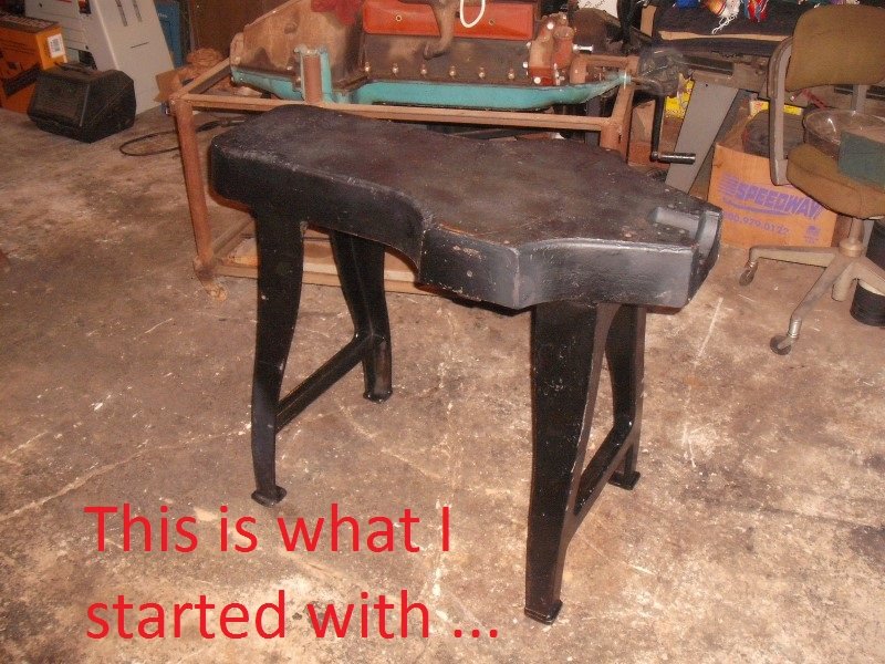

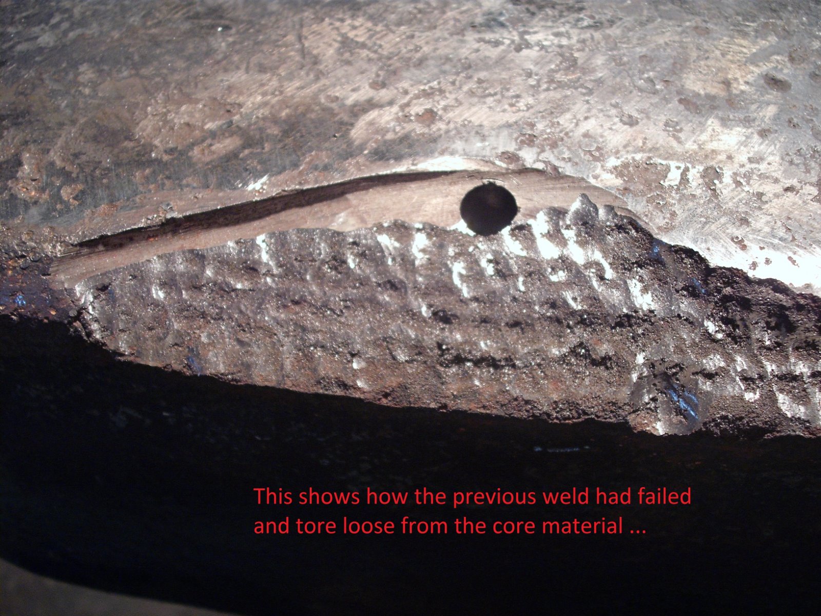

I have been working on repairing my KR Wilson pan jig. There were two places broken on the top of the table at a couple of the pin holes. My plan was to weld up the broken area and then re-drill the 5/16 hole for the locating pin. I found some speciality cast welding rods. The description said they were designed to weld oil soaked , dirty, heat affected cast iron. Since the iron in the pan jig appears to be high sulfur content to the steel and has not responded well to other rods, I thought this rod may work. So today I welded the broken chipped out area, and welded the hole shut. It welded great. I could not ask for the weld to go any better. So I ground down the weld and flattened out the table top area where I needed to re-drill the hole. It ground great. Next I located the hole and drilled a 1/16 inch pilot hole. It drilled OK. Next I drilled a 1/8 inch pilot hole, It destroyed the first bit, so I found a new bit and was able to drill a 1/8 inch hole. I tried to go to a 5/32 drill and no luck so I tried a 3/16 and no luck. I have destroyed all my bits. After looking again at the welding rod package the name of the rod is NOMACAST and in the fine print it says "non-machinable cast iron" OOPs now is a good time for me to read the fine print.... It is also a hardness rating of RC 39. I really hate to grind the weld back out and start over with another type of rod. The iron in the pan jig is a "rotten, high sulfur, core" with a "hard surface" overlay on the top 1/8 to 1/4 inch thickness. This thing is a bi%@# to weld. I have been welding over 30 years and this is the hardest thing I have ever tried to weld ... So today after finally getting a good weld, I can not drill the Da## thing ARagggggggggggg. OK Im done venting ...... Any suggestions as how to drill it ... If not I guess Ill grind the weld back out ...........................................................................

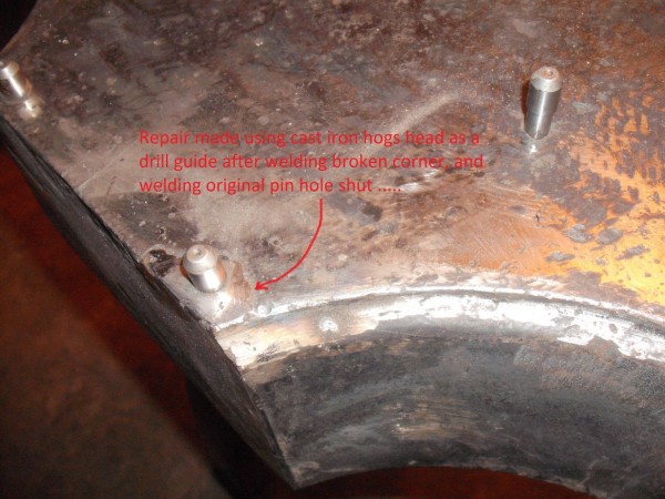

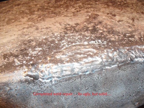

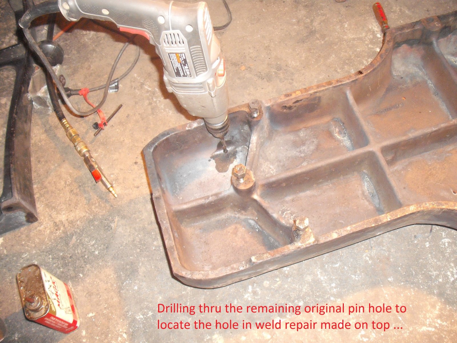

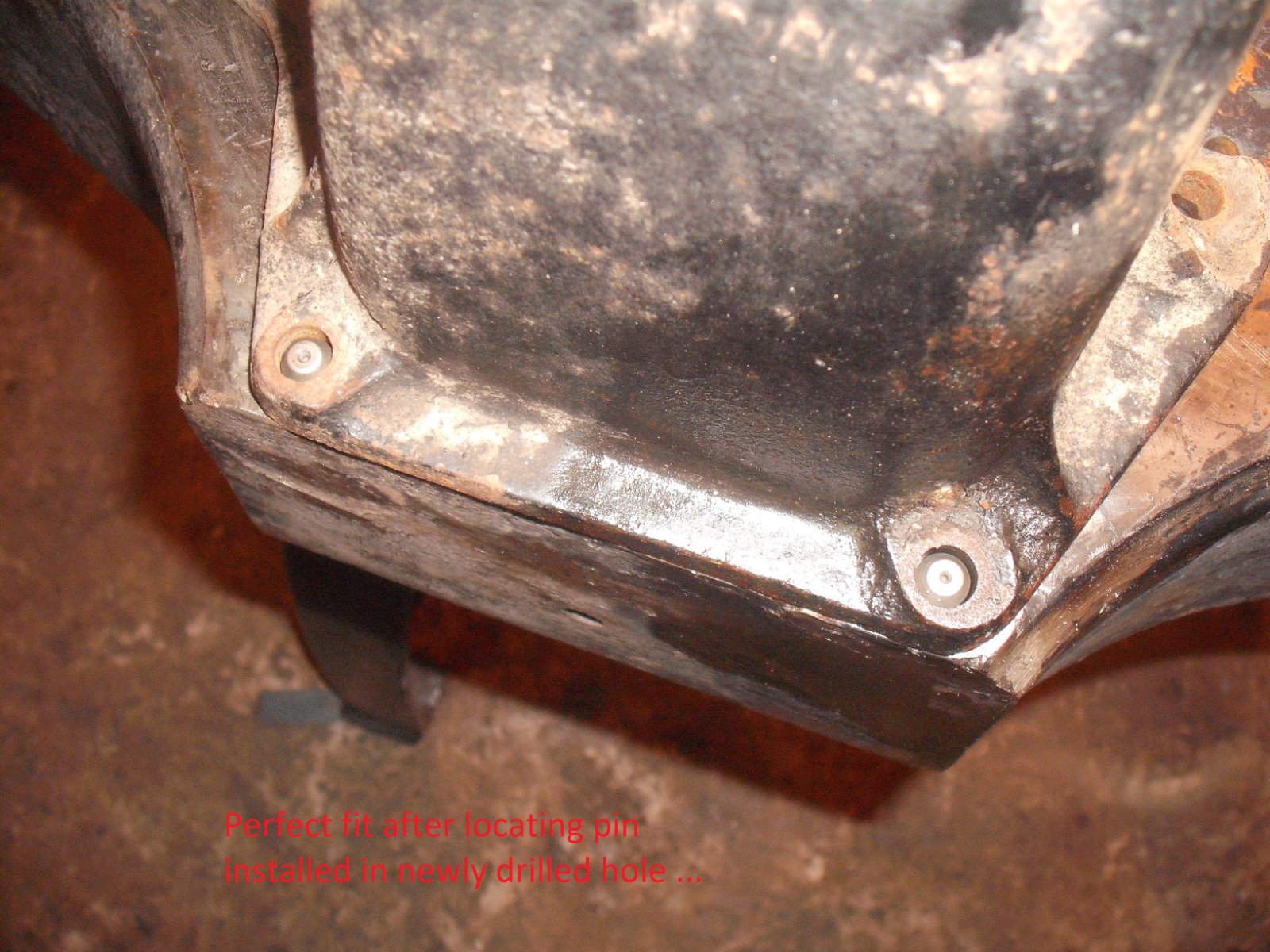

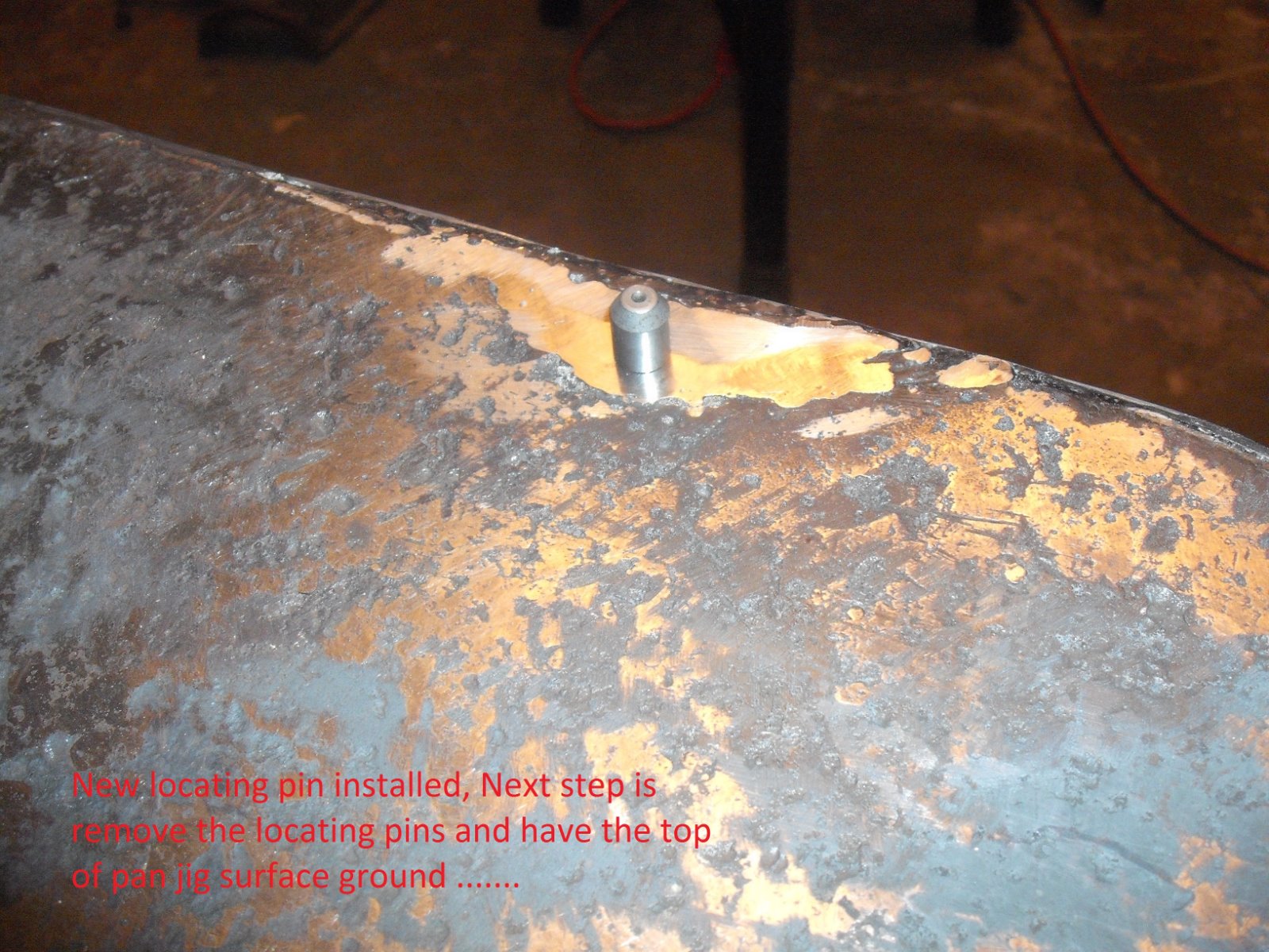

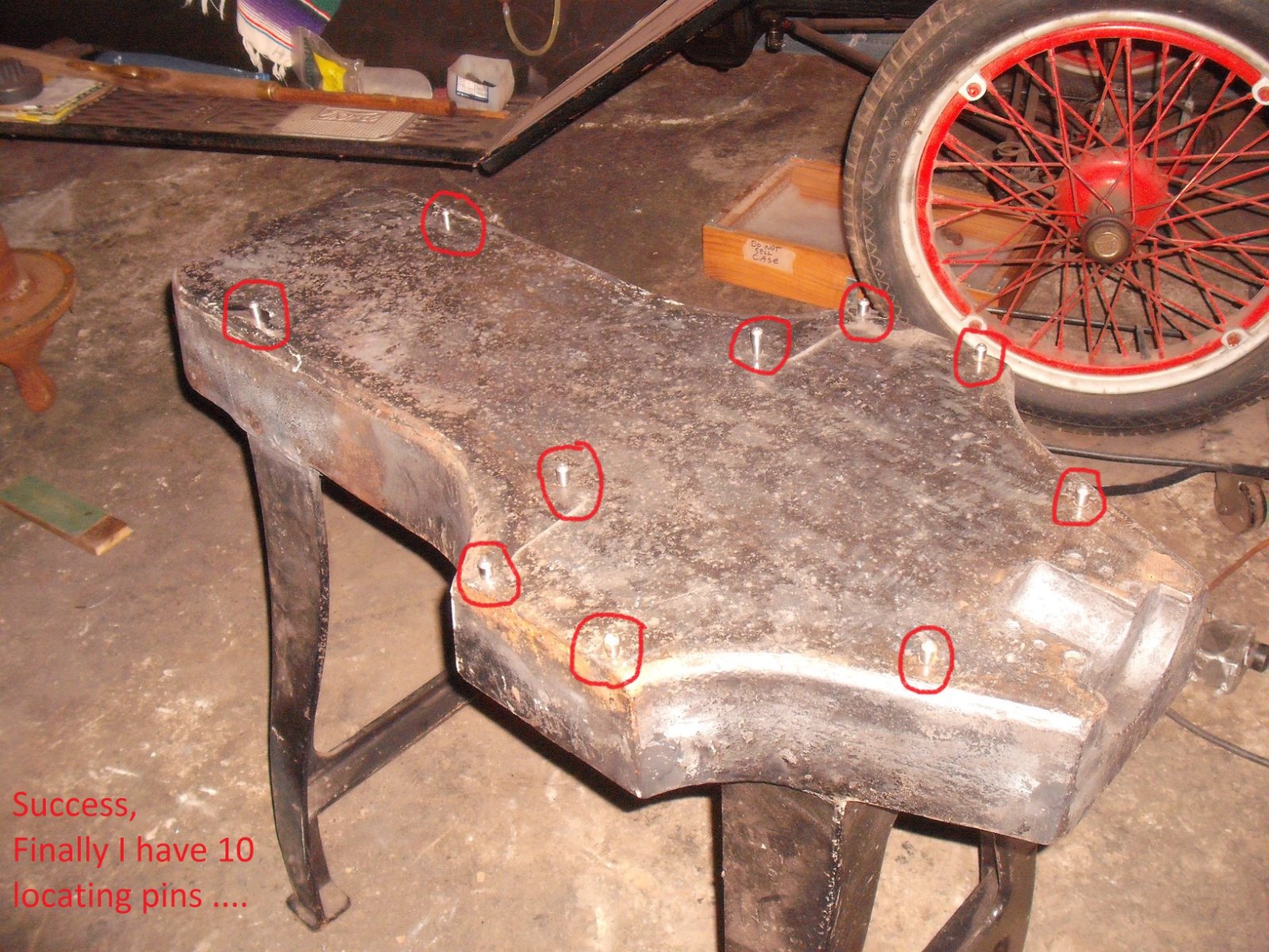

Success

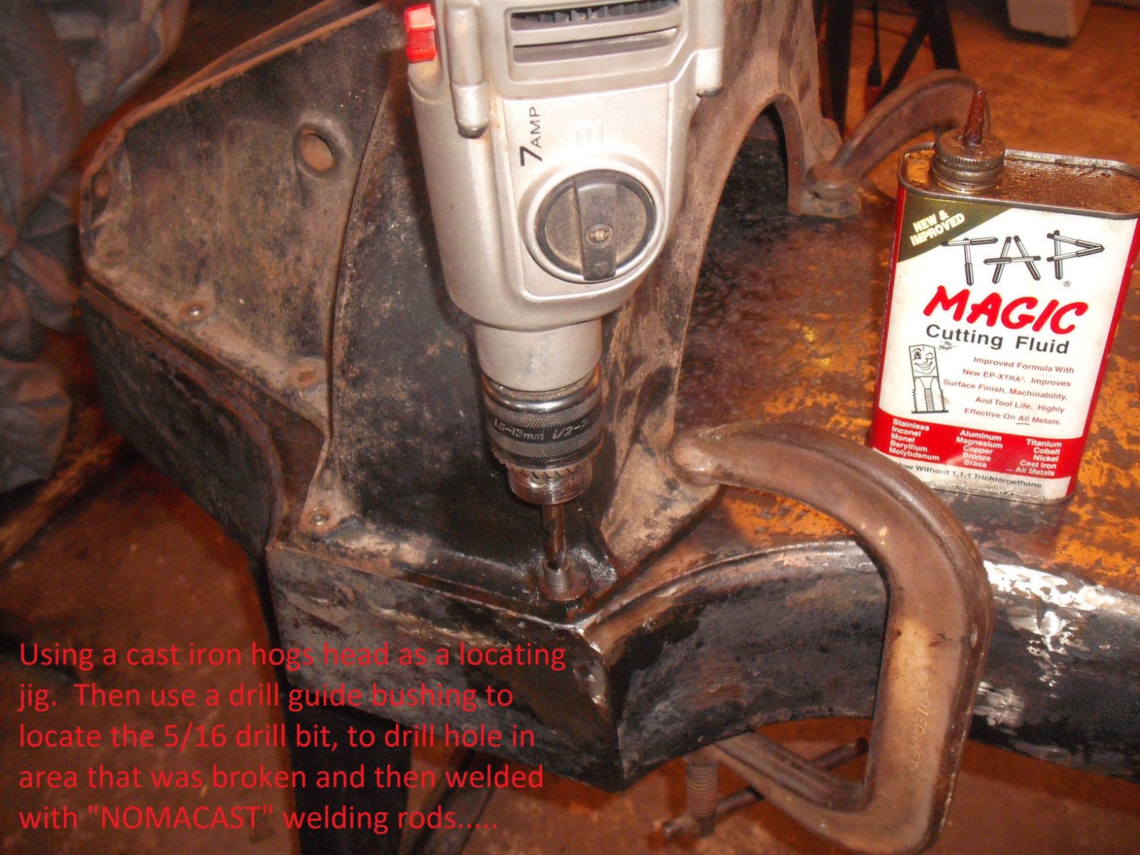

I found a 5/16 cobalt drill bit at tractor supply today. So I thought I would give it a try. I used the torch and did the best attempt at anneling the weld area as I could do with a torch. Then I used a cast iron hogs head located with 5 of the remaining pins, as a drill guide. I made a drill guide bushing to fit the hole in the hogs head and also fit the 5/16 drill bit ... With some cutting fluid in the hole and using a hand drill at a low RPM and as much down pressure as I could. I was able to drill the hole.
.... It was tough going and I was afraid of breaking the bit, but I had success.

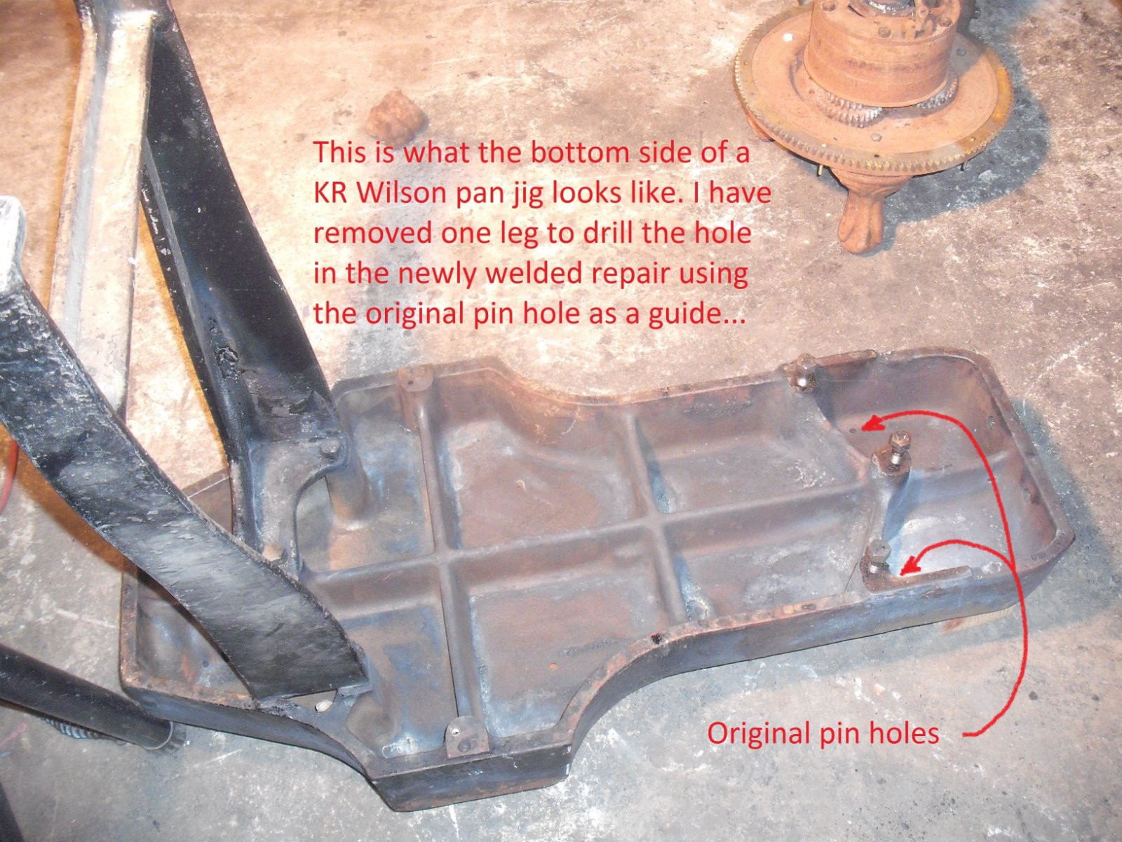

The second broken place that needed welded was one of the front holes. So I had no good way to locate it from the top, but that hole went all the way thru the table. So by removing one leg I could use the remaining part of the hole as a drill guide from the bottom. I really did not want to go thru the hard as he## drilling again. So I decided to call the people at Weld Tech. They were the folks I used to work with on the big construction projects when I was still working as a Boilermaker. I was hoping someone would remember me, and I could use an "old favor" . Well one of the younger ladies that was starting to work for them, about the time I retired was still there. We had a nice talk, and then I gave her all the details about my "problem child weld" About a hour later she e-mailed me a full "nuclear grade" weld procedure. Since I have high contaminated cast iron core I was correct with the choice of the NOMACAST rods, since it is designed for contaminated metal and dissimilar metals. I was to use the NOMACAST rods to "butter" the contaminated core cast iron with a "root" pass. I had to maintain a 750 degree pre-heat while welding, and peen the welds after each pass. Making sure to cover all the old metal as well as be sure to cover the tie in between the hard surface and the core cast iron with the NOMACAST. But do not get any of the NOMACAST in the 5/16 hole. Then continue building up the broken area with narrow stringer beads till all that was left to weld was a shallow depression with the 5/16 hole in the bottom of the depression. Then make sure a 5/16 drill bit will still fit in the hole. Then I could weld up the hole and the depression with either 55% or 95% nickel rods. They both would machine OK so I chose the 55% as it is harder than 99% nickel. After welding I needed to "step down" the pre heat from 750 degrees to 450 degrees over a two hour period. So with the wife (welders helper) operating the "rose bud" on the torch we reached temp in about 20 minutes. I made the weld while she checked the temp with "temp sticks" re-heating as needed. After about 30 minutes of welding I was done. Then I made sure everything was still at 750 degrees and wrapped the table top in insulation and my leather welding covers... With the insulation I only had to re-heat one time to achieve the step-down ... For folks who have not been around a "hot weld" 750 degrees is hot enough you can feel your face burning when you raise your hood. It will also burn you thru your clothes while welding if you get closer than a foot to the piece. It will burn you thru your gloves if you hand is against the piece for more than a few seconds ... 750 degrees is the limit for using temp sticks. This weld was the full extent of my abilities to do it at home ...... After cooling for about 4 hours I was able to drill out the pin hole from the bottom side. I had no problem drilling thru the 55% nickel.
Sorry for no pictures of the welding process, we were pretty busy at the time ....
When the Weld Tech lady asked me if I had "buttered" the weld zone, I felt like an idiot. I should have know that... That would be a common practice to do in a problem weld ... I guess I have been "retired" way too long .... But the pan jig now has 10 locating pins and is one step closer to working .......... Thanks for all the input, I needed the support ...... and a shoulder to cry on .....
