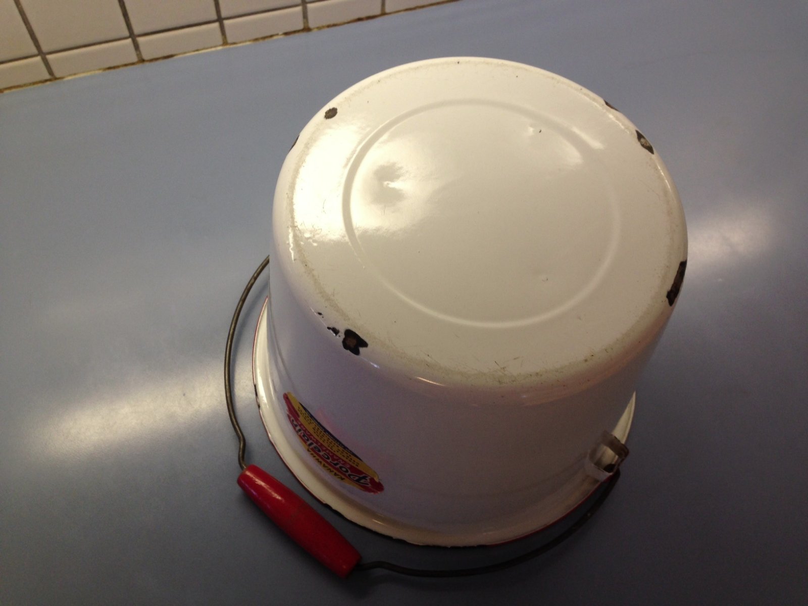

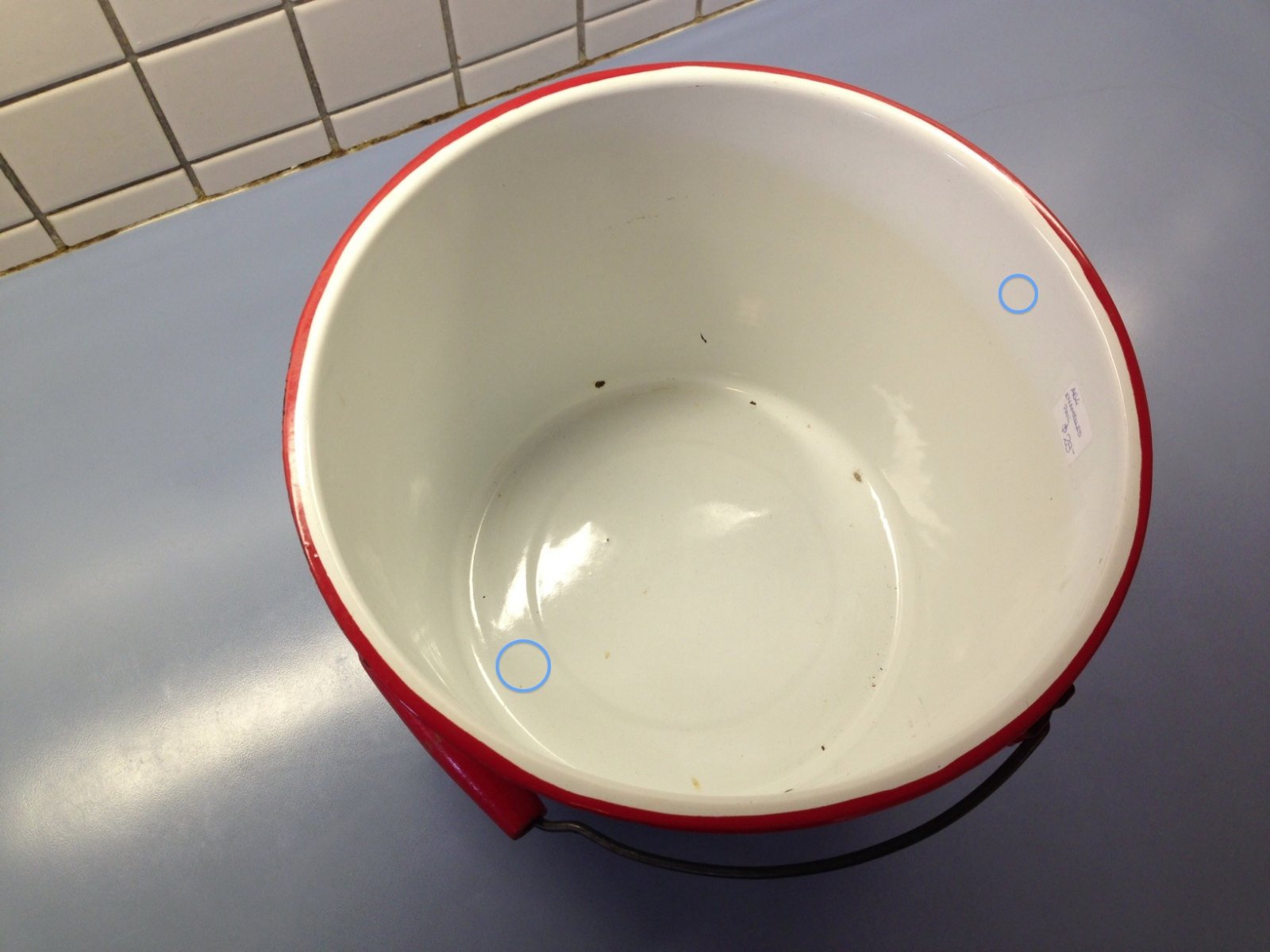

I need to drill two holes in this pail. One about 1" diameter in the bottom, and a second one about 1/2" diameter near the top.
I expect this coating will want to crack and/or chip — any suggestions for doing a neat job on this?

I have used porcelain bits in the past, starting small and going up. Easy does it kind of thing.
Still crankin old iron
- Posts: 5615
- First Name: Henry
- Last Name: Lee
Re: OT: How to drill a neat hole in an enameled pail?
Using a small grinding stone in the area to be drilled down to bare metal is the key. Take your time and she will come out great.

I use a diamond coated glass drill bit.You will want to run cooling water when using a glass drill bit.

Thanks all for your comments. I'm going to start with Henry's suggestion.

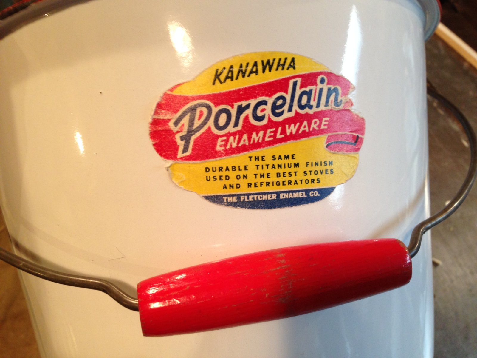

This pail is indeed in nice shape but may not be as old as it appears. The material is fairly light and the label has a newer look to it. A bit of online poking around suggests this piece dates back to the '50s. I combed a couple of antique malls yesterday looking for this sort of thing and was surprised how much enamelware is still around.
HI Rich — I need the look of porcelain and an intact inside coating for this project. I'll post some photos when complete (a month or two).Rich Bingham wrote: ↑Mon Mar 04, 2019 7:47 pmJust nosey . . . why do you want to drill holes in that pail ? Enamelled steel articles aren't easy to come by. Would something else do ?

I'd use a diamond coated bit as Daryl suggests. I've used them on similar things recently and they work well. Just keep a spray bottle of water handy and cool it regularly.
