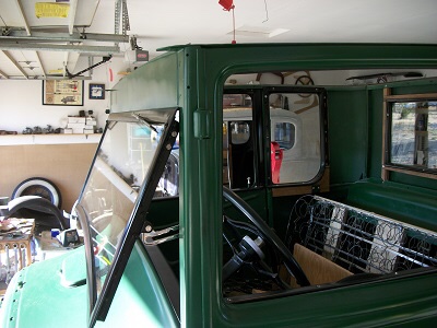

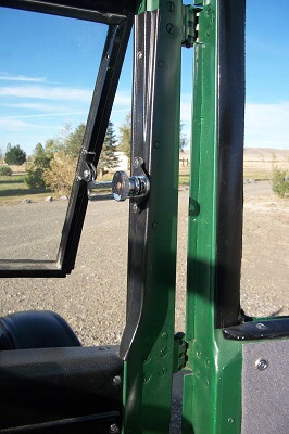

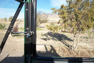

I will say this without seeing a picture. Even if the rot is like swiss cheese...as long as there is enough of the piece left to indicate the shape of the square tubing, it can be repaired with any number of incredibly hard epoxy putties available these days. I have had great success with “Aluminum Devcon” (mix ratio by volume: 4 parts grey putty to 1 part white catalyst), that I have been using for 50 years (Part number 10610, www.McMaster.com. Search box: “epoxy putty”). Once cured, it is as hard as steel and can be machined. I would saturate the rusted area with Ospho which will halt the rust and change it into a hard black inert stable substance. When the Ospho has cured, I would mix up a batch of Aluminum Devcon putty and start sculpting the tube by filling the square tube through the rust holes into the interior and, conforming it to the exterior sides of the tubing until it is smooth and assumes the same size of the original tubing. Just don’t fill the top part into which the pieces on each end of the top piece slide. That can be sculpted after the top has slid into place. With some practice and black paint, you will not be able to discern the repair. Jim Patrick
Photos courtesy of Harvey Cash from a 2015 thread:
