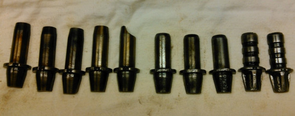

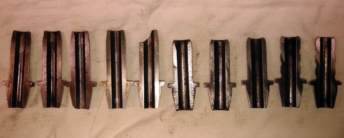

I just got these and cleaned them up. They came with some Model T parts. The internal measurement is 0.312 inches, standard size for a Model T valve stem. They are two piece with matched halves. The long ones are a little long and the short ones are a little short for the valve guide length in a Model T block. Looks like they would work for a Model T. How would a person install these in a block?

Yes Model A. Normally would have come as a matched pair. These look used. The longer ones would be standard length for Model A. The shorter ones after market of some type. I would just toss in scrap bucket, you can buy new ones.

Steven - Model T valve guides are one piece, and the straight stemmed T valves can be pulled right out of the solid one piece guides. Model A valves however, have a valve stem that is "mushroomed" at the bottom and would not be able to be pushed into or out of one piece guides like Model T straight stemmed valves and solid one-piece guides. That's how you can always tell Model A valve guides like yours because they are split in two halves. Pretty obvious I guess, but I don't think anybody mentioned that difference so thought I would,....FWIW,.....harold
