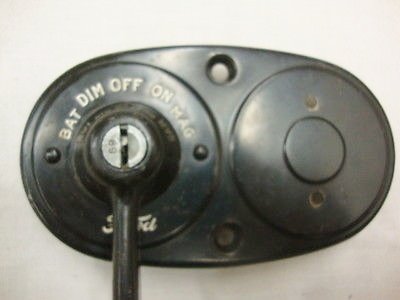

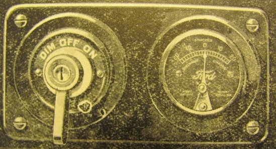

Painted white insert lettering on this early '19 version from print adv. Early switch had various styles of heavy cast plated handles

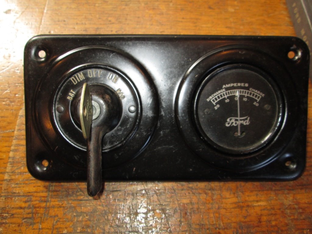

1926-27 style, NOS switch, non-starter version with headlamp dimmer behind the blank plate... showing factory white lettering
