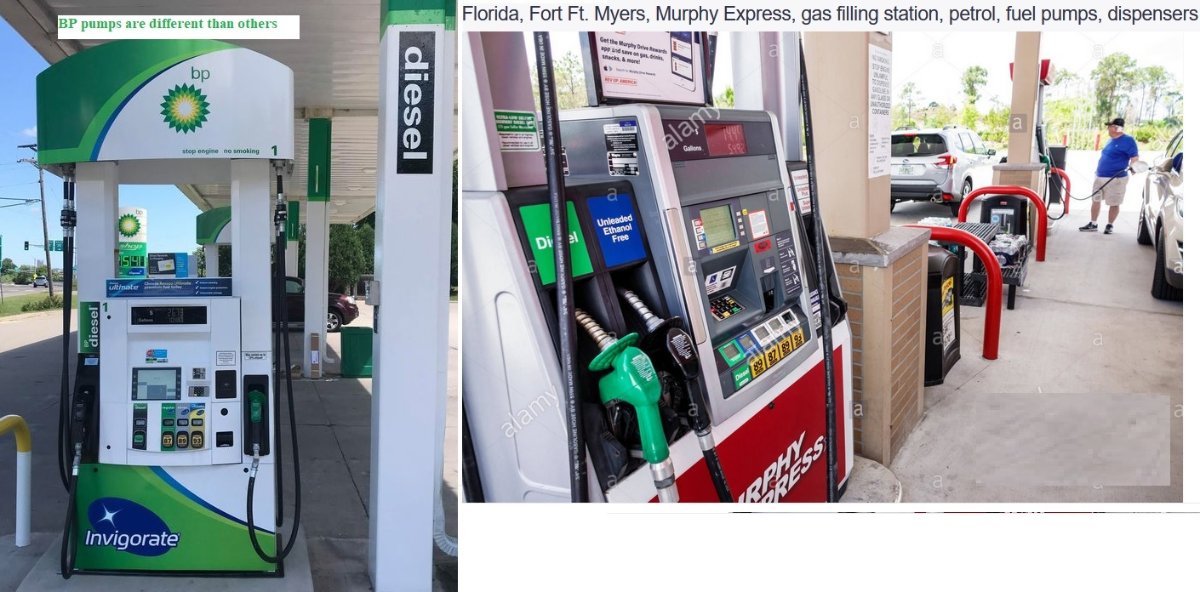

Gasoline is essentially a shared commodity, often stored in common containers until it is purchased by a major retailer. After that, the retailer treats the gas with a specific additive, thereby giving the fuel its brand identity. Top Tier gasoline was developed in 2004 to go beyond the minimum standard for detergent additives to better protect increasingly sophisticated engines from carbon buildup and deposits on the intake valves—which can result in a rough idle, ac
Top Tier Retailers
76, Aloha Petroleum, Amoco, ARCO, Beacon, BP, Breakaway, Break Time, Cenex, Chevron, CITGO, Conoco, Costco, CountryMark, Diamond Shamrock, Entec, Esso, Express Mart, Exxon, Fast Fuel, HFN, Hele, Holiday, Kwik Star, Irving, Kirkland Signature, Kwik Star, Kwik Trip, Marathon, Metro Petro, MFA, Mobil, Ohana Fuels, Phillips 66, PUMA, QT, Quik Trip, Road Ranger, Shamrock, Shell, Sinclair, Sunoco, SuperAmerica, SuperFuels, Texaco, Valero, Value America, Wow, and Win Win
Walmart doesn't sell TOP TIER gas. Available octane levels are regular, premium, and super. Walmart also sells diesel.
The gas company Walmart uses is Murphy USA. Murphy USA operates 1,474 (as of June 30, 2019) retail fueling stations in 26 US states. Over 1,100 sites are located near Walmart stores. As part of the company's new direction, more than 240 stations, also known as Murphy Express stores, are located independently.
NOT inferring that you pumped diesel just noticed the difference in the color of pump handles that BP uses. The use Green for Gas while others use Green for diesel
