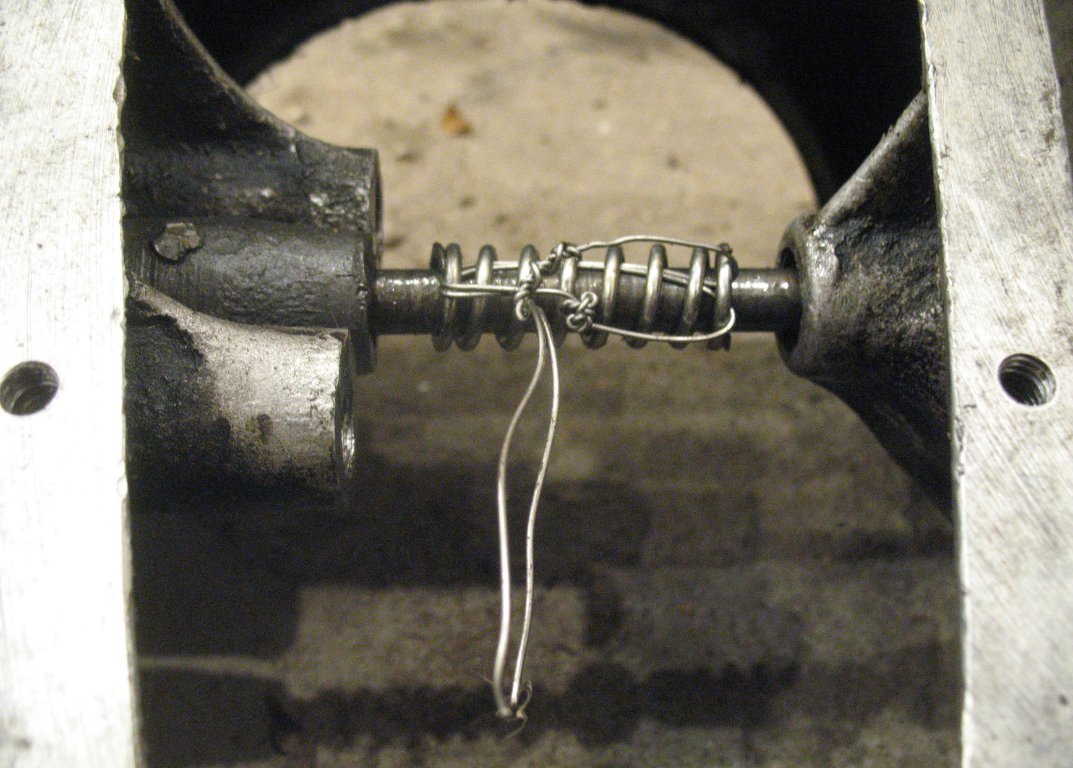

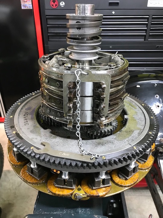

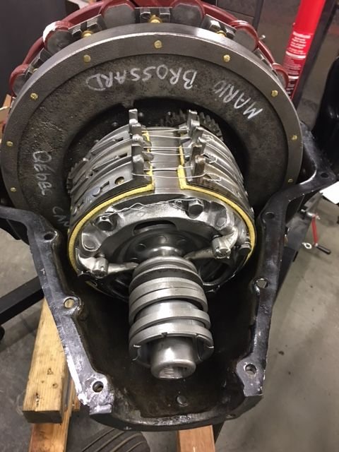

This is how I set up the bands. Is there a better (easier) way? Is the band clamp enough better to be worth the $13.50 + shipping?

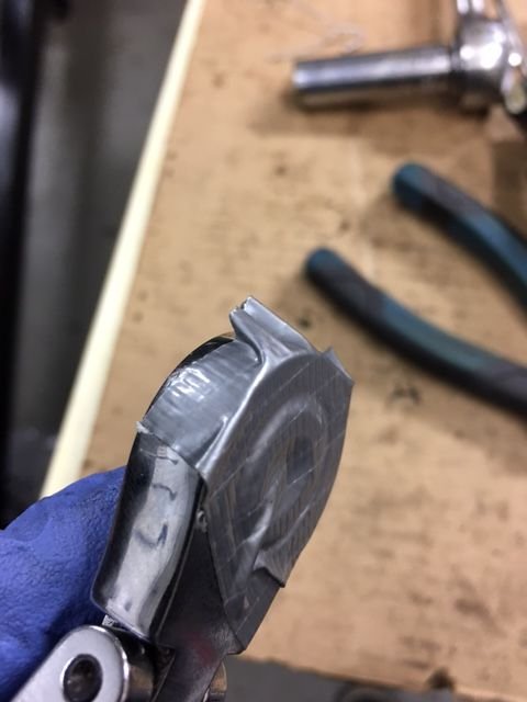

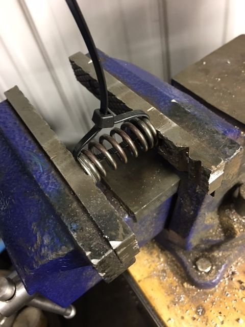

Same question here. Is there a better way to compress the low pedal spring?

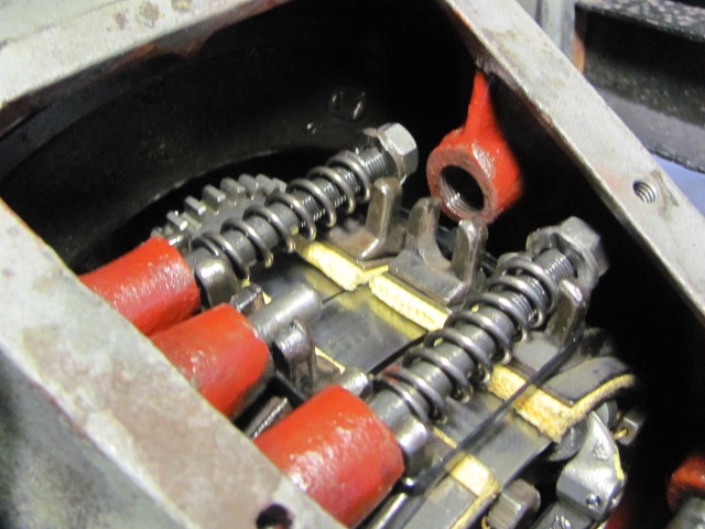

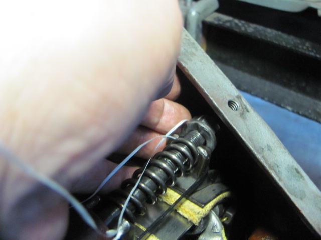

I have always used cotton string. Less concern about loosing bits!!

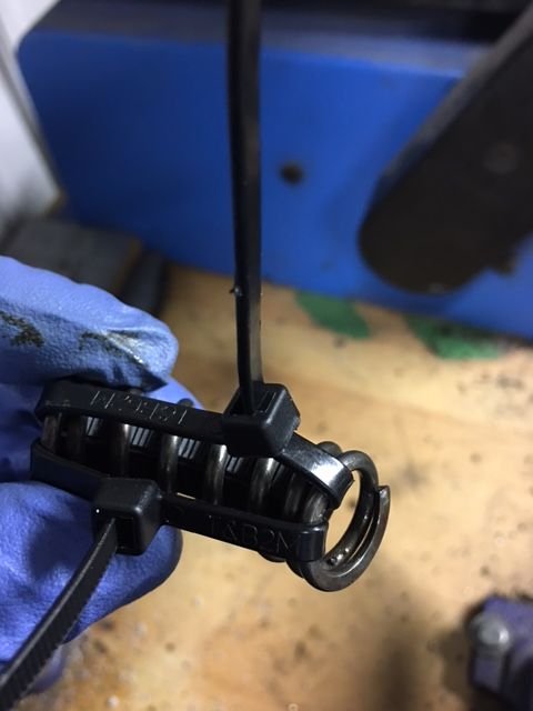

You are asking for trouble with the wire. Use plastic zip ties. If a little plastic falls into the transmission it will not cause trouble

Steve, I use the band clamp sold by Langs and it works fine. After lots of use it began to spring out a little and I just bent it back it. I would recommend getting one.
- Posts: 7126
Re: Installing the hogshead: Is there a better way?

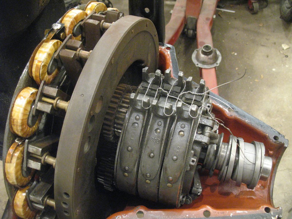

Steve, I use copper wire. It's non magnetic, should a bit come loose, and it is softer to to bend around when withdrawing it . On our RHD set-up we have two springs to contend with, reverse and brake. I do not like the new springs available because they seem to be longer than necessary and too strong. Unless there is damage to the springs, I leave them well alone. I do measure the gap and wire the band ears together to match the gap. This leaves the maximum clearance to get the cover over the springs. Obviously, others do it differently.

I'm using the clamp. The only thing I'm concerned with is once the hog's head is on and the springs and bolt are on. How do you get the clamp off. Seems like it will be under the bolts. I think wire or string is going to be the best way.

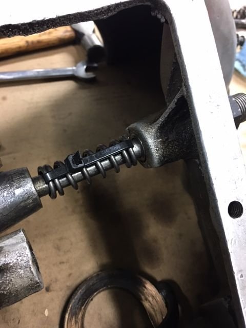

I’ve used heavy zip ties, work fine. Once had to find a busted wire end.
But you can use that excess wire for the bolt heads on your driving plate before fitting your alum. hogshead
Note the black zip tie, use two and lace together and grab all three band ears. Use dental floss on the washer/nut assembly, loop tied.
Turn the nuts a few threads, then remove the zip tie by snipper, the band ears will catch on the hogshead bosses.
Do that prior to setting and bolting the hogshead all the way down.
Zip ties will sneak out under the band lugs, that big fat tool won't! Tried that, been there

Steve, I bought the clamp years ago, never did work for me...use wires just be careful...I hold one end with needle nose and cut with side cutters then pull out the wire...works for me...

I like the zip tie method. No wire bits to fall in.

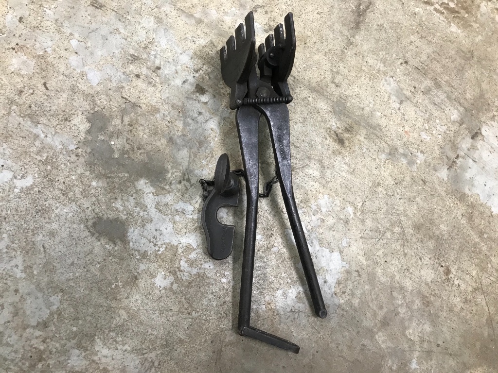

I have had good luck using three separate pieces of wire. One on each band. As I lower the hogshead at an angle with the rear lower than the front onto the drums I cut each piece of wire one at a time as each shaft engages the band ears.

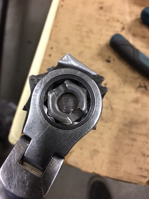

This period tool works amazingly well to compress the band springs. Although it won’t work on ‘26-‘27 hogsheads. One of my better Hershey finds!

Jim, could you post more on how to use the clamp. It looked to be in the way to set the hogs head, so we wired it and went on.

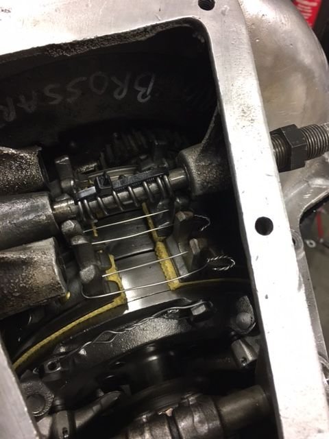

Hi, I wasn't successful using the clamp. I used black zip tie and steel wires but just be careful...I used a lot towel surrounding the band in the goal to avoid any steel wires fall down in the transmission. Also bellow couple pictures for the springs tips. Hope that help.

I have exactly the same tool that Ed shows. I will never install a hogshead without it! Once you have the band ears tied together with the plastic ties and the springs compressed with the tool, the hogshead just drops right into place. Easy peasy.

The Ford script u-shaped band tool works better than the modern copy that Lang's sells.
It has slightly different dimensions.

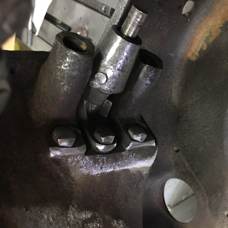

Steve, where is the lock wire in your driven plate bolts?
When I install a hogshead I use the clamp sold by the vendors. When I sit the hogshead in place, I start all the bolts and nuts to make sure the gaskets are in the proper position and every thing lines up. The bolt are just barely long enough to get started towards the engine. Before tightening everything down, I install the pedals, band springs, washers and nuts. Next I pull out the clamp and gradually draw the hogshead down until it's seated and snug up the bolts. The clamp cannot be removed if you tighten the hogshead down on it.
Stephen
Stephen

Rusty Ford is right about the copy of the band tool not fitting well. I have one of those and wound up not using it. I can’t understand why the repo tool can’t be made to the same dimensions as the original.
