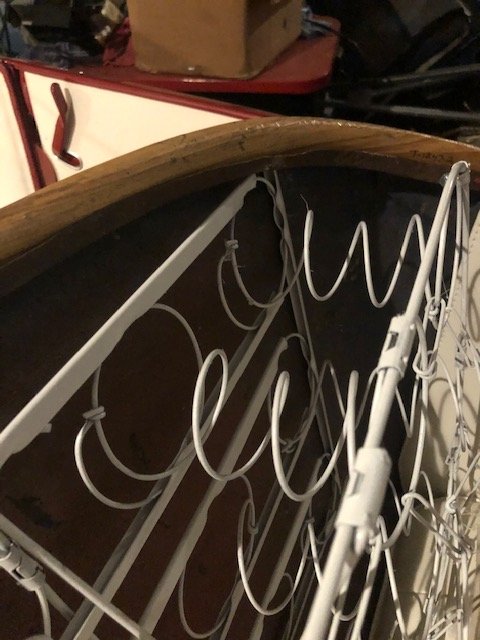

Here are the new springs.
Front and rear. Since the upholstery is white, I painted the springs white.
No one will see the seat backs and only a few will see under the seat cushions.

I think you have the seat back spring upside down. The curved corners go to the top.
Mustang1964s
Topic author - Posts: 272
- Joined: Sun Jan 06, 2019 10:48 pm
- Last Name: Bourgeois
- * REQUIRED* Type and Year of Model Ts owned: 1914, 1926, 1927
- Location: Waco, TX
Re: Late '26 Touring upholstery
Lol
Now that you mentioned it. It is!
That’s what I get for just setting them in.

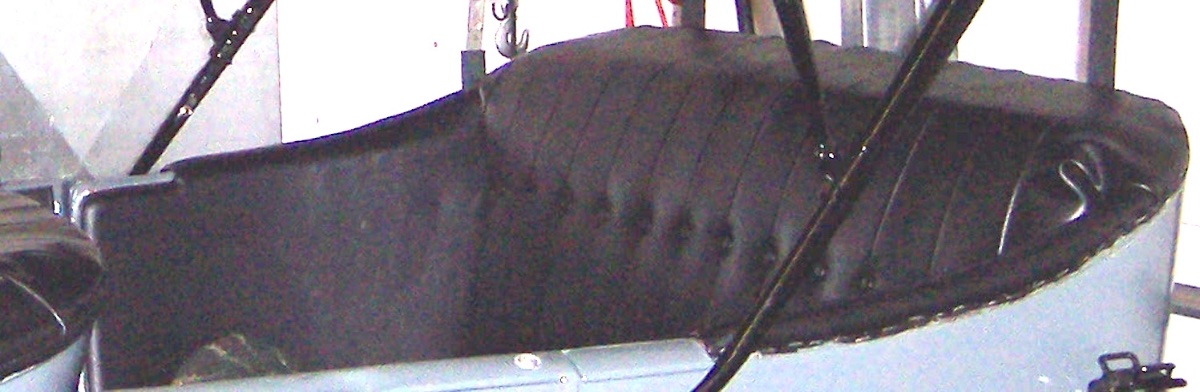

Seat upholstery is fairly easy, make a simple plywood base and 2x4 stringer, with two long all-thread rod at each end to compress the spring inverted over the upholstery. Then fold in the crimp channel. Rear hip pads go in first, then hang the rear back spring, with simple looped strips of material, positioned over the finished seat. The rear backrest upholstery then is fitted over the backrest spring.

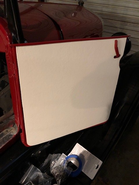

I am looking at the door panels.
Pretty straight forward.
The question is the top edge.
Will it be ok just leave it tucked under the lip.
What is the opinion of the folks about putting a slight amount of weather strip sealer just along the top?
Would it prevent of any chance of coming from the loose or bowing.
This a driver and be exposed to the weather.
Here is a pic before I attach it.
With luck I will have the door panels nailed tomorrow night.

- Posts: 4046
Steve
Your fit at top is fine. Under that slight lip, that will prevent moisture. Of course if you leave it in the rain all the time the door panels will warp in a few months. Dry off the upholstery if caught in the rain with top down. Any sealant at the top edge could be visible.
As for latch trim, your new panels have stitched seams, no real need to add the metal crescent. Those were factory for the pressed in grain black cardboard used, and the metal crescents were factory crimped to the exposed edge of the cardboard panel as added wear protection to keep a raw edge of cardboard from fraying. Your panels are more fancy than stock, with added layer of vinyl

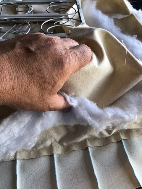

Here are some pictures of the rear toe kick and rear hip.
My current question is do I pull the over hang tight then tack it down or leave it fit just snug?
Toe Kick and Rear Hip Just rear hip
Over lap. How tight do I pull this?
- Posts: 4046
Looks pretty good to me. Would try to remove the wrinkles with a tad of cotton batting under that rear section, the back rest upholstery will cover that area anyway, but just to be sure those wrinkles are covered too.
Original 1926sport touring, new, backrest showing the hip pad, pull nice over the top of the body armrest.
Install on my '27, showing the thin padding on that vinyl wrap over the arm rest. If you look at my finished photo, in this thread 3/6 @ 11:09, the rear hip pad is smooth and pulled tight, without wrinkles, over the armrest section of the rear body tack wood.

Side and door panels installed, except the front kick panels.
It's been an adventure, I think the hard part is about to come up.
Let me know what you think.
Trim around the latch. Here are the rest.

When I purchased my '27 touring car the back seat upholstery had been redone. The pleats had buttons. Th front seats had not been done and the seats that I presume to have been originals (they were really bad) did not have buttons. I'm guessing that the seats would have matched. Does anyone here know for sure whether a late '27 (March production) would have had buttons or not? For the record - we redid the fronts without buttons.
- Posts: 4046
Bruce's C-D encyclopedia states '26-'27 open cars came with or without buttons on the vertical pleats.
Ones I have seen original are later, '27s with Vaporizer carbs, and pleats are without buttons. The famous 15th Million is buttonless.

Tonight I was trying to place figure out the spring placement before I starting to cover them up.
The rear spring seem to fit right in.
My question is the front seat springs.
Do they need to be bent to match the sheet metal?
Or should I put some support behind the spring to keep them from collapsing into the sheet metal?
Here is the front: Here is the rear, I think the placement seems about right.
Or just a bit lower.
- Posts: 4046
The placement for the front seems fine, the spring will conform to the curve of the backrest body panel. Hang the spring with the seat cushion in place, that will show where the spring should hang on the lower part. Looking good!

I am tackling the rear seat back.
The old seat back had a piece of what looks like cheap carpet.
Should it be put on the new springs?
I have installed new wood. The three runners were missing from under the old seat back.
I have an alignment questions.
The burlap is hogged tied to the front of the seat springs.
The flaps on the upholstery should the align up with the springs?
Where should it be hog rings be applied?
I am thinking so.
The bottom of the upholstery aligns up the padding lines up bottom of the springs.
Should the cotton padding also start at this alignment point?
It seems that the cotton padding could hang down just a little past, just take up the gap from the back to the seat.
Here some pictures of the old seat back and what I am currently looking at.
I am thinking so.
