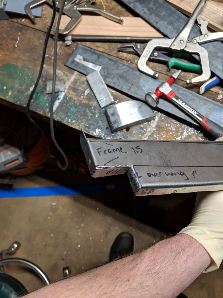

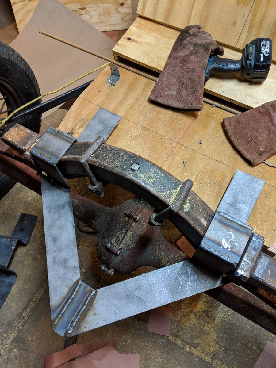

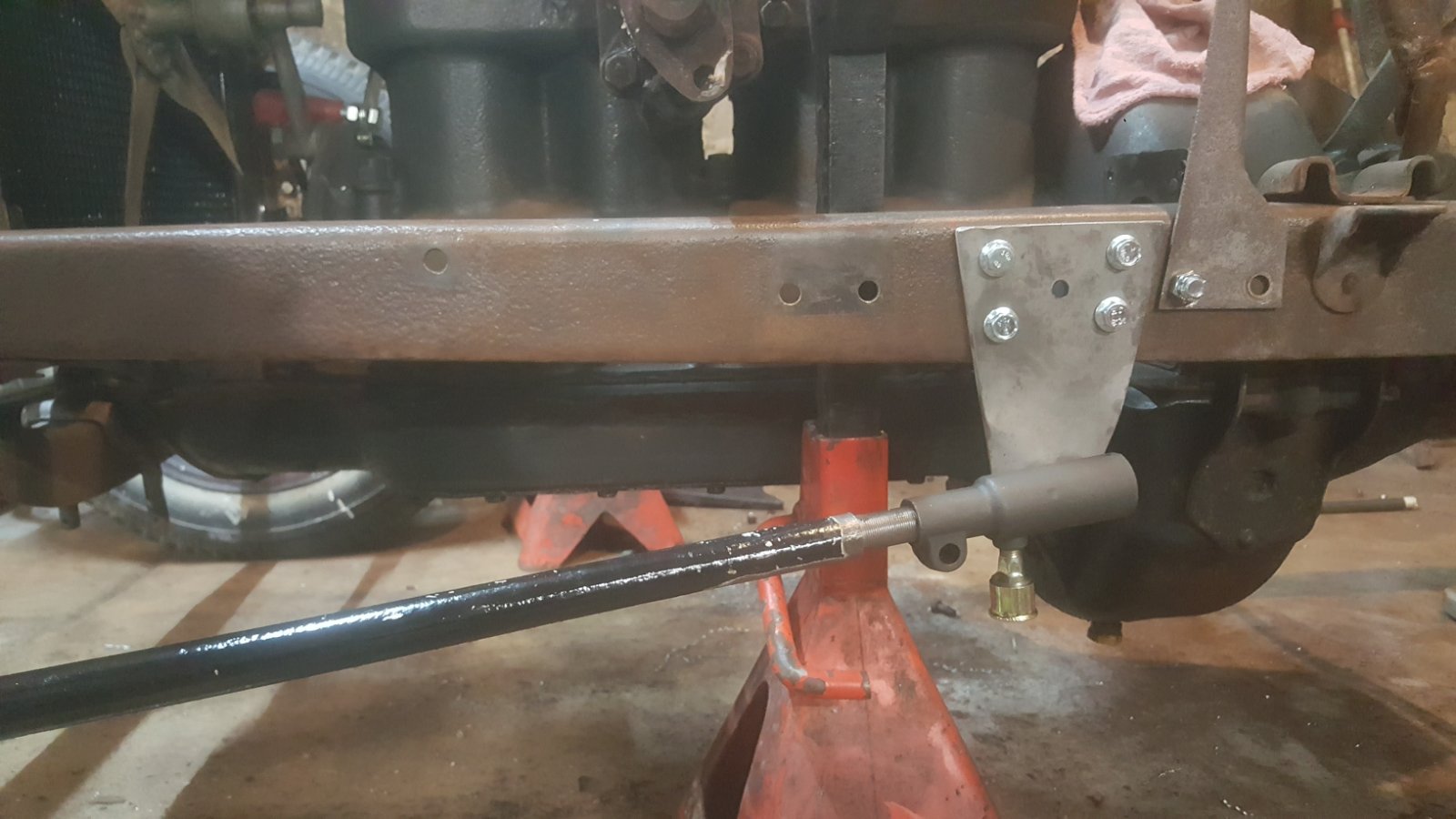

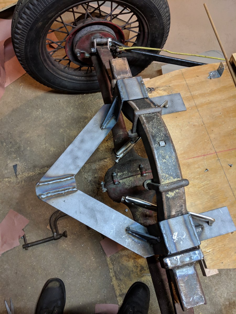

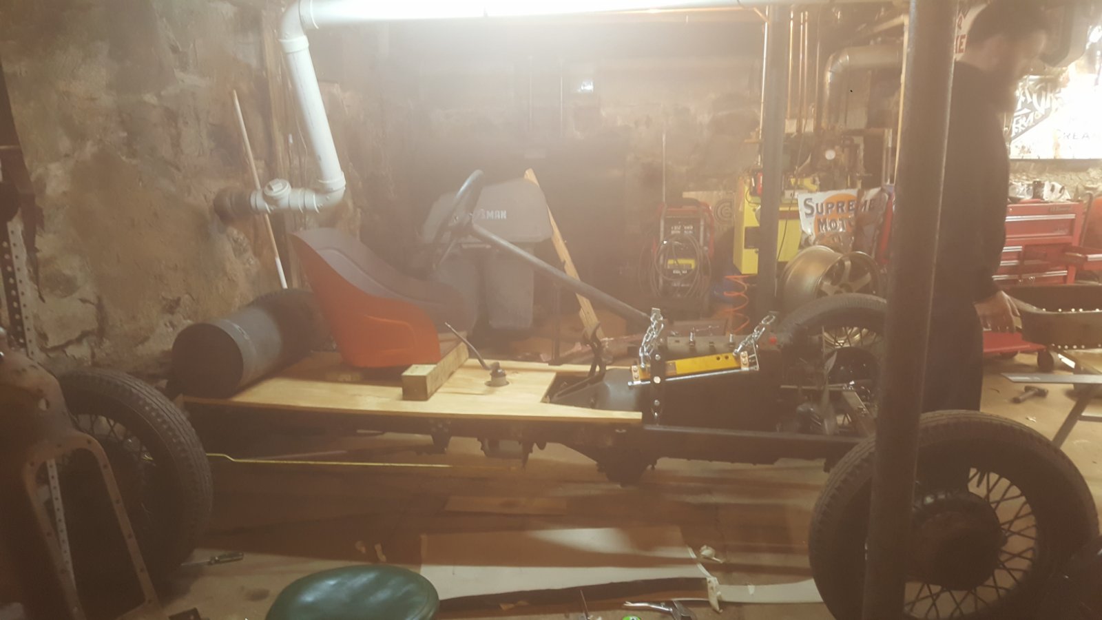

Late last year I bought a frame and running gear to begin building my own speedster. The chassis had been modified in a very hokey way and I went through and undid/ modified what had been done. This thread will be very photo heavy as it's easier to explain visually.
Originally the frame was lowered with angle it on and a modified rear cross member. I cut all that off and came up with something else.
This ended up being a bad idea because the frame and spring interfered. That was a week or two down the drain.
The rear lowering did however work out. I bought the cast lowering brackets and a lowering cross member for a combined 7" drop. This car will be about as low as I can make it and still be drivable.

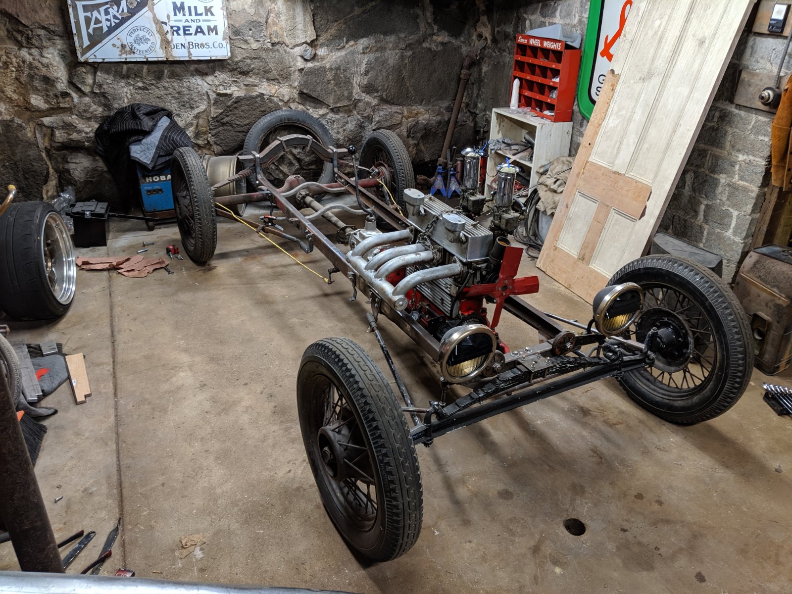

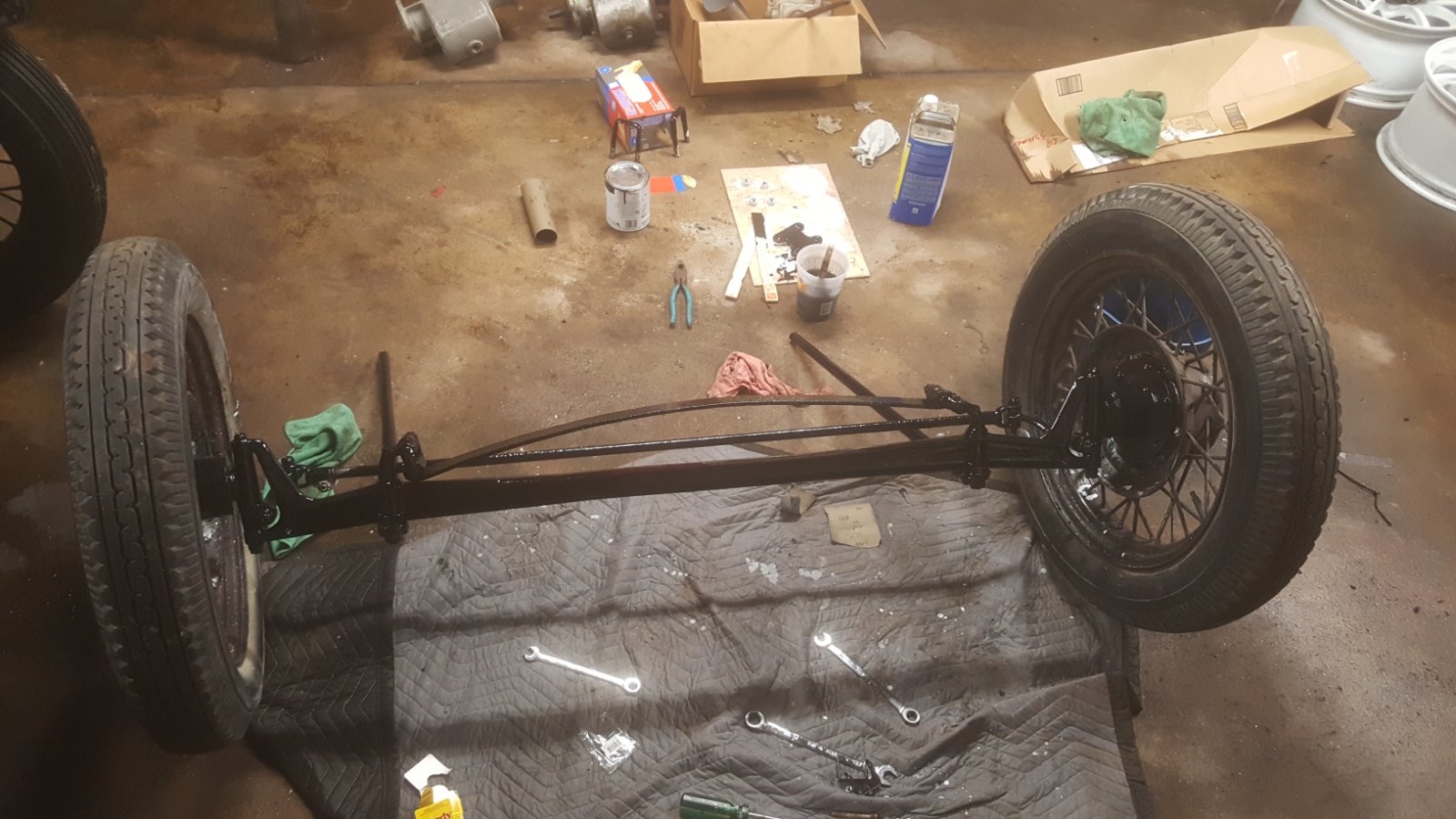

I stripped, blasted, and painted the front axle, as well as chopped up the front wishbone to be mounted to the frame.

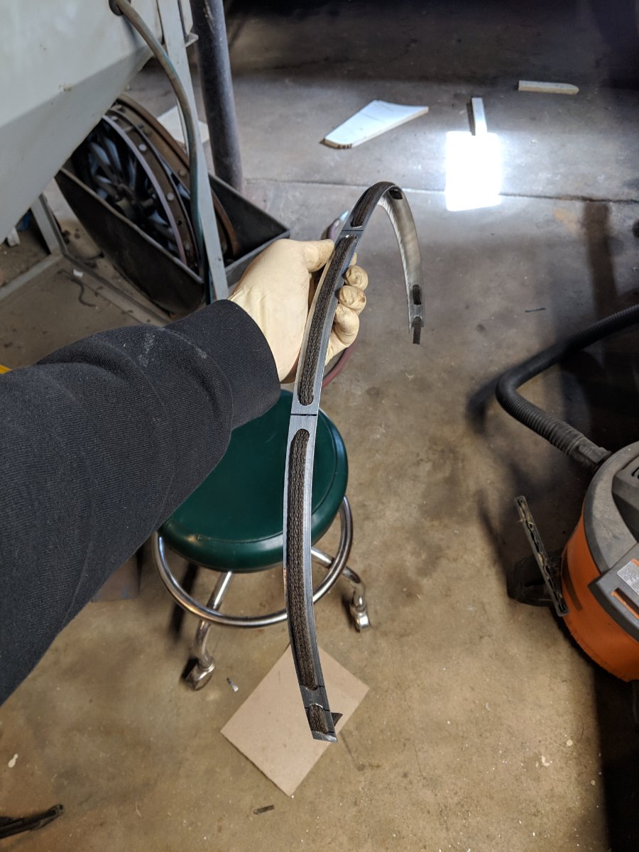

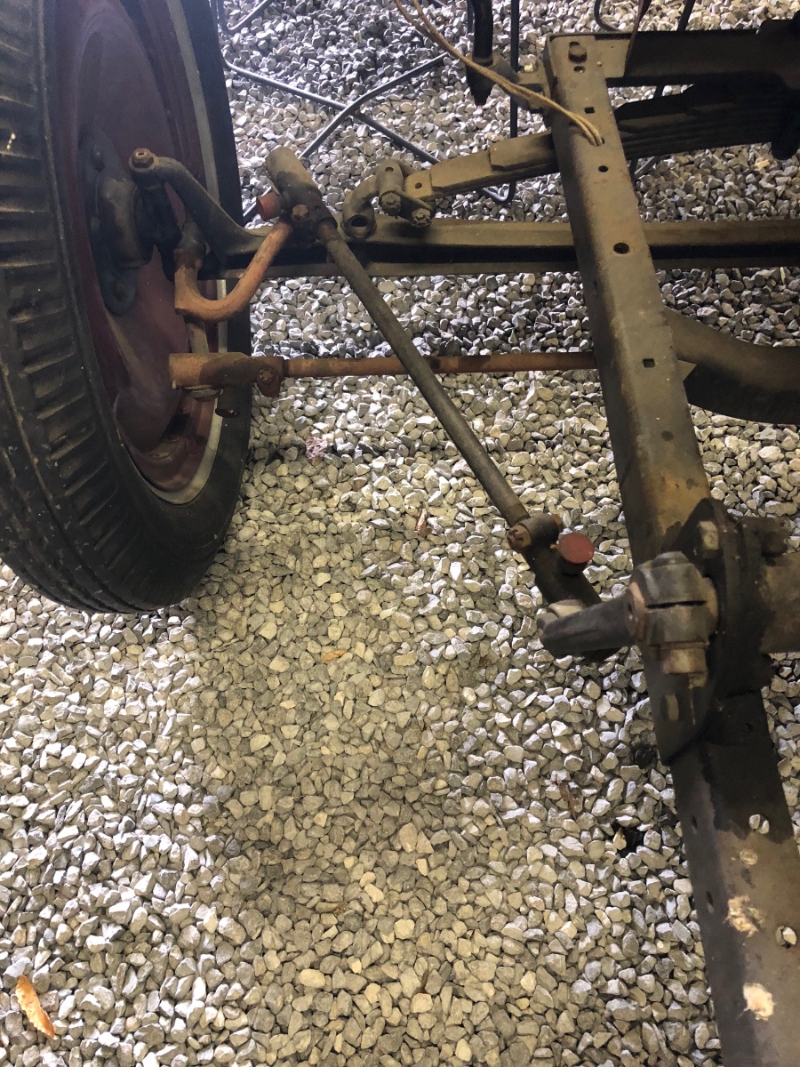

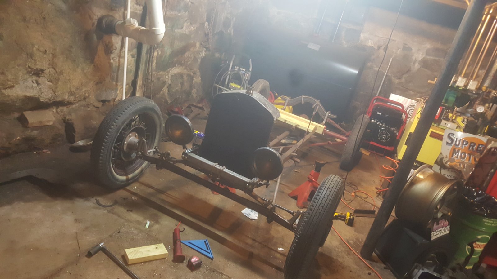

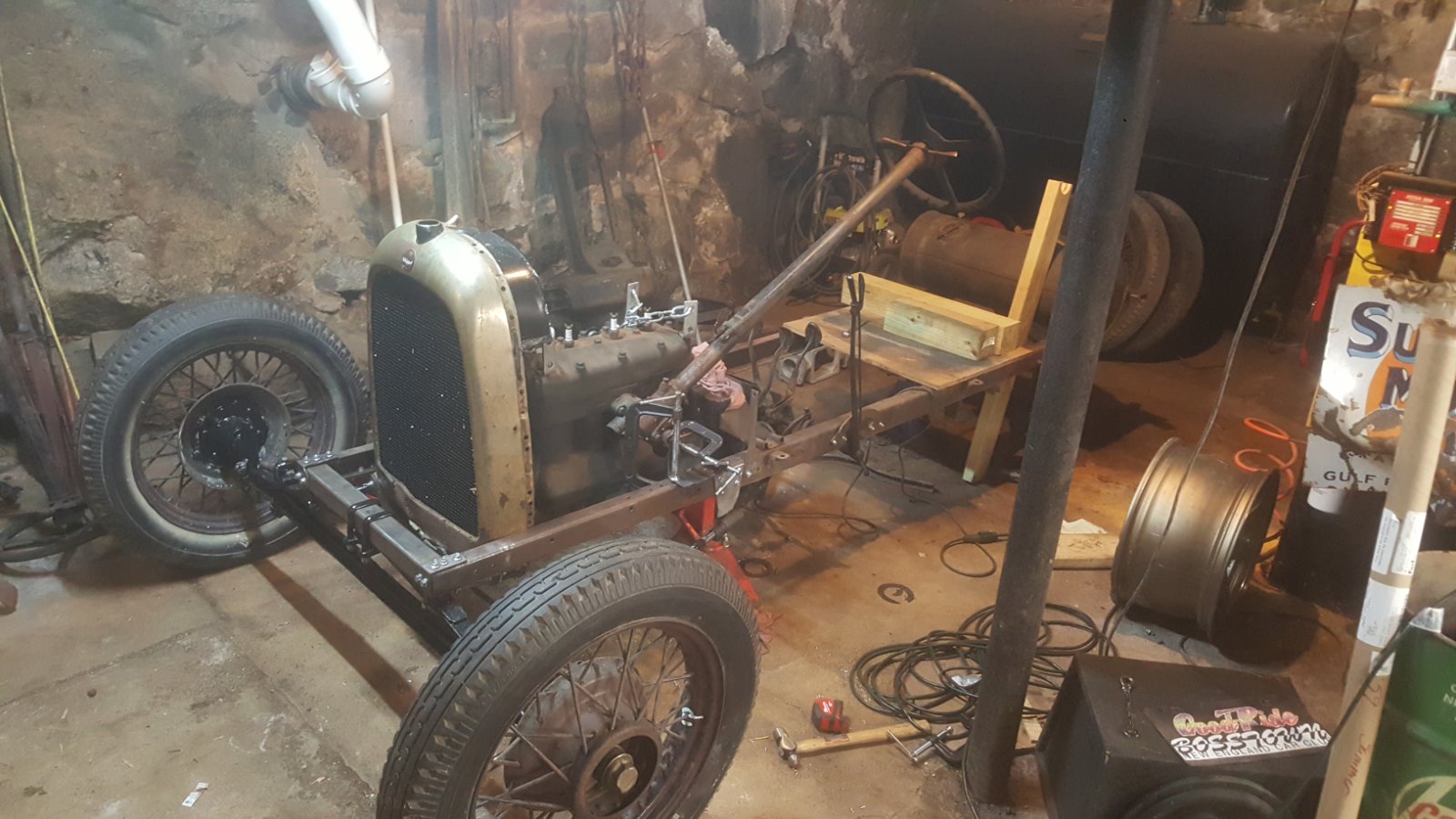

Here's the beginning of the split wishbone and mount. I'm using bolts temporarily for mock up. I will be using rivets later on for final assembly.
I cut the wishbone then inserted a good chunk of model a tie rod inside, then plug welded, welded the seam of the wishbone, and the end. I am going to install spring perches and welding another pipe to make them into a hairpin design for more strength. I made a 3/16 inch plate with a model a steering ball swedged and welded. I'll be modifying the mounts for a bit more strength in the future.
I picked up an old 2 tooth model a steering box and started mocking it up to figure out where it was going to sit and work. I want a real low steering column angle and tried to get it as close to the pedals while still being able to push them. Also, I am mounting the box as far inboard as possible. I really enjoy the early Sprint cars, but wanted a speedster to drive more casually as well. So this will be my iteration of a street able racer.

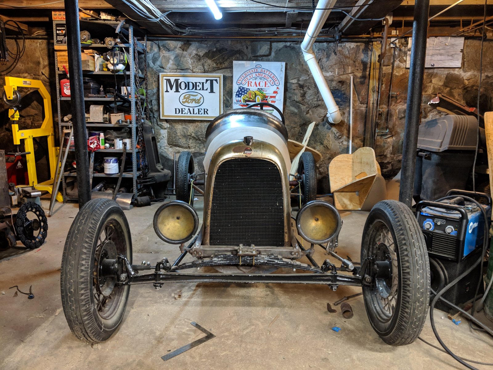

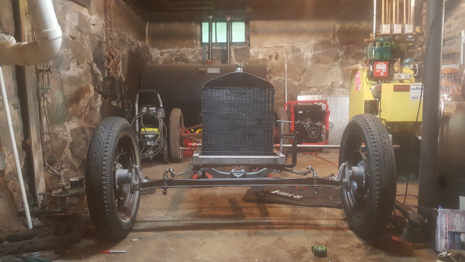

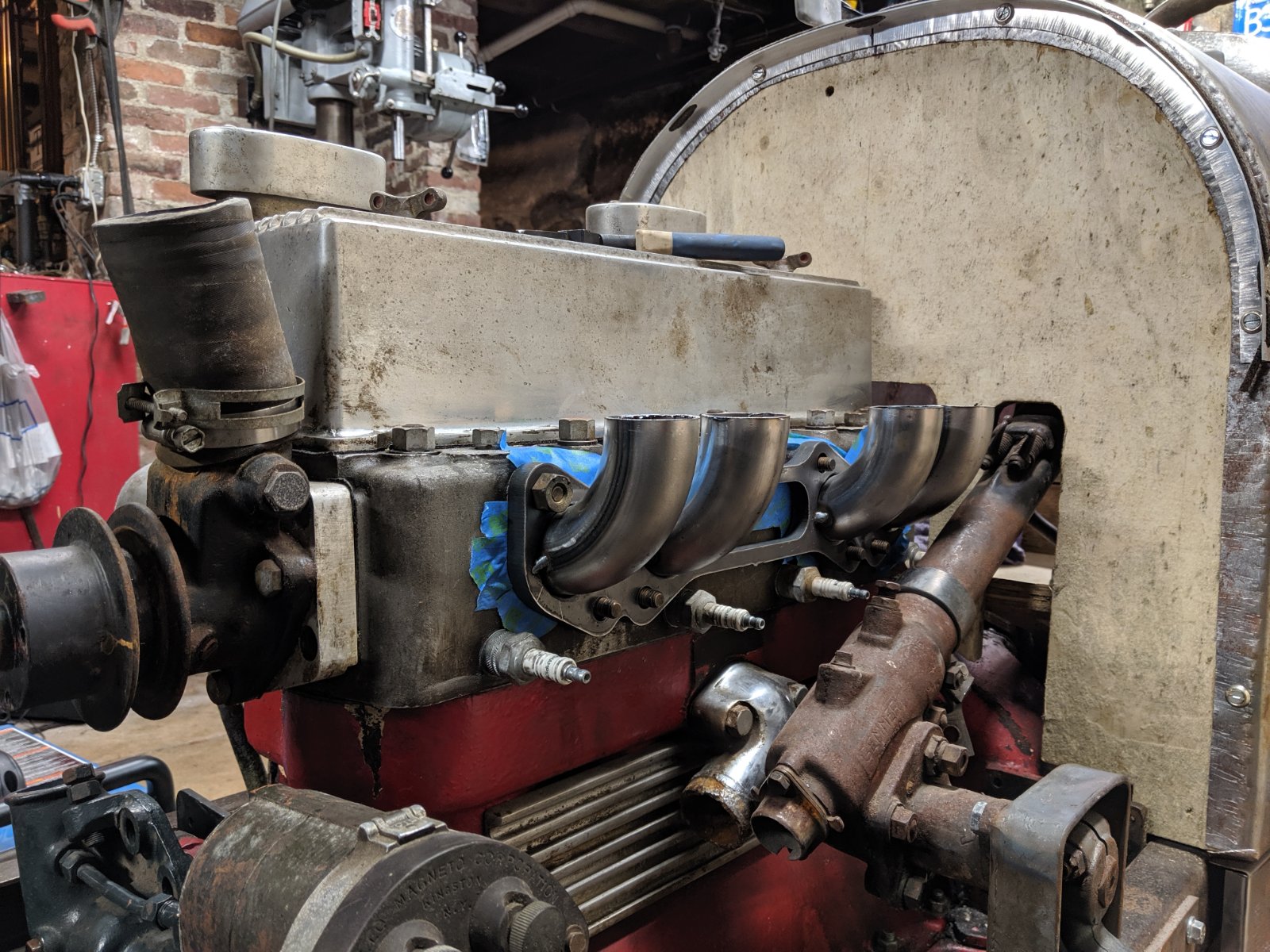

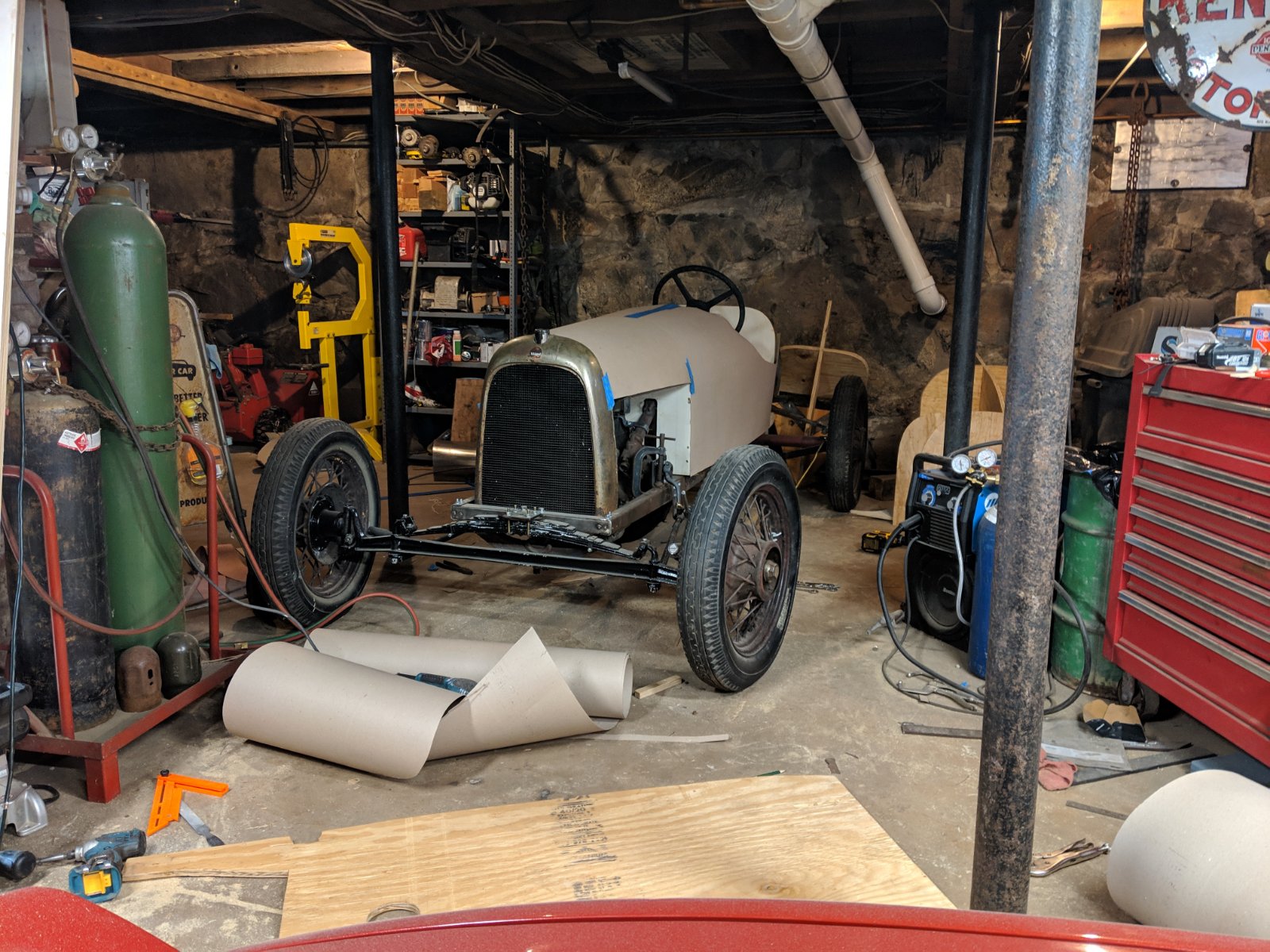

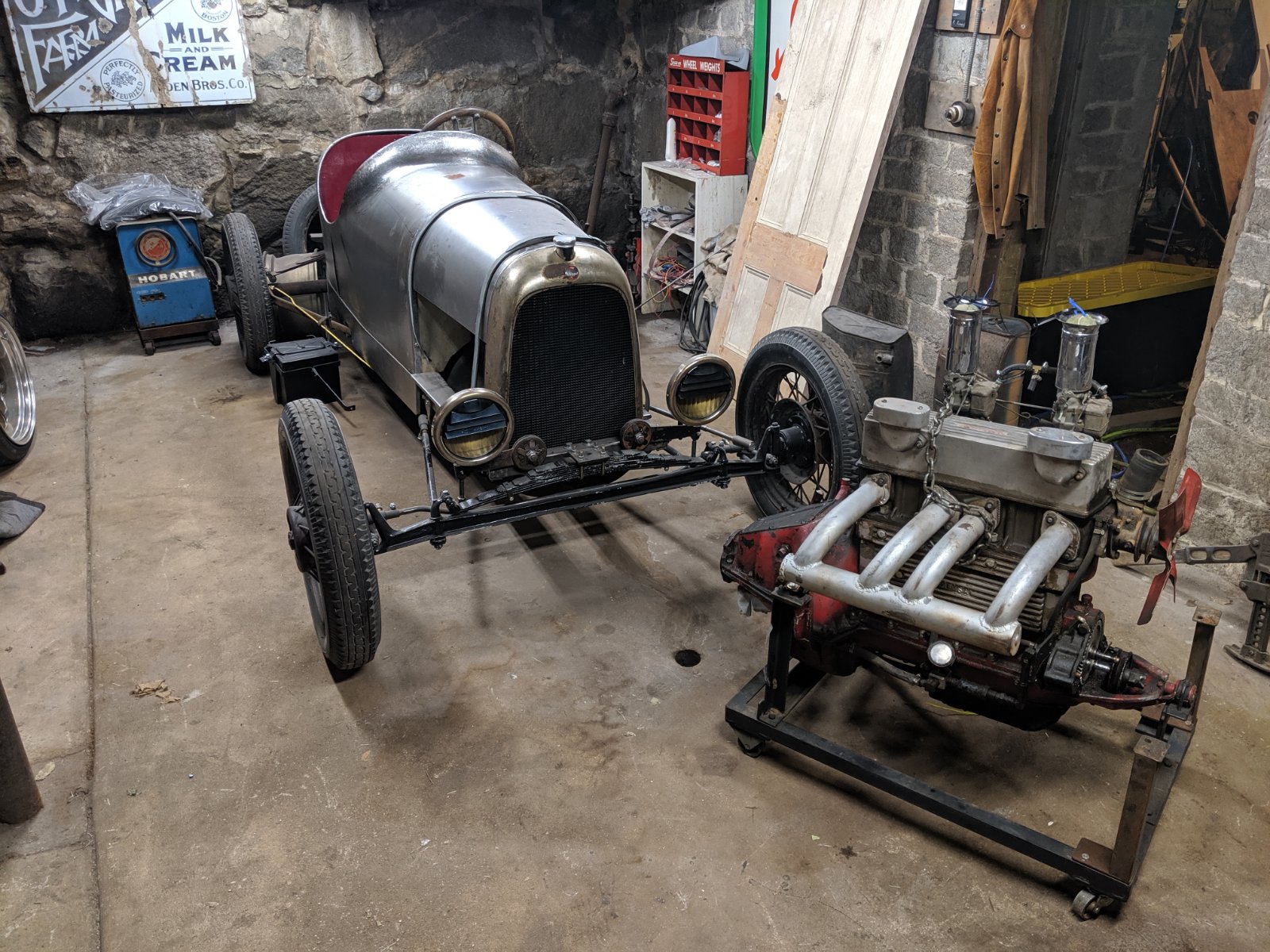

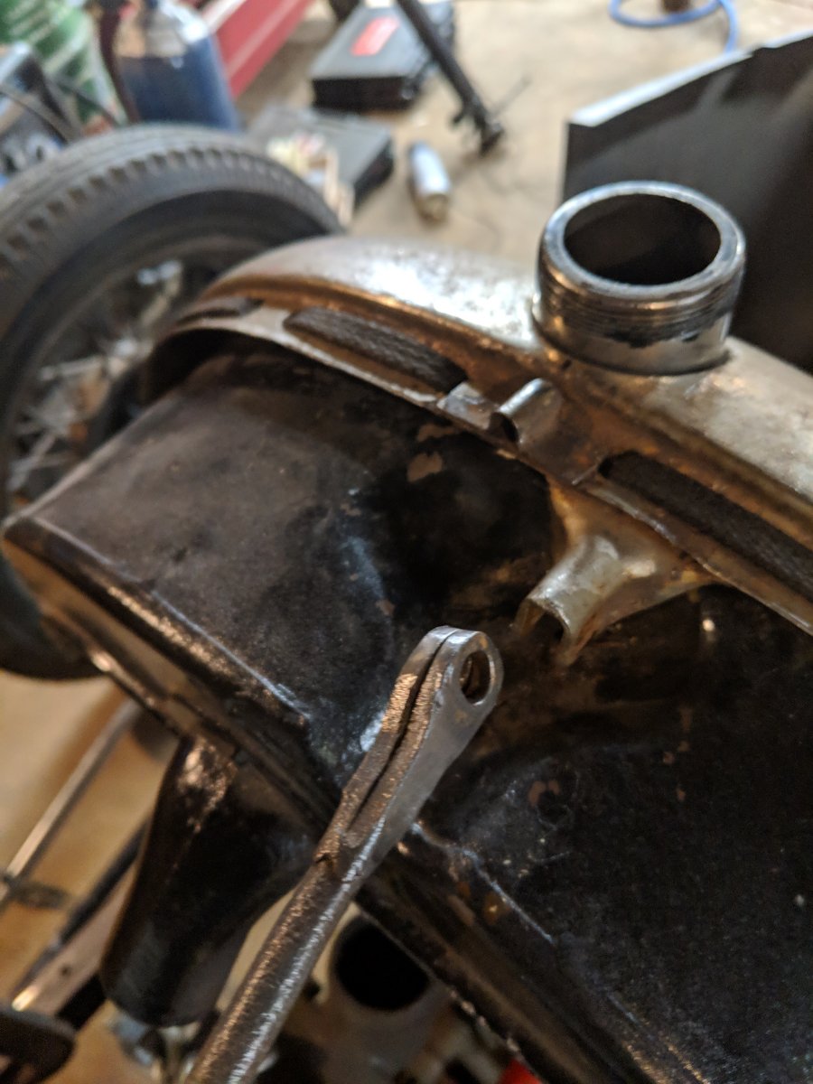

This is about when I met my friend Rob Weitzel. I had been posting here and there searching for a Whippet radiator. He mentioned that he had one. I bugged him about selling me one of his and he gladly did to help me keep my project rolling. Rob has been a key factor to this project and has been a ton of help.

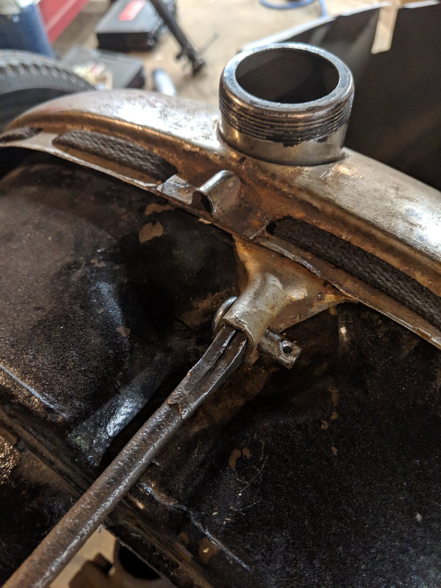

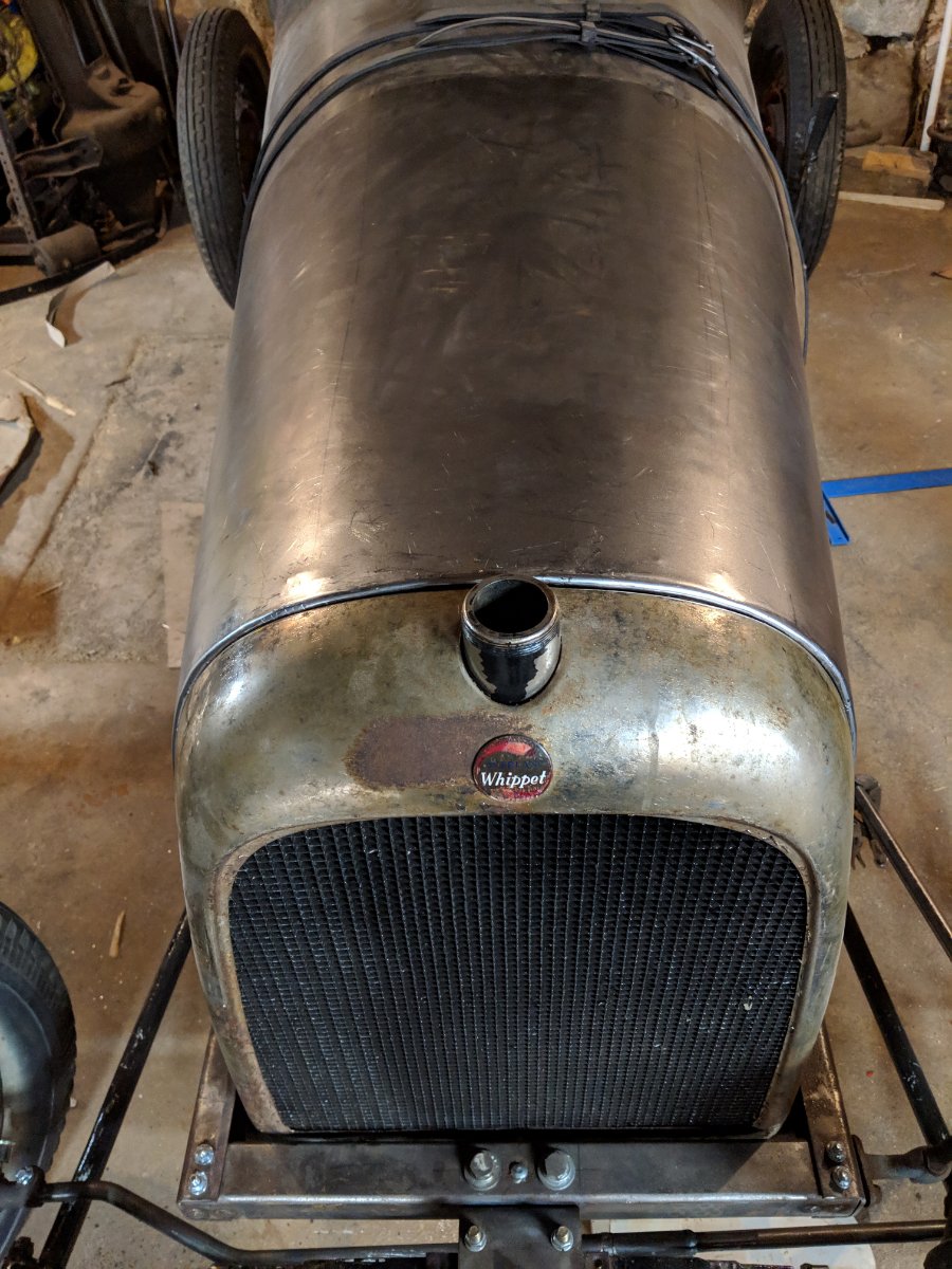

The shell of the Whippet radiator he sold me was crusty on the bottom. I cut it out, shaped a patch, and welded it up. I had just bought my first welder a week before so this was the first little welding project for me.
Here's a couple more column mock ups and the beginning of the body.

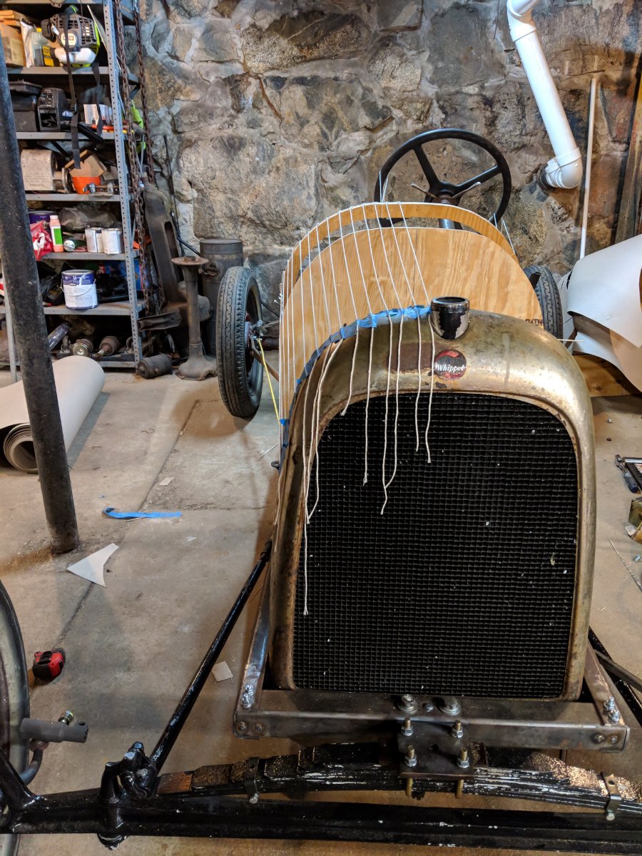

Re: Model T Special build.

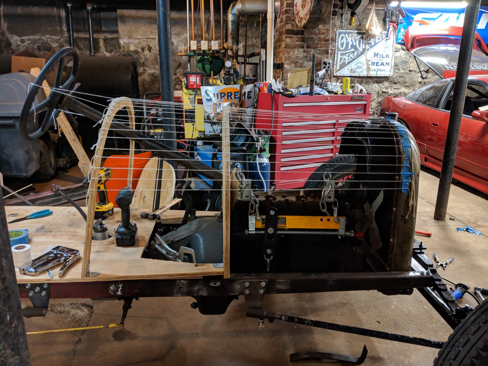

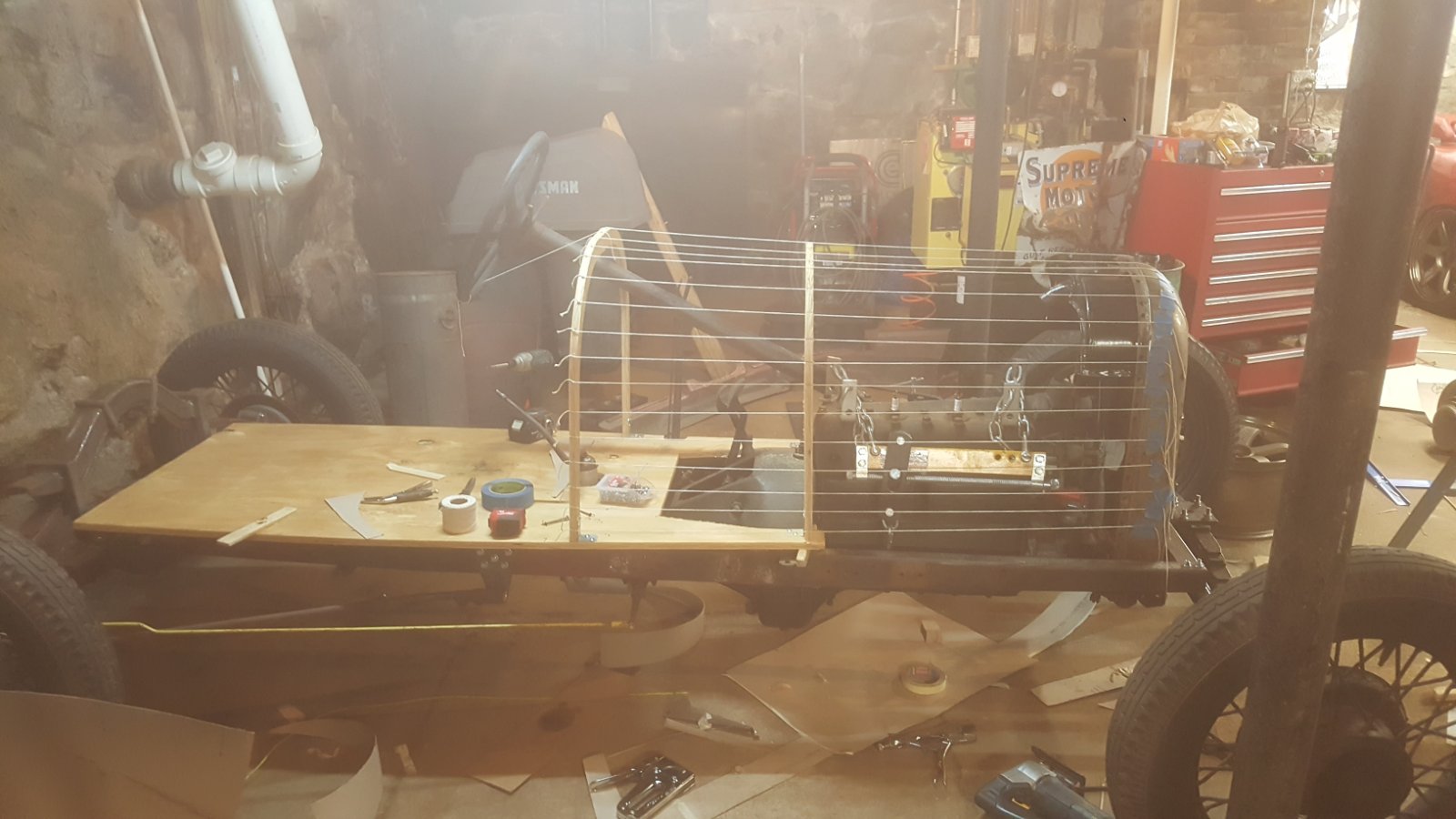

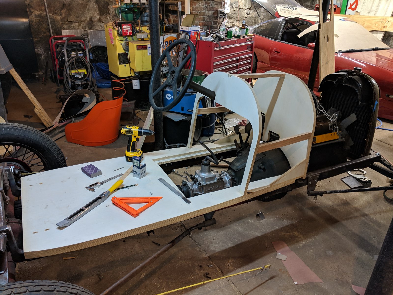

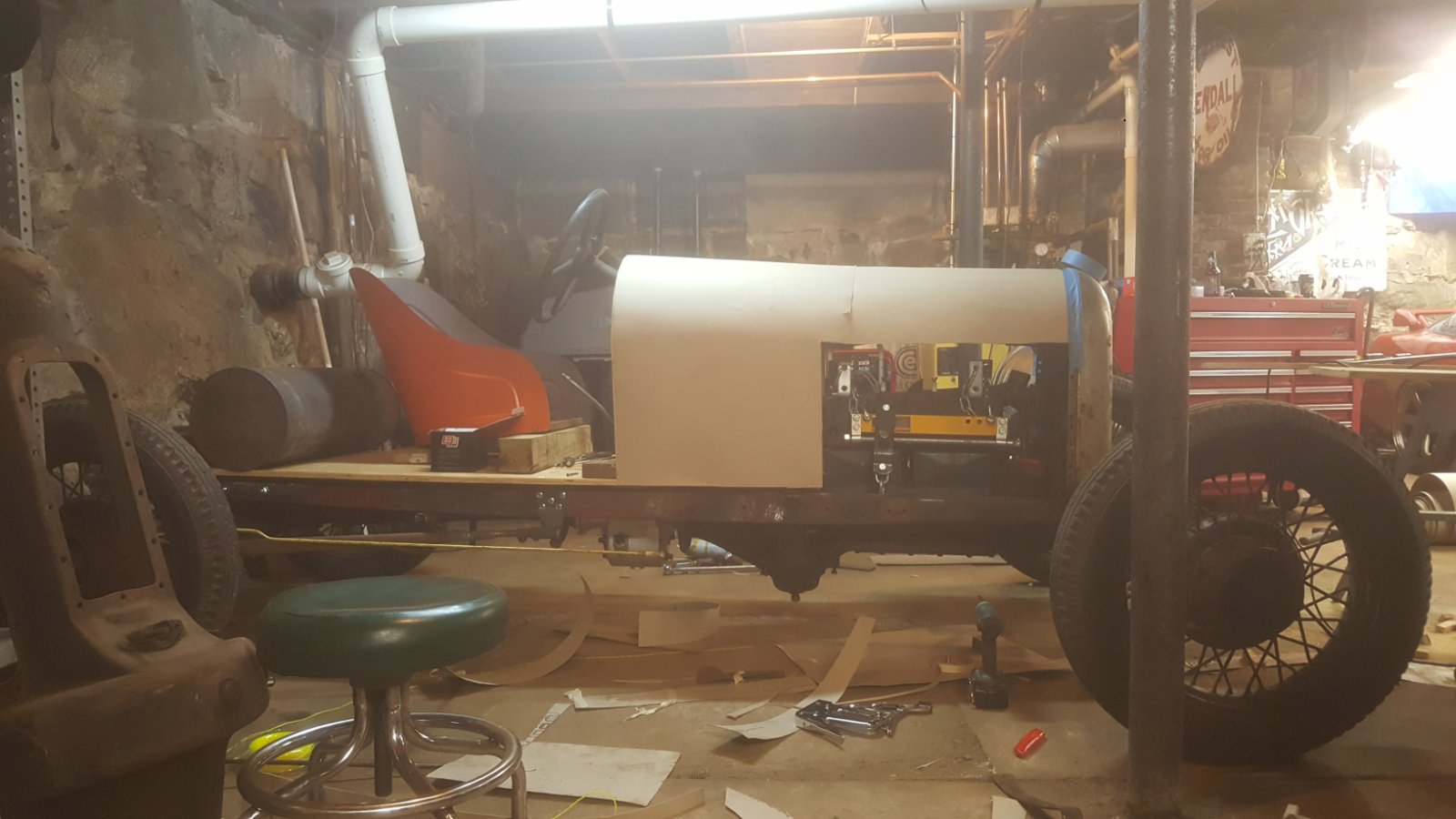

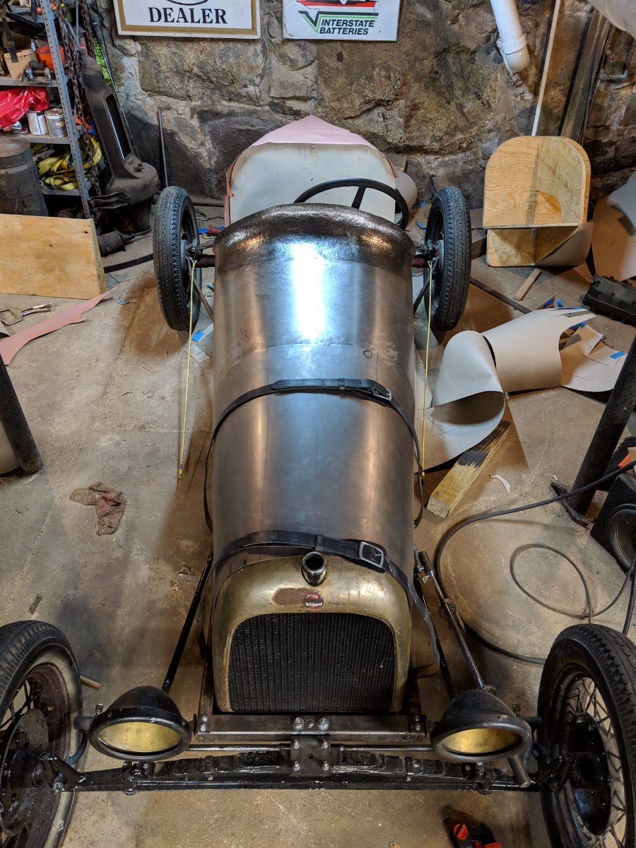

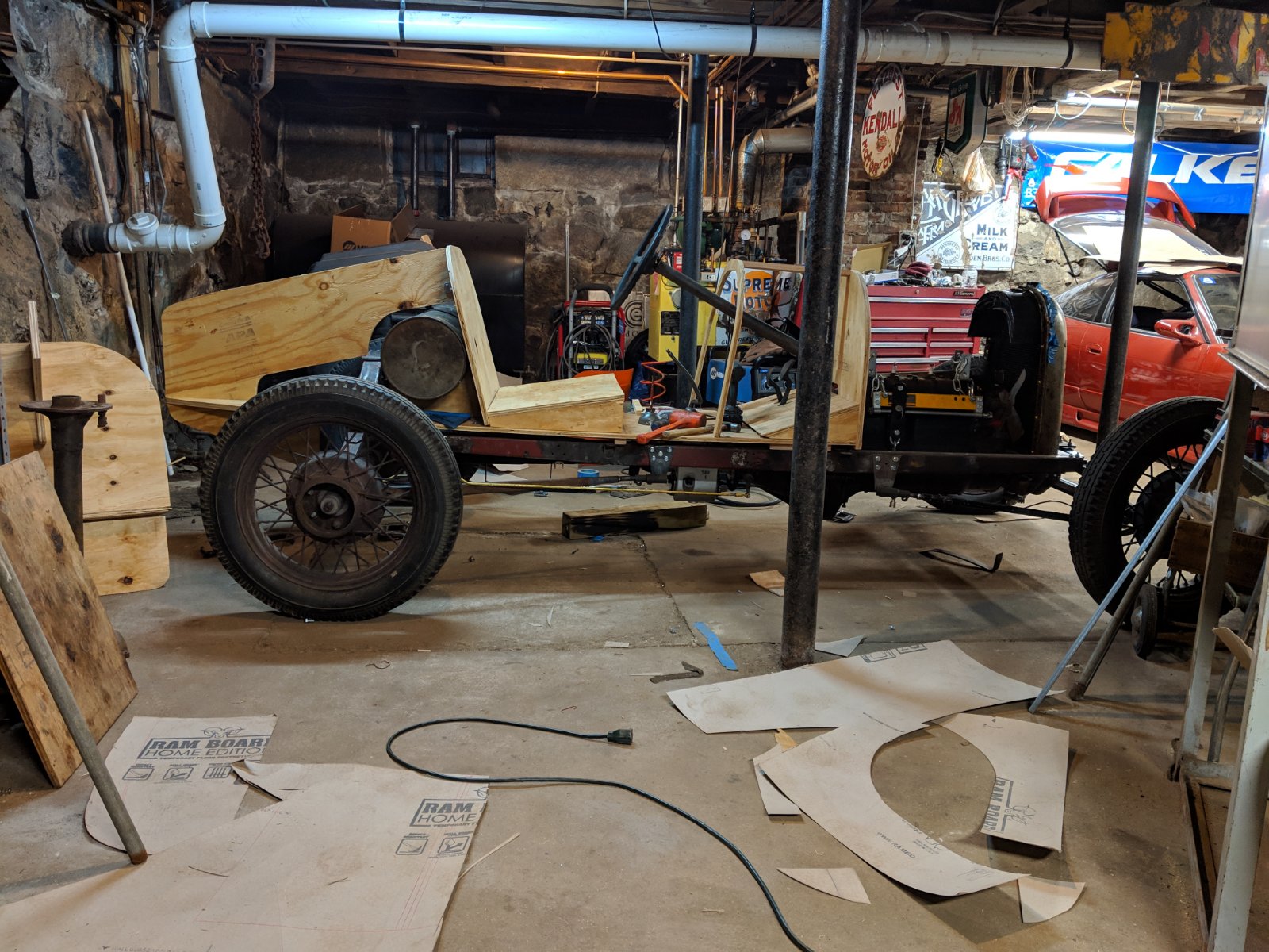

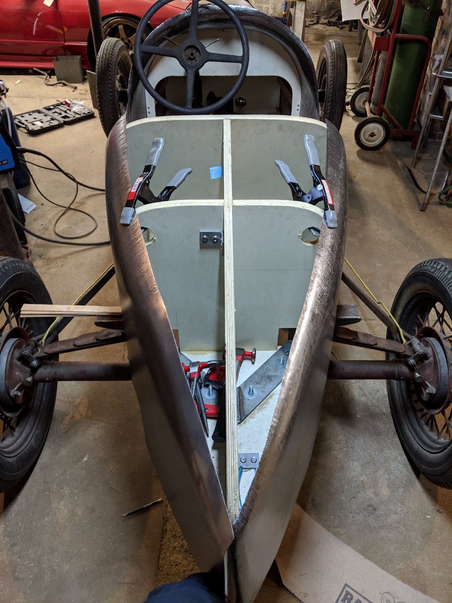

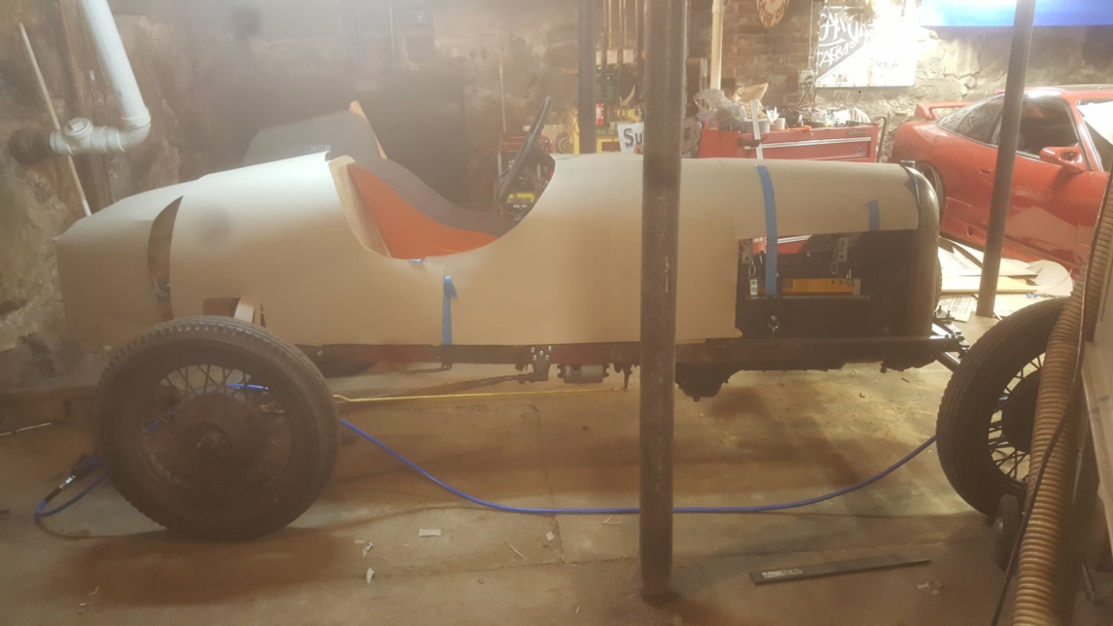

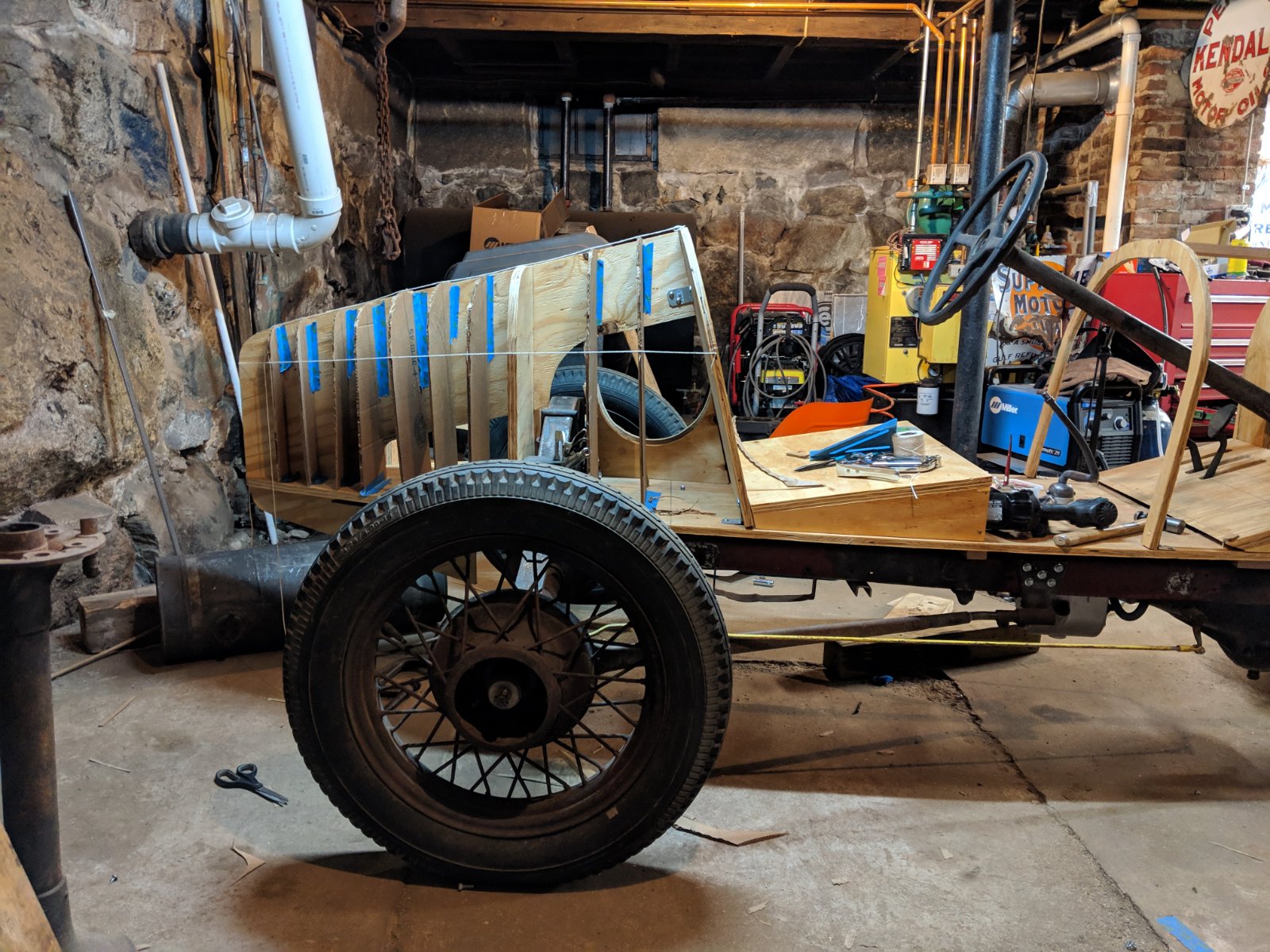

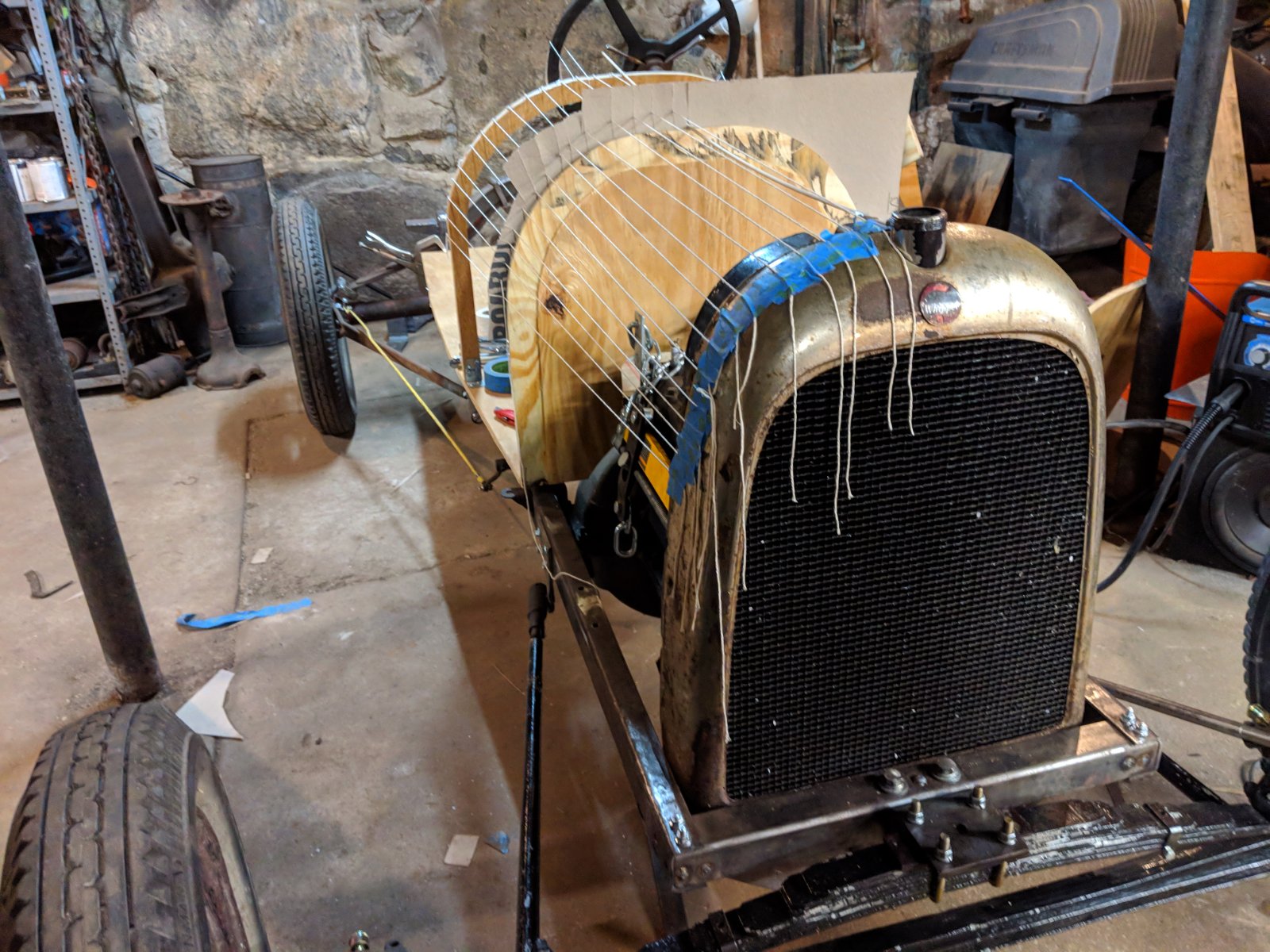

I will be running the 2 tooth box, model a drag link in a modified length, and model a steering arms in model T spindles. The arms bolt right in.
So there was a lot of measuring, cutting, swearing, creating fire wood, etc. Here's some photos of the prototyping.

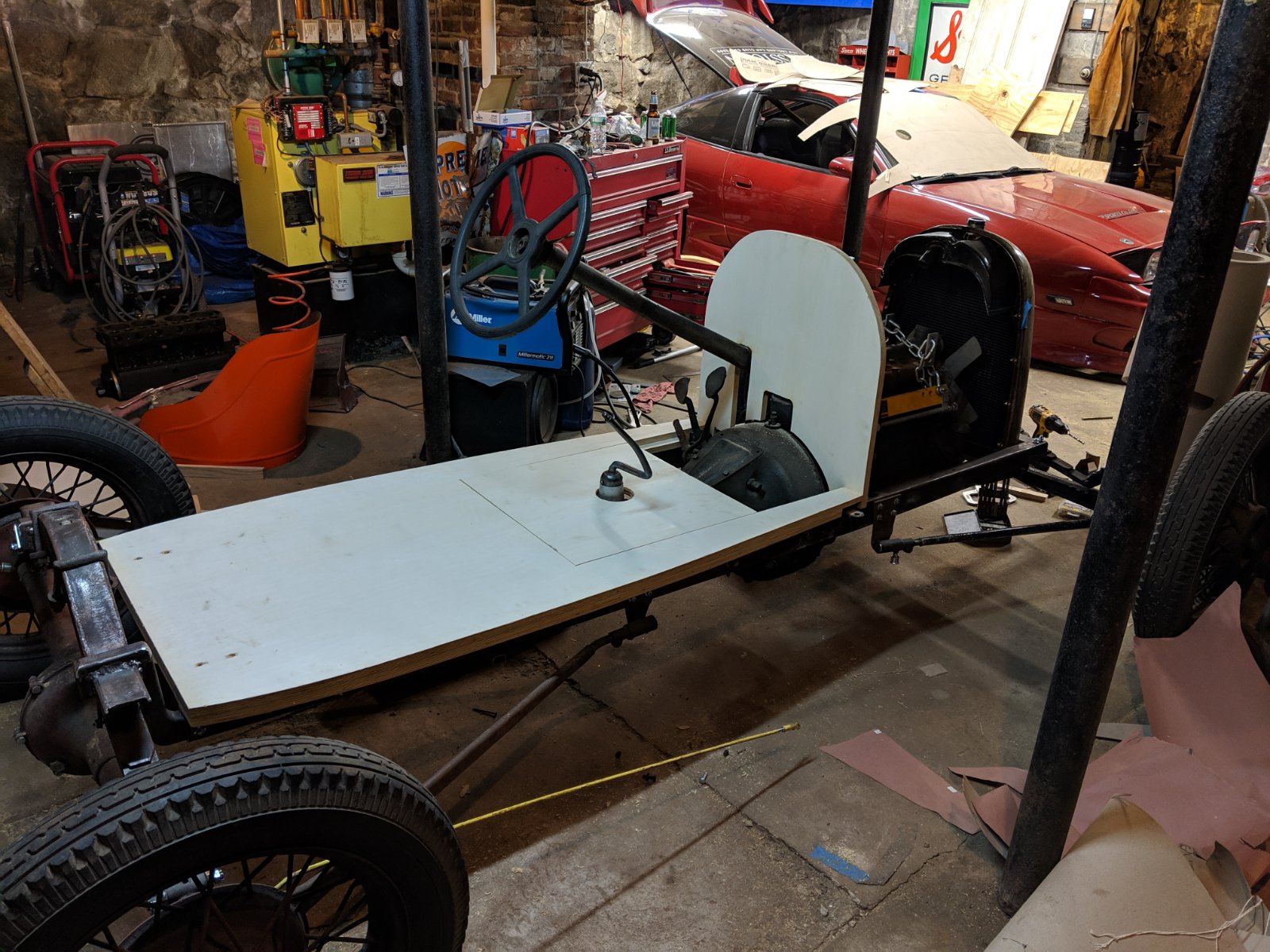

I created a dash, then mounted up a rough firewall. I ran strings from the dash to the radiator. I stapled a piece of cardboard to the rough fire wall then slit the cardboard until the string ran straight through while taught. Once I did this about 50 times I got a good half profile of the firewall shape I wanted after trimming the cardboard at each slit to flow well from radiator to dash.

This is a clearer view on how I got my firewall shape. I ended up doing this multiple times because I didn't like the body shape. I spent a month playing with cardboard I think.

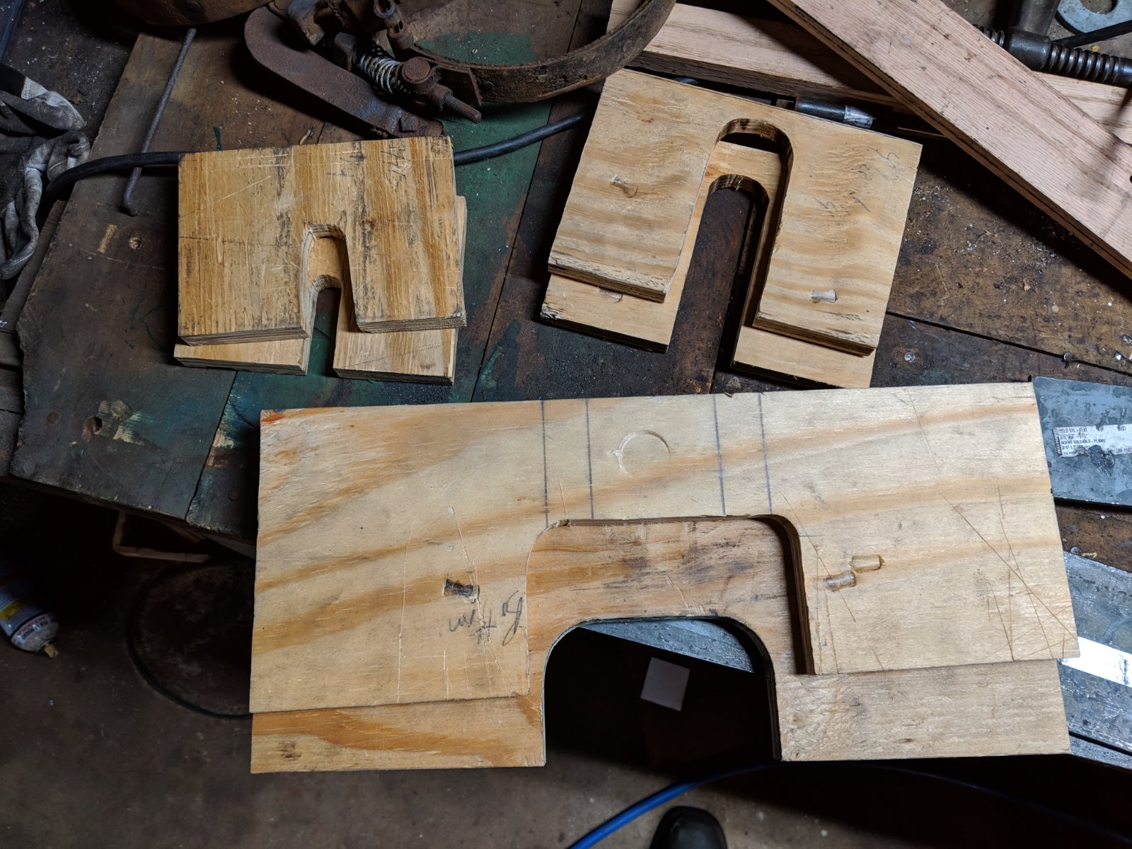

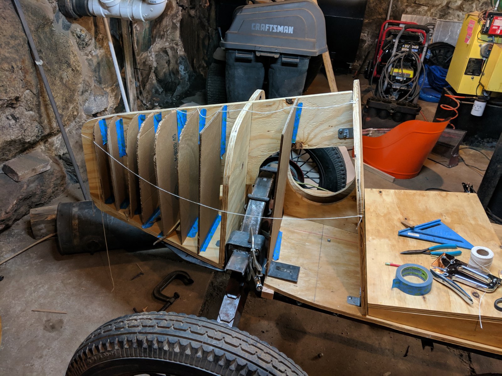

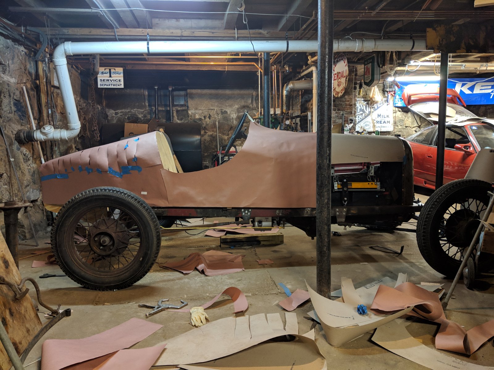

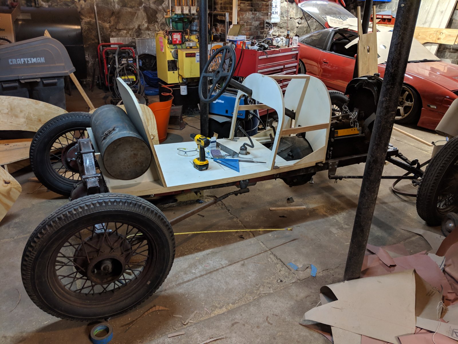

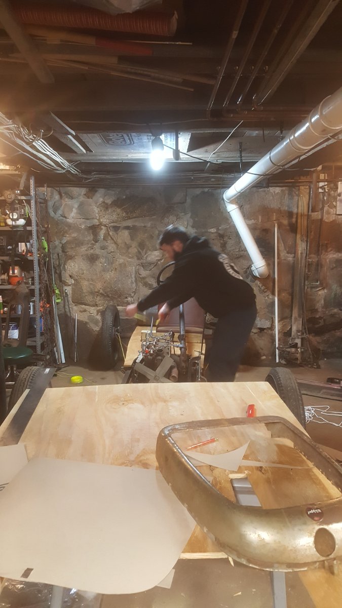

I spent a lot of time playing with cheaper plywood as well as card board and more string as I didn't want to waste good materials while I was still processing ideas.

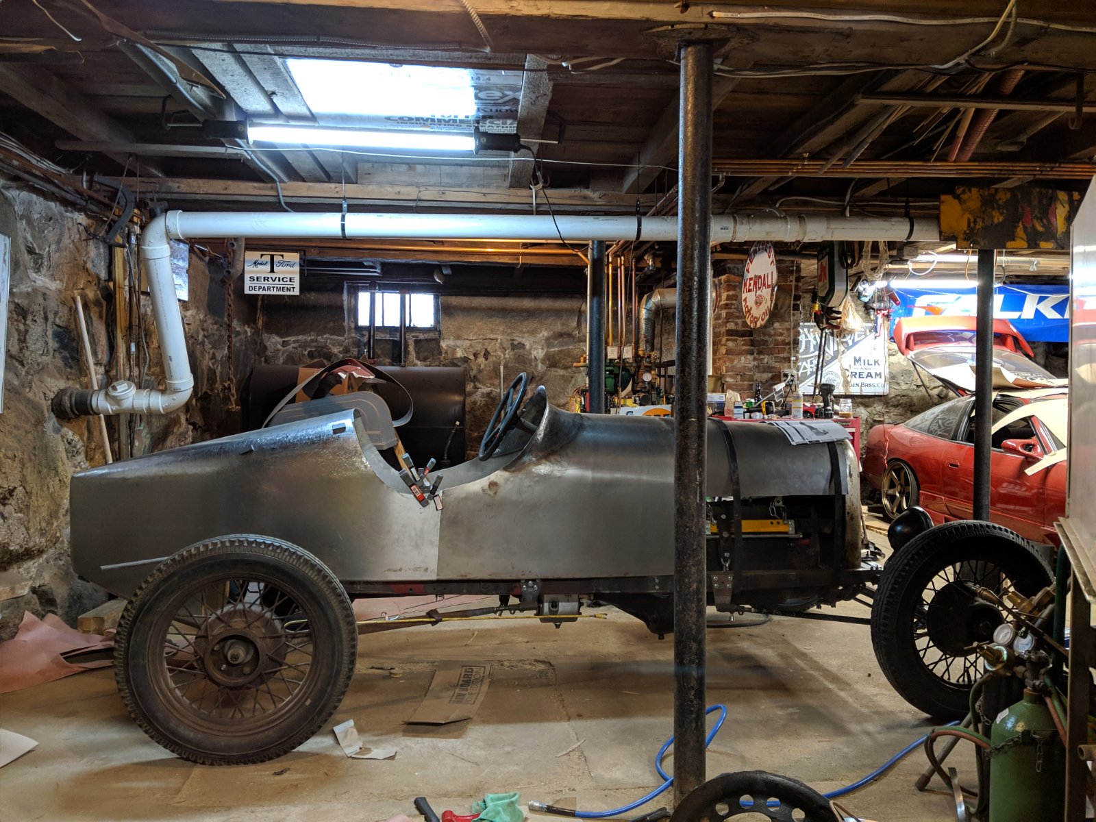

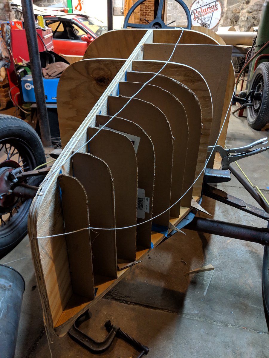

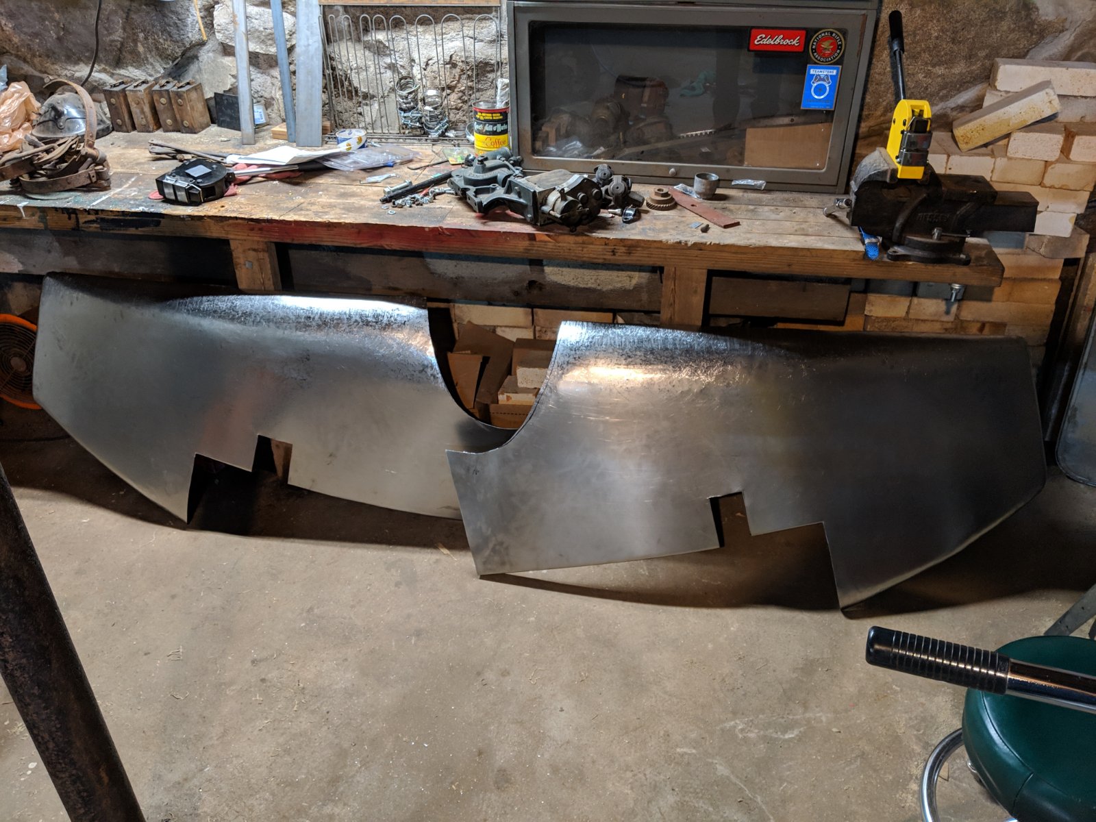

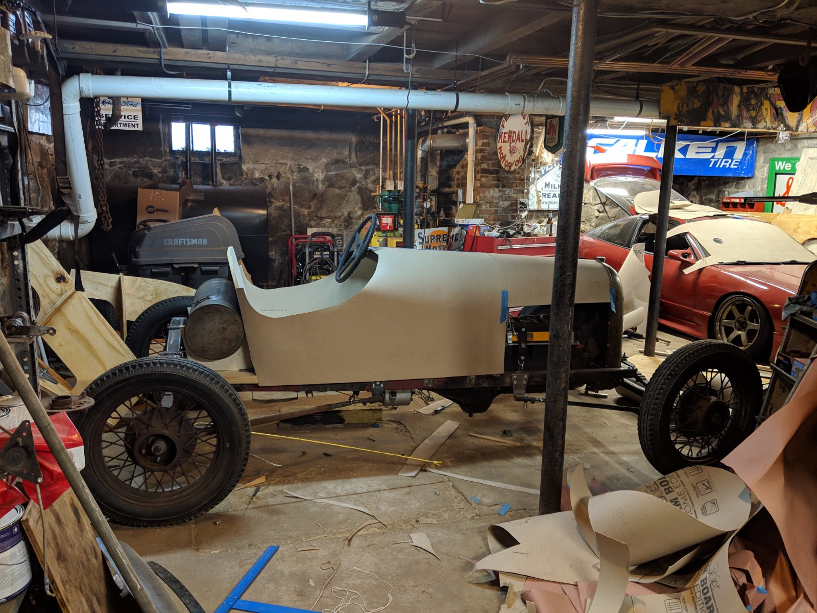

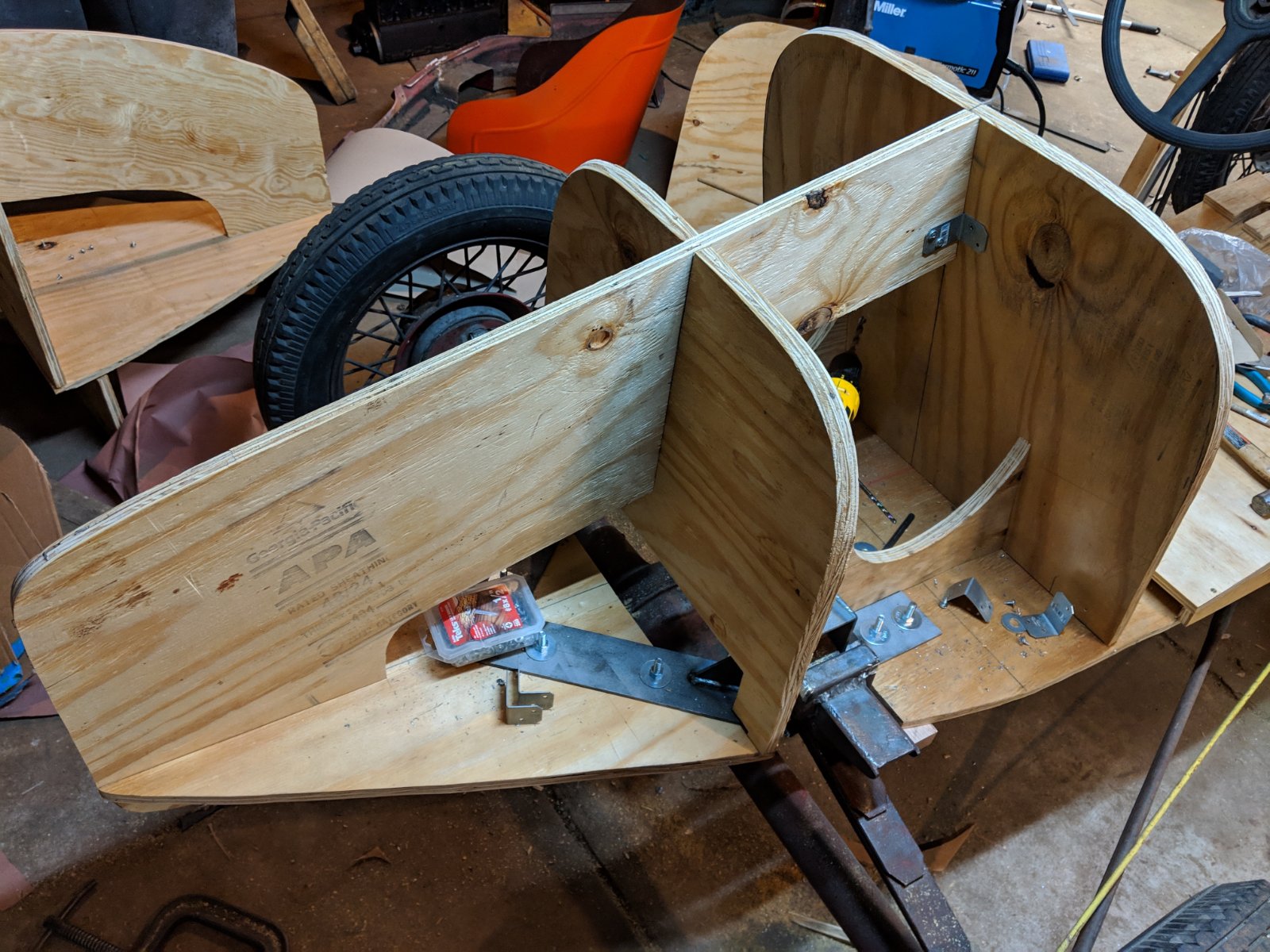

After a lot of modifying I ran a paper template I was happy with. Because the rear cross member sat above the frame line, I had to come up with a bracket that supported the tail. Weld project number 2.

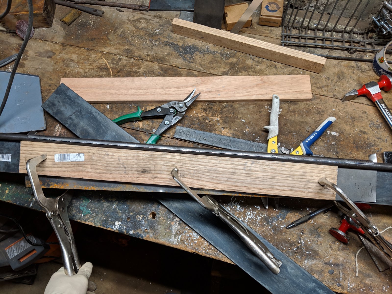

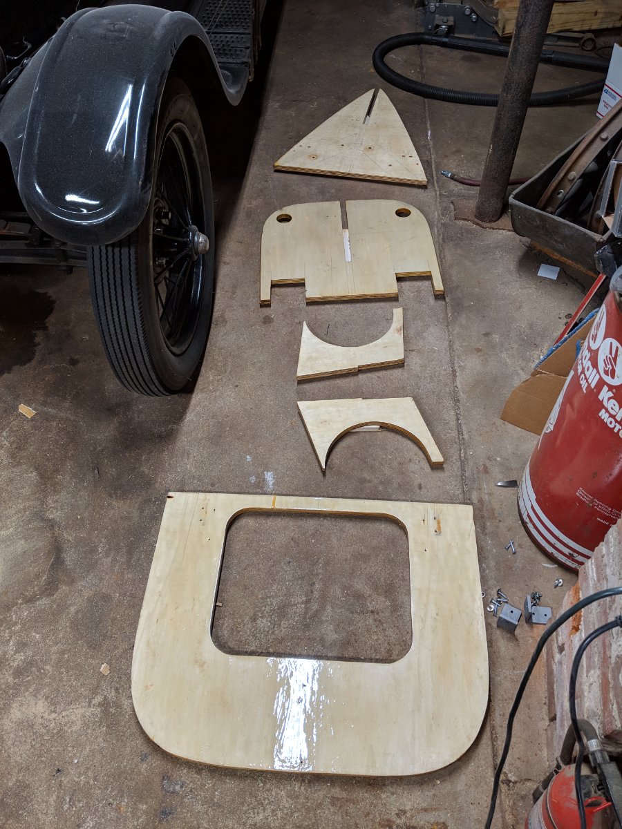

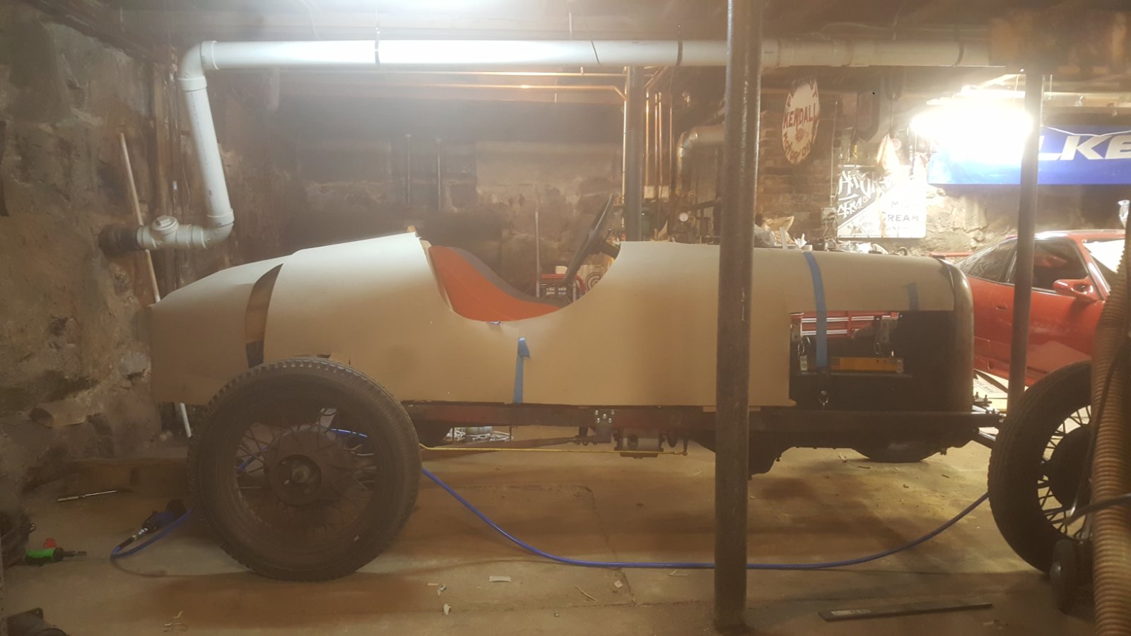

I then took my cheap plywood panels and transferred them to nicer materials.

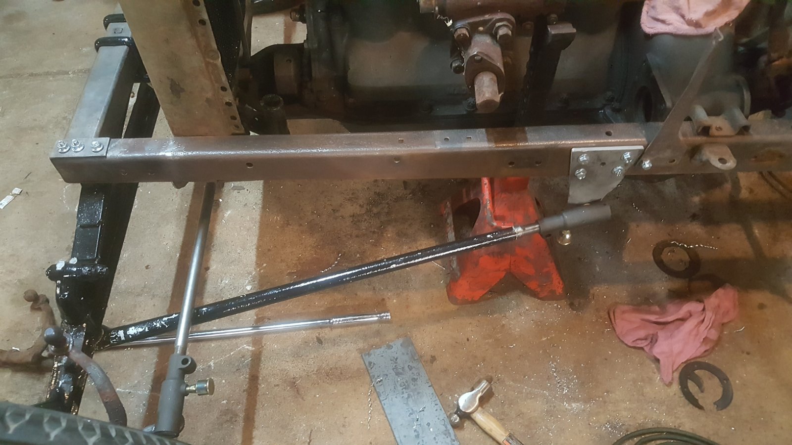

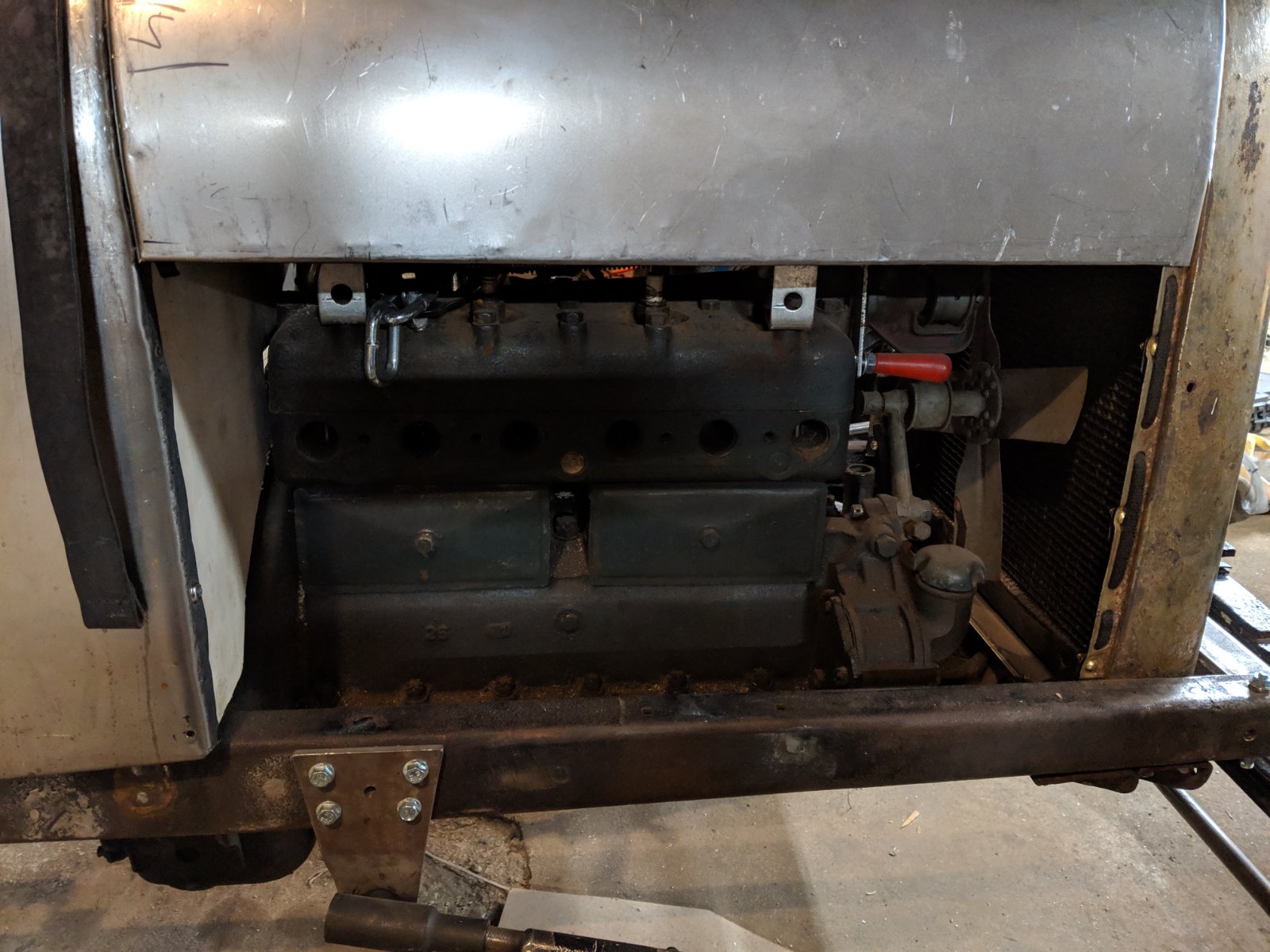

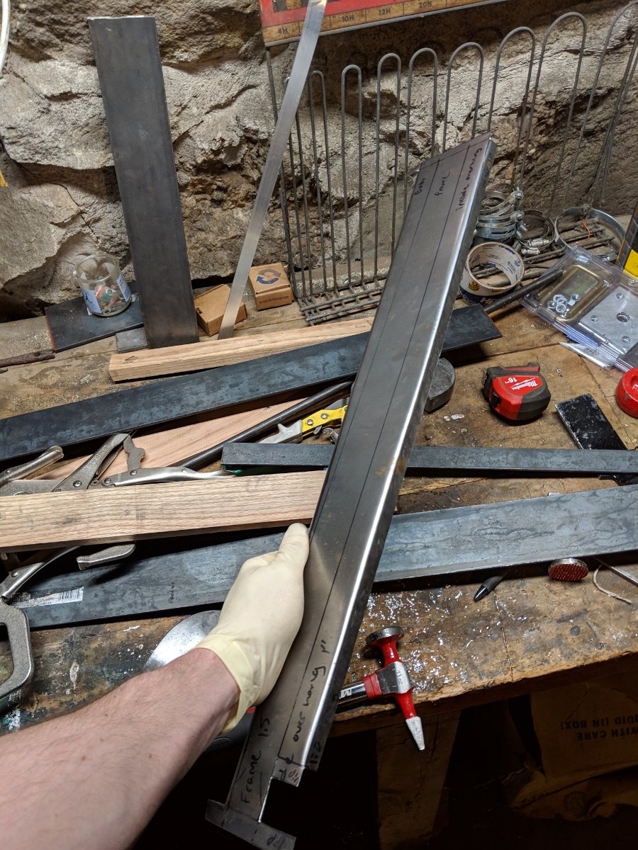

This shows the updated front lowering design. I did a Z bracket from the first cross member I made. The model T cross member has been set back 6" in the frame for a better balance and the raked out look of the old racers.

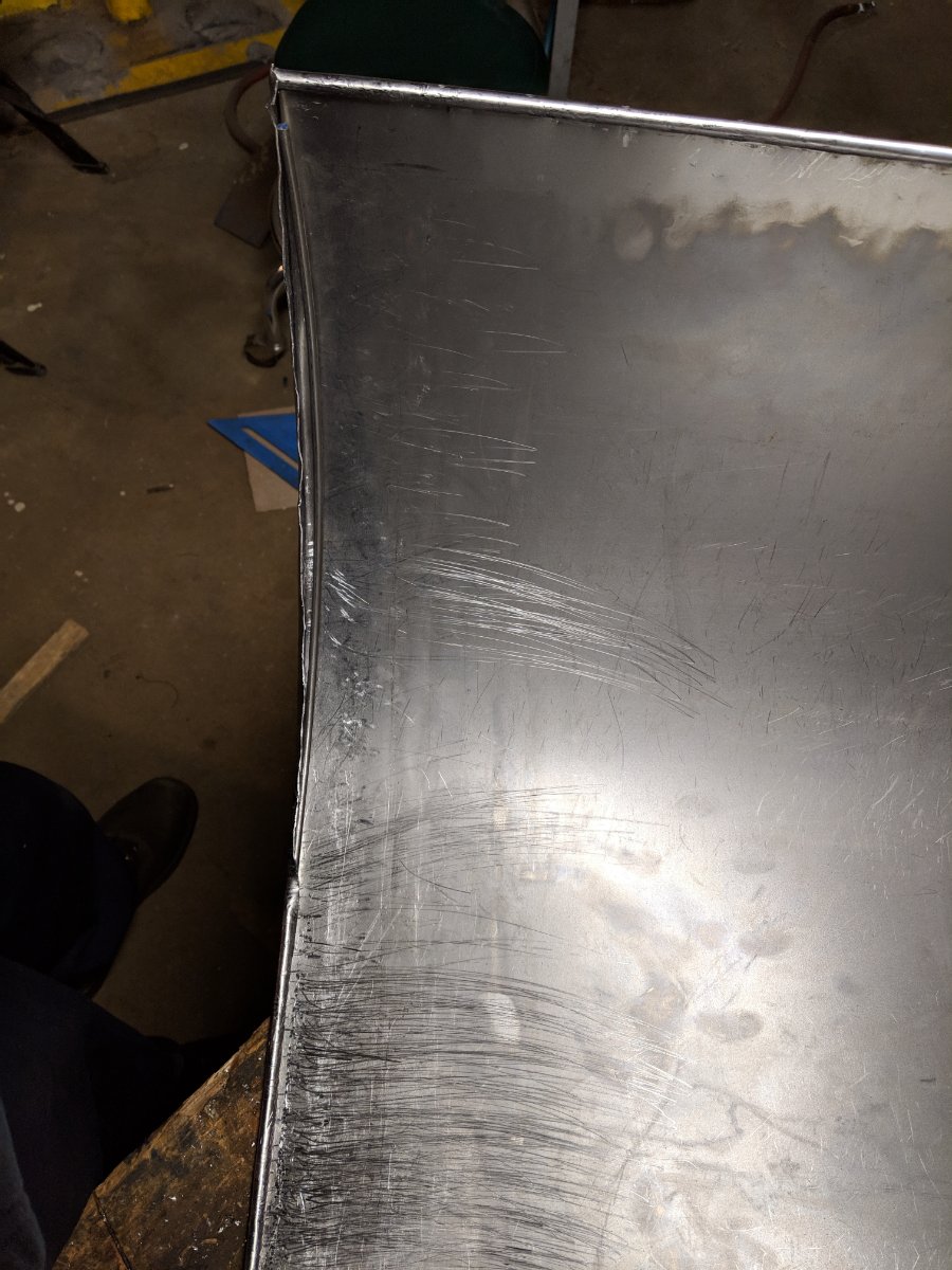

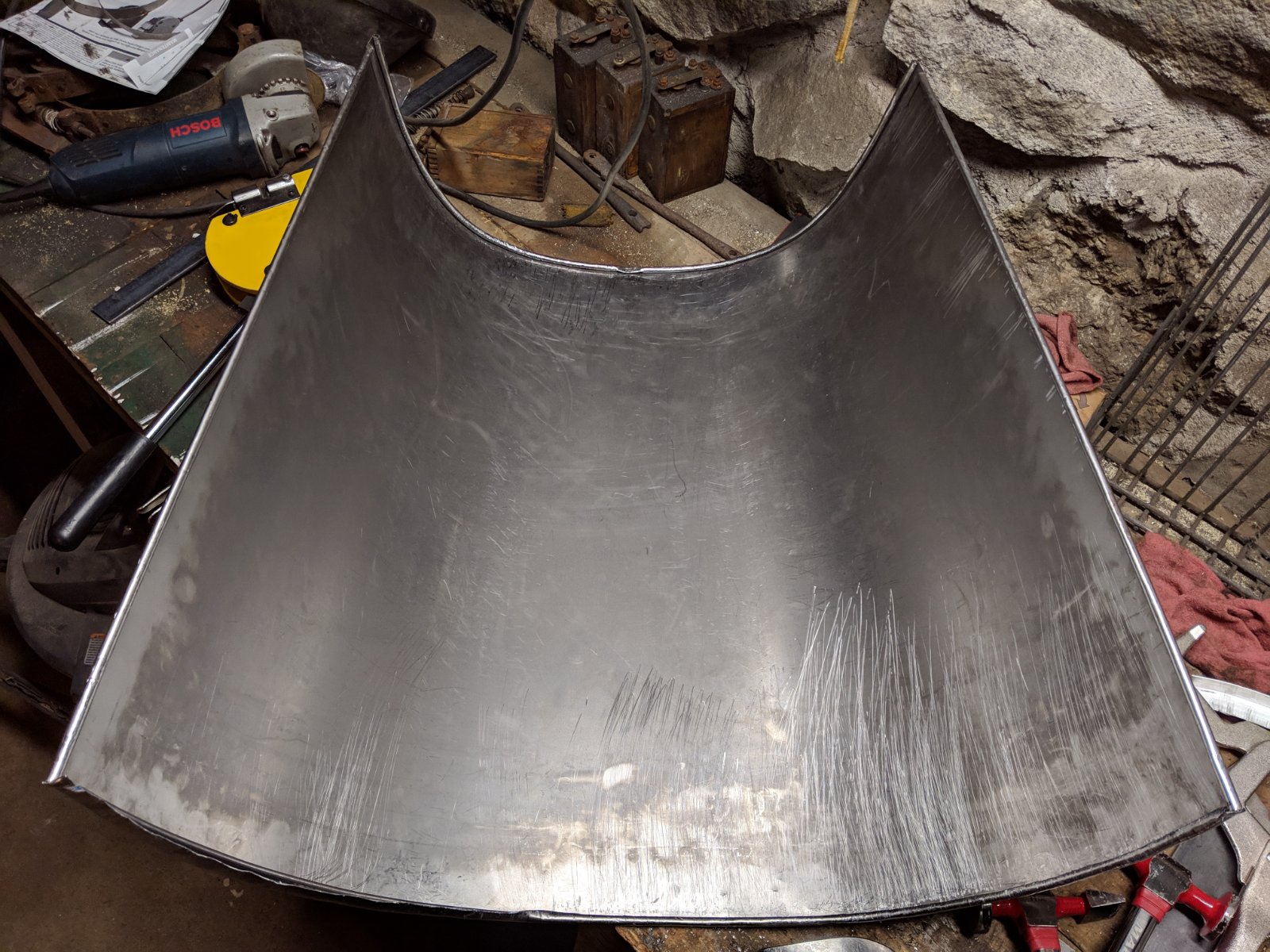

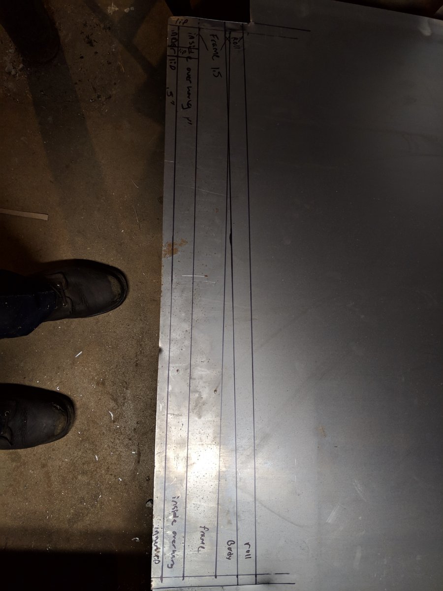

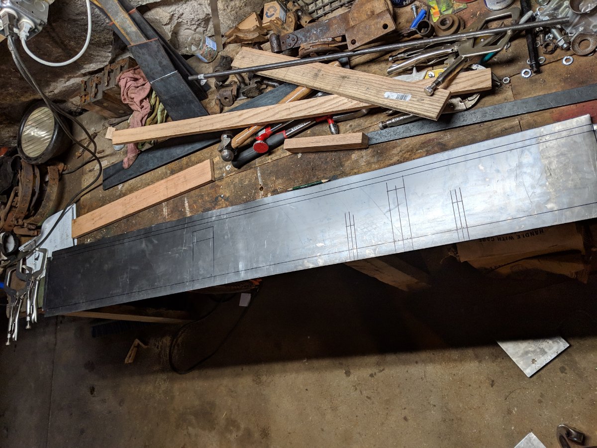

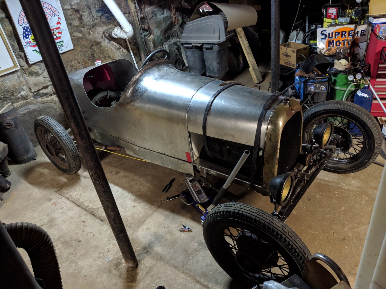

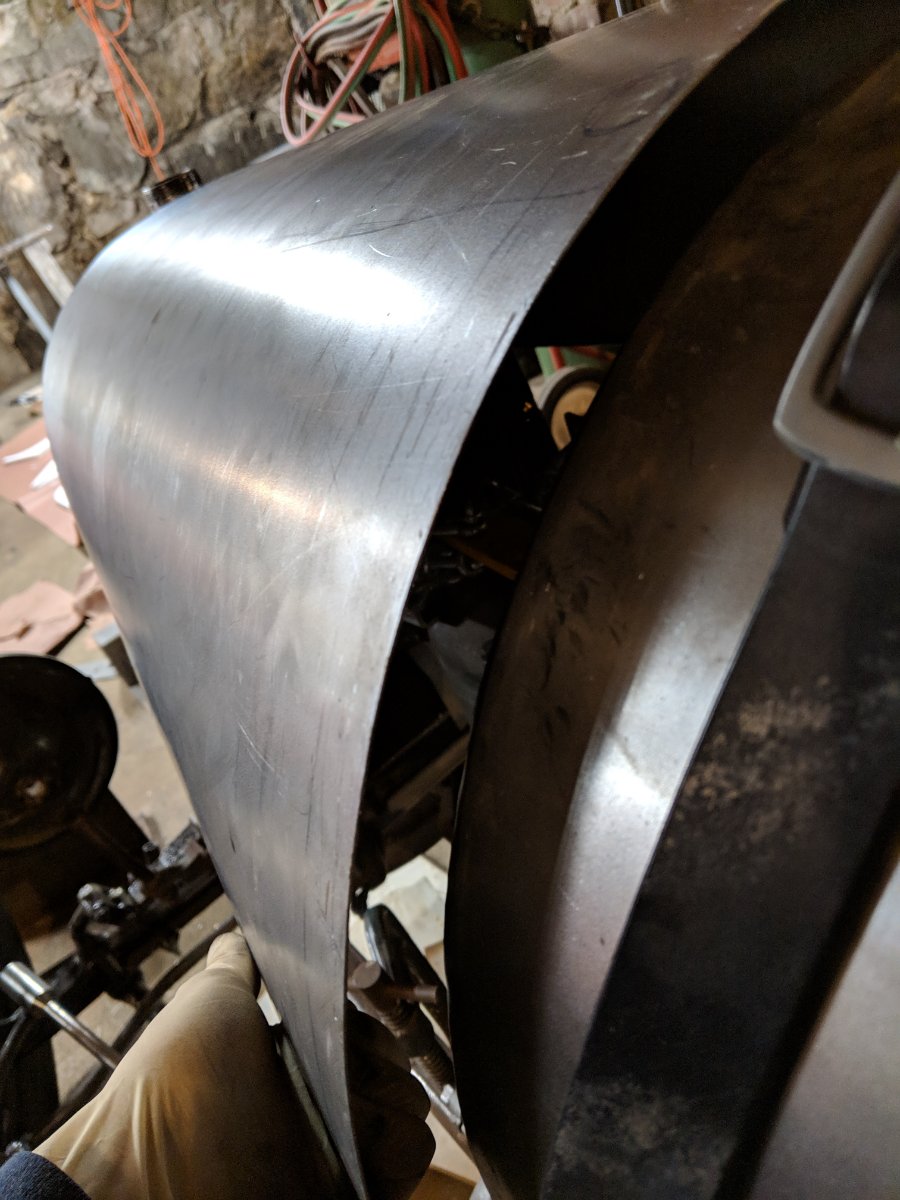

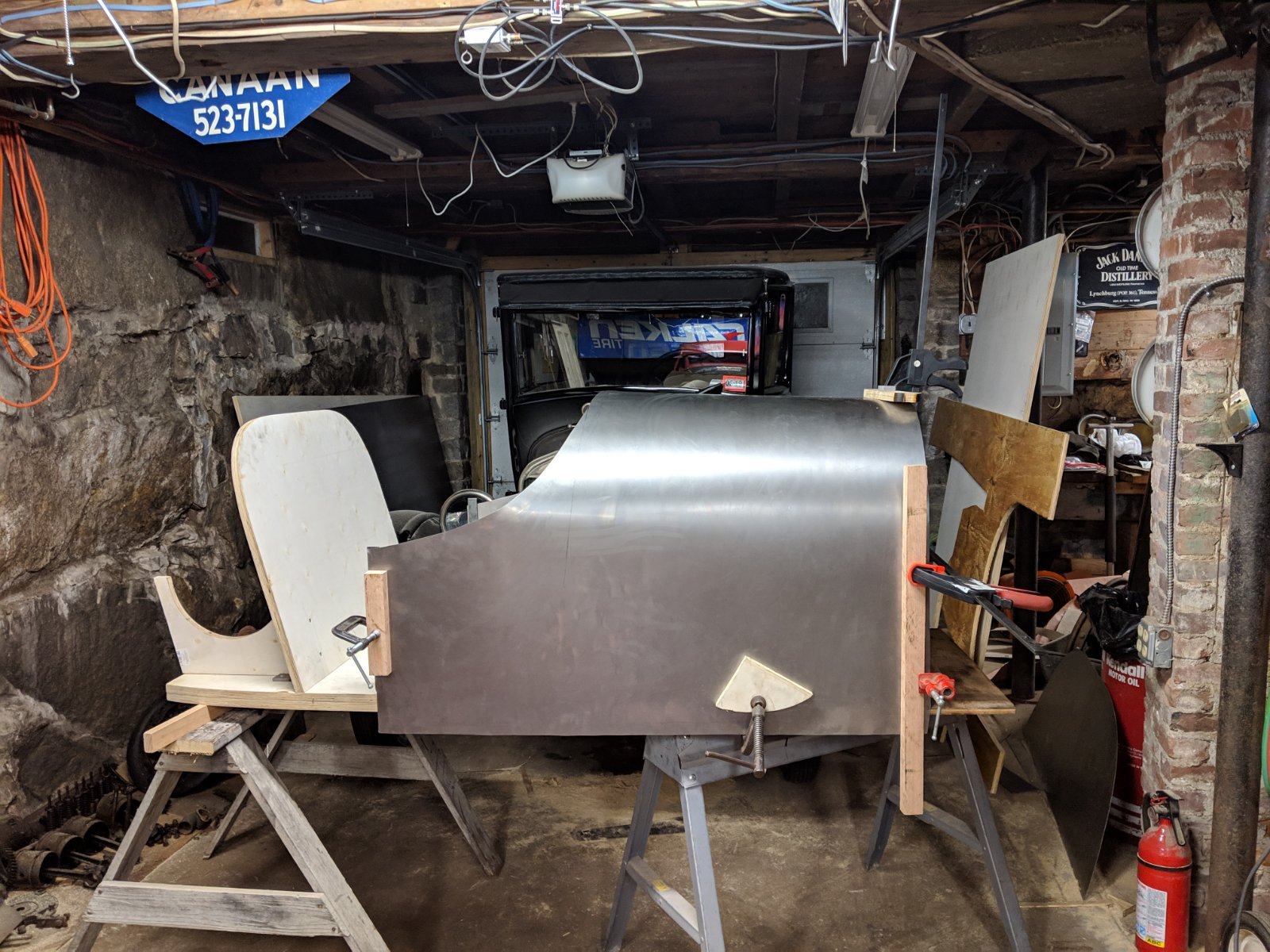

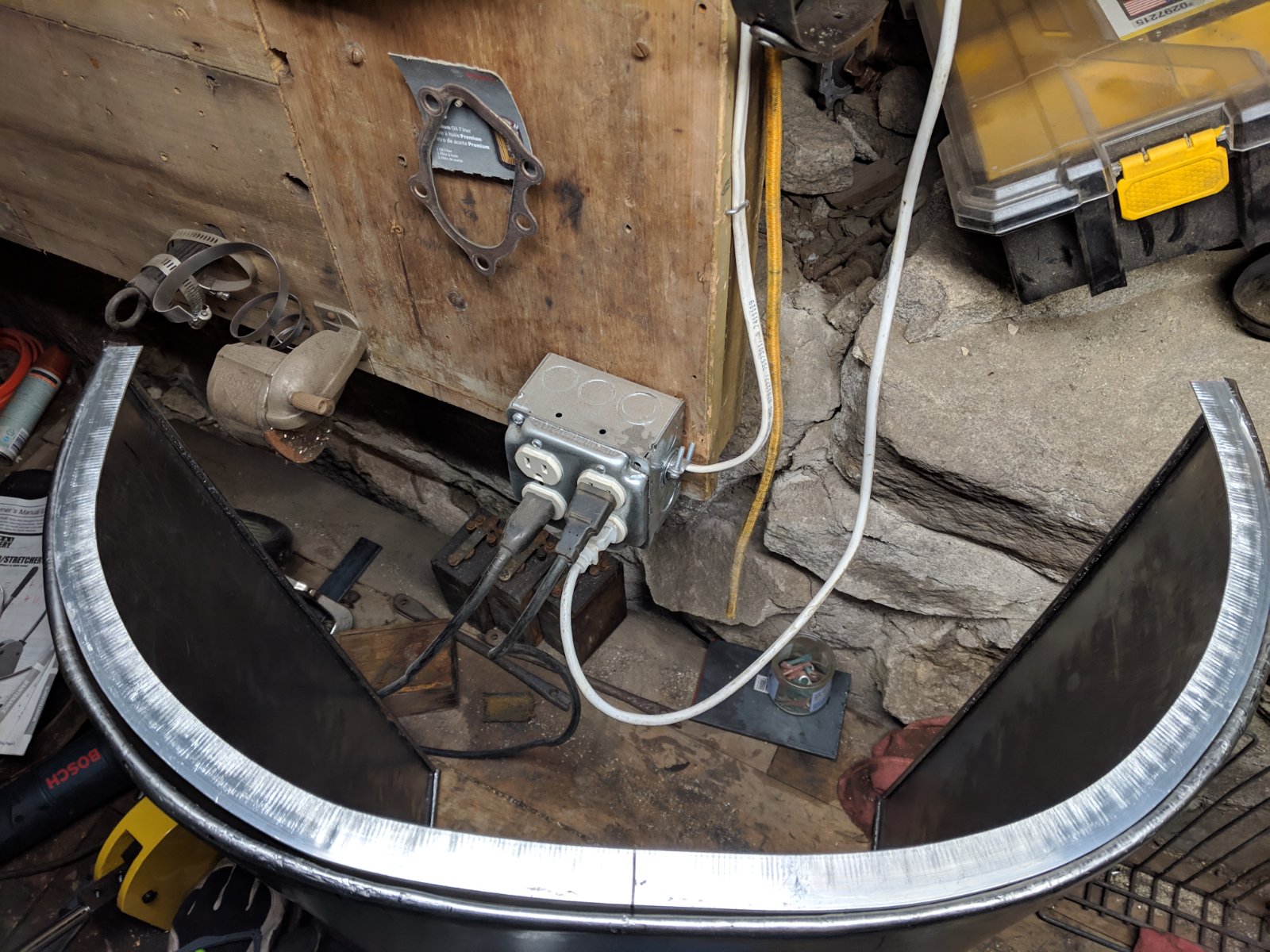

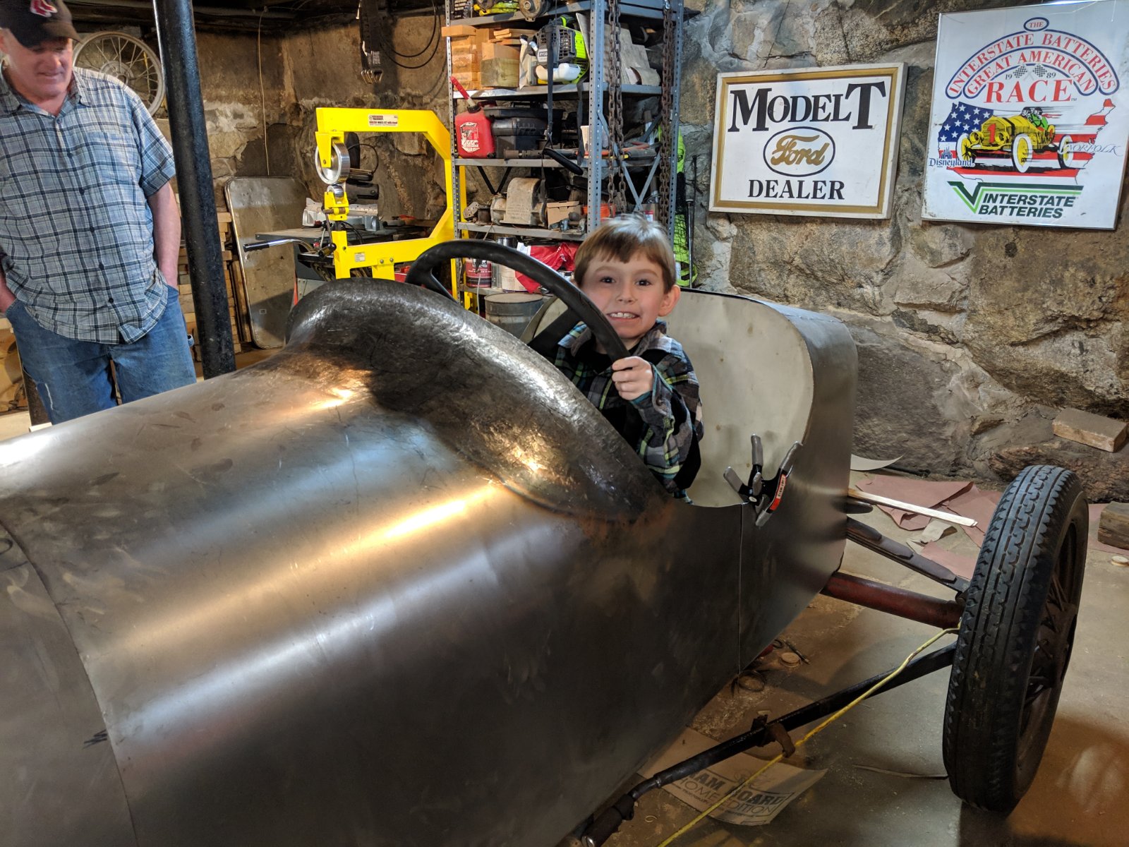

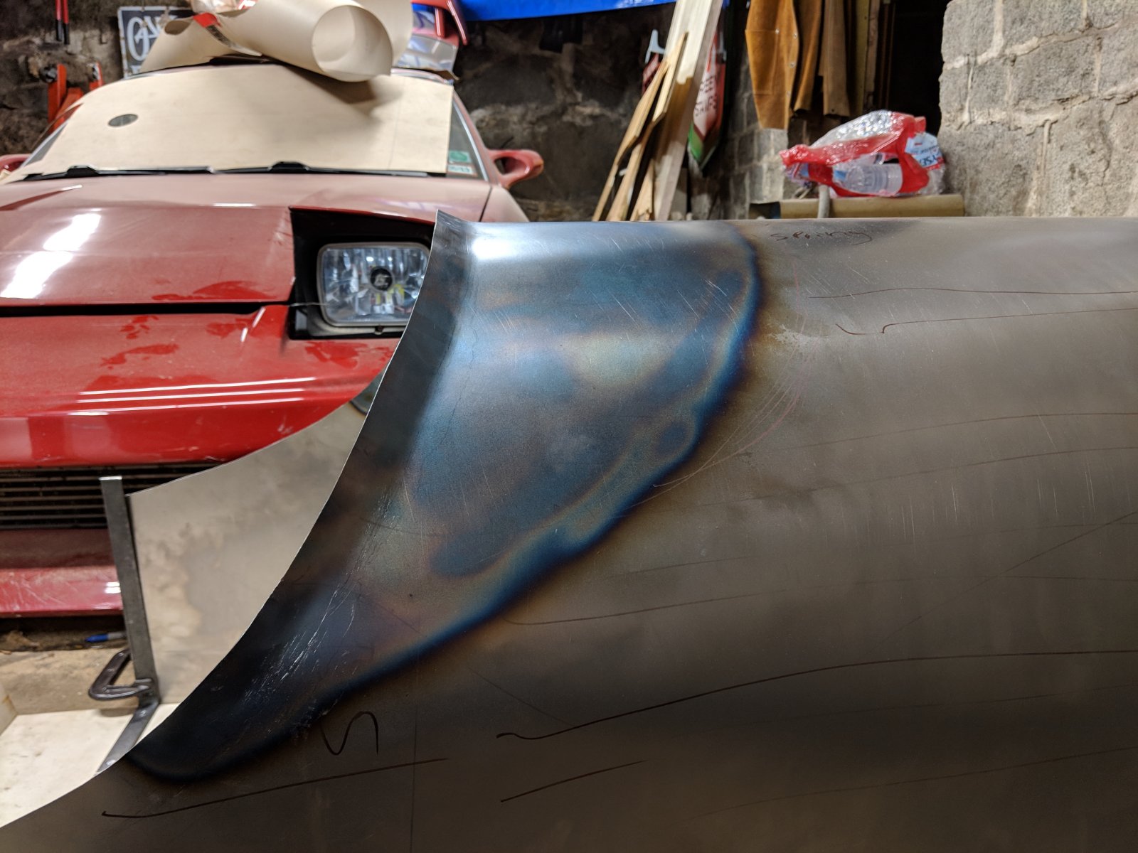

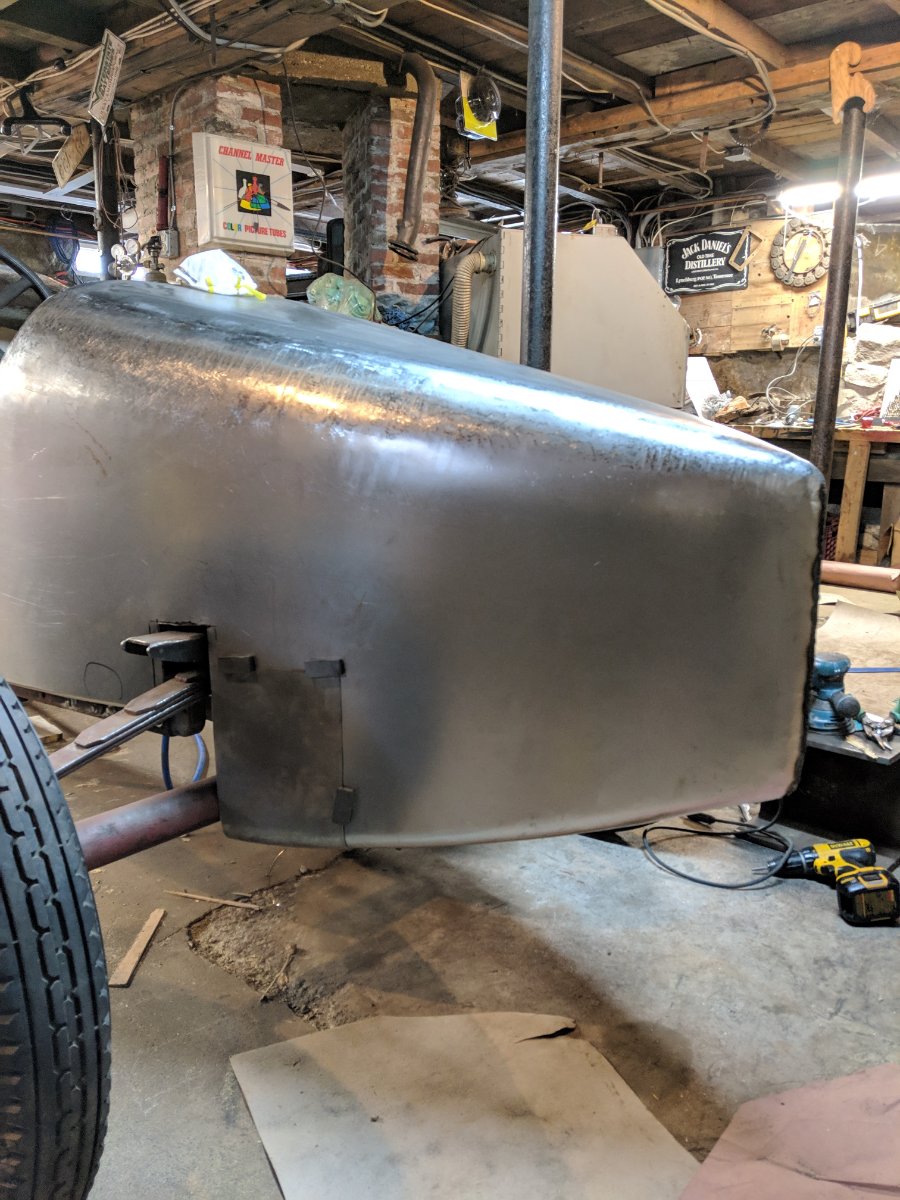

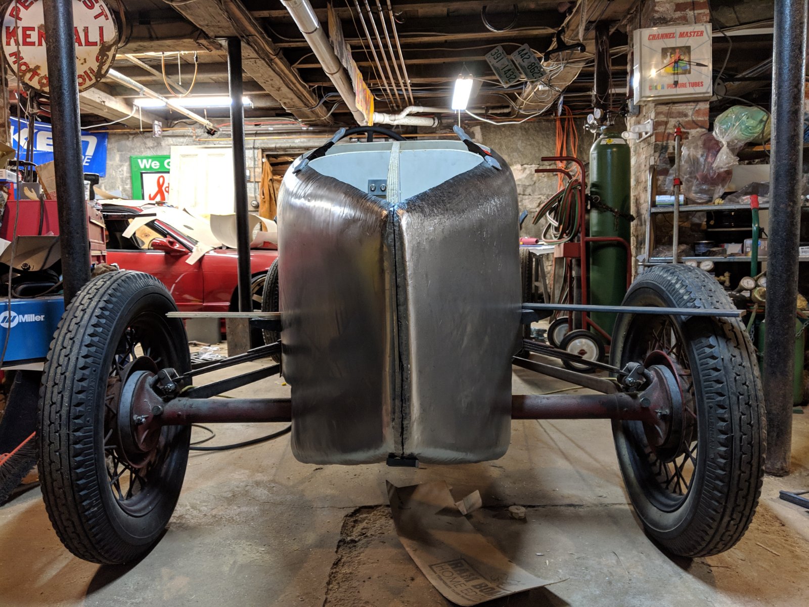

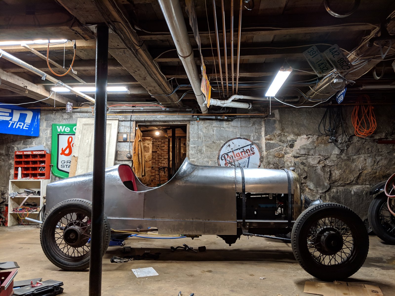

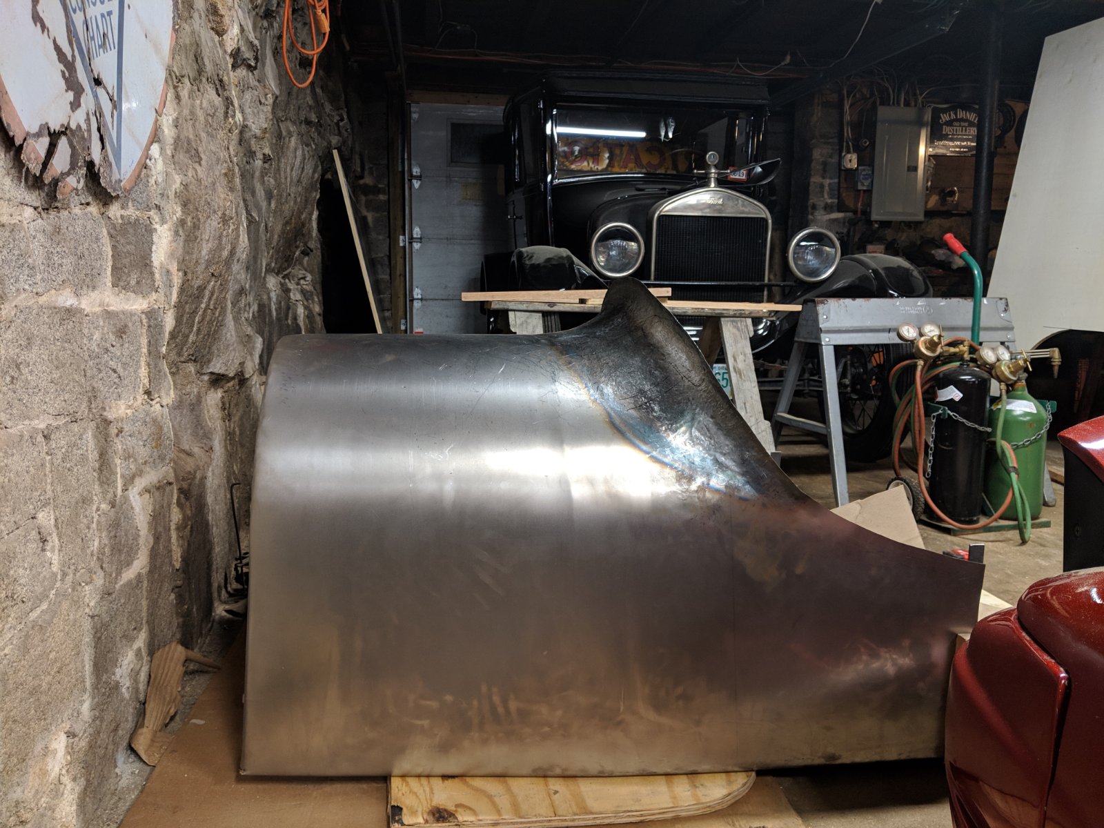

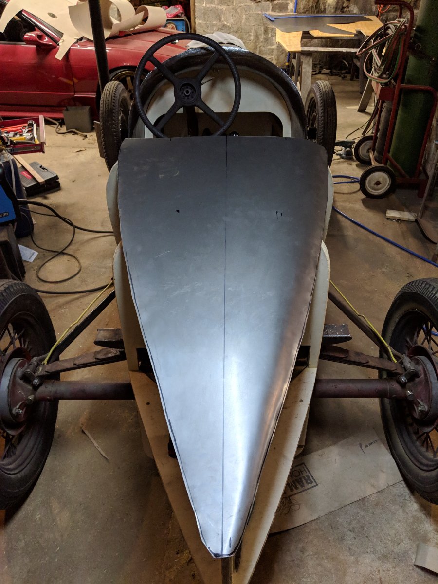

I then bought some sheet metal!

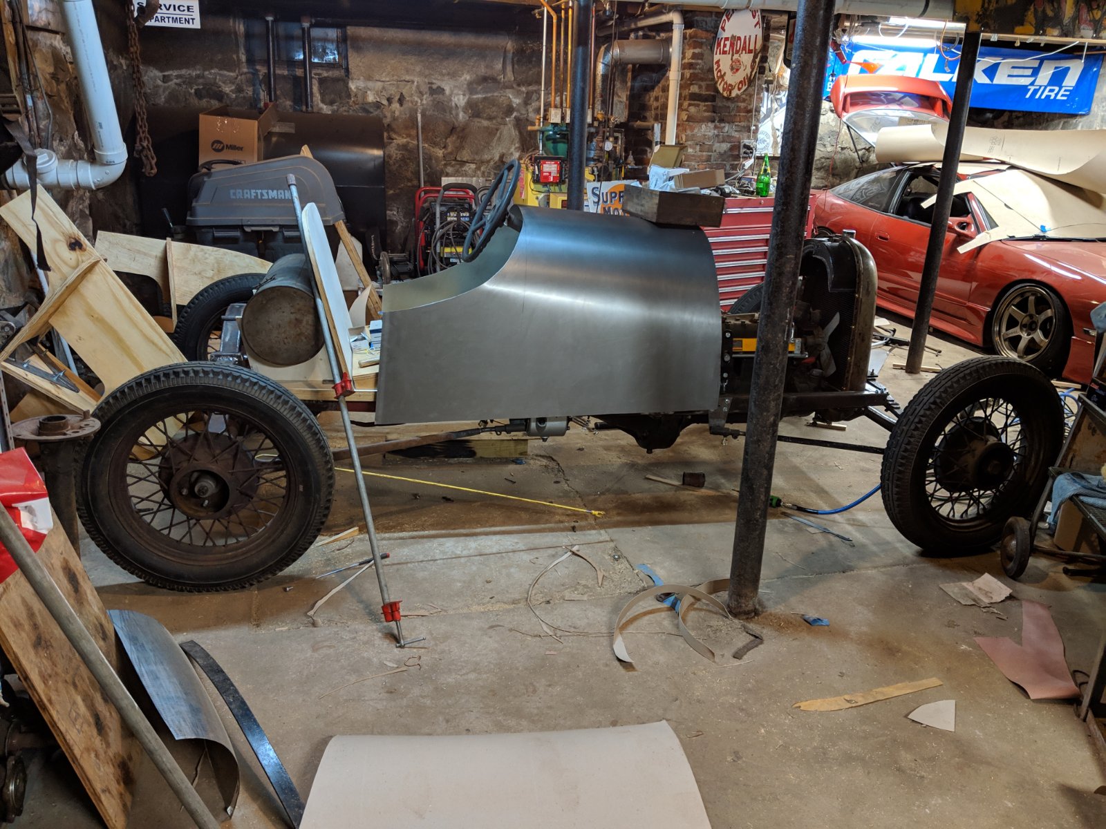

Began flaring the cowl. Do not use heat. That was a huge mistake.

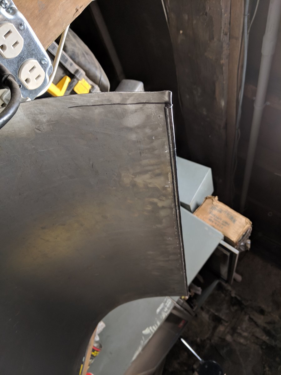

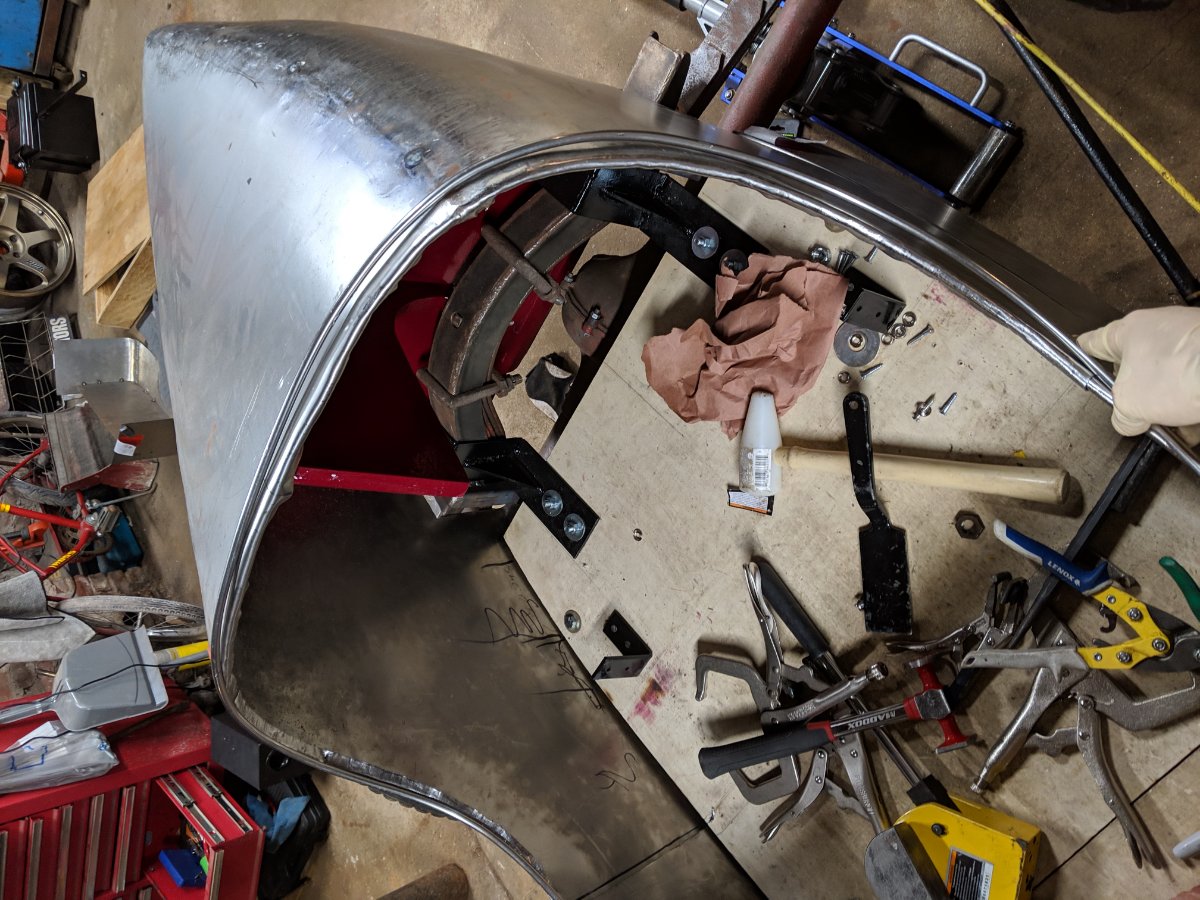

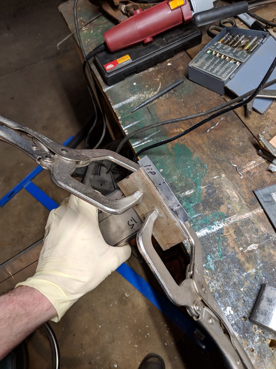

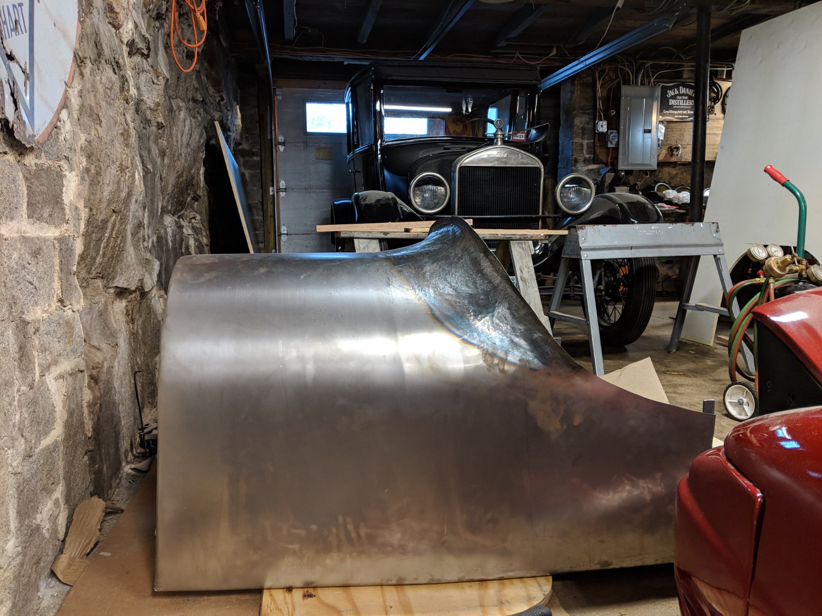

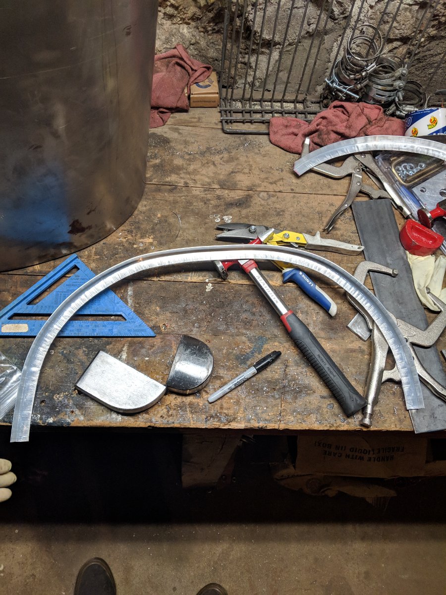

More flaring. All hammer and dolly. I don't own any nice fancy tools.

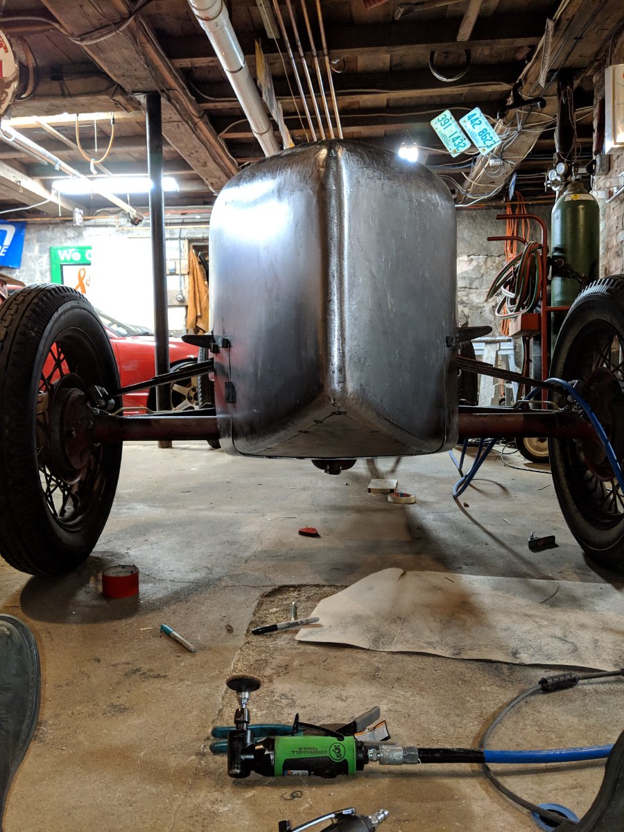

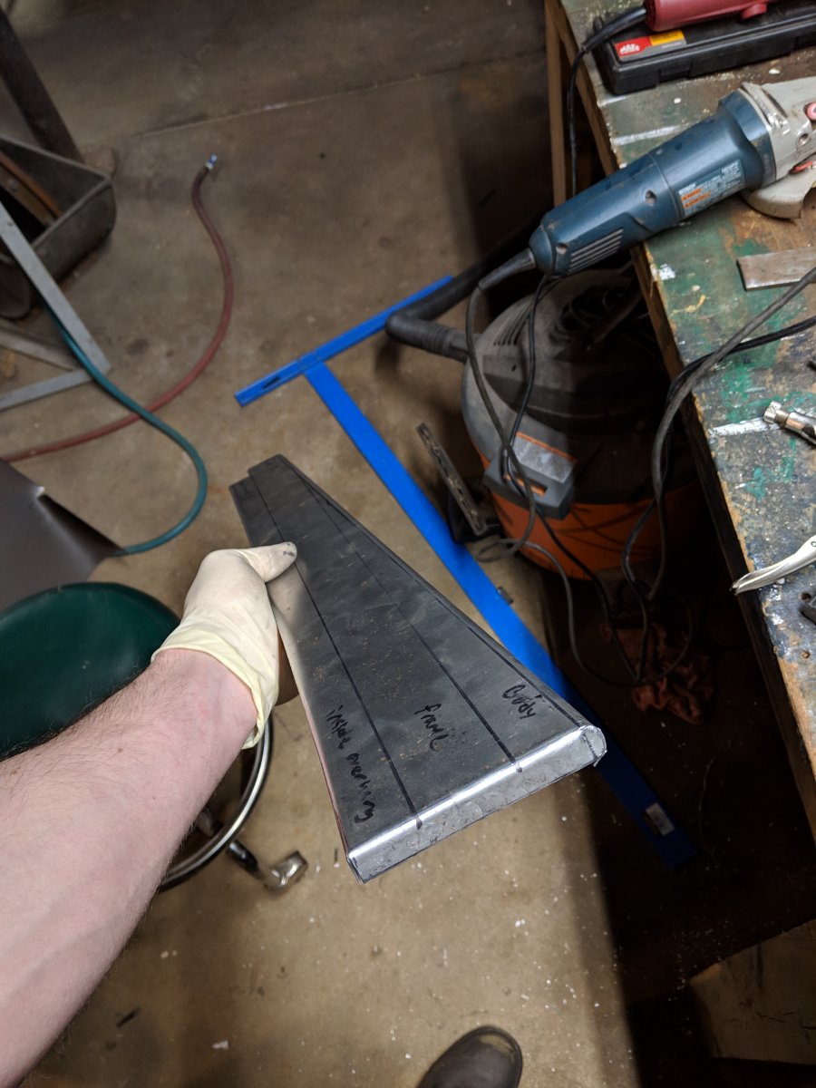

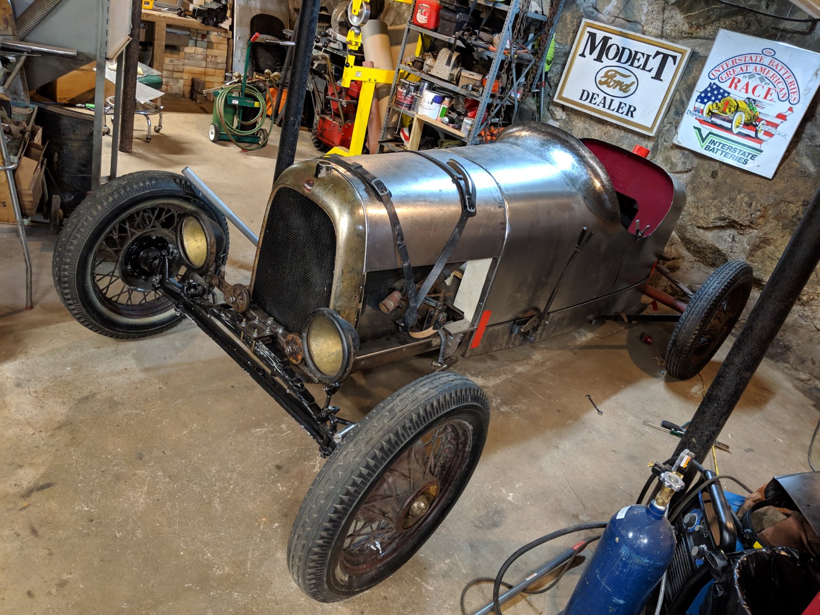

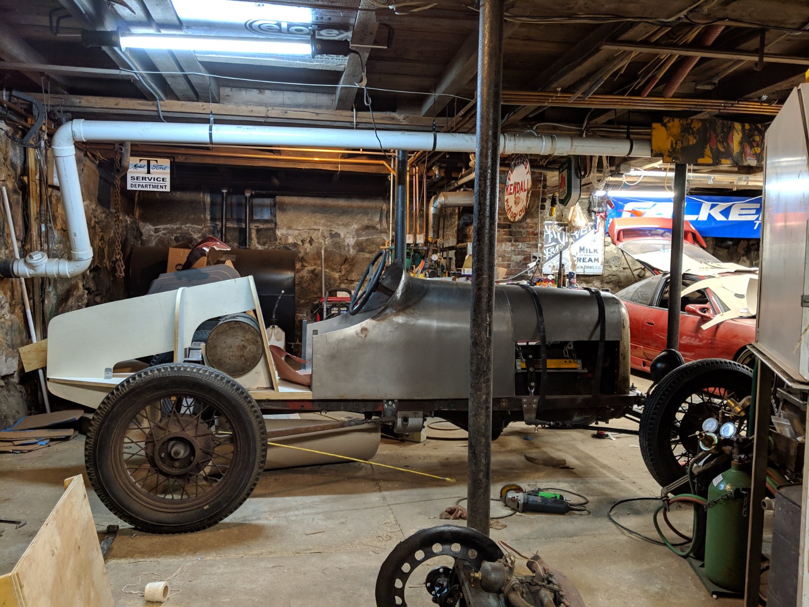

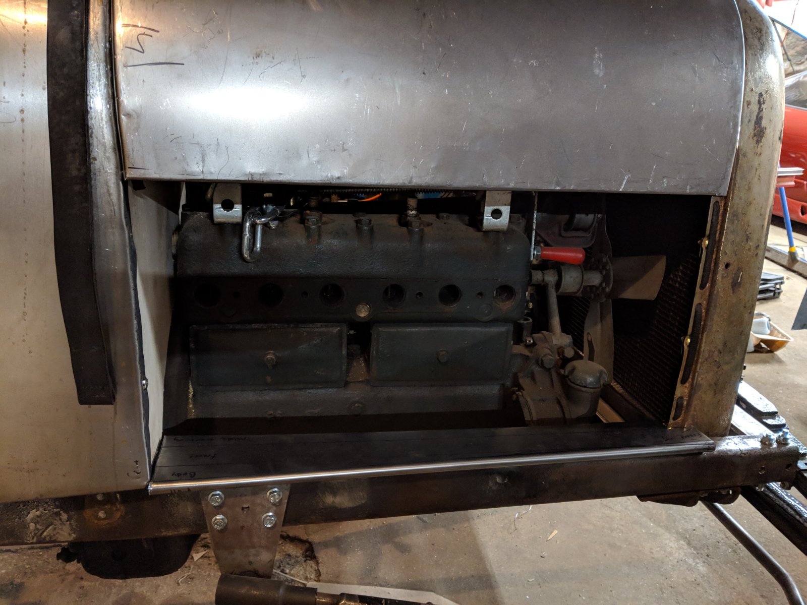

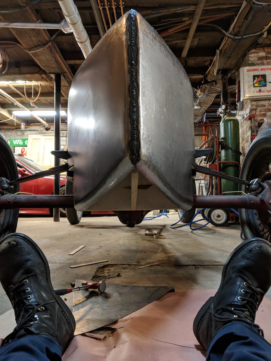

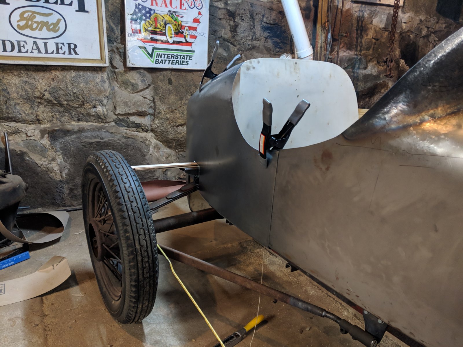

I whipped up a quick hood to lay on and had to throw the straps on obviously.

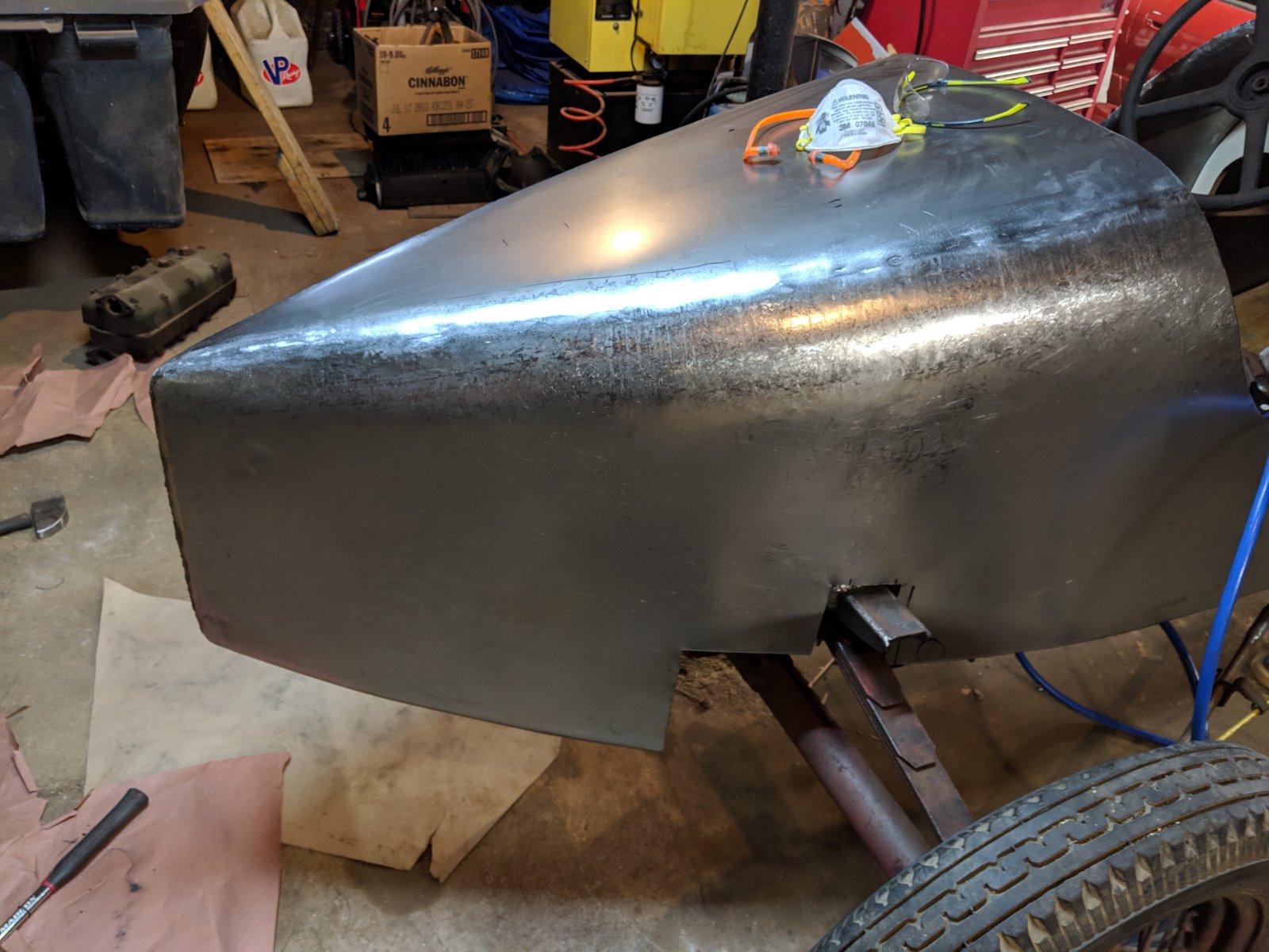

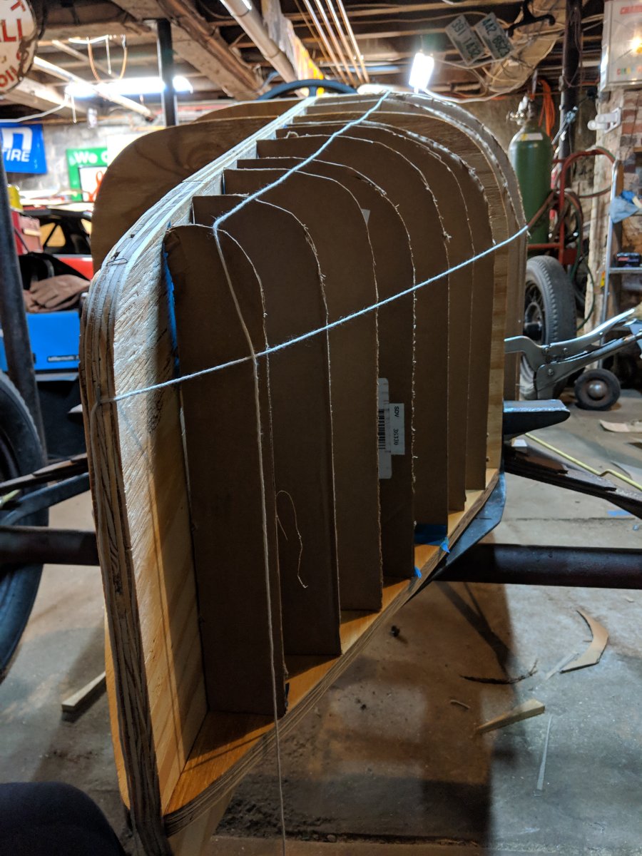

Then moved back to the tail skeleton/buck. More paper and templates!

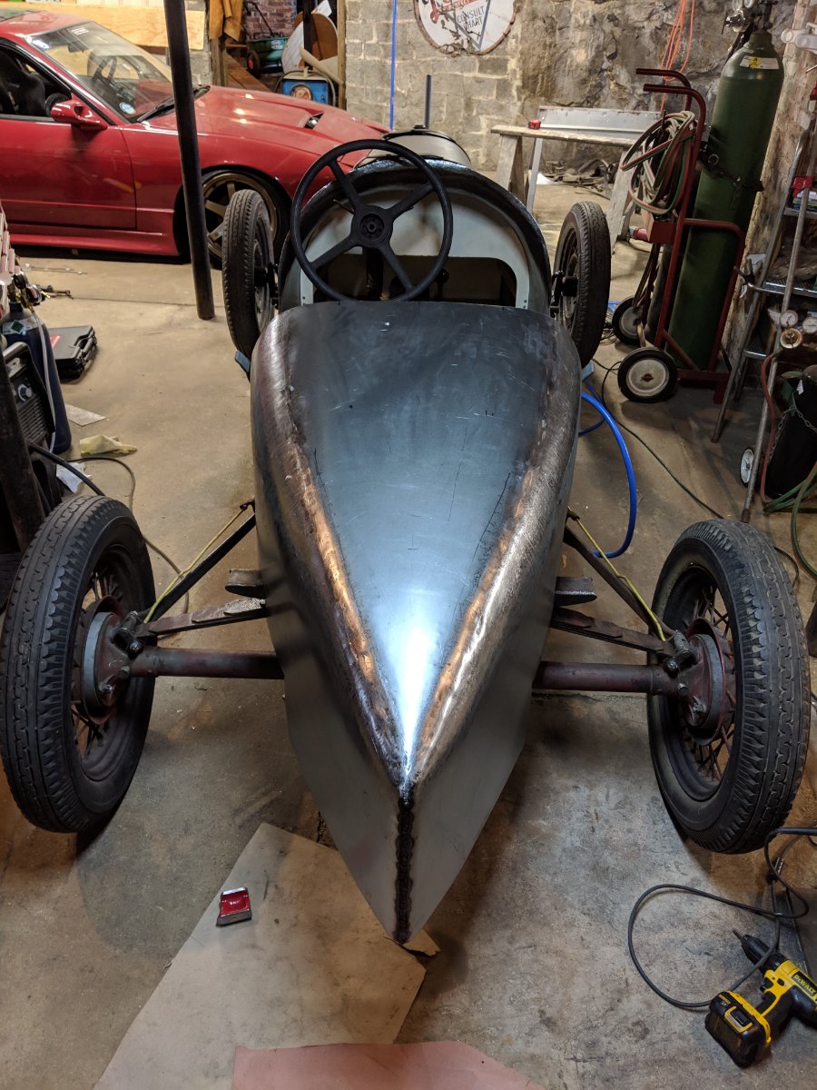

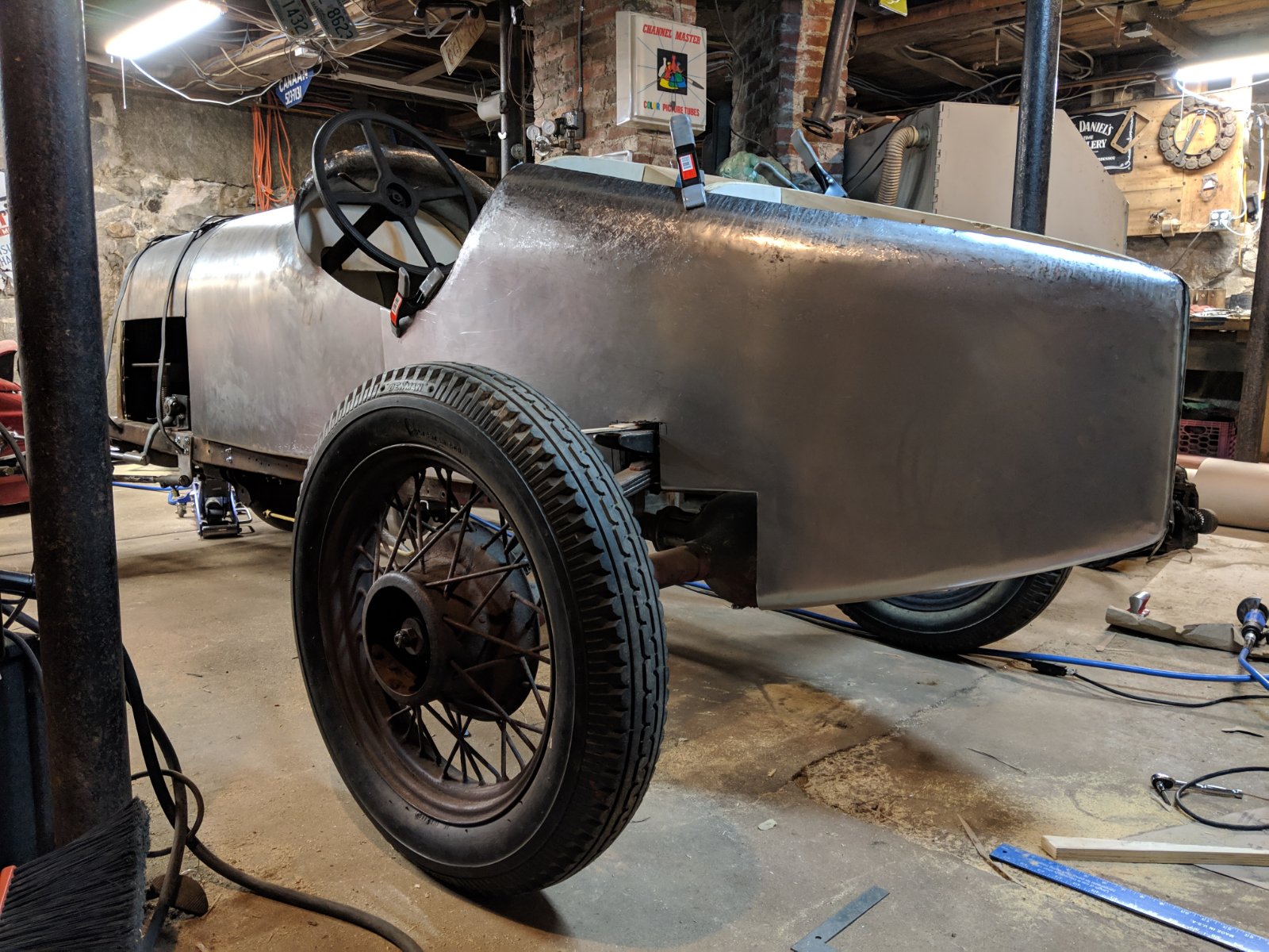

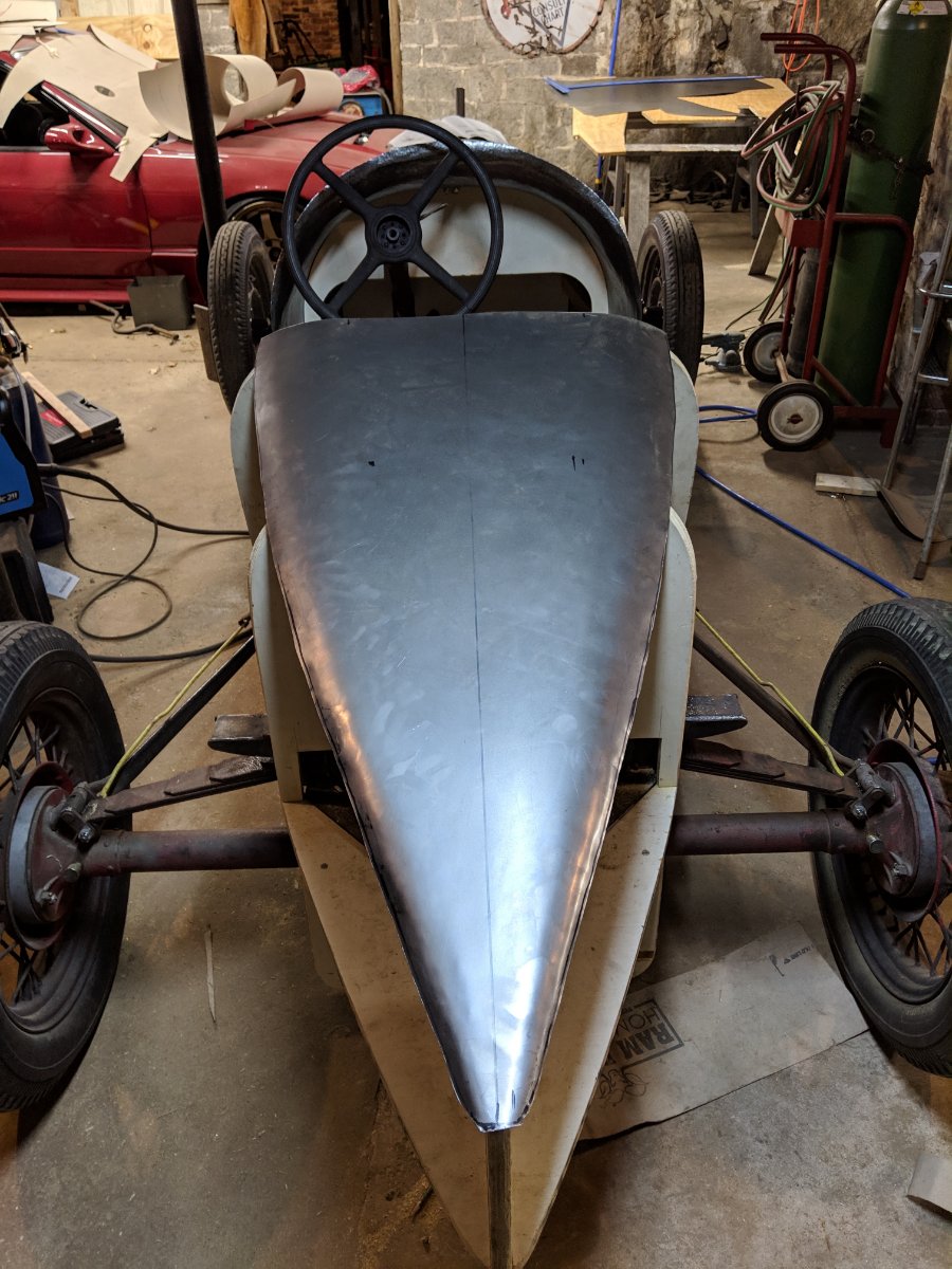

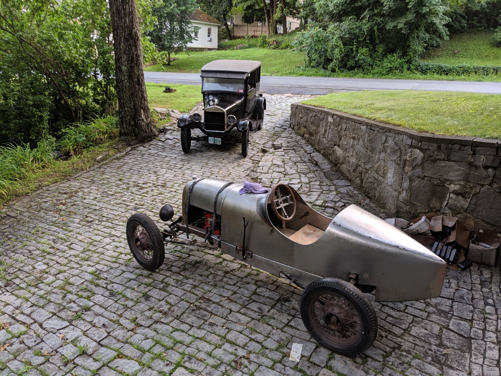

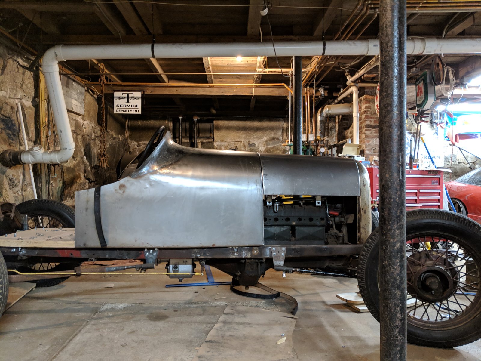

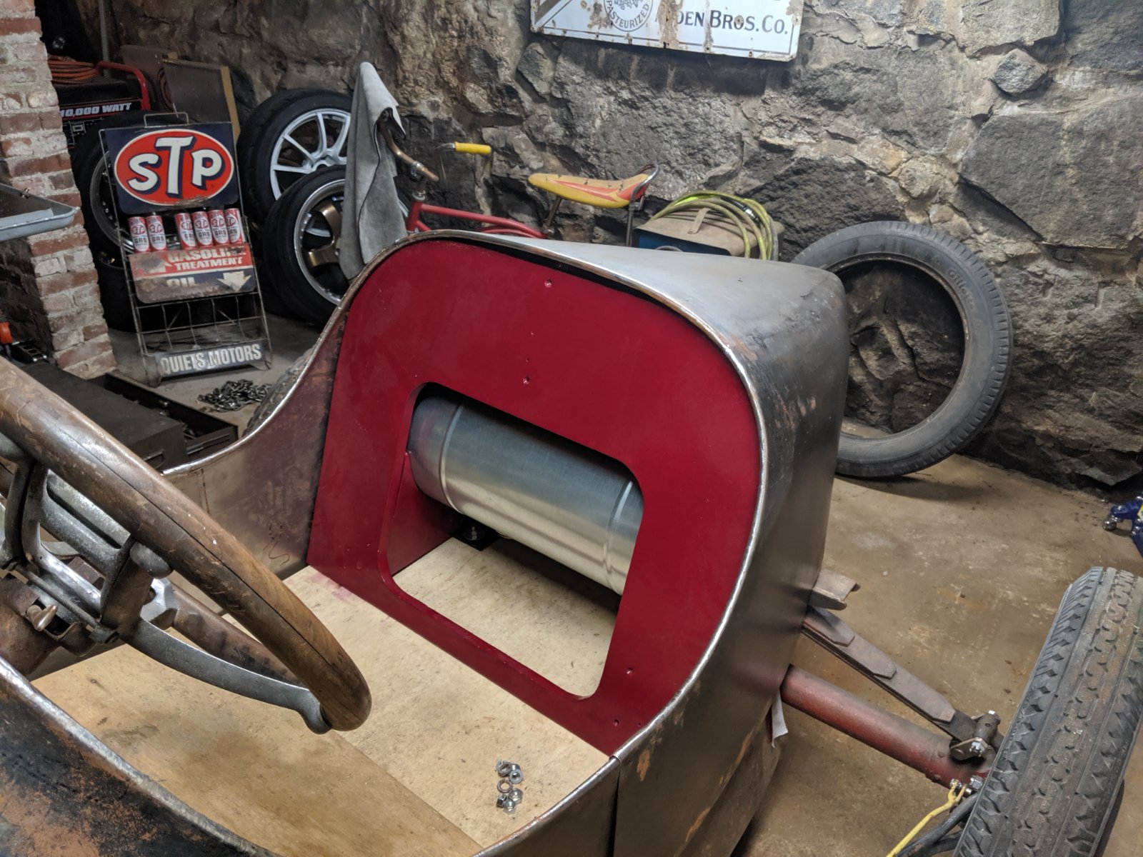

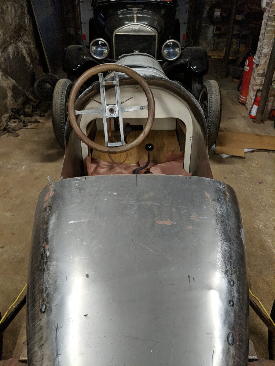

Not too shabby I guess for no sheet metal skill

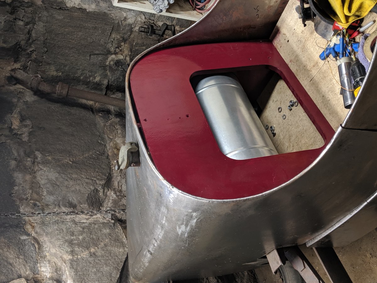

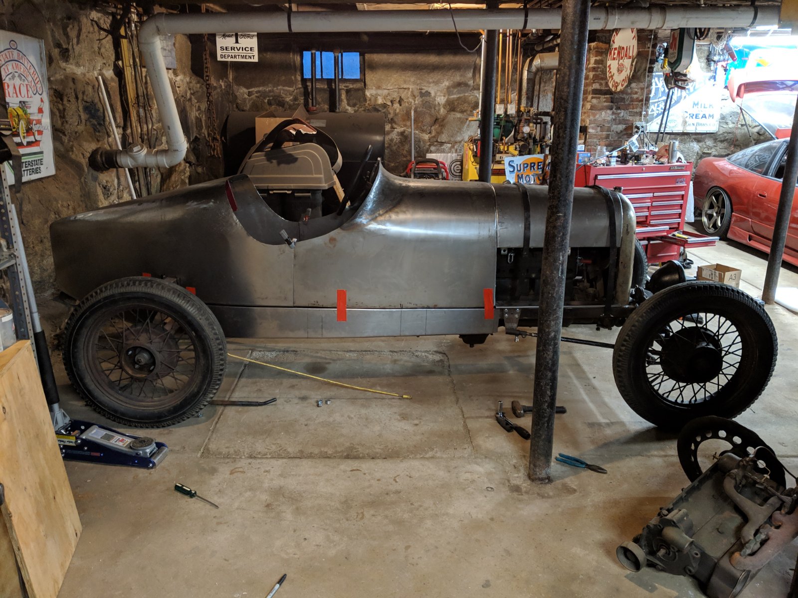

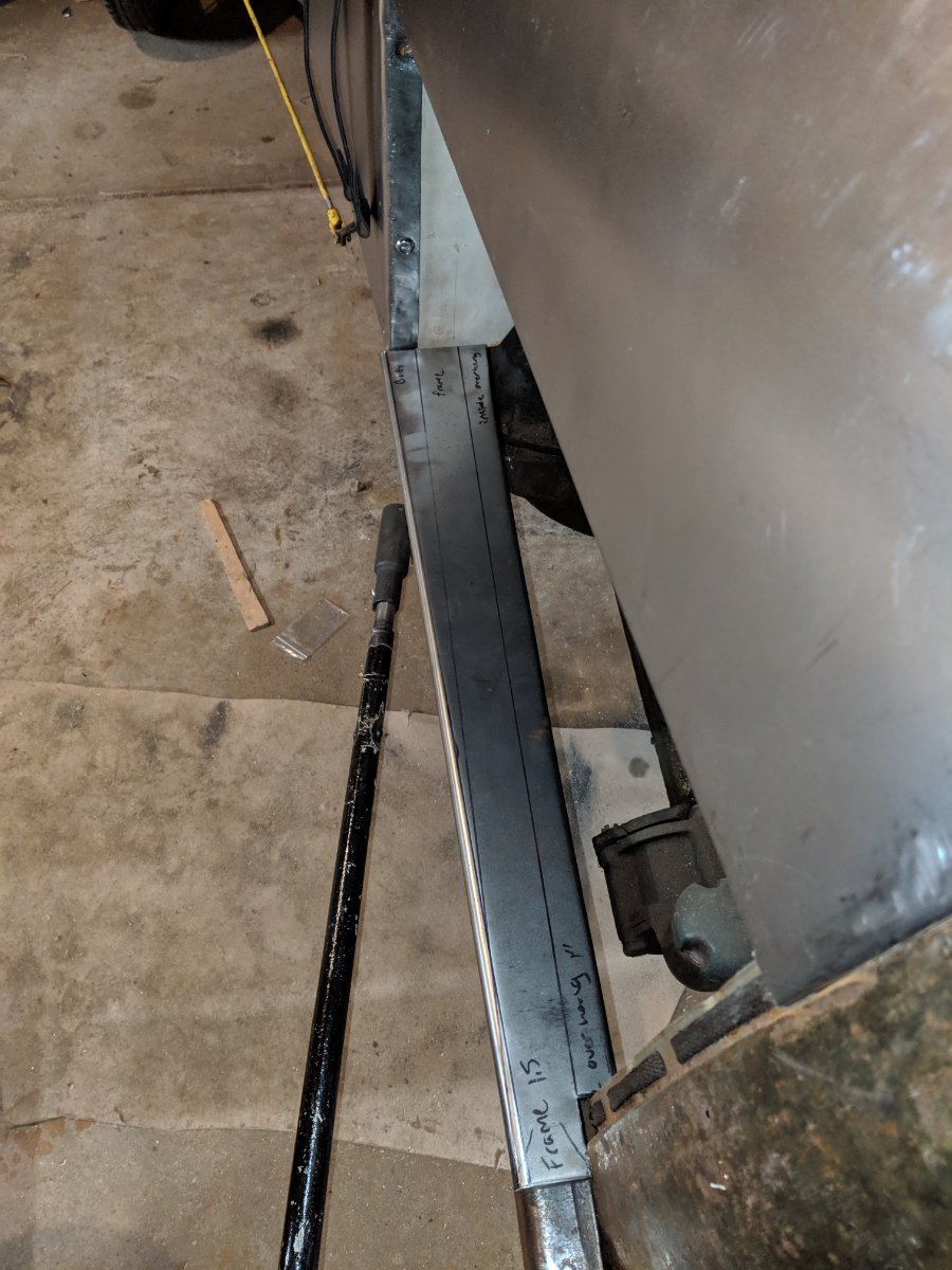

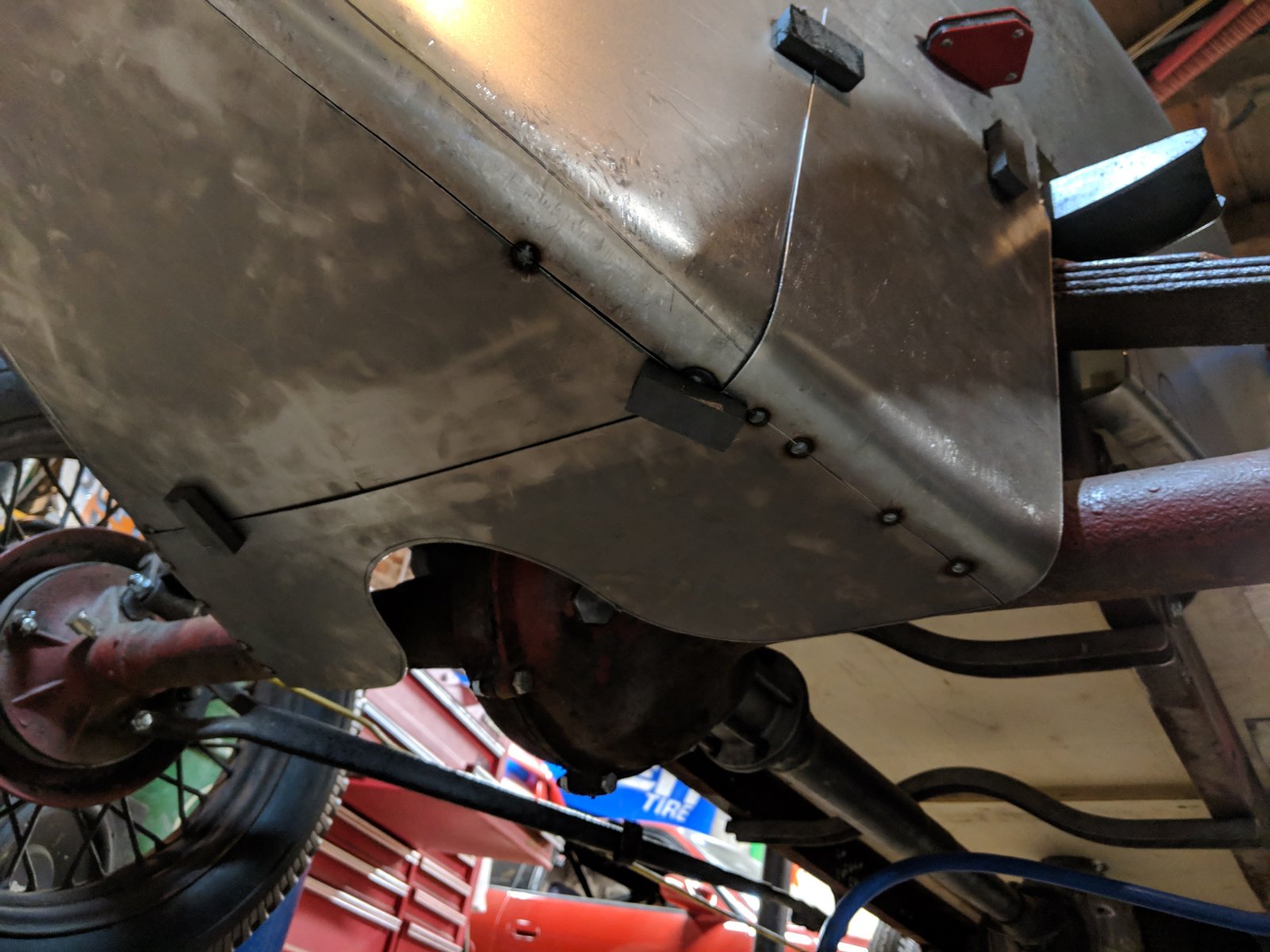

Modified the bottom of the tail for less downward sweep. The car will eventually have skirts and I'd like them to flow with the tail.

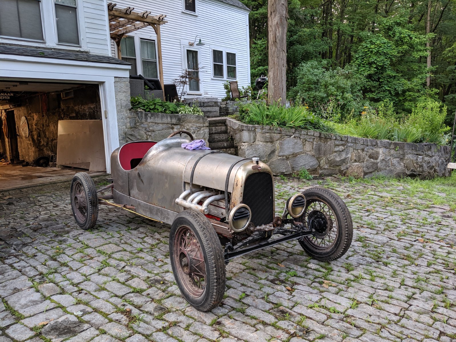

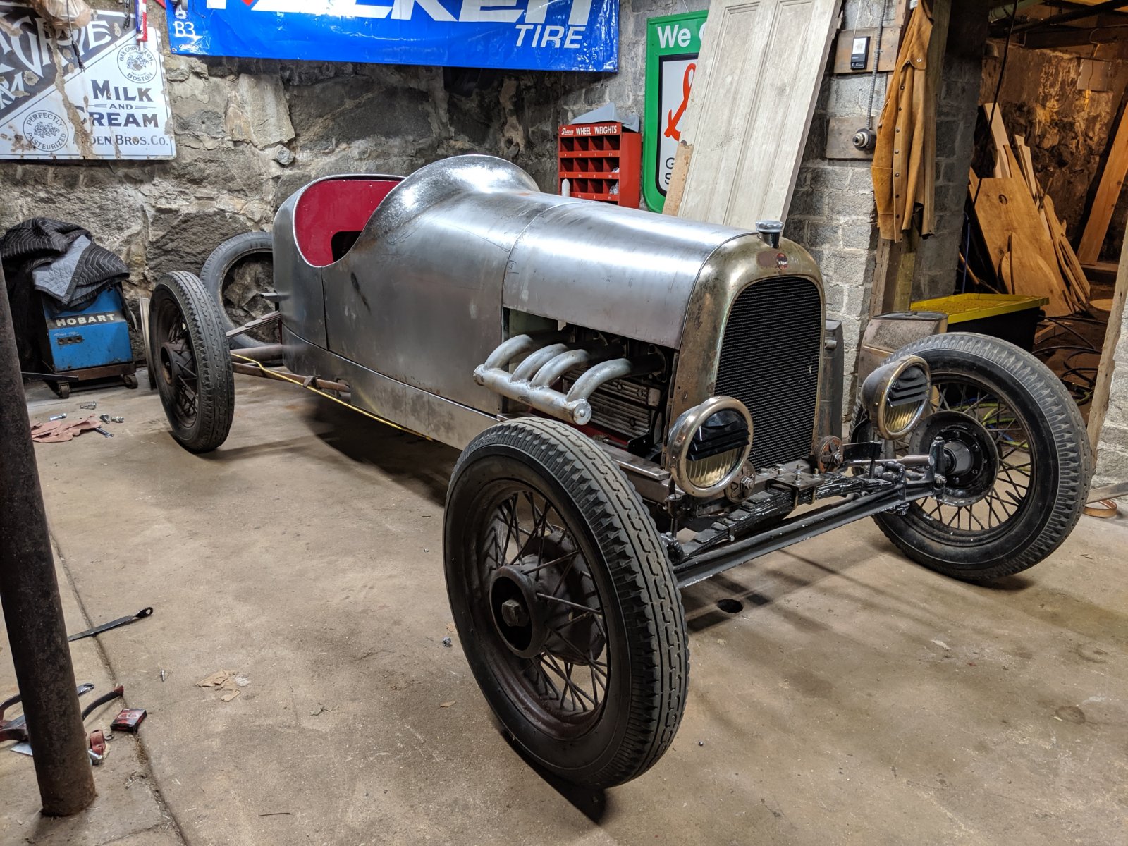

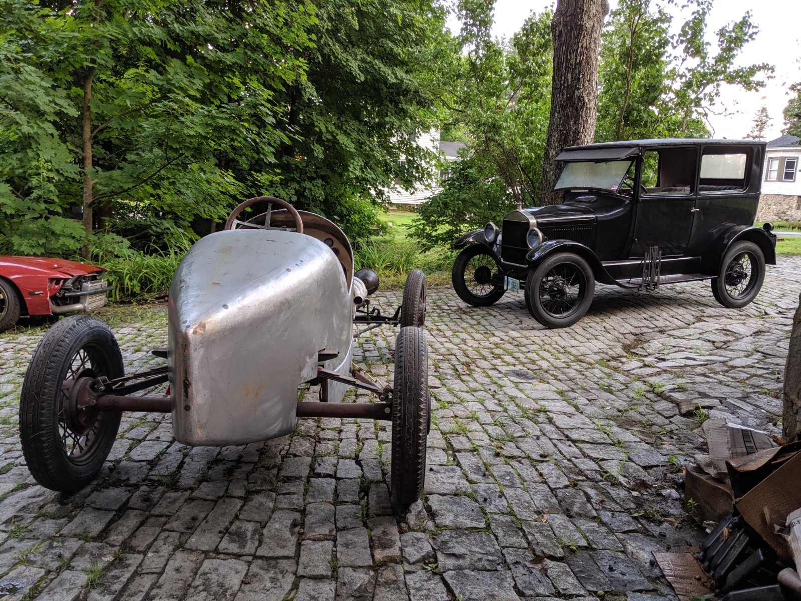

So yeah. That's about 6 months condensed into 2 hours of staring at my phone posting photos. That's about it for now. I hope to keep progress rolling along as well as it has been. Sorry I got less detailed as I posted progress.

THAT is the way a speedster should be built! I have a question though......you weren't clear as to whether using heat on the sheet metal was a mistake or not. Seems to me that heat would definitely be necessary in order to form the panels without distortion. Or did I read that wrong? (probably)
Shane Lach
Topic author - Posts: 246
- First Name: Shane
- Last Name: Lach
- * REQUIRED* Type and Year of Model Ts owned: 1927 Tudor and 1921 speedster in progress
- Location: Milford, NH
Heat was a big mistake for steel. My initial thought was to anneal but that really only works with aluminum (so I learned afterwards). Being a steel body, all I caused with the heat was a bunch of shrinking, buckling, and warping. Cold forming works much better.George Andreasen wrote: ↑Wed Mar 06, 2019 10:57 amTHAT is the way a speedster should be built! I have a question though......you weren't clear as to whether using heat on the sheet metal was a mistake or not. Seems to me that heat would definitely be necessary in order to form the panels without distortion. Or did I read that wrong? (probably)

Heat age-hardens aluminum.Shane Lach wrote: ↑Wed Mar 06, 2019 11:21 amMy initial thought was to anneal but that really only works with aluminum...

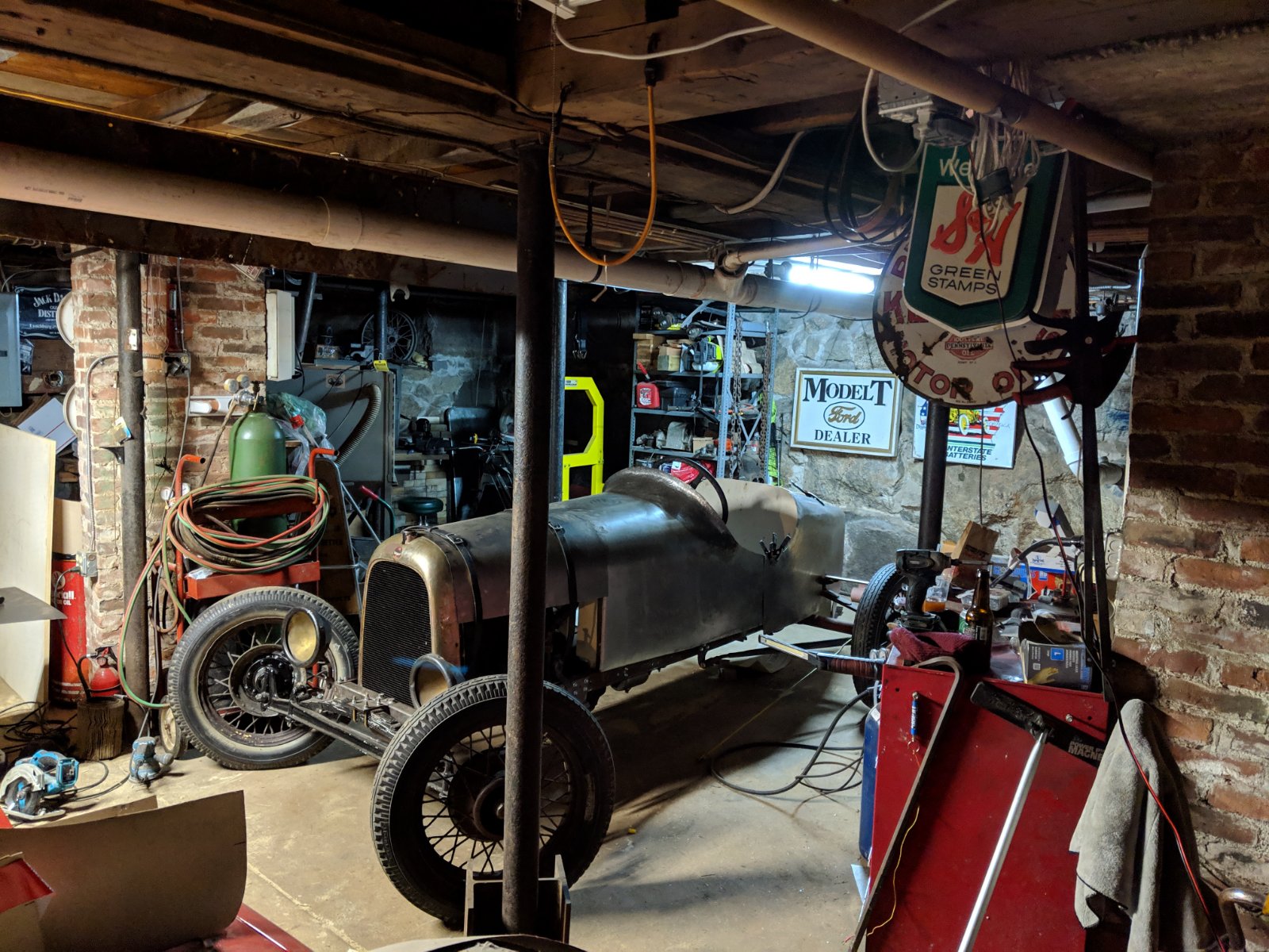

Your build is awesome!!! Very cool field stone basement garage?!! Just asking.

You got it! The house was built in 1880. I was told it was an old school which was disassembled and relocated here in Milford, NH. I bought it 3 years ago and love it. It has its quirks and takes maintenance but it's a labor of love.

A picture of the garage from the outside would be appreciated if you could. Guessing it will only add to your build thread.
So lately I have taken the tail apart for sealing and paint on the wood, and doing some finishing work on the hood. I am sealing the wood with fiberglass resin. The wood seems to soak the first coat up, then the second coat adds a nice protective layer.
Here is most of the panels while drying. They're currently drying after being primed. I used Rust-Oleum boat primer for fiberglass.
Here's the rear edge of the hood to give you an example of how it was before. I've been wire rolling the edges of the hood with 3/16 rod. I've been using a hammer and dolly to bend the edge to 90*, then using my shrinker to get the shape right. I then use a piece of thick flat stock backed by a dolly against the 90* to make it 180*. I then clamp the round bar in after pre shaping it to the panel. Just tap the 180 all the way around the bar a little at a time to get a nice rolled edge.
Partly rolled. Front edge fit up to the shell sitting decent.
Rear edge rolled and fit nicely. This is just sitting against the firewall. I need to shape up a hood shelf and lace it. A project for another day right?

This shows the whole panel. Eventually all sides of the panel we're completely wire rolled. It added a lot of strength and is nicer to grab onto when removing than just sharp unfinished edges.

Shane, BRAVO!
Very Proud of You! For a novice, you are becoming a professional very fast. Glad to see you are using techniques of various styles. This makes you a better fabricator as it teaches you what works best for the situation, life and experience becomes the teacher.
Love your progress, now I have to go and burn some midnight oil to catch up with you!

Shane, It looks GREAT!! I love design and all the metal work. I think that rolled edge is over the top. I have never tried something like that, but who knows.... after seeing this I may try. Do you think you can bring it to Lincoln for the speedster reunion? It is June 20-22. It only happens every other year, so the next time may be in 2021. Hank, how bout you?
This weekend I worked on making a hood former for the firewall and fitting the hood nicely. I made it out of angle aluminum in the shrinker very little at a time. I found the stretcher tears the aluminum. That sucked when I ruined my first one.
I shaped it then drilled some holes to lace it up like a radiator shell.
Shane Lach
- First Name: Shane
- Last Name: Lach
Here she is all test fit.

Not much but I was sitting on the couch contemplating going to the hardware store to buy steel rod for a radiator support. I decided to go downstairs and see what I had already. I found an old brake rod and thought it might work. After smashing it flat and a little grinding it fit into the Whippet shell perfectly. I just have to thread it and add nuts and washers.

Today I made a hood shelf! Well I made one yesterday but it was an inch too short
Shane Lach
This week I dug into the side skirts. I built a couple, didn't like the first design, and really enjoy the second.
Here she is with no side skirting.
Round one ended up too blocky for my liking. They didn't flow well with the natural taper off the car. They also sat lower at the front due to the rake.
This one I'm much happier with. The 1.5" taper rear to front really fits the body much better.
I made some measurements and cut out a couple pieces of wood. I then set the skirt between them and left the metal 1/2" proud. Next I shaped the metal to the wood form. I'll take a couple photos of that process on the next side.
Moving on to the other side, I faced new challenges. I had moved the parking brake handle outboard and had to work the skirt around it. I did so by making some wooden templates to form the metal around. I'm pretty close to done making panels and it's almost time to move on to the fine tuning of them. It's exciting to see a car where once there was a pile of scrap parts I pulled out of someone's yard.
Skirt cut out and all measurements mapped out.
Folded the edges and began making the hand brake cut outs. I left the metal a half inch proud and folded it around these forms

Shane, I've been following your project with great interest. I have a question though. In your first pictures you show what appears to be a piece of box tubing used as a cross member. You mentioned there was some interference though, so you decided against that method. Where was the interference? At the ends....spring hitting the closed off box? Or was the spring rubbing against the inside of the box? Both?
I'm asking because I had the same idea and would like to know exactly what headaches you ran into. In the meantime, keep the photos coming!!
Shane, I haven't been on here much lately, but GREAT JOB!
I had to chuckle at a couple of things you did, because the are in similar fashion to what I am doing:
Modified T frame, Model A steering, a happy accident that it came up through the same hole in the firewall. My column will be shortened though. I am also using an A front axle complete, but used Model T spring and perches. Some mods will follow as I may add front brakes. I have the parts to do a '28 Chevy overhead on a T block.

George Andreasen wrote: ↑Wed Apr 03, 2019 7:35 pmShane, I've been following your project with great interest. I have a question though. In your first pictures you show what appears to be a piece of box tubing used as a cross member. You mentioned there was some interference though, so you decided against that method. Where was the interference? At the ends....spring hitting the closed off box? Or was the spring rubbing against the inside of the box? Both?
I'm asking because I had the same idea and would like to know exactly what headaches you ran into. In the meantime, keep the photos coming!!![]()
The spring contacted the frame like you described. You can weld a channel on the front of the frame so the ends are open, but I didn't like the look as much. Since I already shifted the engine cross member back and the square one was made, I went with the lowering bracket I made off of that. It gives it a cool rake out front and functions well so far. My rigorous r&d only consists of me jumping up and down on the front end lol.

Alright guys. It's been a while but I'm back on track. With spring hitting I had a lot of household chores to focus on, as well as my wife is pregnant so a lot of my time has been consumed with other priorities. I've been making it a point to put in an hour or two a day again.
A while back I purchased a wallowed out Neville steering wheel. I needed an adapter made to fit my model a steering column and reached out to Hank. He explained that he was proud of the work I was putting forth and this was my reward. He managed to mill the hub face and create a collar to insert in the wheel. I appreciate all the help he has given me.
After this, I began working on wire edging the circumference of the cockpit. I used 5/16" steel rod. I welded a piece of rod to the end of vise grips, and a plate to the other jaw. I gradually clamped and rolled the edge until I formed a 180* pocket. Then I formed the rod to sit in the pocket, clamped it, and hammer/dollied the sheet metal over the rod.

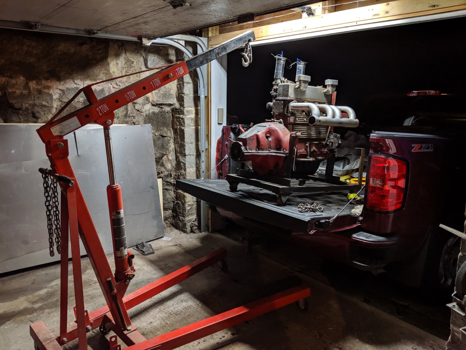

Last month I traveled from New Hampshire to Nebraska for the speedster reunion to execute a long planned transaction with my friend Rob. We had been talking and worked out a deal on a special engine he had and wanted to sell me. He drove from California and we met in the middle of the country.
Here's a photo of the gang. Rob, his father, Bob Middleton, my wife and I. These guys were great and it was cool to meet after months of phone calls and mentoring.
Here she is. This is Rob and I after we dragged the powerplant to my truck bed after a combined 3,000 miles of driving. I'm honored to own this piece of automotive history and happy to give it a new home.

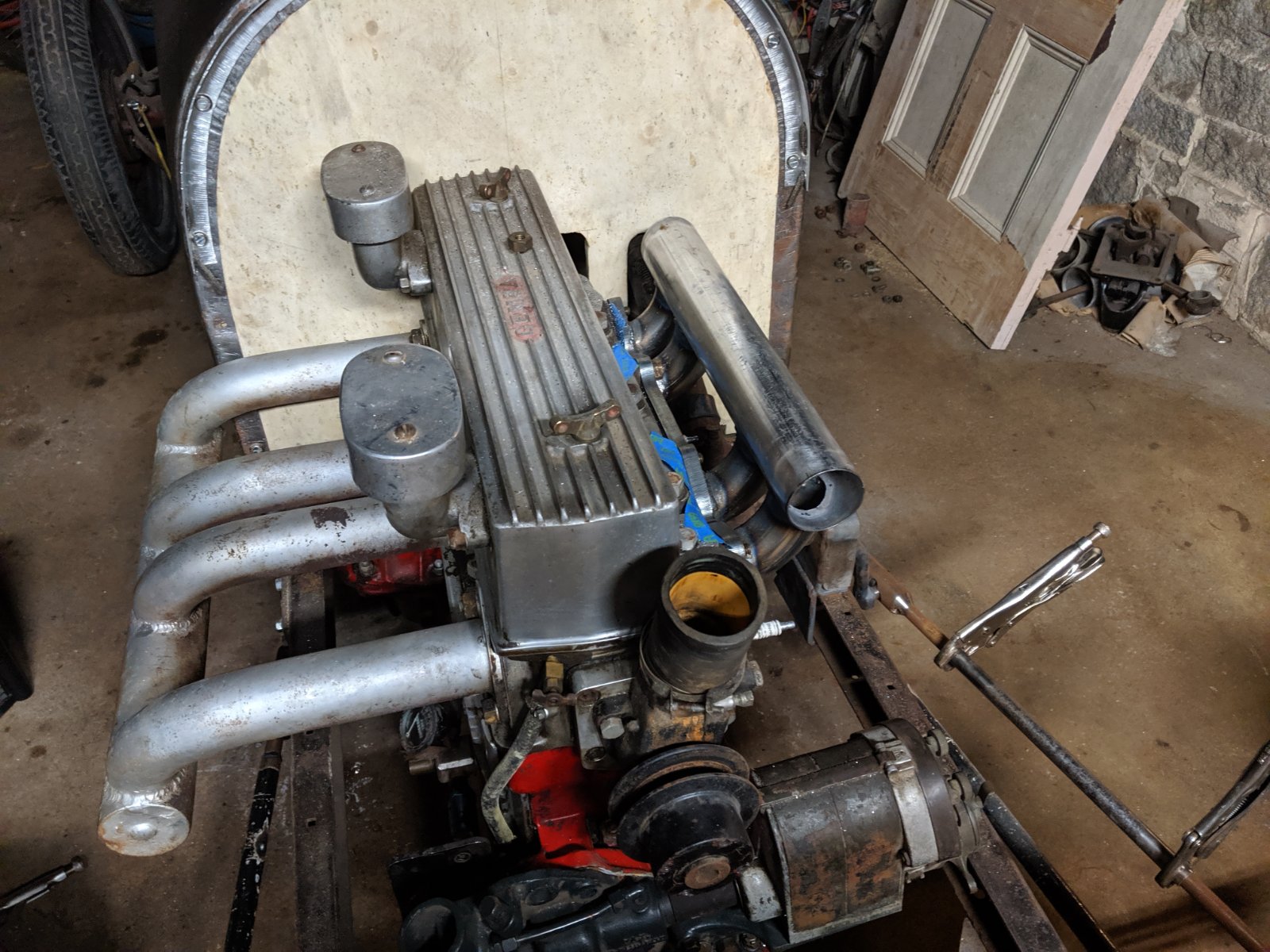

Onto the details. The engine is a model t block, Gemsa 9:1 cross flow head, model a crankshaft, pressure fed oil system, dual downdraft strombergs, etc. I'll change a couple things here and there but the goal is to get it fit and running mocked up. I will be installing a splitdorf crossdrive mag setup on the front as well.
I found some sweet old louvers for model t headlights you can see above also. Couldn't pass those up.

So as of recently, progress has dialed back a bit due to my wife and I having our first baby! But I've been sneaking in some work here and there. I'll share some photos.
I rolled the car outside for the first time ever a month or so ago to get the juices flowing again.

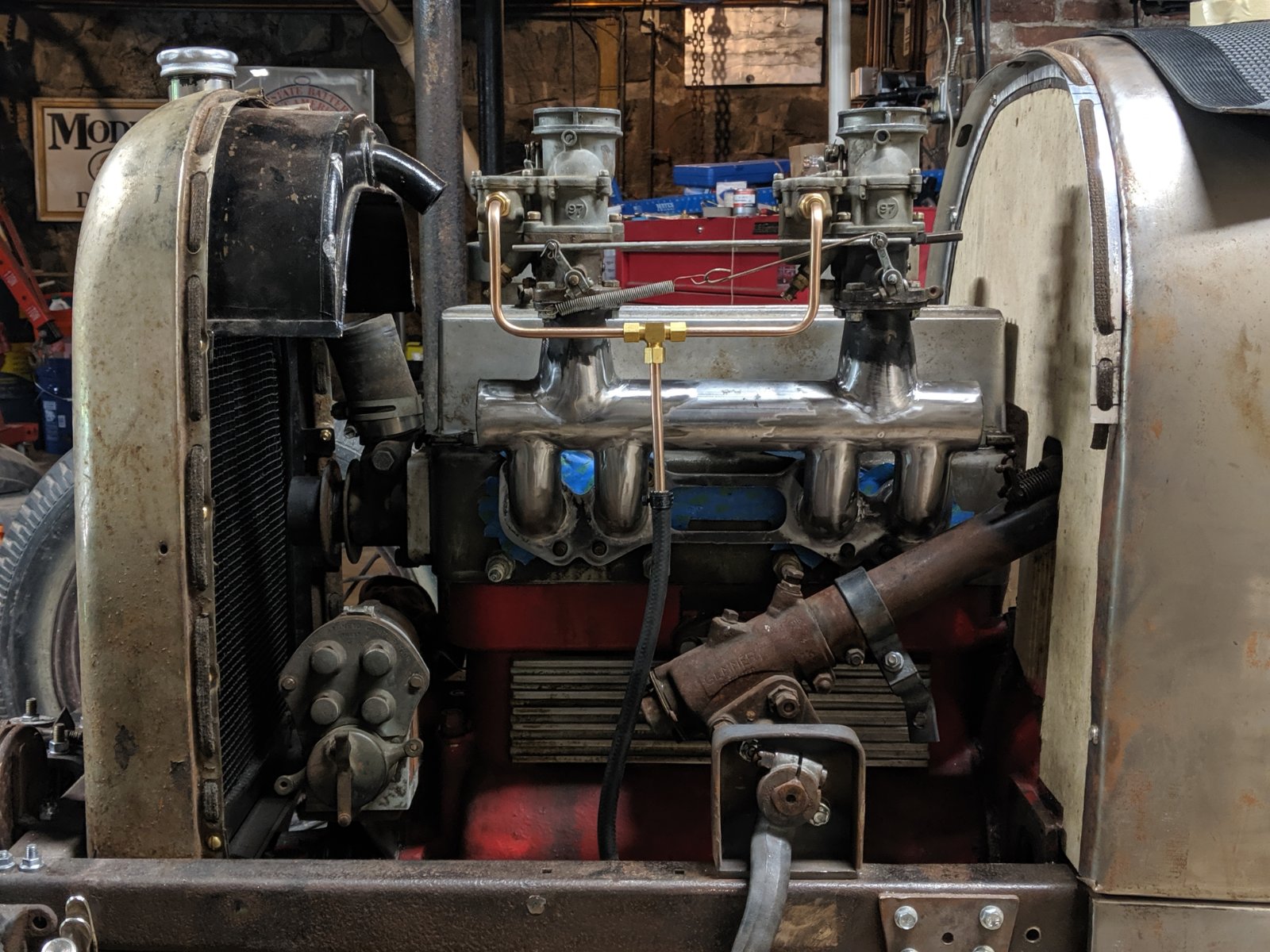

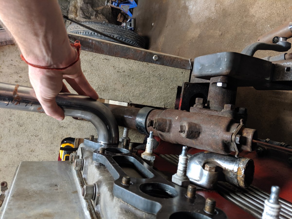

So back to the engine. The intake manifold that came with the engine came straight out of the head and contacted the steering column. Therefore I had make one which entered the head at 90*. I purchased a flange from Rob and got to work.

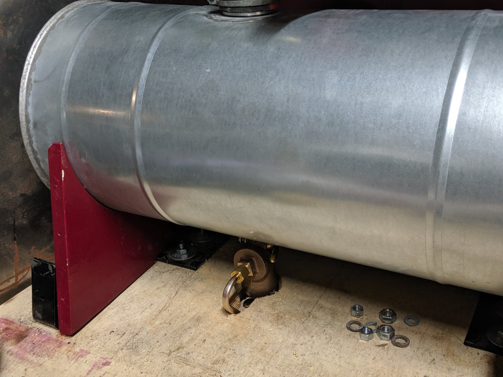

I then began working on the fuel system. The gentleman who builds the reproduction T tanks made me a custom one which is 3" narrower and sits behind the seat nicely. I then got a fuel fill adapter which threads into the tank, a fuel coupling, some t radiator hose clamps, a brass pipe, and a cool old brass flip top filler and created the filler neck. I used a harbor freight hydraulic knock out punch to put a perfectly round hole in the body. I also soldered the filler cap on because the tank will be pressurized.
[attachment=4]IMG_20190814_164531.jpg[/attachment]
[attachment=3]00000PORTRAIT_00000_BURST20190902151226754.jpg[/attachment]
[attachment=2]00000PORTRAIT_00000_BURST20190902151904705.jpg[/attachment]
[attachment=1]IMG_20190902_151627.jpg[/attachment]
I then began running fuel line from front to back. I purchased a repop sediment bulb and installed that. I modified it by drilling it to accept a 5/16 fuel hardline to supply the dual downdraft carbs. The line material I used is Cunifer which is a copper nickel hybrid material. It had the old look but is more resistant to cracking/hardening. There is a short length of rubber fuel line between the tank and frame, frame and engine. That should relieve strain on any hardlines.
[attachment=0]00000PORTRAIT_00000_BURST20190908153306682.jpg[/attachment]

Here's the fuel line photos.
