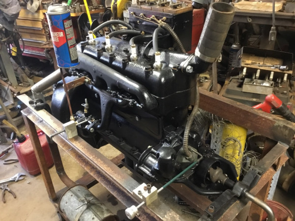

This is both mystifying and infuriating. I thought I would turn the engine to line up with the U-joint and found it absolutely stuck solid. Even putting all my weight on the hand crank won't budge it. When it was on the stand, before I nstalled the pan and the hogshead, I could grab the flywheel and turn it, but nothing will move now. I suppose I will have to put the thing back on the stand, pull the hogshead, and try to find what's stuck. But first I'll go and do some other things while I calm down.

Is that pliers you have resting in the oil filler hole jamming the timing gear?

Ooh...Adam good eyes....missed that!

And, I'd remove pliers and install the oil cap!

Pliers jammed in timing gear? Nope. Pliers are out, cap is on.

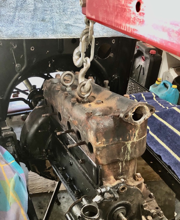

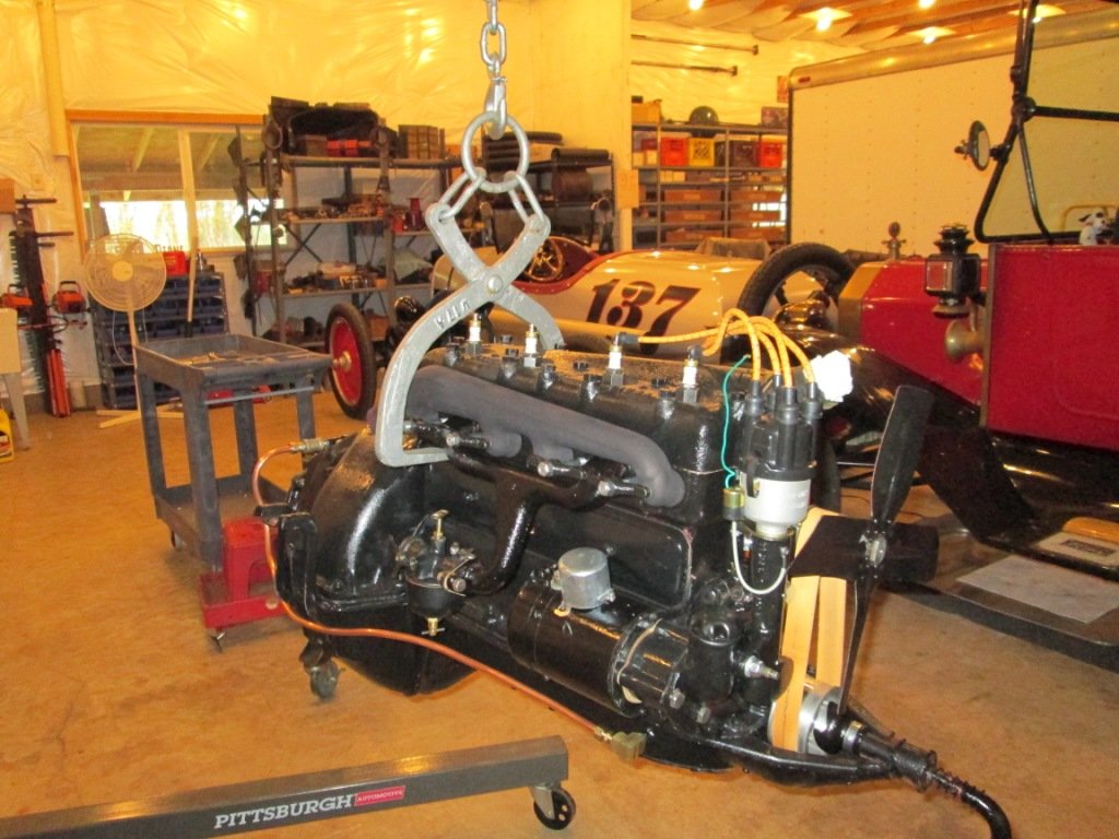

As an aside, how do others feel about hoisting the engine /trans assembly on two head bolt holes, especially with the chains attached to the end of the bolts? Is that asking a bit much of 100 year old cast iron? My three legged chain fall goes down to the pan rail at the back.

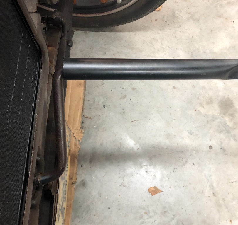

If the engine was free until you tightened down the crankcase bolts, there is a strong possibility that the slanting front of the flywheel pocket, where the wishbone socket is, has been sprung inwards enough so that when it gets drawn down by the bolts it springs the bottom half of the field coil into the magnets, locking everything up. I've seen that happen before. Unfortunately that is one area that the KRW pan jig can't check for.

AllanAllan wrote: ↑Fri Mar 12, 2021 7:21 pmAs an aside, how do others feel about hoisting the engine /trans assembly on two head bolt holes, especially with the chains attached to the end of the bolts? Is that asking a bit much of 100 year old cast iron? My three legged chain fall goes down to the pan rail at the back.
To me ....if the block threads are good condition, and clean; then using bolts there is OK.
But those tall and spindly bolt shanks could twist and bend, as the engine is tilted. Use of a block plate, solid to the block, and two or more bolts, flush and secure, spreading the load on those 7/16" bolt holes is OK to pull with little risk.
Or, for me the special plug lifts, when the cylinder head is installed is plenty safe. The pull out force of 1/2" pipe thread of steel in iron is well over 1,000 lbs.
And....on topic. Steve has stated the engine has been stored for 8 months without turning over the crank handle, that motor is just plain stuck/stiff that so persuading with leverage is needed, after a little soak in some slippery stuff

I concur with R.V. regarding the area behind the front radius rod although 3 dip pans are quite tough in that area compared to a 4 dip but a good front end collision can surely impact that area.
As far as lifting a complete engine for removal or replacement - I've got a "2 plug" gizmo that's adjustable to tipping or this is the best tool !

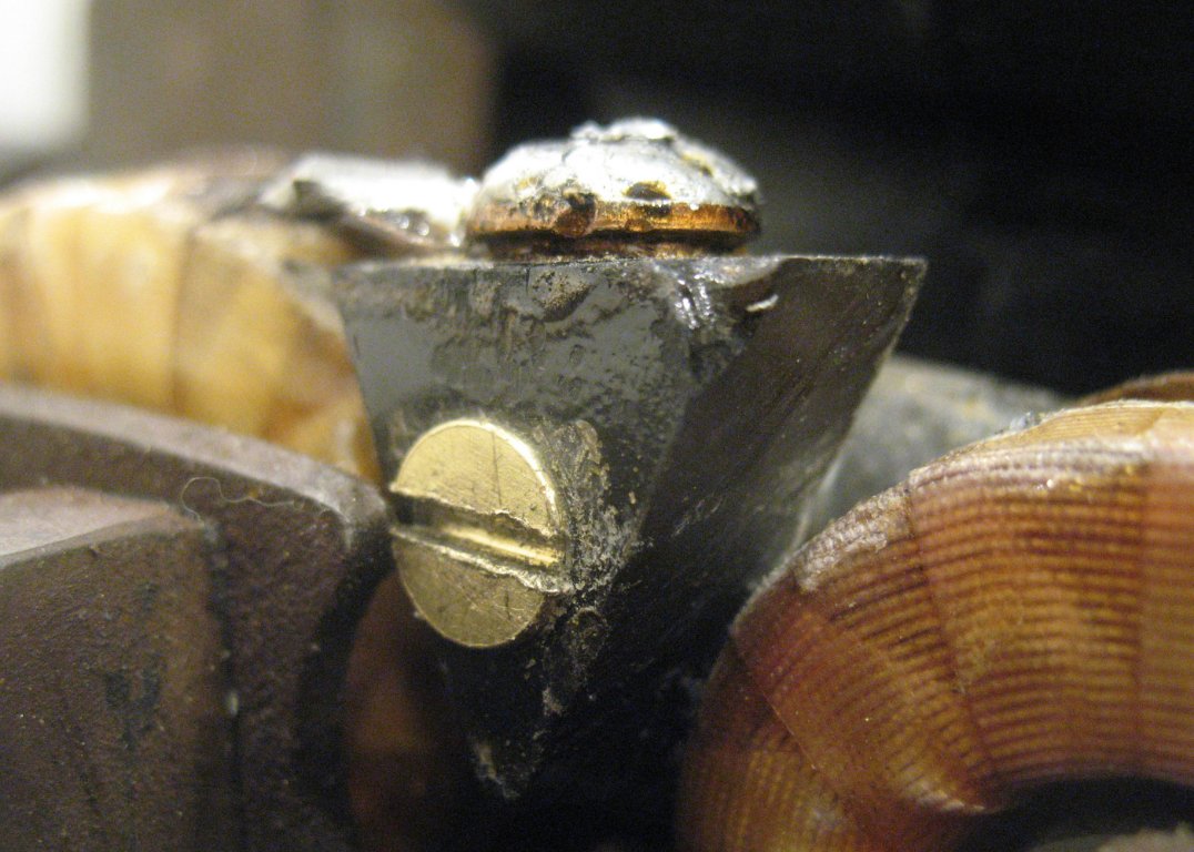

Topic author - Posts: 7411
Re: Engine stuck, old man steamed
I thought I posted this afternoon, but apparently I didn't click Submit.
No, but they don't look flat.
1915.
SCAT crank, no dam. But did I get the horseshoe in upside down? Nope. Took off the inspection cover and inspected. Horseshoe was AOK.
So at that point I figured it had to be something under the hogshead. When I pulled it I found that was right, but the problem wasn't anything I or anybody else would have guessed.
When I assembled the mag ring I didn't have the proper rivet, so I used a machine screw to hold the base for the solder blob. I didn't make the countersink deep enough, so the screw head was out far enough for a magnet plate to get stuck on it. When I turned the engine backwards it moved about an inch until the other magnet plate hit the screw. This will be a fairly simple fix.
But before I put that hogshead back on I'm going to take the time to make a pedal spring compressor and perhaps make pedal installation a little less annoying.
Have you checked the pressure in the tires ?
I’m thinking two large screw drivers in the starter hole.
1915.
Do you have a counterbalanced crank with a welded in dam behind the 4th rod.
Steve,
From your other post "Installing the hogshead: Is there a better way?" it looks like something more, happened since installation.
Vern (Vieux Carre)
It's Bill
- Posts: 279
- Joined: Mon Jan 07, 2019 6:41 pm
- First Name: Bill
- Last Name: Hoffer
- Location: Mars, PA
Yes, it looks like you need to do more checking. After the steam clears out. Keep in mind this is all fun! Cheers, Bill
- Posts: 4081
Vernon
Good look back to earlier photos.
I too wondered how that mag contact on the ring got snagged, and pushed down.
Since it was nice before hogshead on....believe now the hogshead dragged on install, too close to the ring, since it’s a ‘15, would be alum hogshead, easy to wrestle around by trying to set pedal shafts too and force to wrong spot?

I keep thinking somehow something is binding either the timing gears or the transmission gears... maybe a dropped bolt / washer / cotter key? Once it's wedged in there you're locked up... sad part is you have to get into it to find it, but once it's out it should turn normally, Good luck, Steve!
schwabd1
- Posts: 282
- Joined: Sun Jan 06, 2019 7:26 pm
- First Name: David
- Last Name: Schwab
- Location: Northwest Ohio

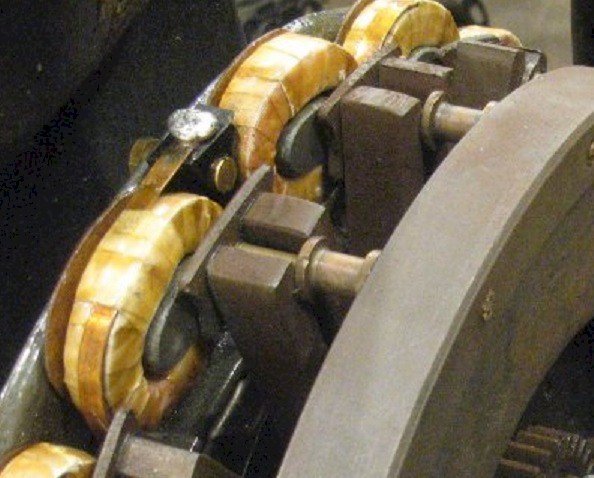

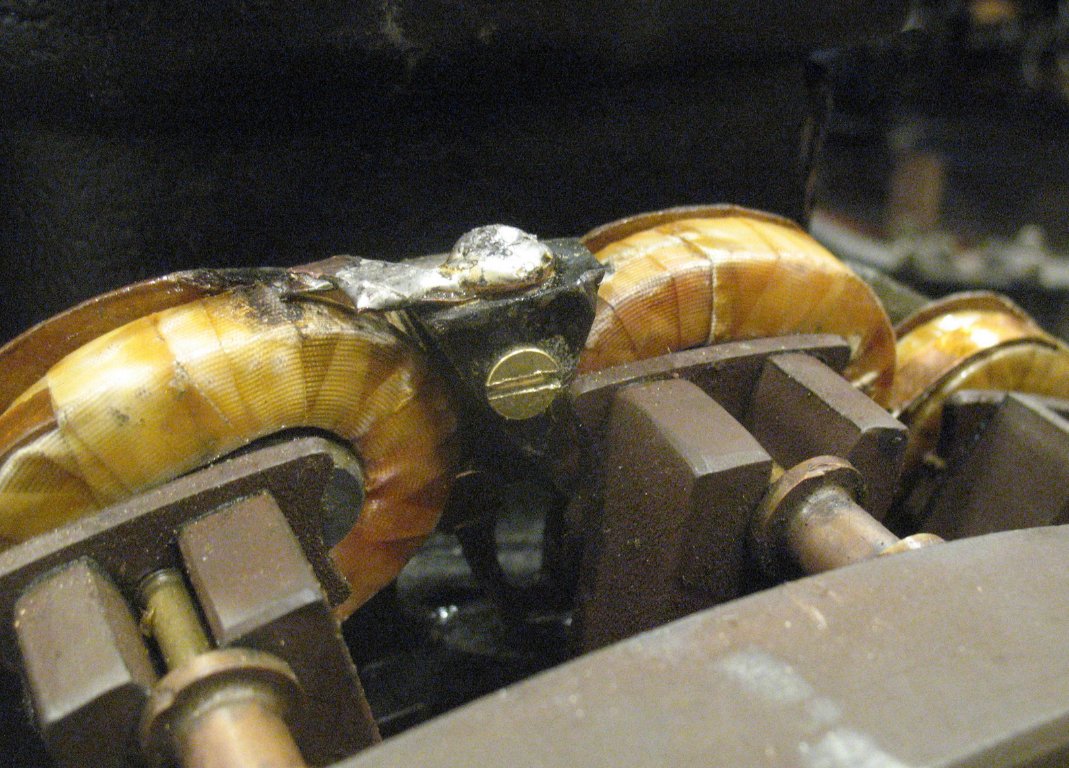

Hmmm, looks like the screwdriver slot on the newly rebuilt mag ring is vertical.... on the "stuck" one it's horizonal.
- Posts: 4694
I can't quite tell from the picture, but is that triangular block pulled out from the mag ring? If it is flush against it, then it is too thick and sticks out too far toward the magnets. Notice the picture posted by Varmint That block should not protrude farther than the coil rings and yours looks like it does.
Gee, we do have some observant folks here.
This view may show better what's going on. The triangle as originally installed had the solder blob too far forward, so it was not centered in the mag post hole. When I moved it toward the rear to center it in the hole, the screw wasn't countersunk in the triangle enough. Here you can see the magnet plate hitting the head of the screw. I will be making a better triangle that will position the blob correctly without a screw head sticking out.
With the triangle and blob removed, the engine now turns freely all the way around.

- Posts: 5579
Why are you not utilizing a rivet as designed ?
The right sized rivet seems to be made of unobtainium.

It may be an illusion, but on my screen it looks like a cold solder job on the ribbon and blob, solder appears to be sitting on top of the metal with little on the edge or underside.
Just curious, why did you take on that flywheel rebuild and not just buy a new one ?
$265.
Since you could grab the flywheel and spin it before the hogshead installation, did you move the triangle in the intervening time or did something drag it aft?
See my post at 11:29 AM today.
It may be an illusion, but on my screen it looks like a cold solder job on the ribbon and blob...
Nope. It was hot, hot, hot.
