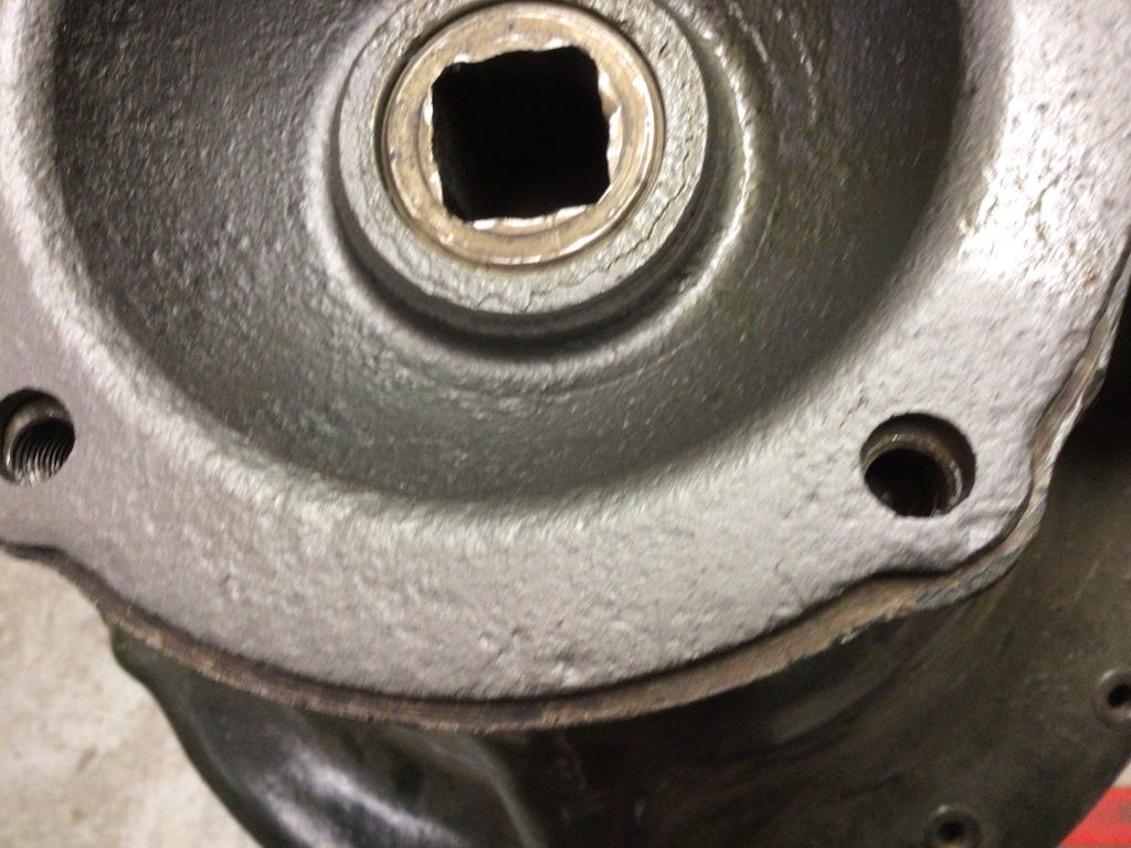

My original pan was unuseable so I bought another one. It has straight side rails and good threads and is in good shape.
It does not fit the rear bearing.
Murray Fahnestock says to straighten the pan by attaching to the block and using wood block and large hammer.
My concern is will that damage the block. I need to move it a little over 1/16”

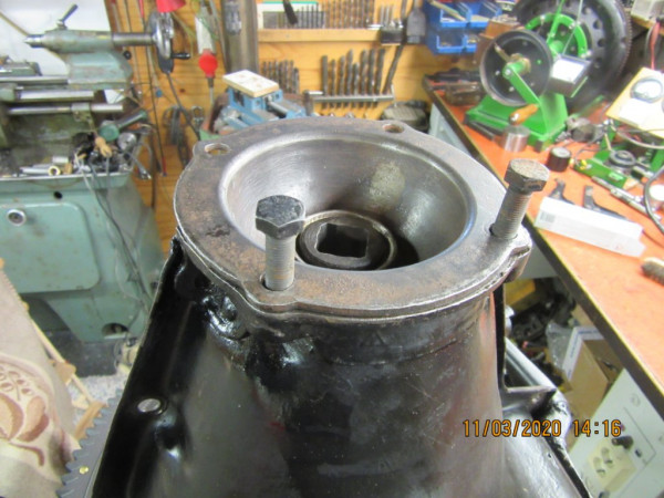

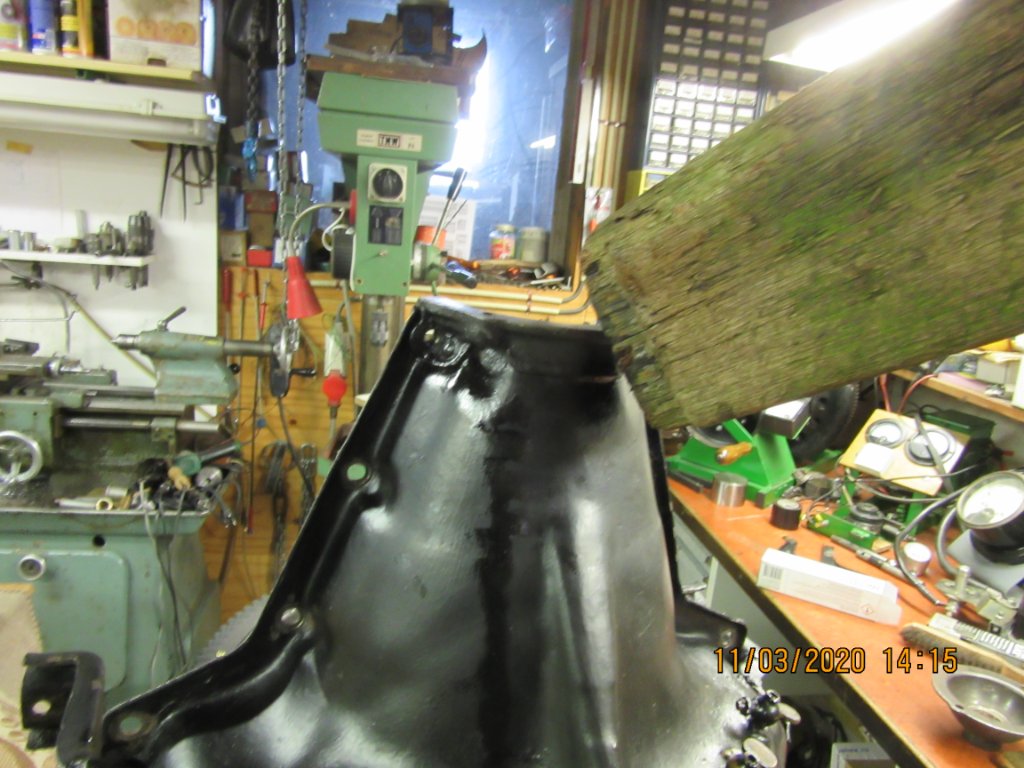

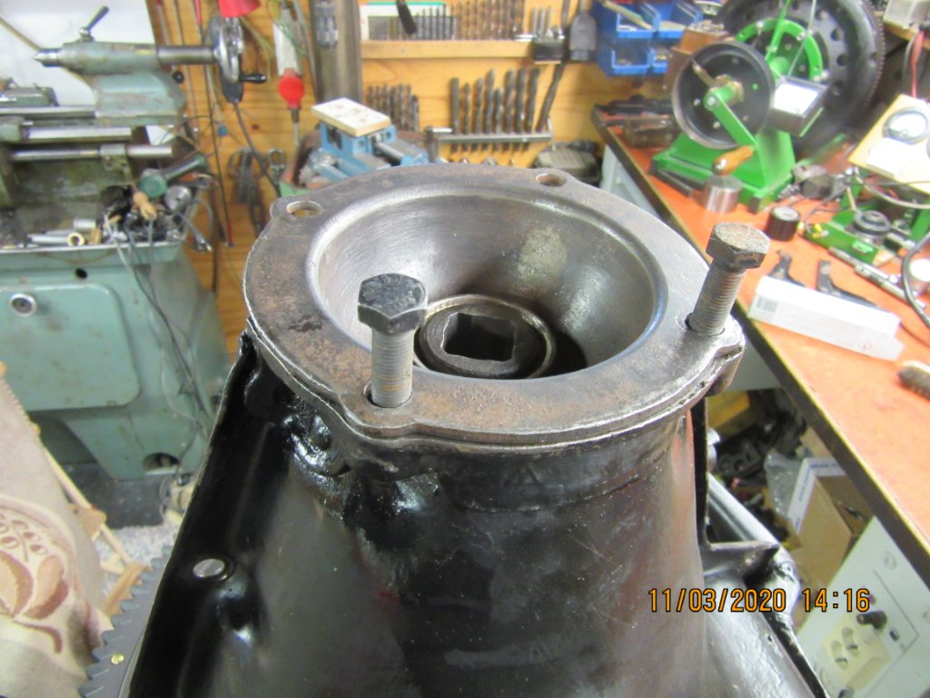

Post by ABoer » Mon Mar 15, 2021 5:08 pm
Yes ; I have a Pan Jig , but the lasts mack I give with a HEAVY wood block .
