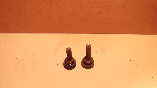

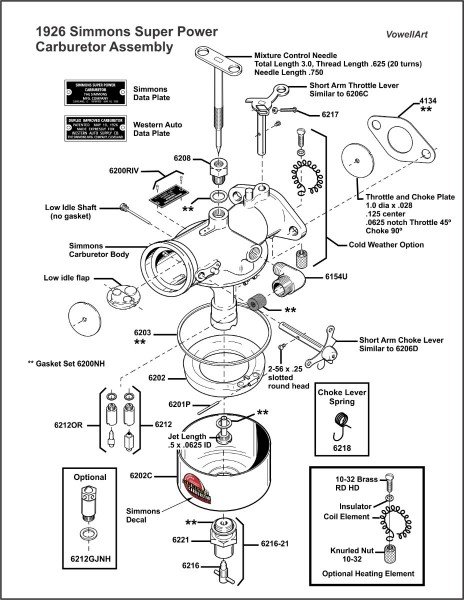

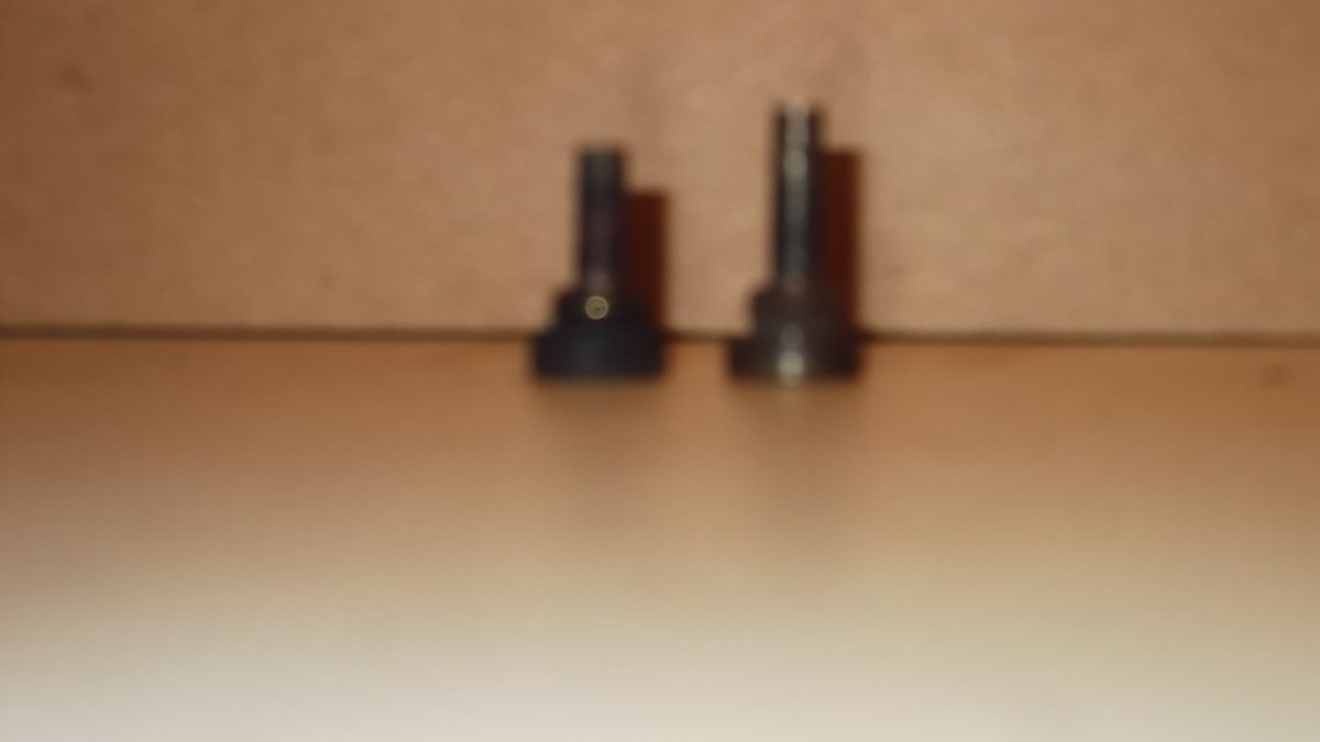

May just have a plugged passage. I wonder is someone installed the wrong spray needle jet, they are a different length then NH but fit the same, along with shorter needle. If you go down to the drawings, it show the length of the jet tube. The shorter one in the photos is the Simmons/Western Auto/Duplex jet.

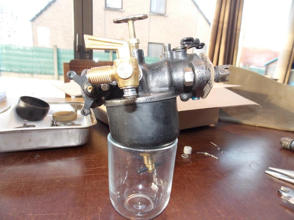

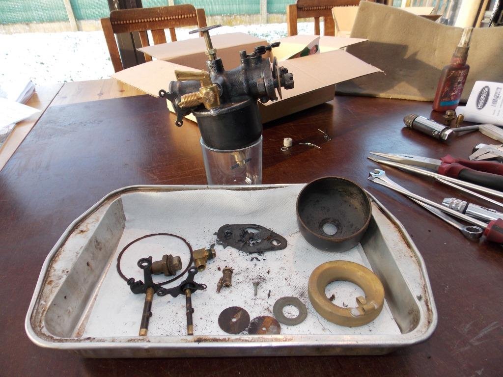

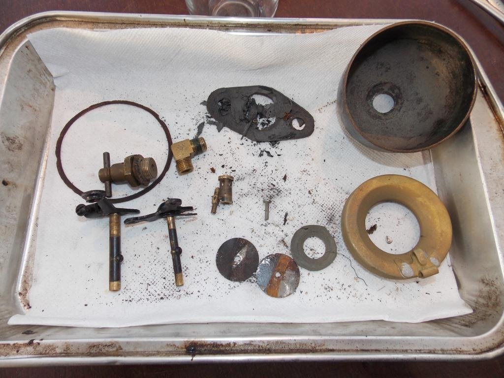

Now I know why the 1913 runned as crap as it arrived here to tune up. It had a Simmons carburetor on the engine. I tried to rebuild it but could make it run right. Build a rebuild NH pre 1923 on it and it run as new.

Revisit this thread and found that the Simmons carburetor on the 1913 runabout was missing the flapper. The bolt was there to close the hole but had no axle and no flapper.

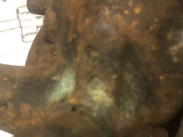

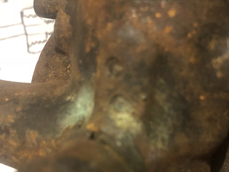

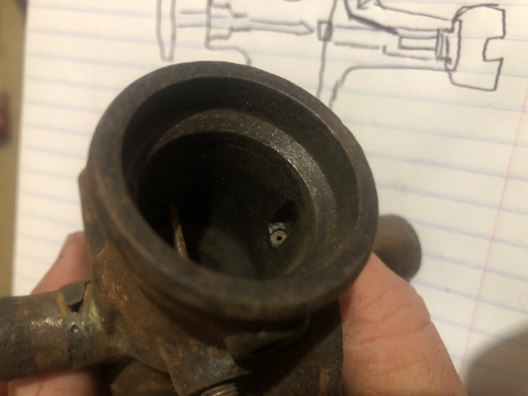

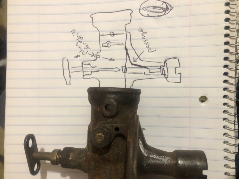

Those Simmons carbs have one passage. It’s function is to add air to the mixing chamber itself. That same passage on an NH would be the one that goes from under the ID tag to the mixing chamber.
You can see on top of the carburetor to plugs, one is to plug the hole where they drilled this passage from the top and then sealed the top of this passage which is intersected by another. The other is where a stop for the flapper is inserted. The passage that intersects this one comes from the choke side of the carburetor.
It is placed in such a way that when the choke plate is fully closed air can still be drawn through it through a recess in the carburetor throat that leads to the passage opening. I drew a diagram and put chalk marks where the passage is.
The main opening is under where the flap is located. As more air volume rushes through opening the flapper wider, less air goes through this passage and all the air needed mixes with the gasoline drawn through a jet that is inserted into the carburetor throat. This is where the spray needle seats unlike the NH where the longer needle goes down and seats against the spray nozzle itself,
Instead of an idle circuit like an NH, and it functions a bit differently than the Kingstons but the same principle, the flapper regulates the air providing a richer mixture at lower speeds and just enough in the mixing chamber while choking.
If you mess with the heating element make sure it is sealed or it can cause a vacuum leak or dripping fuel at shut off. There are several rubber washers there to seal it from the factory.
