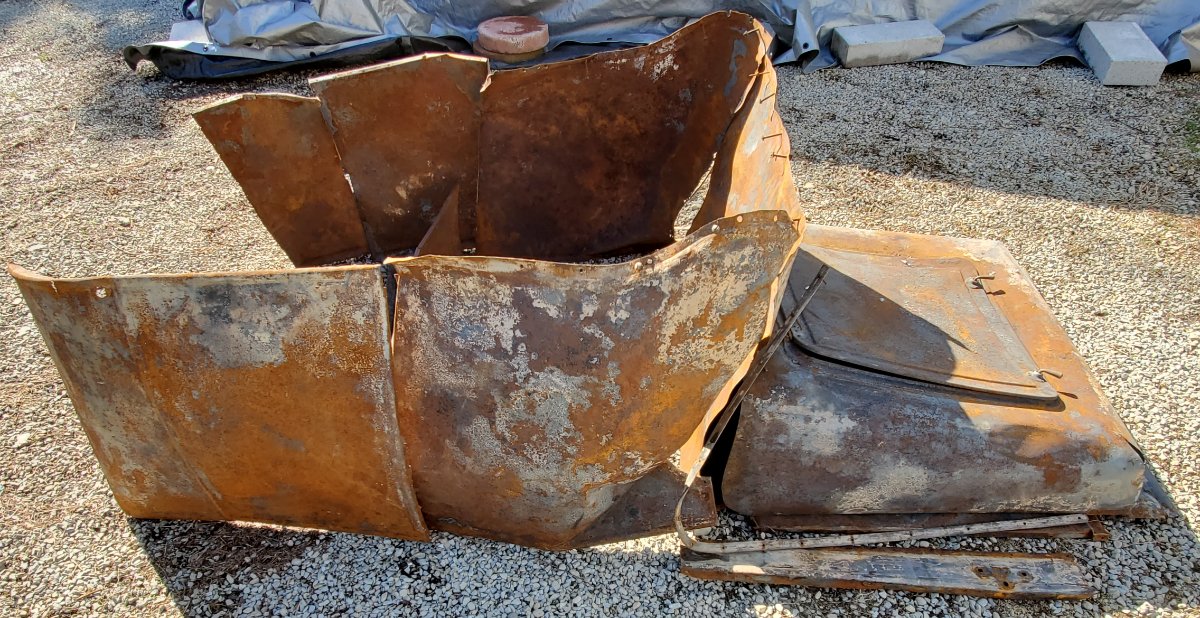

evening all.
I'm looking to invest in a quality hammer and dolly set (either new, or well maintained used). Whats a good set off hammers and dollys that would be great for T body use?
I'm also looking into investing in an English wheel and a nice bead roller too. Nothing way pricey, but what would be suitable for repairing and making new patch panels and such for T bodies.
Benji

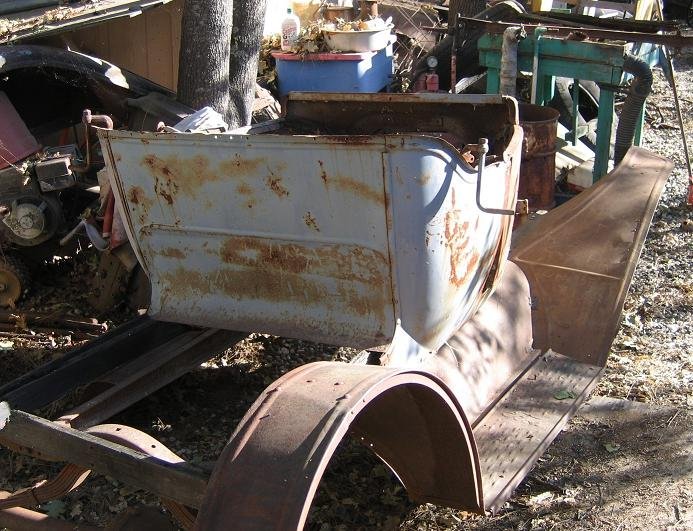

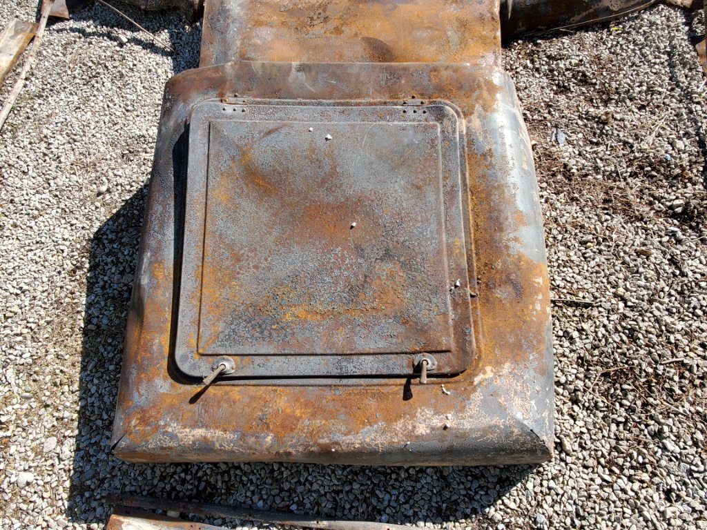

UPDATED: My internet was out for a couple days, so im just now able to reply. Here's some pics of my 1913 roadster sheetmetal to restore.

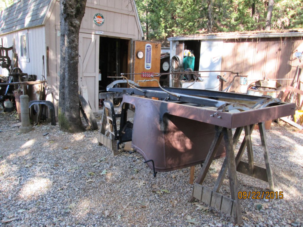

I'm just getting into metal fabrication and looking for tools too (lots to learn yet). If your limiting your work to repairing and making new patch panels and such for T bodies then metal thickness, panel size/shapes should be considered for all tools The patch panel prizes shown are Howell's on eBay- I doubt if you could make them for what they charge in terms of metal cost & labor. So you might want to limit your work to repairing. Hammer styles are designed for various types of repairs - watch some YouTube videos to understand what you might need, that might help you decide on a set or just a few individual tools AND the quality you need. I purchased and returned a small English wheel because of its workmanship (sold by Grizzley, VEVOR..)- anvils included and what I would initially need.
I did buy an Bead roller that is great. It came with a few dies and planning to buy some additional. The throat size is all I need and the spoke crank allows me to see what I'm doing as I manually advance the material through it. Again watch some videos to aquatint yourself with the tools and what you plan on doing and how much of it.
I just purchase a shrinker/stretcher set from HF (10% off) and have yet to use. I don't see much difference in what others sell except for price. May need to make a foot pedal.

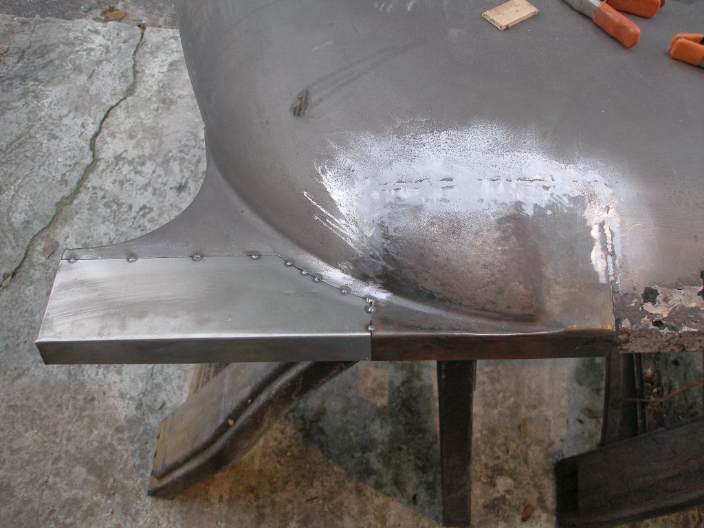

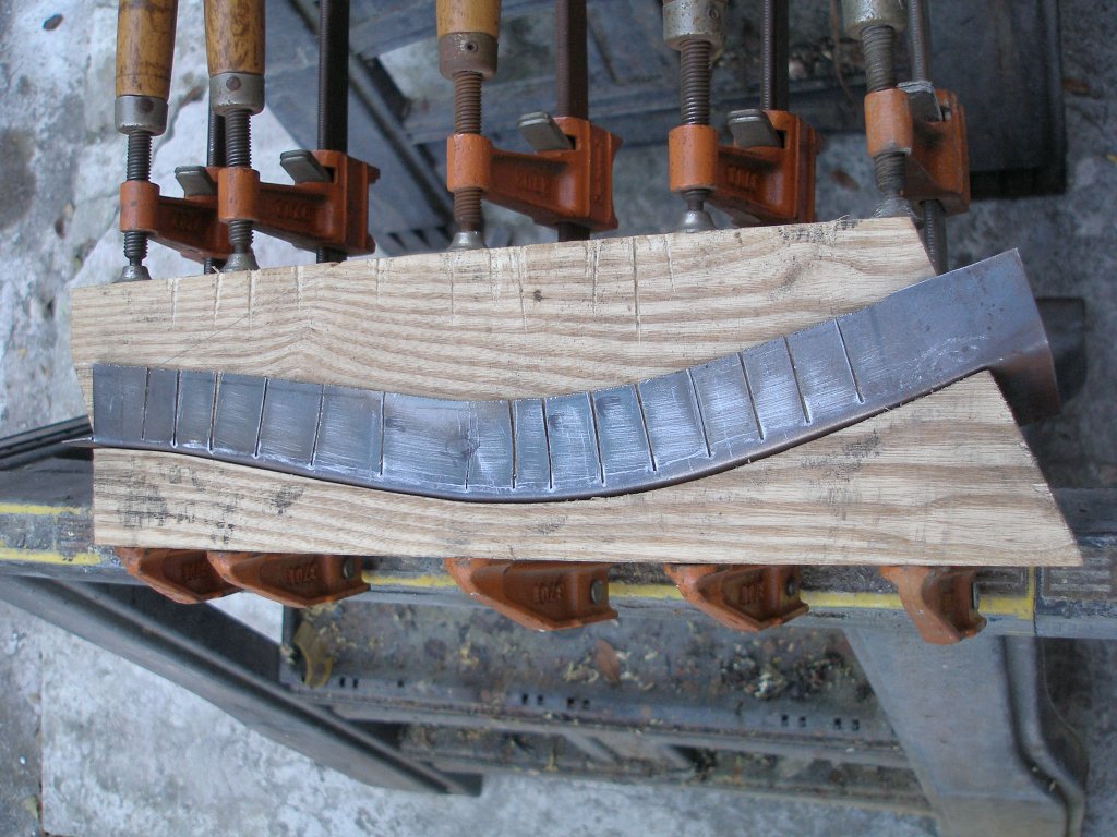

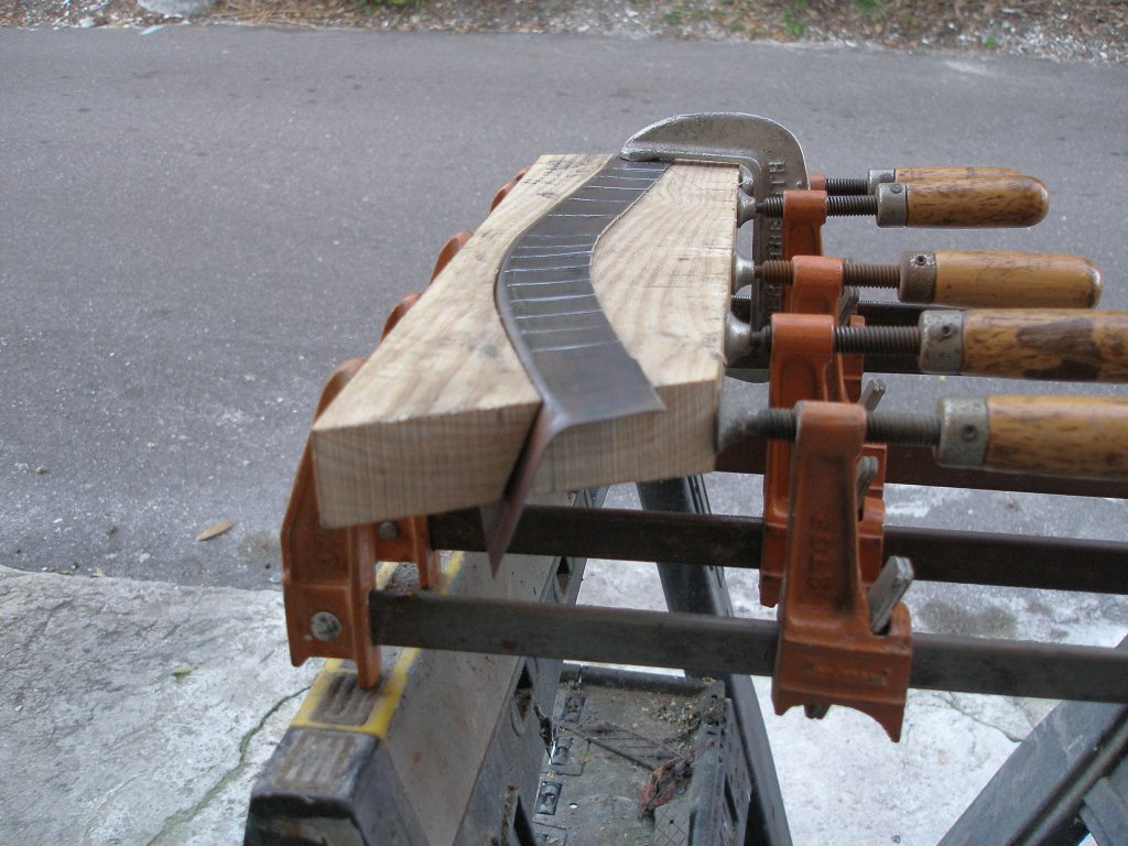

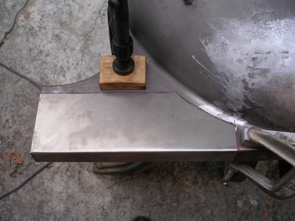

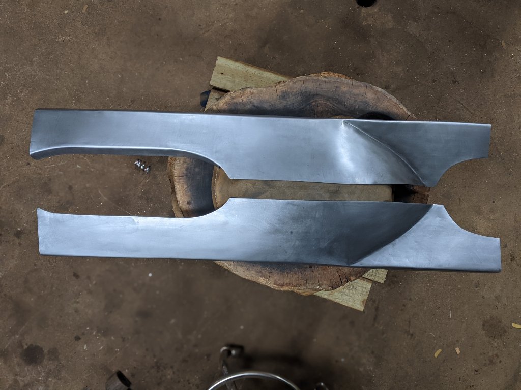

All would be nice, but a hammer and dolly did this after being disgusted with the fit and shipping costs of patch panels...If I was going to have to spend a day making one fit, I figured I'd spend a day and a half and make them myself and save the money
Posts: 6739
Re: What is the best Hammer / Dolly sets to get, as well as everyone else's favorite body working tools?
Post by Scott_Conger » Thu Mar 11, 2021 12:02 pm

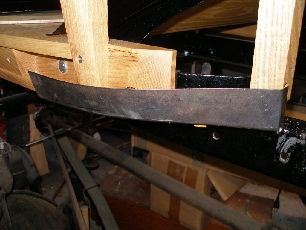

You just have to be smarter than a piece of flat metal
A shrinker would have been nice, but this took 3 hours and a bandsaw and cost me nothing but time...I doubt that I could have made it in 2 hours with all of the "correct" tools, anyway

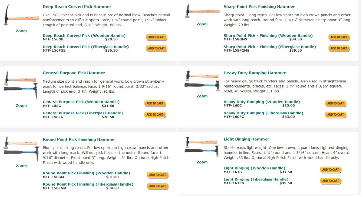

Lists purpose of various hammer styles ...https://www.tinmantech.com/products/han ... y-hammers/
Which styles make sense for Model T work.? Sometimes a "kit" contains stuff you'll never use.
Martin Tools makes very good American auto-body hand tools. These are based on the old patterns from Fairmont, Paramount, Proto, Blackhawk, and others. We have found this company to be responsive to the market, and they are genuine made-in-America.

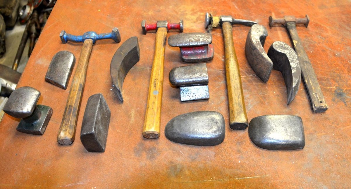

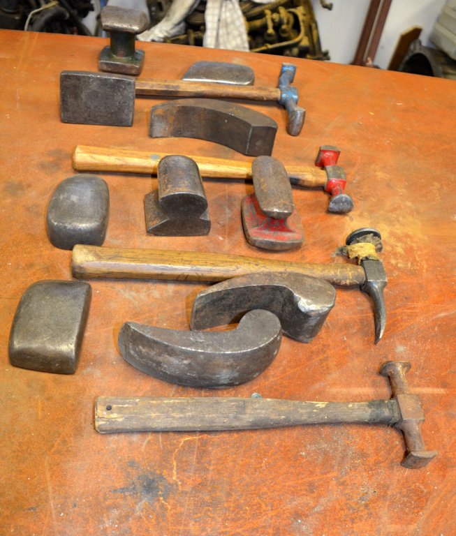

As promised I've photographed a few of my hammers and dollies. Hopefully the different views will give an adequate idea of the shapes.
About half of these dollies are ones I made, the others are Snap-on or SP.
Such tools are very personal to each owner, and different people will find different tools more preferable to them (depending also on the type of work you do). What you see here is a subset of the ones I've found useful for old car work, there are many other levers, spoons, slappers, dollies and hammers I've got, but I reckon this lot is probably the most useful.

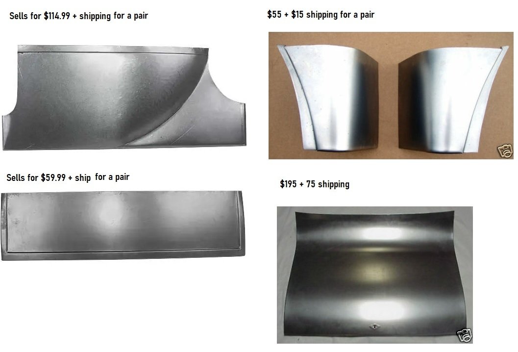

Al, my cars are early, so patch panel availability is minimal. No patch panels for the bottom of 13 doors, etc. So its best I learn all of this. My 13 roadster is more bent metal, no rust outs.
The 13 touring I have has alot of rotten metal on the lower 6 inches or more in the rear tub, and tapers out about the middle of the car. It was screwed to a piece of plywood, and left out in the weather a long time before I got it. Had it not been, most of the wood would of been intact, as well as some upholstery. Very sad, but I'll try and save it. It also came with the fenders, hood, firewall dash shield, one engine pan, all the brackets and toe heel panels, the little lips for the seats, splash aprons too I think.

Like a couple others, I make my patch panels myself. Available patch panels I have seen others buy never looked that good to me, and the fit wasn't good. Since I work on a very tight budget, I figure I can spend less, and the time I usually spend making them isn't much more than I would waste on phone calls and fiddling with and getting a bought part anyway. I made the piece for my car like Scott Conger shows above. He did a nicer job than I did on mine, but mine fits, works and looks good!

You've got a fair job ahead of you, judging by the photographs. It's not going to be easy, and there'll be some difficult times I expect, but if you persevere I'm sure you'll get great satisfaction out of what you produce.

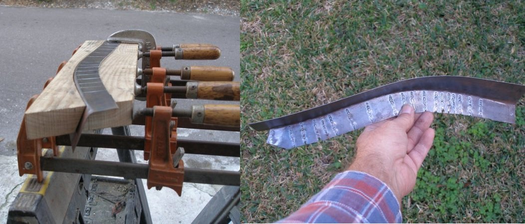

Secondly, there is no one right way to make panels but you may want to 'invest' in a shrinking stump to make some of your quarter panels and the like. Here's one I made recently:
I used this to make the complete quarter panels for the car you see in this thread: viewtopic.php?f=2&t=19034 - the methodology there was to first cut out the rough shape of the panel, then shrink the edges with the stump and wooden round-headed sheetmetal hammer, followed by working with an English wheel, then finishing off with flat panel hammer and dolly.
With the door skins, which generally require much less curvature, I'd just use the English wheel if I was making the whole skin (and possibly bead roller if you wanted some edging), but if I was patching it then there's a lot you can do with simple hammer and dolly work as Scott has said.
As a matter of interest the original metal panels for the car in the above thread were in some cases not too dissimilar to yours in terms of condition, but in others areas they were completely non-existent. The restoration decisions were:
  • Guards had repair panels that were made with folder or wheel, and/or flat and crowned hammer+dolly. These panels were then let into the guard via mig or gas welding.
  • Quarter panels were made new using the method I describe above. I did try repairing one of the original panels but it was badly holed in a number of places and a new panel gave a better outcome for a lot less time and welding material.
  • Rear panels including bootlid and guttering were all manufactured using a roller or folder, with a little hammer/dolly work. You don't actually need a roller for this but because I had one it was used. I also used a post that was holding up Adrian's shed in order to adjust the curvature in one panel and it worked fine!
  • The front cowl was made simple by cutting to shape then bending up each side by hand on a piece of carpet layed on the ground. When it was fitted into place I needed to do some shrinking and stretching with straight-pick and flat hammer + dolly.
  • Sill panels were made with a swager because the folded edge was necessarily not straight. This was followed with a light wheeling and fettling with flat and curved hammer + dolly to get the final shape and fit right.
I note these points because it may give you an idea what to do with yours, but I stress again that there are many ways to go about such things that would produce similar results.

Question: What is the best way to clean the rusted panels before working on them. Soda Blaster, chemical treatment (cleaning vinegar, molasses tank, Rust Inhibitor, or ..) or other method. I would think that any form of sand blasting might warp the metal, but then again its already warped. ... I experimented using a very acidic Household Cleaning vinegar (not labeled white vinegar) to de-rust some parts was did the job just as well as named brands Rust stuff at a 10th the price. Only difference is that parts did start to oxidize a few days later if left untreated
Shane Lach
Posts: 246
First Name: Shane
Last Name: Lach
Location: Milford, NH
Re: Update: Pics of my 13 Roadster Sheetmetal. Hammer/Dolly Set to get; everyone else's favorite body working tools?
Post by Shane Lach » Tue Mar 16, 2021 12:22 pm
Rust 911 is great for rust removal. Blasting isn't the best as it will warp and thin. Make a bath and soak overnight
Posts: 5511
Last Name: Gregush
Location: Portland Or
Post by Mark Gregush » Tue Mar 16, 2021 12:38 pm
I am trying to decide looking the the photos if it is rust/exposure or has been in a fire? Kinda look like the panels have been thru a fire. If that is the case, could affect the work-ability of the metal.
Herb Iffrig
Posts: 1762
First Name: Herb
Last Name: Iffrig
Location: St. Peters, MO
Post by Herb Iffrig » Tue Mar 16, 2021 2:06 pm
My first thought was that it had been in a fire too.
Posts: 5450
Last Name: Hatch
Location: Alabama
Post by Dan Hatch » Tue Mar 16, 2021 2:16 pm
I think I have seen that before. Looks like Warren’s roadster from Knoxville. Hope you can save it. Dan

Mike: thanks for the link! I think I may have come across him before, but am saving al, his videos and will watch them this weekend. What briefly I saw looks neat!
Luke: thanks again for your detailed descriptions. Watched a couple stumping videos the other day. I see if my neighbor down the street has a suitable species. He burns wood all the time, and has several logs to be split. Reminds me I need one for my anvil anyway! I will invest in an English wheel. For what I want to do, I think it will be a good tool to have for door skins, etc.
Frank: I've been getting evaporust in 5 gallon buckets from home depot. Its the cheapest around here ive found. Been using it to clean up an old atlas lathe that had some light surface rust on some parts (luckily not the ways). Its work fantasticly! Basically thinking of a clean/decrease solution in home made troughs lined with plastic first. Then derusting them. Apparently if you dint rinse the evaporust off. It leaves a protective film. Im not sure if I want to do that or??? Im shying away from sandblasting the sheetmetal.
I've been seeing what others have been using tool wise. I dont think I'll buy a set so to speak. Im going to look for some used tools that I need first since swap meet season is upon us. And will go from there. But yes, your right, I only need the tools for specific sheetmetal work on early Ts.
Dan, Mark, Herb: yes it was in a fire. Dan is correct, its Warren's old 13 roadster parts I dug out of the carnage of his garage.

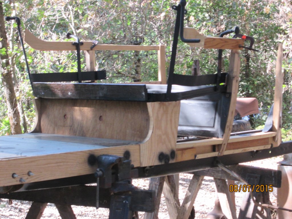

Post by Wayne Sheldon » Thu Mar 18, 2021 6:26 am
For a little comparison, I think I will post a few before and in process photos of my 1915 runabout. Mine wasn't in a fire, but I have restored panels and fenders from fire damage before. And my body had suffered from an attempt a few decades back by someone wanting to build a bucket T hot rod. Along with some rust-out (not bad, but enough) took a lot of work to fix it up to decent. I don't have many pictures of my fenders or side aprons, but most of them were in much worse condition than the body was.
Most of my project are parts rejected from other people's restorations. A lot of it is done now, and I just need a few things to get it put together.
It can be done! And I think you can do it with yours!
