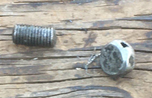

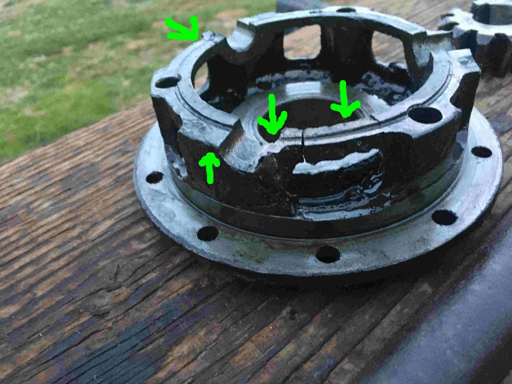

After careful study I determined that a failed original bolt conspired with a lot of worn parts to cause a significant problem.
This bolt was in the ring gear holding it to the differential casing. It sheared off and was held to the ring gear by it's safety wire. As you may see in the photo it lived that way long enough to get tumbled like a rock at the beach... rounding off the edges until the safety wire broke. The bolt head then found it's way between the pinion and ring gears. This snapped the pinion in half and broke the Woodruff key and the keyway of the driveshaft (on the taper). The force was so great that the differential casting broke. This sudden jam caused the triple gears which were on worn pins to jam teeth together (because of looseness on the pins) and snap off a triple gear tooth and allowing the triple gear to go out of time seizing the transmission. The result was broken shafts and bushings on the low and brake drums, trashing the drums. The bushing on one triple gear shattered and bent the triple gear pin trashing the flywheel.
As a result of this I had to do some repairs even I feel to be significant. I built up and balanced a flywheel and a transmission. Replaced the drive shaft, differential case, pinion, ring gear bolt, Woodruff key, brake and low drum, clutch shoes, flywheel and all the magnets. Other stuff not due to the damage caused by the bolt was replacing the clutch drum and clutch plates, and the 4th main.
The amazing thing is my daughter said she didn't hear anything, just the engine died! I can't figure that one out, I'm almost deaf but she isn't!

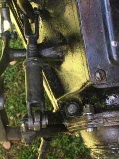

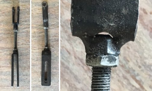

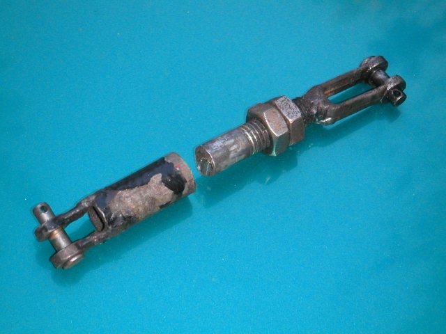

Prior to redesigning the slider I used the one which I purchased with my accessory brakes. After using it for a short time I found that the brakes faded in use. The problem was that the 5/16" all-thread rod used in compression to push the brake mechanism failed by bending in the middle. You can see in this photo that even after straightening the inadequate rod retains a bend.
Next you can see the design I came up with to replace this setup. I used 1/2" galvanized pipe, a 1/2" bolt, and two clevis adjusters. They were welded together and replaced the manufacturer slider. The pipe piece slides over the 1/2" bolt piece and is adjusted with the jam nuts. There is more than enough of the 1/2' bolt inside the pipe to keep the interlock from buckling. I have been testing this design for over 15 years and probably over 30,000 miles.
This design is both adjustable and so stout that it continues functioning under the forces encountered in the most severe panic stop.
I urge all of you who do not have accessory brakes to get them. If you have an accessory brake make sure it works by your pedal as you may not be able to grab your brake lever in time. Don't use an under-designed interlock which could cost you, your passengers, or others involved in the accident an injury.
Please look at your interlock and see if it is assembled with parts like 5/16" all thread which are meant for tension NOT compression or which have poor insufficient welds. If you have such an item on your car I urge you to consider upgrading to something safe. If you are thinking of buying an interlock please evaluate your choice and forgo one which has light, possibly inadequate design and construction.

I am using all the parts from a popular aftermarket manufacturer except for their interlock which I have found inadequate.
The brake lever has a pivoting yoke on it which actuates an equalizer pulling the accessory brakes when the parking brakes are pulled.
The service brake pedal works the transmission brake when pushed, but it also works the interlock which also pushes the yoke... and therefore the accessory brakes.
To work the clutch you must either push the low pedal or pull the brake lever... either, or both, will do the job. BUT stomping the brake pedal WILL NOT work the clutch. That is why I pushed the low pedal 1/2 way down as an automatic, ingrained, part of mashing down on the brake pedal.
In every normal stop the emergency stop procedures are practiced. Some people always throw in the hand brake on every stop to make the addition of the parking brake part of a normal stop and therefore part of the E procedure. I frequently practice this but not enough to make it automatic. I am now glad that I don’t make that automatic because I had to have both hands on the wheel to steer. If I had one hand on the brake lever I couldn’t have avoided the Z car!
Since I don’t go for the brake lever in an emergency I am relying on my interlock to do it’s job. If I still had my fold-up slider interlock I suppose I would always use the lever as the actuation of the outside brakes would be risky otherwise.
This is why I posted my interlock photo now as well as about 15 years ago.

I'm not sure if you would consider that rear end "unknown". I completely went through it when I built it up about 25 years ago and then a second time about 20 years ago after I destroyed the set of needle bearing thrust washers, replacing them with bronze thrusts. Then again about ten years ago when I replaced the bronze while it was all apart to replace the failed ten tooth pinion.
I am thinking that the ring went on 20 years ago and the safety wire was replaced ten years ago. I don't routinely replace all fasteners when I am working on the car so the ring gear bolts are probably 90+ years old. I think that we are all at (a small) risk of this type of failure as parts age... even if we have "known" assemblies!
There was enough force to break the differential carrier casting in several places.

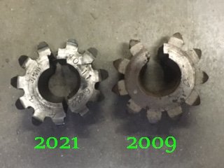

Here we see the pinion placed in around 2001 and broken (coincidently about 100 yards up the same hill from the current incident) in around 2009. On the left we see the pinion used for about 12 years (2009-2021).
