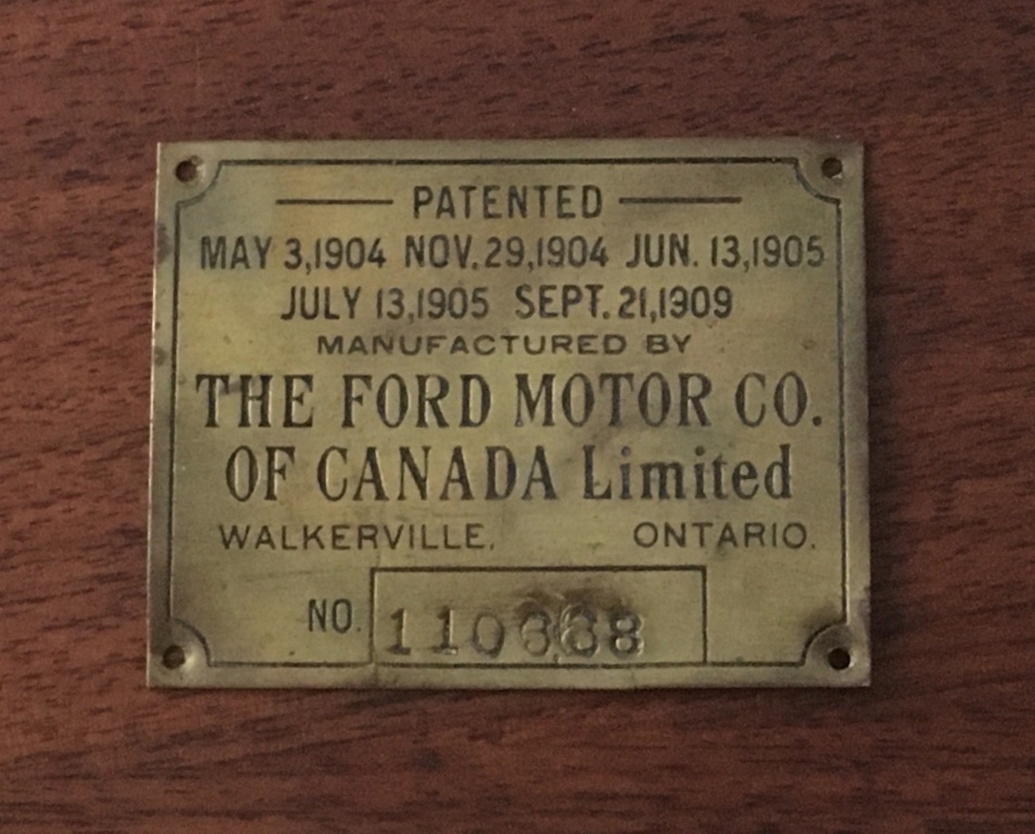

Canadian 1912 dash mounted serial number plate.

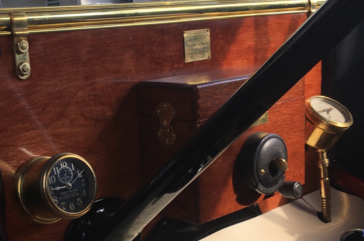

The brass plate was fastened to the dash with brass nails.
Plate location original to my 1912. Some plates were mounted higher, right against the brass dashboard trim.
The plates were centred with the coil box.

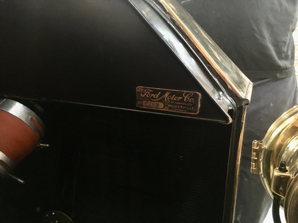

Canadian radiator plate.
There are no (zero) Robertson (square headed) screws on my Canadian 1912. I don't know about
later years, but my car's body is Canadian made and 100% original. Only slot screws were used in its construction.
