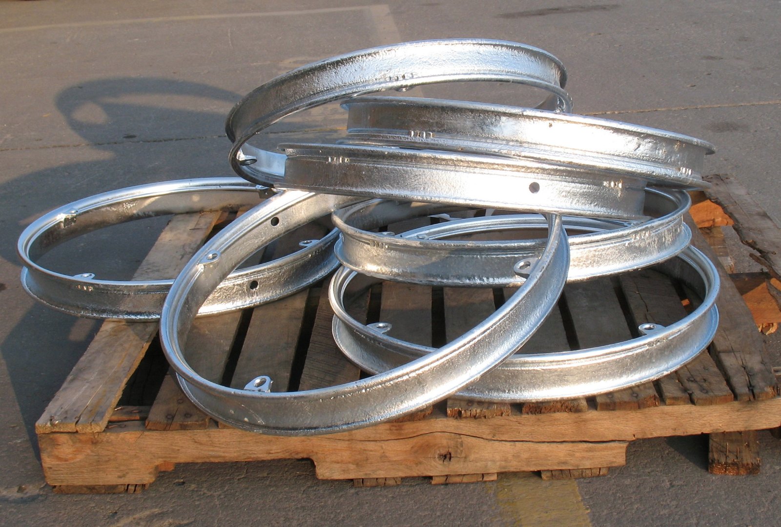

Every time this subject comes up, confusion walks upon the scene. Consulting the dictionary: galvanize coat (iron or steel) with a protective layer of zinc : an old galvanized bucket.
There are two methods of galvanizing, electroplate and hot dip. The hot dip method is preferable because it applies a thicker coat of zinc. That's why I buy old hot dipped nails at auctions. New electroplated nails you now get at the hardware store are so thinly electroplated that they turn to rust spots in a few years.
Rims galvanized with the hot dip method.
The Model T Encyclopedia says demountable rims were zinc plated (galvanized). It says nothing of cadmium, which came into use for plating on an industrial scale in the thirties and forties.
As the picture shows, I have my rims galvanized. If I were painting them I'd use silver (aluminum) Rustoleum, also known as Oklahoma chrome.
