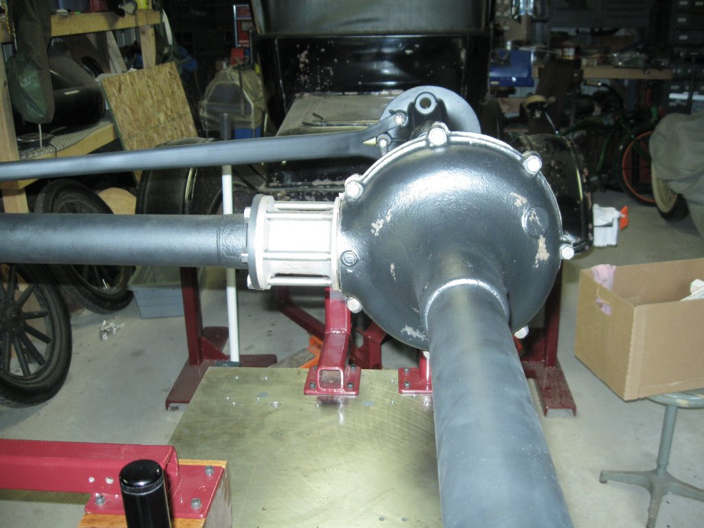

Just a quick update. I was able to go out to a new acquaintance on the weekend and got a lot of new used parts that will replace some of my mangled ones. I still have to order from the vendors but the list is about half. I did get a used axle at a good price but I'm not sure I will be able to use it when I get playing around with it. The brand new sleeve at the pinion end is a loose fit and I've been told that the sleeve will shrink if I heat it and let it cool on the shaft. I''m skeptical because in my idea it will only shrink back to its original size and not get smaller to fit tightly. We'll see.
I'm putting off ordering parts until I get the hogs head off as there is a groove in the low drum and I want to see the condition of the band linings and if there is a rivet causing the problem or if its a groove previously made. I was able to get the 10 easiest bolts out of the hogs head this evening....saved the other two for a fresh start. Any words of wisdom for pulling the hogs head by myself in a single door roadster?
Any way it'll be nice to start putting things back together some day instead of constantly tearing apart. jim

Another update:
I pulled the hogs head tonight. Brute force and a little finesse! Had a hard time breaking the bead on the gasket, ended up using a jack under the starter corner and standing on the running board to get it to pop. Even then getting it out the cab was very awkward the exhaust pipe is coming right out when trying to get it back in for sure.
It looks like the low speed band front corner was rubbing on the drum and causing the grove. One band doesn't appear all that round and I've read on here that that is important. Another band seems to be twisted a bit too. I'm really thinking detachables as I'm not sure I will be too interested in ever pulling the head again. I didn't see them in the catalogues I've got, but should find them somewhere.
thanks for reading. jim

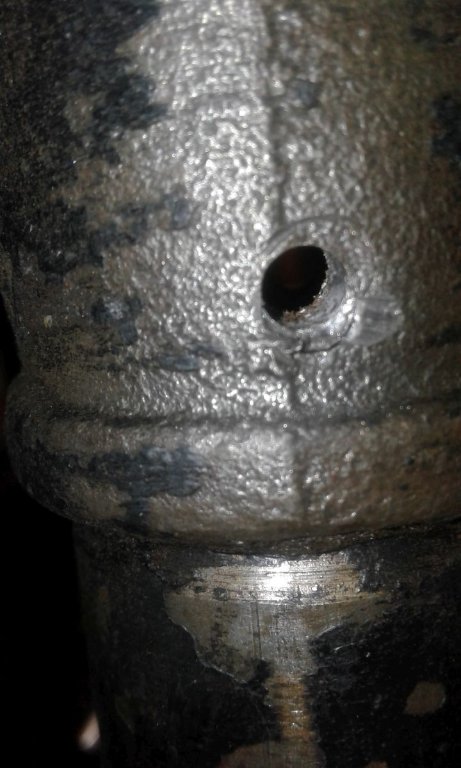

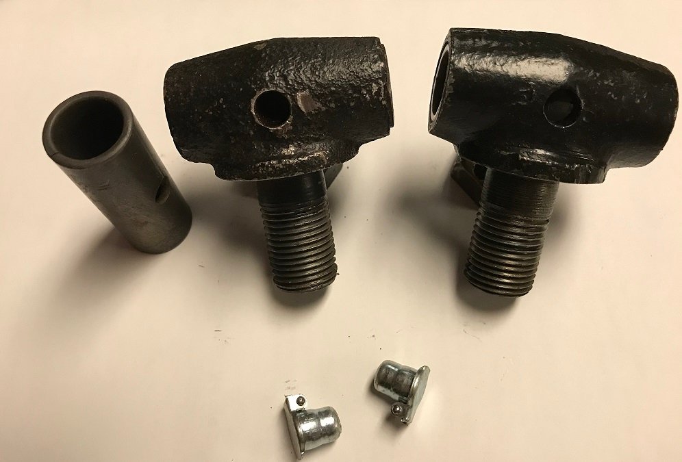

I'm making progress but a big set back tonight ( I think ).
I've finally got the sleeve on the shaft at the pinion end and the bottom end assembled and all looks great. Nice and tight. I ended up reaming it a lot with a socket and some very course emery paper wrapped around it that I have around. It took about 8 hours of trial and error and 350 degrees of heat but it's on.
When I installed the bushing at the universal end, the drive shaft went in but the pin didn't line up in the universal. Not even close. So I decided to take out the bushing and see what was keeping it from seating as it had to be the problem. The drive shaft pin hole was lined up perfectly with the access hole.
I don't have a puller so I set up the same way as I pushed to old one out - with the old drive shaft and a socket. The axle book said to use a socket with a 1.25 O.D. (15/16) so I found my impact 15/16 and measured it at 1.25. Stuffed it down the tube and .... sheared off two of the rivets in the tube.
Does this make my case a piece of junk? Can I put a couple of tack welds on the outside to make up for the sheared rivets?
Any way, I went and got a 13/16 socket that would clear the two remaining rivets and punched the new bushing out. When I got it out I compared it to the original that I'd removed very closely and they are almost identical in every dimension including the thickness of the bushing rim. What I did find was that the 1/4 inch hole that I drilled in the new bushing was exactly to low in the bushing compared to the old one - the difference I need to line up the pin. I couldn't see any reason in the shaft for it not seating properly so I guess I just need to give it a lot harder love tap when installing it. I may have to find something else to install it with then my 1 1/4 inch socket as it left a bit of a mark in the bushing surface on the first attempt.
Thanks for your help. jim
- Posts: 5261
- Last Name: Hatch
- Location: Alabama
Re: drive shaft and rear end rebuild
If the two rivets did not matter do you think Henry would spent the money to put them there? Either replace the rivets or the tube. Just my 2 cents worth.

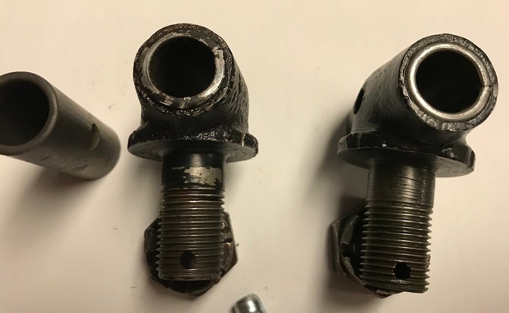

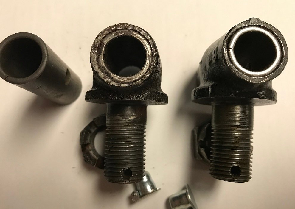

The sheared rivets are not that difficult to replace. I got a piece of solid round stock and ground four tapered flats on one end so that it could be driven down the shaft until it engaged the rivet heads. This became the buck against the rivet heads. Remove the sheared rivets and place two new ones in the tube. Then fit the buck and you are free to form the new rivets to suit. I have used this process a few times to fit new castings for two piece torque tubes.
Hope this helps, Allan from down under.

I was able to pull one of the rivets with a pair of pliers and the other I had to drill out. I've attached a couple of photos just to see if I could.
I stuck a cheap aluminum rivet in the hole to see about fit. I've been informed about a specialty fastener place near here so I'm going there tomorrow to see if they have the structural rivets that seal themselves and have the shear strength and in steel not aluminum so that I don't have the corrosion of two unlike metals happening. (That's one run on sentence!)
We'll see what they say and will default to building the bucking tool if they can't help.

The driveshaft is back together and to speck! All I have left to do is peen the rivet in the universal joint. I ran out of time tonight.
The all steel blind structural rivets I got worked out great and instead of reaming the bushing I ended up having to shim behind it to get it thick enough.
Thanks everyone for your replies and ideas, its good to have a place to get help from people with experience.

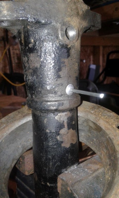

I was installing new thrust washer pins tonight and had to take the first one I tried out and ended up destroying it. It wouldn't sit flush with the case and sat way proud of the hole. The problem is the pins are .250 long and the holes at the edges are between .218 and .221 deep. The axle book talks about filling the bottom of the hole so the pins don't sink in too far but not a mention about sitting proud.
Has anyone come across this before?
I'm debating about beveling the bottom edge of the pin or trying to deepen the hole without making it oversized with the hand drill.
jim

I assume that you are having problems with the thrust plate pins in the axle housings, not the pins in the differential carrier half's. It sounds like in a prior rebuild someone drilled out the old pin but didn't get it all out due to the taper end on their drill bit. Try carefully using that hand drill and a slightly under size drill bit before you modify the new pins. Go slow and you should be ok.
- Posts: 1006
- Last Name: Bartsch
- Location: Dryden, NY 13053
Jim I've got the same thing going on with my '26 differential. Just held the pins in my cordless drill chuck rotated at slow rpm gently kissed grinder wheel to shorten. Dont overdo, it more difficult to make them longer. Do not drill the holes deeper for the reason you stated.

Jab35 - interesting that we are both working on 26's with the same problem. I wonder if its a thing with the improved diffs.
Kmatt2 - I'm going to go and have a closer look at the holes and see if there appears to be any residual pins left from another rebuild - they should be easy to get out if so.
Other wise I'll look at the shape in the bottom of the hole and see what mods will be necessary. Thanks for your suggestions. I'll let you know what happens. jim

Jim: The thrust plates had been turning on the inside of the differential and wore the pins and inside of the housing making new pins a few thousands too long both axles had a groove at the edge of the gear where the washer had worn the axle. With all this wear, I may need thicker brass thrust washers, haven't got that far yet.

I was looking at re-bushing the rear perches while I waited on parts and discovered that one perch is badly worn beyond the bushing. They are of course improved perches and are not available at Lang's. I check a couple of friends I know and they don't have any either. Steve at Lang's said that he was having problems finding them too.
So I can get a good pair of used pre 26 perches and I'm wondering if they are interchangeable to a 26 axle? I checked the bolt size and they are the same and it looks to me like they could work and maybe raise the car about an inch to an inch and a half.
Has any one ever done this, thoughts?
Thanks in advance. jim

Jim I know the vendors sell ring gear shims, but that does not mean they are a good idea. If you need a shim behind the gear to get the two closer, the same result can be achieved by using the same thickness shim behind one of the steel thrust plates. There is no drive involved in this application. The ring gear shim will introduce another interface between gear and housing, and more chance of movement at that point.

Jim: I'd suggest these if shims are needed, I would install in differential housing where two pins are located to secure the outer thrust washers. Available in 0.010" and 0.015 ". https://www.modeltford.com/pl.aspx?t=s& ... 010&page=1
Grab those rear spring perches from Frank! Best, jb

Thanks Frank for the perches, I'm looking forward to getting them early next week.
Allan and James - I'd already ordered the ring shims by the time I saw your posts. I'd ordered them because the axle repair manual suggested using them instead of "moving the diff off of center by shimming the thrust washers". From your comments I can see advantages to both approaches. Have there been problems with the ring shims since the book was written? Would a little lock tight between shims add a little insurance from stopping movement? jim

Jim, the ring gear must be tight against the carrier. 10 bolts are used to maintain this tension. The whole is designed to function as one part. The ring gear is manufactured separately for serviceabilty sake, the friction between the gear and carrier being the sacrifice for this. By adding a shim you would effectively doubled that sacrifice.
Shims are best used in stationary applications, like the T rods and main bearings and the magneto coil plate.
Many use shims on the rear axle/hubs to compensate for wear. The best solution is to fit new parts. Second best is a single shim. The problem gets worse if multiple shims are used.
If the rear axle rebuilding manual suggests that shimming the diff off centre by .010 to .015" is a problem, I just wish all my problems were of the same magnitude.

Jim: Have you confirmed that a shim is needed to obtain proper ring gear/pinion gear mesh? I read that information in the book too but am not to the point in my rebuild where I can confirm the need for additional shims. Based on others' experiences posted here, some have noted that the brass thrust washers had to be machined thinner to achieve mesh specifications. Time will tell in my rebuild.
I'm with Allen, if the thing is only 0.015" or so off center, I'm ok with that. Let us know how this turns out in your rebuild. jb

I've got it all re-assembled except for the outer seals, sleeves and bearings. All seems to be looking and feeling really good. As I had the ring shims and shipping makes buying parts in dribs and drabs so painful I went with them. I ended up using .040 to get the spec on the back lash.
Jab35 - I sure didn't end up shaving any off of the thrust washers. I actually made my own shim from some .015 galvanized tin I had around. Used a hole saw, tin snips, and drill press to fabricate it but it looked almost store bought I must say when I got it done. Worked out well as it was just what I needed with one slightly thin steel thrust washer in the mix.
I've been thinking about putting a small (strong as I can find) magnet on the filler plug to attract any metal that develops on the housing from time to time. Sort of a way to keep track of what's going on in there. Has anyone had similar ideas or experience?
I'm hoping to get it off of the bench tomorrow and onto the floor to finish the outer axle stuff and maybe get it all painted up and back in the car on the weekend.
Frank - the perches arrived today with the card and are now on the backing plates. Very nice parts...much,much better than what I had. Thanks.
Thanks everyone for your ideas and help so far. jim

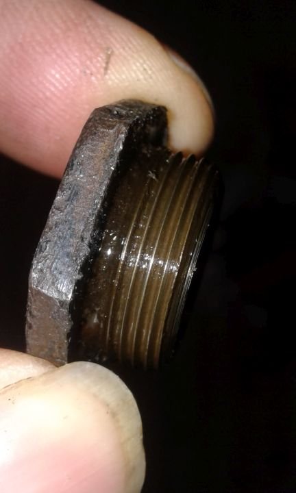

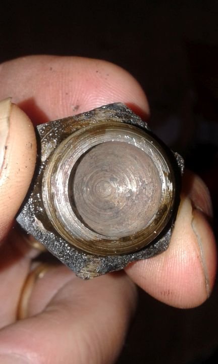

So this is the plug in my diff filler hole. It doesn't look at all like the part listed for 26-27 plug in the link. Are they interchangeable?
- Posts: 4963
this is the earlier style. Pre 26. Same as transmission.

If it is a Canadian car, it may be correct. Some things changed earlier then the US built cars and some things stayed the same longer. An example would be the casting date on block, I think Canadian cars had them to the end, unlike US that ended around 1921.

So I must have a Canadian 26 - 27 rear end then. Looks like I'll fabricate a magnet on my plug - maybe on the out sided with some epoxy.
Any way, I got the axle drive shaft unit off of the bench today and into the car again. I had a bit of a chore getting the universal into the back of the transmission but eventually got it.

I wouldnt sweat the plug. I have quite a few with the early style plug. I believe they went into early 26. Its like the 3 or 4 different backing plates on a big drum.

Well its May 1 and I haven't been on the sight in a while it seems. I'm glad that I'm working but it gets in the way of garage time.
Today I spent the whole day weight lifting the hogs head in and out of the car many times. Finally got it in and bolted down. The peddles are installed and a rough adjustment made. I've read on the forums about the band tool that looks like a 'U' and how some find them really handy and others not so much. Well I'm in both camps after today's time with the T. I couldn't get it to work very well as intended and found that the zip ties worked best for me, but I did find the tool handy when trying to install the springs, washers and nuts. On the brake band I compressed the band and spring with a large screw driver and put the band tool on just the outer edges of the band ears to hold it compressed while I used both hands to install the washer and nut.
On the reverse band I did the same thing and used the band tool wedged down in between the low speed band and the reverse band to hold it compressed while installing the washer and nut. Worked really slick.
Hope this helps somebody some day.
I have lots of things to put back together now but I feels good to be putting things back instead of tearing things apart to get at something.
Thanks everyone for the help on this project. jim
