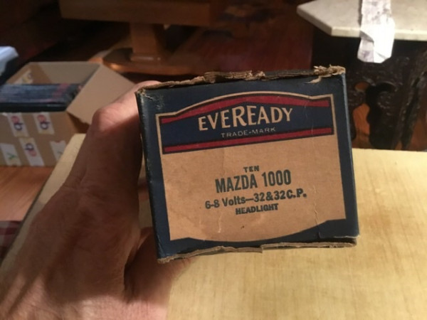

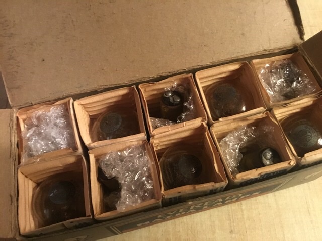

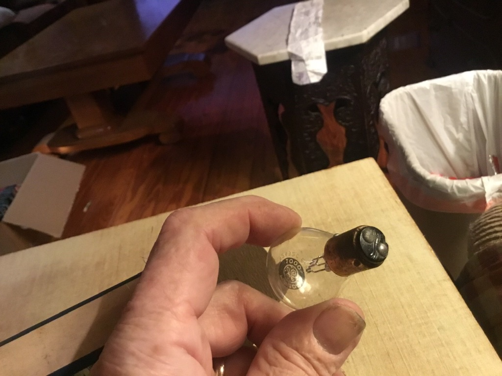

Hello all. I just bought a box of ten (10) circa 1930 Mazda 32 & 32 CP, 6 to 8V auto headlight bulbs. Can these be used on my 1926 Model T? It makes one wonder how an original box of ten survived 90 years without ever being used. Then I come along. LOL! The vintage box looks good in the tool box in the trunk of my T. With both filaments being 32 candle power, is there a bright and a dim? Thank you. Jim Patrick

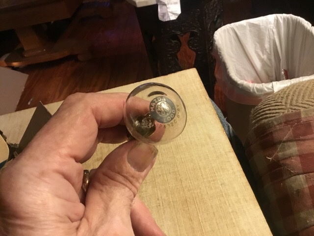

Bright and dim (high and low) are determined by which filament is on. The top filament results in low bean, and the lower filament high beam. The reflector shape determines where the light goes. These may actually have the filaments in the correct orientation as the new bulbs give you a left and right beam. Bill Robinson and I have modified our light sockets to actually get a high and low beam.

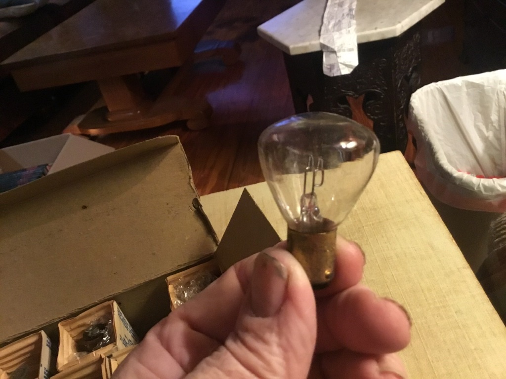

There appears to be a center filament and a filament that is next to and offset from the center filament. I believe that the center filament would be the high beam since it would utilize the entire reflector, while the offset filament would be the low beam since it would utilize the upper part of the reflector, directing the beam downward. Is this right? Jim Patrick.

Mine are Westinghouse Mazda Lamps, 21/21 1114. When I got the box is still had 8 out of 10 still in it, I have used 2 of those. On mine the offset goes to the top and is so marked on the bulb. Check you fit to make sure the filament is horizontal not vertical when the bulb is installed. Different cars had the contacts orientated different. Also make sure the globe is not loose from the base, super glue will fix that.

Glue it even if it doesn't seem loose. Spray silicone lubricant in the socket and on the base before you put the bulb in and try to turn it. I once went through seven spare bulbs that twisted in the base and were wrecked. I didn't drive anywhere that night.

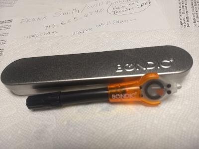

Steve Jeff is right on the money. glue all Your bulbs weather they need it or not. I use the Bondic UV setting glue / compound
doesn't stick to Your fingers like super glue. run a bead around the old glass to base seal and then use the UV light on the end of dispenser pen to run around the base and harden the glue. No Fuss No Mess. Bondic can also be used to build up worn surfaces with multiple layers and can be sanded. I don't get a commission. just think the stuff is great. same stuff the Dentist uses to hold Your teeth together.
