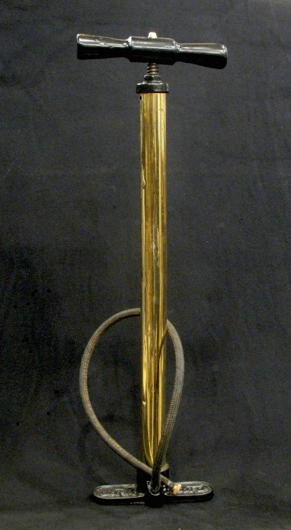

Post by Steve Jelf » Mon Mar 22, 2021 1:22 pm
...and your defense for why you did this to your car.
:D
A tarp to lie on under the car, and to catch small dropped parts that will otherwise disappear into the terrain.
A 2 x 8 block to go under the jack.
Wheel chocks.
3 irons are enough, but they should be long.
Spare bulbs (1915-1927).
A can and brush for washing parts. You have a solvent dispenser on the bottom of the carburetor.
At least one fresh tube of Ultra Black.
Gasket paper and scissors.
#1349 and #2335.
Tissues & paper towels.

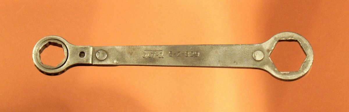

Specialized wrench for adjusting transmission bands, the medium crescent wrench will do that.
So will the little #1917 Ford wrench, but the Ford 5-Z-829 is so much handier than either of them I keep one in my tool box./

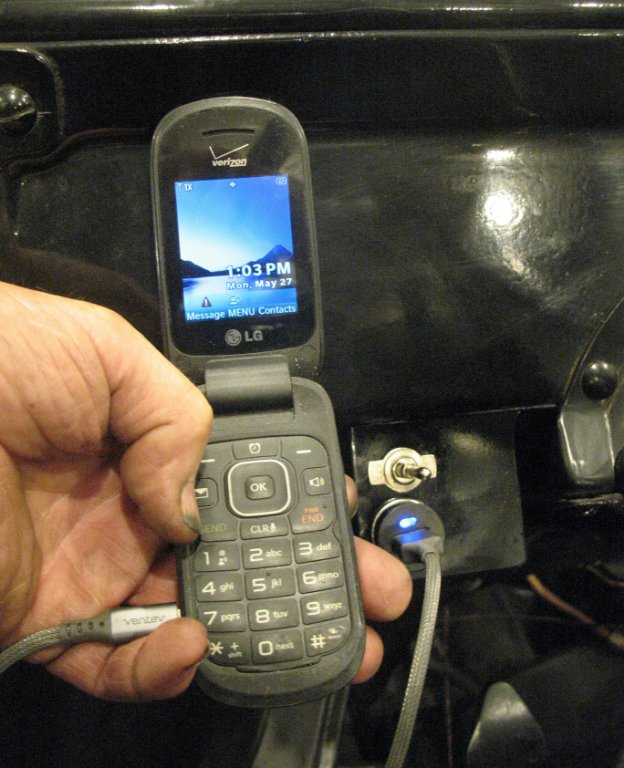

...add to that a 10 dollar phone charging battery.
You can charge it off the car battery.
