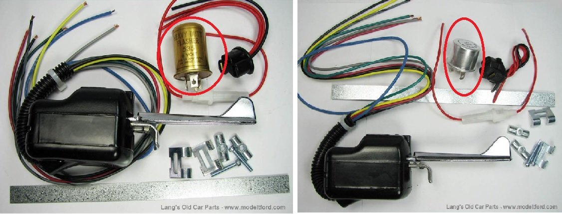

Is the switch voltage-specific? I ordered Lang's 6v turn signal kit but they said their supplier has backordered the switches for a while now. I've found some similar switches at other general automotive retailers, but all claim to be 12v. The only part of the switch I can think of that might drive voltage specification is the indicator light, which I'm guessing if incandescent would be replaceable.

The flasher needs to match your voltage. If you buy a 12V kit, you'll need to get a 6V flasher too.

The only apparent difference in Lang's 6V &12V turn signal kits is the flasher. This switch is voltage insensitive at 6/12 volts
Now if you intend to use LED's neither of these flashes is correct., you need a flasher for LEDs, so just by the switch and your own flasher
