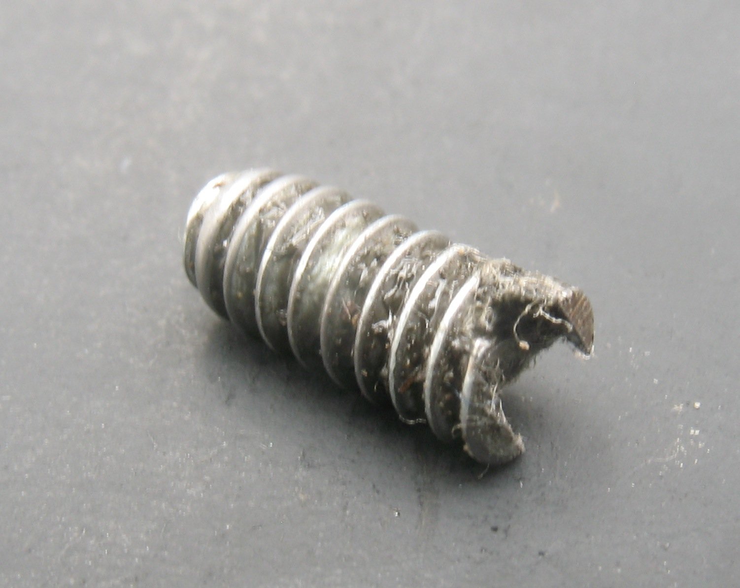

Yes, I know it's supposed to be a regular round head machine screw. But this is the second steering gear case I've found with a headless set screw. That makes me wonder if they tried these for awhile.

Prior to about 1970 or so, any machinist worth his salt would know that a slotted headless screw would typically be used where neither part has a through hole such as in this situation, pulley securing, etc.. In the face of no documentary evidence, ever, (to my knowledge) of this being on a Ford drawing, I would suggest that (in my opinion) it is an early non-Ford replacement for the frequently missing screw.
I have seen slotted, headless screws in gearboxes, too, and in every instance, the slot was very wide, like made by hand with a saw (something like in the photo above), and never looked like a properly fabricated part .

FWIW, that screw has much coarser thread than the usual item. I would hazzard a guess that it is indeed a later replacement, perhaps even oversized to make up for stripped threads in the housing.

Agreed. Ford part # 3505 is a roundhead machine screw. Anything else is a spurious part!

The little set screw is 6-32, not oversized. I was lucky to get it out before one of the "teeth" broke off. I've replaced it with a round head 6-32.
