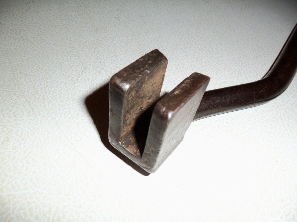

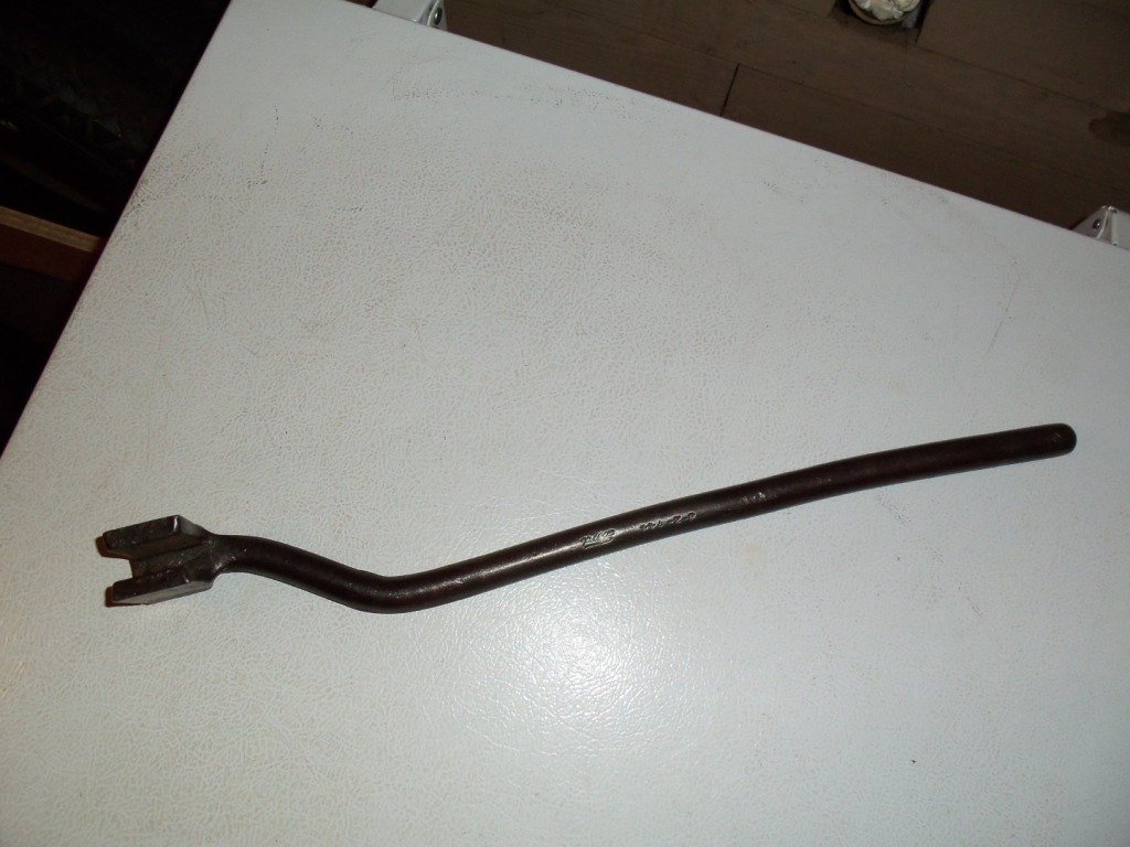

This is the Ford factory bending iron ! You can see the script & Z number.
I'd change out the floorboards !

That’s a tool that can easily be made. Or as some do use a large pipe wrench or a good sized adjustable crescent wrench.

Sure could John - I just happen to collect original tooling for Ford Model T's !

Cool seeing the tool.... Haha
