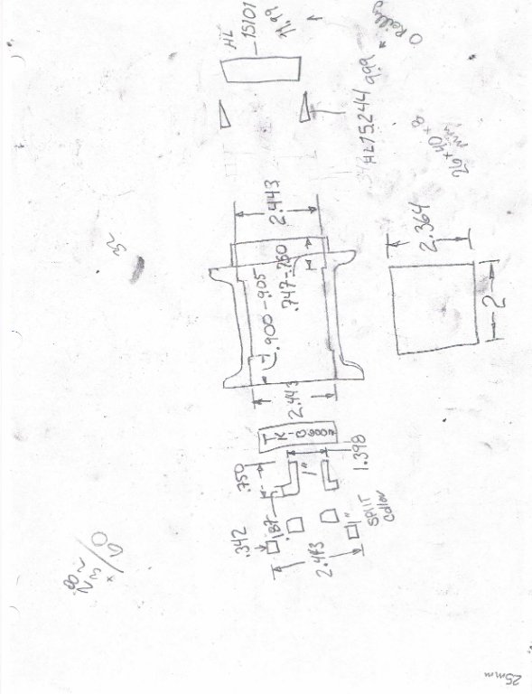

It's nice to know I'm not the only crazy I can do that person out there! I don't think it would be appropriate to publish some ones instructions with out there permiision. I had the same thought you have about making my oun roller bearing spool ( also having some that are to pitted to use) The deciding factor was when I could not get the backlash set on the gears until I discovered the bore was off center by almost .010 " so every time I assembled it with a different shim nothing made sence it would not change the wat I expected. Once I discovered the offset I could set the backlash by rotating the spool.
You will definetly need a lathe and some good measuring tools. I purchased the bearings, split collar & bushing@ the local bearing house. I made the spacers out of a old rear axle housing tube ( it was a bent one) Once I had it assembled I cut a shallow grove in the shaft and ground the ends of the split collar so it locked into the shaftand could not just slide back giving it to little bearing preload. I would spend the extra time to indicate the spool
before starting so you will not run into the same issue I did with the one I purchased. Here is a crude drawing of the notes I made. Hope it will help.
Craig. OK I give up turn your head!!

Here is a pic of the parts

re tun on head, no problem, I just rotated my saved copy!
thanks that will be great help. I am redoing my back plate so I can mount my 4 jaw. My 3 jaw is about .015-.018 out, ok when turning down a part but not so good if you have to keep a center.

Your drawing, I thought, was excellent, wish I had it before starting!!
