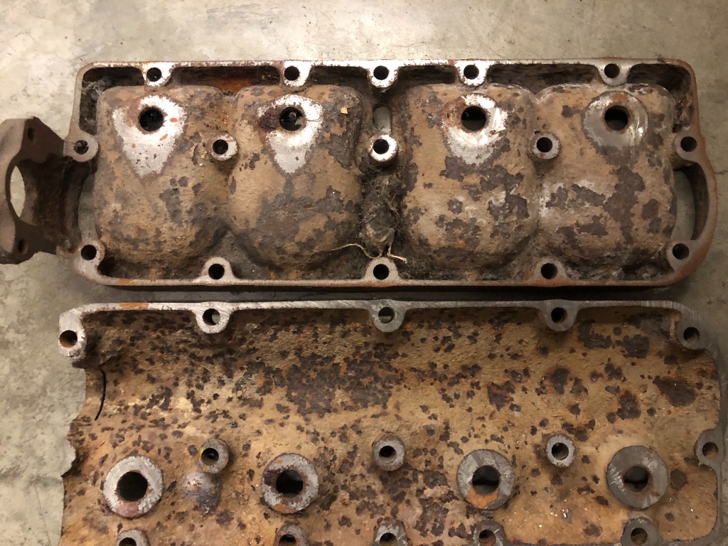

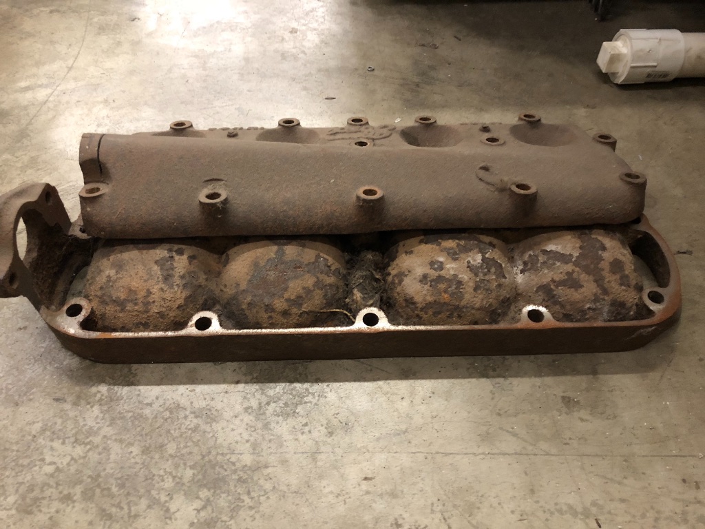

The best spot is here Danny!
Hank

I like the cutaway head! That’s awesome

Where you aware the MOUSE plug was in the head when you cut it?
Never would have occured to me a plug like that.
I guess you could flush forever and not get that out.

The engineer gave his life! LOL
I did multiple temperature checks over the years and found there is a heat eddy right where I marked it. You really want "True" head temperature when it comes to engine performance. As another find, MotoMeters are off by up to 10-15 degrees. Just in my observations.

The wall thickness on the head is a lot less than what I would picture in my head. But I have a lot going through my head😳
Hank, I should have thought about this before we bolted the head down

Post by Henry K. Lee » Sun Apr 04, 2021 11:14 am
To easy to do it even with the head on. Vacuum cleaner and pilot drills working your way up.

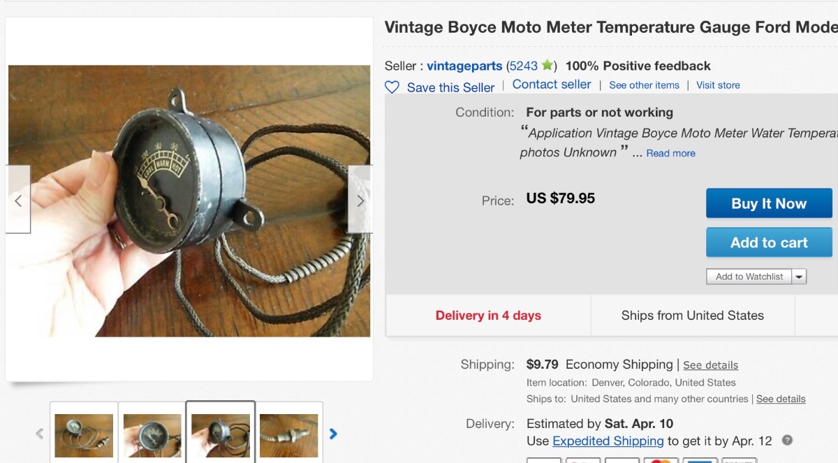

Danny, mid 1920s motometer came out with steering column mounted water gauges and also dash gauges. This may be an idea for a period item. This dash type is on eBay right , looks complete. It’s nice if the seller will drop the bulb in a cup of hot water to see if it works. Otherwise a crapshoot.

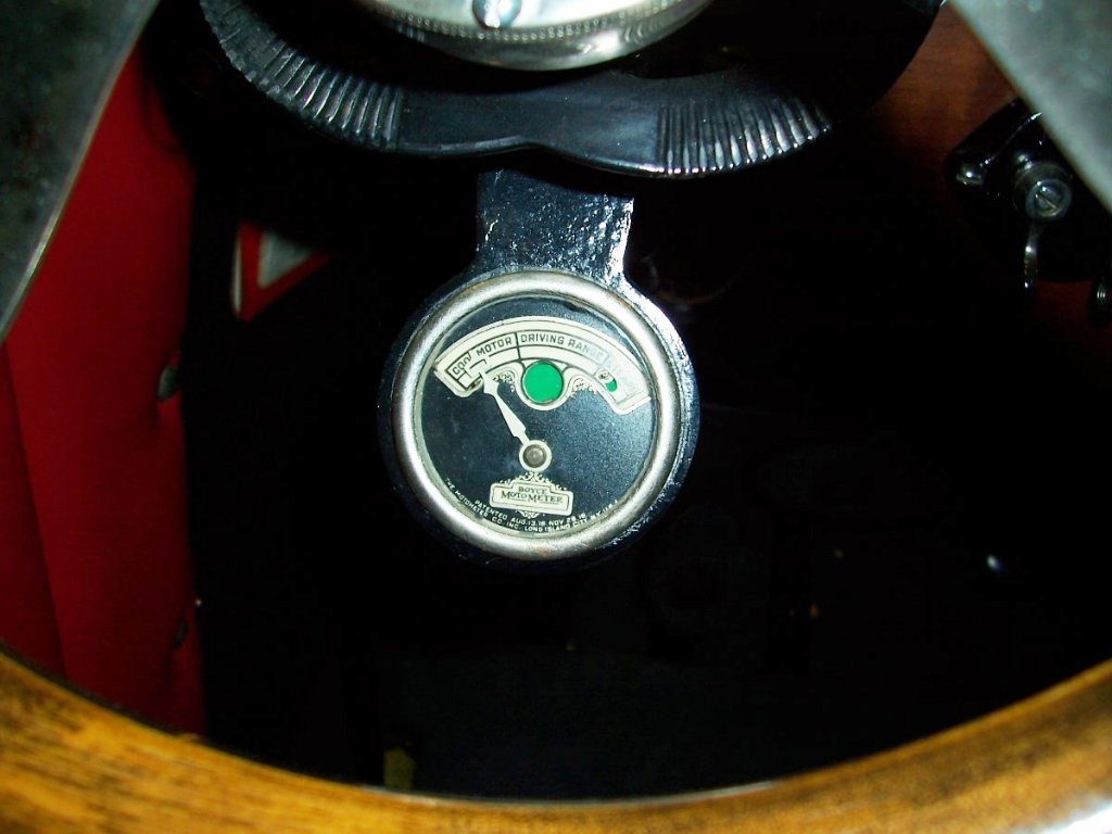

Here's the original Boyce Motometer water temperature gauge on my Racer - it was marketed for the Model A Ford with a round steering column mount & 2 ways to attach the sending unit - one was in a special head bolt and the other was a contraption for the upper radiator hose -I chose to mount the sender in the block. This unit has a small arm that will lean on the needle when things begin to get too hot and a "Red Ball" shows up - totally cool !

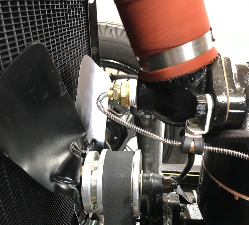

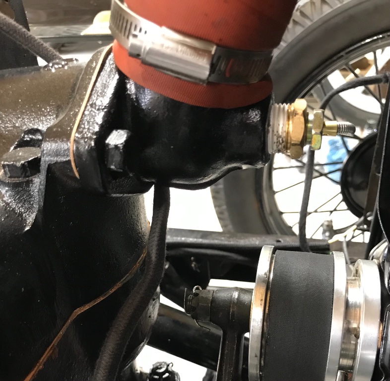

Here is what I did on my speedster.
I had an old Nims style ‘26-‘27 water pump that was missing the impeller and shaft. I tapped the impeller hole in the housing for pipe thread to accept the fitting of the temperature bulb. Seems to work well. It uses a modern dash mounted temp gauge.
