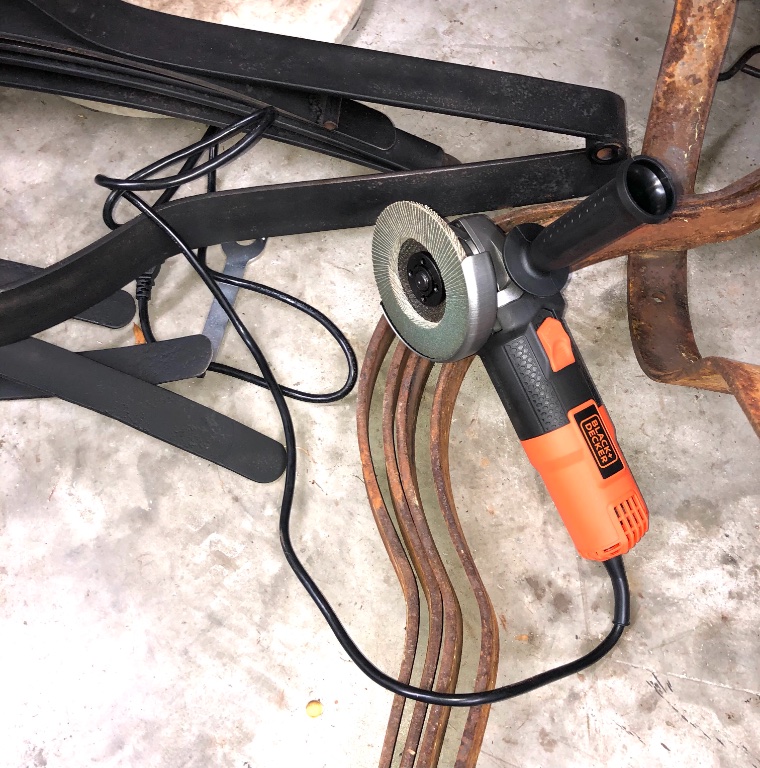

Hand sanding to get rust off? Even Henry put electric on his T ;)
Just got a new grinder and disc to finish the rust removal, the ole Craftsman grinder finally conked out after 30 years :?
