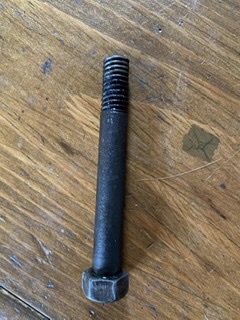

Hello everyone, hope you and your cars are all well.
I was replacing Lizzie’s Kingston carburetor with a new Holley NH as the old Kingston was flooding badly and I figured I would pull it out and rebuild it and in the meantime use the rebuilt NH and in the end I’d have a spare carburetor ready to go.
As I got the new carburetor in, I noticed the horn bracket was loose and I decided I would retorque the head bolts to 55ftlbs (I think I have a steel head even though it does not say Ford MADE IN USA on it because it’s magnetized). Most were all up to snuff at about 55ftlbs.
Then I got to the center bolt just ahead of #4 plug, and it was only snugging to a point then becoming loose again. I snugged it down as much as it would go (about 25ftlbs) and I started the engine to see if the mixture was good. Oil began gurgling out of the bolt and I shut the engine down (it only ran for about 15 seconds). I began unscrewing the bolt while praying that it wasn’t cracked inside the block.
Turns out the bolt came out in one piece and the bottom most threads are all totally stripped. I’m going to pull the head off the engine tomorrow afternoon after work to see what’s going on inside the back two cylinders and see if the top of my block is good (hopefully it doesn’t need to be milled).
It looks like the bolts are missing some threads compared to pictures I see of other T head bolts, maybe it is cracked deep inside the head after all. :(
How do I measure the bolt to see if it’s missing the bottom?
How do I determine what bolts I need? Seems like there are different bolts for different heads.
Are the bolts supposed to bottom out?
How do I determine if I need to retap the block threads?
What thread tap and drill should I use to retap the block threads (if necessary)?
What should I do immediately to prevent any further damage to the engine? (Remove head, oil, and coolant?)
Here is a link with pictures of the stripped bolt. I’m not sure if it’s cracked. https://imgur.com/a/G0omH3a
How should I proceed?

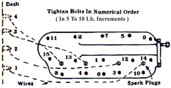

Just my opinion but 55 lbs. are a bit much in my shop - 45 lbs. is usually plenty - there will be more opinions than mine, I'm sure. It appears to be a stock head bolt and the threads are toast and more than likely the block bolts also. There are "high" & "low" head bolts - they're 7/16 - 14 x 3 & 1/4" long for the high head. And no, the bolts should not bottom out !

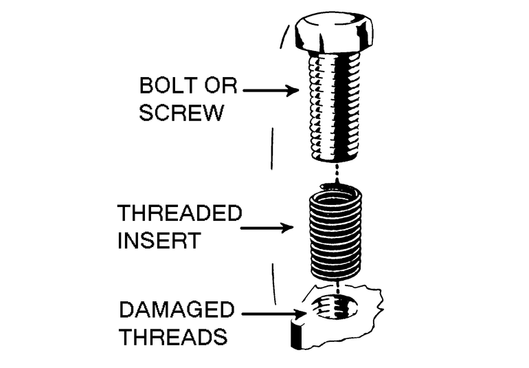

Re fixes for the problem, I would,
*use a drill of appropriate size to clean out rust/carbon in each hole in the block.
*use a bottoming tap to clean up all the threads and blow out each hole.
* inspect all the cleaned out holes and helicoil any which are doubtful. I prefer threadserts to helicoils.
* Check each hole and each bolt for engagement prior to fitting the head.

Recommended torque is 50lbs.
Since oil gurgled out, the leak is from the cylinder and not from the water jacket, so you have not punched through the bottom of the hole and entered the water jacket, which is a good thing.
1. Place the damaged bolt next to the other bolts. If it is shorter, you have a problem. When I worked for the Railcar repair industry, this was a common occurrence and our machinist had a special type of welding rod that he would slip into the hole and touch to the broken stud. The rod would weld to the top of the broken stud, but not the walls of the hole. He would then grab the rod with a pair of pliers and unscrew the stud out of the hole. I wish I could tell you more about this special rod.
2. Again. Compare the bolt with the other bolts. If the threads are the same, no one in the past has retapped it a different size or tap. It would be advisable to buy an entire new set of bolts, in case some of the other bolts are fatigued or stressed and about to break. I have never had trouble determining what head bolts to get. There is only one type for the Model T engine.
3. No, the bolts are not supposed to bottom out unless the holes are full of crud and rust. It would be a good idea to blow out all the holes with a high pressure air nozzle, but not before covering each cylinder hole to prevent the rust particles and crud from entering the cylinders. Clean off the head with lacquer thinner, and let dry, then tape over each cylinder hole with several strips of 2” wide clear packing tape or duck tape. Some would recommend stuffing rags into the cylinders, but small particles of rust could fall into the cylinders past the wrinkles of the rags and become lodged between the piston rings and the cylinder walls and badly score the smooth cylinder walls if allowed to remain. Tape over each blown out bolt hole as they are cleaned to prevent contamination by debris from the other holes.
4 and 5. Unless you discover that the female threads are damaged and plan to repair them using heli-couls, no drill will be needed. It is more likely that, after the holes are blown out, the threads will need to be chased with a bottoming tap (not tapered, so the threads will go all the way to the bottom of the hole). If you have a set of taps, the correct TPI (threads per inch) can be found by holding the tap up to the threads of the bolt. If the threads match and seat in eachother, you have the correct TPI. The tap with the correct TPI that will screw into the hole is the correct bolt size. It is possible that a past owner could have re-tapped the hole for a larger bolt.
6. See 4 and 5.
Good luck. Jim Patrick

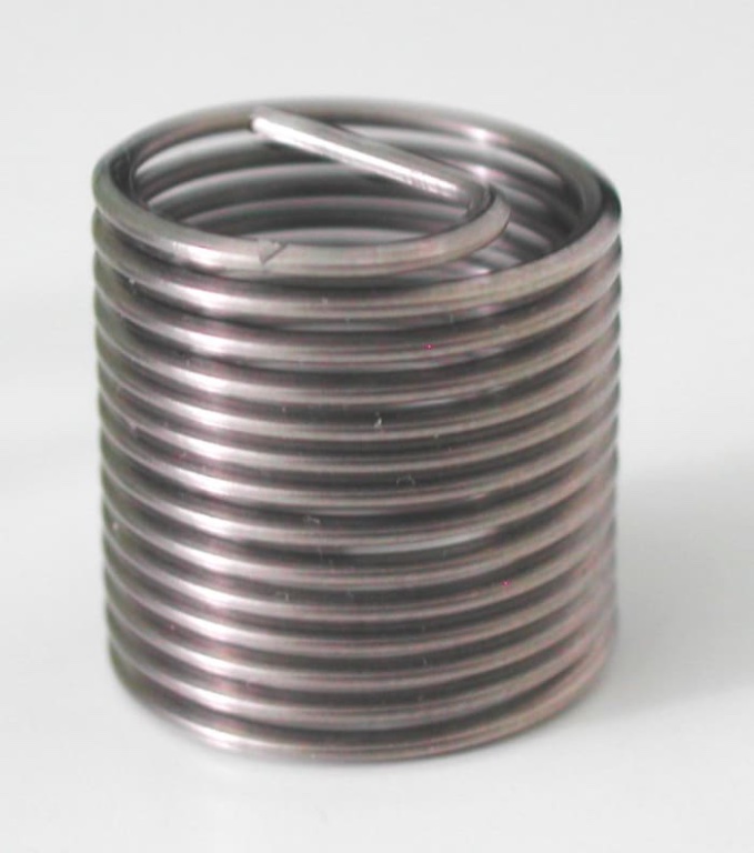

Do not use a drill bit. Use high pressure air then chase the threads with a bottoming tap. Only use a drill bit if the threads are destroyed and must be repaired with a helicoil. Jim Patrick
Here is a helicoil. You will need to drill and tap the hole bigger to accommodate a helicoil the proper size and TPI as the head bolt, you will need a special grooved tool that grabs the wire going through the center, to install it. The wire will break off when the helicoil bottoms out in the hole. In the picture, you can see a groove in the top wire to the left of the center wire where the break occurs.

45-50 is fine. I tighten mine using the Ford head nut wrench. Some day I should check to see what it sets them at. :D

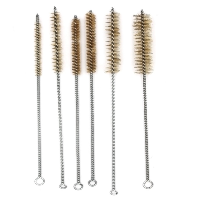

Cleaning out the head bolt holes in a Model T or any older flathead engine is often over looked. It’s nothing new and when not done it can cause a stripped out bolt hole and not getting the head down tight. And when you try to tighten the head bolt thats when it strips out the hole because the bolt bottoms out on the rust and gunk in the bottom of the hole.
Use a ice pick or a piece of stiff wire to break loose the rust and gunk and then use air to blow out the hole. That’s the easiest way to do it. It’s pretty simple to do and if you want use a tap to clean out the threads.
Another good tool to use is a wire brush used for cleaning out gun barrels. That can work also.
The back bolt holes in a T block is kind of hard to get to but using a stiff piece of wire bent at a angle can get the hardened rust out of the bottom of the hole. Just keep working at it and you can clean it out. Good Luck!

For starters, I definitely think that 55 ft pounds is way too much for any T block be it early or late...but I'm not a boo-bird, dozens will tell you no problem, 100's are now heli-coil experts. :) ( I actually start at 35 myself after cleaning and chasing taps and have never gone over about 40 or so by the time I am done and I have a reason...the design and 'load' factor (read Hungarian hunch) for head bolts is based on 3/8-fine. In order to get the 7/16-14 at Rev 2 they had to cut off about 3 active threads, About 1/3 of the active threads on a head-bolt and still darn near bottom out...and were still doing it 15,000,000 copies later)

So the threads on the bolt should be 7/16ths of an inch, 14 turns per inch. So that would be the bottoming tap and thread cleaning tip I should buy.
How should I tap the threads after cleaning the holes (if necessary)? Do I tap them with a ratchet or with a drill? I only have a weak cordless drill or a more powerful cordless impact drill. If I use the impact drill I think that would be a bad idea since it would put repeated shock loads on the tapping bit and potentially crack the brittle hardened steel bit. I take it a regular powerful cord drill would be ideal.
Edit: Seems like there is some sort of T handle tool you use to tap threads by hand with. You tap a few turns then remove the tap and take off the crud and re-oil it. I hope my block threads are alright, maybe I can just run the 7/16ths of and inch 14 turns per inch thread cleaner tool in them to get the remnants of the bolt out. When I take the head off I’ll post some pictures of the bolt holes before and after thorough cleaning before running any hardened steel cleaners or taps into the threads.
