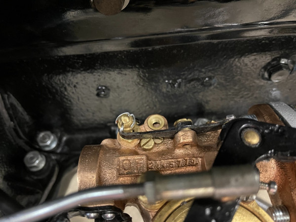

My low speed jet is loose and rattles off set point. I was tired after running new engine in today in the shop. Collar seems to be loose that the jet sets in. I will take it apart tomorrow but figured I would ask tonight. High speed is fine. How is resistance held against the screw?
Thanks guys

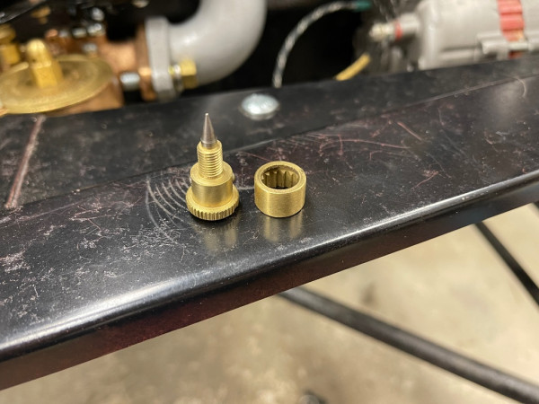

Danny : The collar screws into the body and the jet itself has two spring loaded balls that are forced out into the recessions on the inside of the collar. If the collar is turning just tighten it up. If the tiny balls have seized up or the little spring is broken or rusted, you'll have to replace the spring or free up the balls. Not easy but certainly doable.

The collar is definitely loose. I wasn’t the one manning the carb adjustment as I was watching all other functions. This is a rebuilt engine startup. The fellow making adjustments said the collar wouldn’t tighten. Will it hurt to unscrew jet and pull out or will I loose the balls?

You can back out the jet and inspect it but if the collar won't tighten that's the problem. It's threaded into the brass main body but I've seen a few sheared off at the base probably from someone trying to over tighten it. Most Stromberg collars are the same so you might have to dig out the broken threaded section and replace the whole collar with another used one. I don't have any extras but Stan might. When you get it back together remember the initial setting is around 3/4 turns out from gently seated.

Will take the carb off and do some surgery getting the other end out

I'll try to get you one in the mail tomorrow. You can just unscrew the broken off piece out with an easy out or screwdriver, you can also solder the two pieces back together or send it back to me in pieces and I'll do it. They don't need to be very tight to work.
I wish I could figure an easy way to make some of them and also a less time consuming way to make the knob and threaded part. I routinely replace the balls and spring in the old ones and run a die down the threads but so many OF's are missing the needles ................. I probably have 20 or more cores missing parts. It is also surprising how quickly I run through a $45 stick of brass making knobs. I need a CNC machine or somebody who has one who doesn't have a $2000 minimum.

Danny, Since you don't have to adjust idle after you get it dialed in you could simply attach a wire or other method to prevent it from rotating until you find one of the barrel retainers. I didn't realize those round barrel types are so fragil.

I have plenty other things to do until parts get here. But not long and she will be on the road!SurfCityGene wrote: ↑Fri Apr 16, 2021 1:25 pmDanny, Since you don't have to adjust idle after you get it dialed in you could simply attach a wire or other method to prevent it from rotating until you find one of the barrel retainers. I didn't realize those round barrel types are so fragil.
