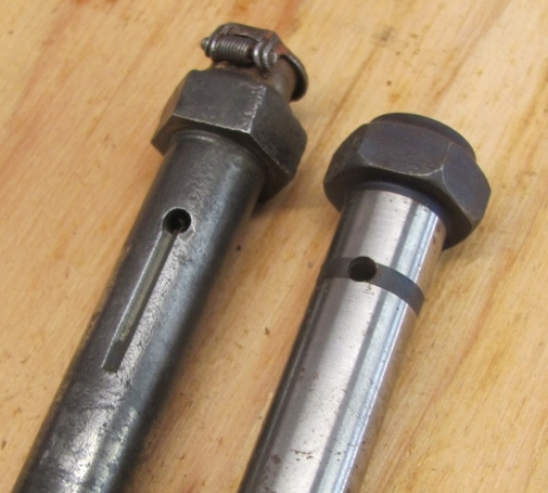

For a time the spindle bolts came with a threaded end and a zerk. I have some spindle bolts drilled for grease fittings half way down the body. This suggests the problem occurred back in the day. Mine have the flip top oiler that was prevalent in the 20s. After coaxing many spindle bolts out of axles I had thought the problem was rust. This experience tells me different.

Original reamers may give too much clearance for modern king pins as most modern king pins are made undersize. The Ford drawing calls out the king pin thickness somewhat greater than a half inch, and most vendor king pins are made a half inch and in some cases less than half inch. Not a problem for the bushings as they can be reamed to any size, but the axles are machined for a larger king pin thickness.
In my king pin drawing research I never ran across a Ford king pin made to take a zerk grease fitting.

Not sure what "time" you are referring to (production or repro's)- but early spindle bolts where threaded for brass oilers. https://mtfca.com/phpBB3/viewtopic.php?t=4474Rich Eagle wrote: ↑Sat Apr 17, 2021 12:59 pmFor a time the spindle bolts came with a threaded end and a zerk. I have some spindle bolts drilled for grease fittings half way down the body. This suggests the problem occurred back in the day. Mine have the flip top oiler that was prevalent in the 20s. After coaxing many spindle bolts out of axles I had thought the problem was rust. This experience tells me different.
by Scott_Conger » Wed Jun 12, 2019 2:56 pm
They are in fact different
'09-'14 screw-in oiler spindle bolts are offered by suppliers for '09-'17. Note: early spindle bolts were a couple thousandths larger than later ones and if you purchase one of the repros that is CORRECTLY made, you will need a slightly larger reamer than the line-reamer the suppliers offer. Mine is .504"
'15-17 man-hole oiler spindle bolts are not available
'18-'27 spindle bolts come with flip top oilers
Zerks/Alemites will fit in those too In looking for info on the Spindle Bolts also found pictures of different designs http://www.mtfca.com/discus/messages/59 ... 1451597403

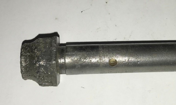

By Dan Treace, North FL on Thursday, December 31, 2015 - 01:08 pm:
Comparison of original Ford (left) and modern avail. repro king pins (spindle bolts). The picture I inserted with the threads was removed from a front axle that was laying in a field a few years ago- (how long was it theer? 50 year old repro?). It has no groove around the oil outlet but one near the top.

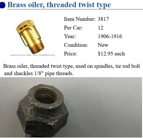

How quick we forget. I have purchased several of the ones you show with the brass twist oilers. My mind went back to what I bought back in the '60s. I still have grease cups in them. They may have been from J. C. Whitney. It seemed the bushings wore quickly in them.

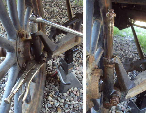

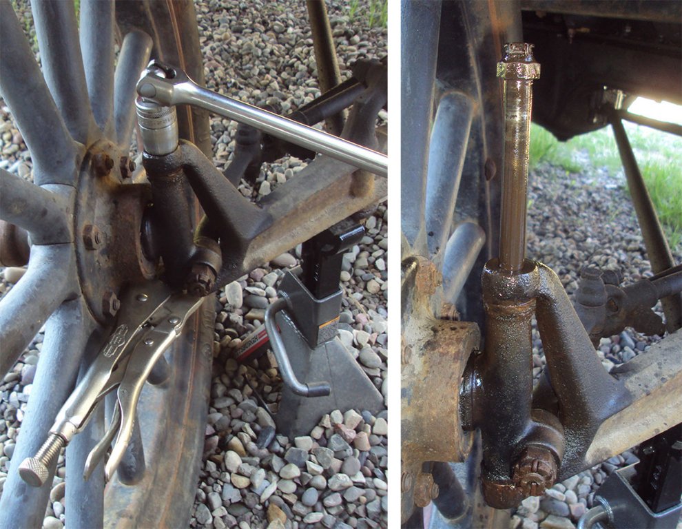

Don't turn the top to loosen it a bit until the bottom nut is partially removed. In case you forgot the end of the bolt is threaded to the bottom part of the axle.Rich Eagle wrote: ↑Sun Apr 18, 2021 1:26 pmHow quick we forget. I have purchased several of the ones you show with the brass twist oilers. My mind went back to what I bought back in the '60s. I still have grease cups in them. They may have been from J. C. Whitney. It seemed the bushings wore quickly in them.
By the way, the spindle bolts now turn about an eighth of a turn after adding the penetrating oil. I'm not sure how long it will take to soak to the bottom bushing. It sure steers easily with the bolts turning in the axle and up on stands.
Thanks for the input.
Topic author - Posts: 6895
Re: Just when you know everything.
Yes, you can see from the top picture the nut is completely off.

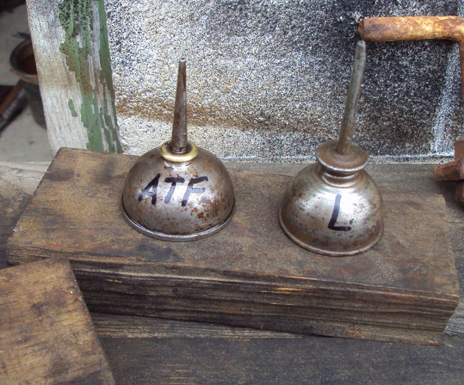

Heat to about 250 F and baste with ATF. Let cool, repeat.
What color is the steel at 250 F?
I found two of those cutesy little oil cans that we just have to pick up and the swap meet and put lacquer thinner in one and ATF in the other. I have been filling the oilers each day as they will take it. Today I can turn one spindle bolt a full turn and the other about a half turn. This gives me hope that eventually oil will get to the bottom bushing. Maybe I can lock it in place with the vice grips. They say that Patience is a virtue but distraction is working better for me.

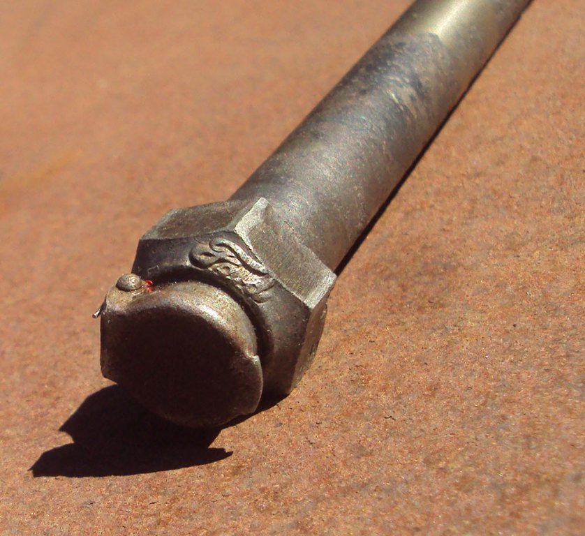

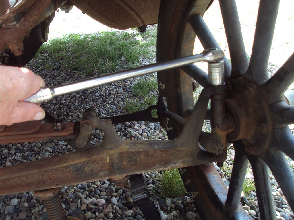

Today with the help of vice grips (one side) locking the lower bushing I was able to turn and remove both spindle bolts. Soaking for 12 days did the trick. Good threads at the bottom let the bolts move up as they were turned.

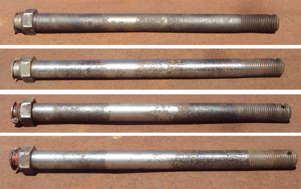

I see that the bolts were old originals when I installed them 8 years ago. One is Ford script. They measure .499 and .498 half way down and .497 to .491 where the bushings ride. Pretty good for used bolts.
They are shown here before and after cleaning. There was a dark brown tar on them. I suspect old oil and rust from water soaking in and condensing inside the spindle body. More frequent oiling should have eliminated this problem. Being kept outdoors also contributed.
The spindle bodies didn't want to come out of the axle. The bushing flanges were tight. I scrubbed them with solvent in place. They didn't seem to wear much during regular in town driving.
They have plenty of oil now and I will try to remember to oil them more frequently.
