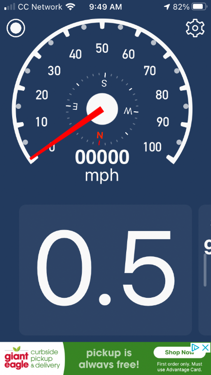

Re: Need help, fuel loss.
I use an app called “speedometer simple by Tevfik Yucek”. GOS speed, average speed, miles per trip, nice big analog gauge and a digital gauge. Also a compass.
And I generally get 20mpg or better with a 3:1 Ruckstel, Stromberg OF, HC head, aluminum pistons and oversized valves....on regular BP gasoline.
My Stewart speedo is in Russian Versts, so I marked it according to the GPS...55 Versts is 40mph.
