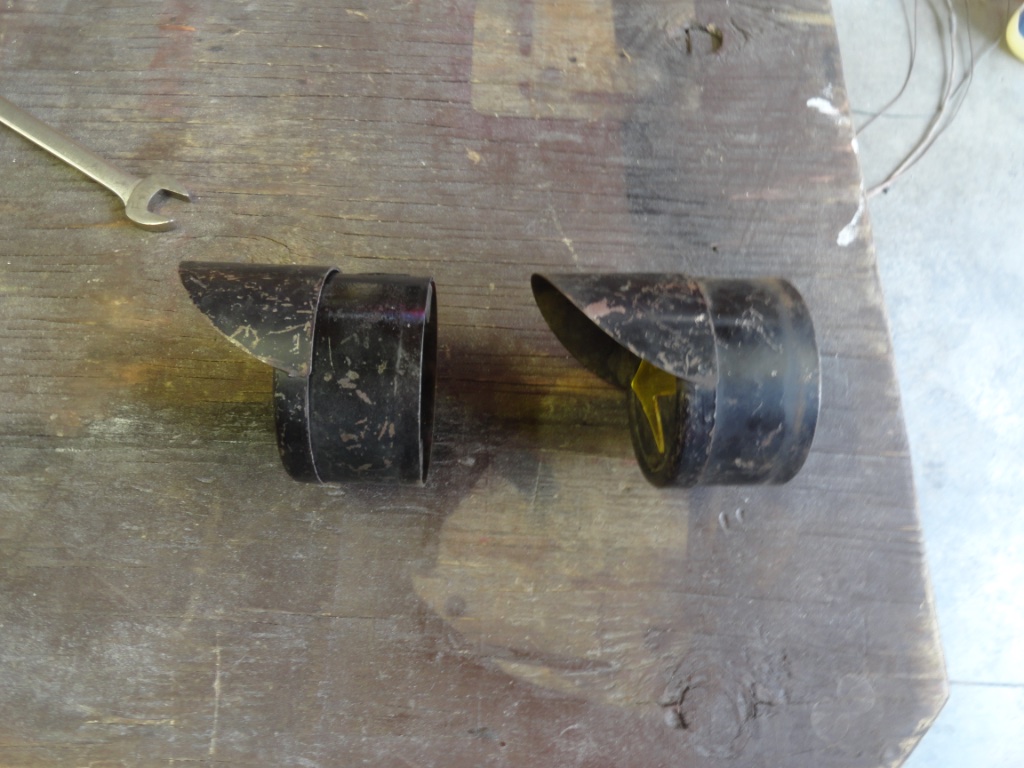

I went to great lengths to NOT have a modern turn signal set up on my
truck, buying period arrow lights off eBay and fabricating a lever on the
column that looks like a 1/3 size version of the throttle and spark levers.
I then ordered some LED diodes, so small you can hardly see them until
they light up, and placed them on a flat black piece of material that just
barely hangs down below the dash on the left side. Wired in series, two
colors tell me which blinker is firing at a glance, so I don't go driving around
with a blinker on. No sound, no one would ever notice them unless in the driver's
seat as they are blinking, and the actual lights themselves are appropriate
size and show arrows when flashing, AND they are period correct and not
some obnoxious modern plastic LED's for a home made trailer or similar.
I also added a period "STOP" light that fires when the brakes are applied.
