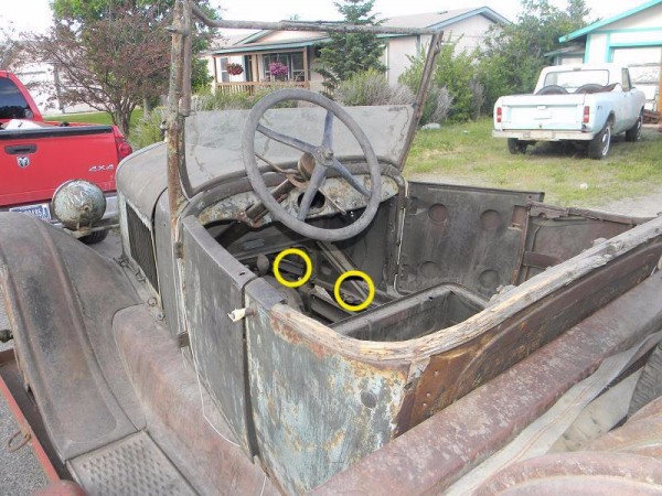

Been a while since I had my ‘27 roadster... but seems to me that mounting bracket circled in the pic above simply supports the hood sill plate and/or hood latch...?
As for the coil box... yur going to have a he// of a time fitting it and the fuel tank under there

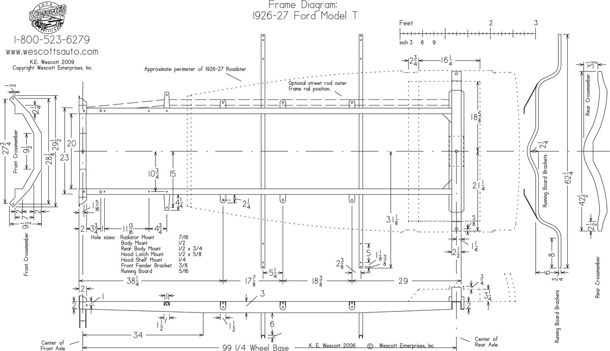

- Posts: 4084
Re: Speedster: '26-'27 cowl on pre-20's frame
Tom

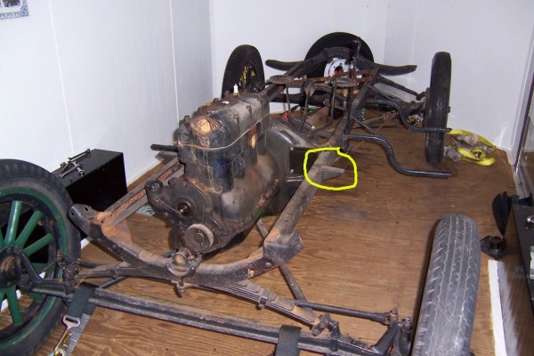

Another photo to show the frame mounts on the '26-'27 frame, as noted the 'wider' mount up front is for the hood clasp as the Improved Car has a bigger hood, and those mounts are needed for the hood shelf so that the wider hood will mate with the cowl. You'll need those wide mounts if running a stock hood.
The other mounts are std. body mounts, but not real sure if the locations are the same on earlier frames.
The late 5:1 steering gears work well with balloon tires, and if you get the whole column that will come with the 'slot' and longer pinion that prevents turning the wheels fully as they can lock, this change in the steering case was done about 1920 or so.

So let's take these copies of your pics:

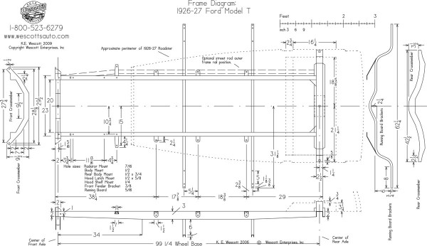

When you say "the 'wider' mount up front is for the hood clasp", I assume you are referring to the "circled green" in the car photo, not the diagram?
The "circled green" in the diagram is for mounting the front of the front fenders?
Then you say "those mounts are needed for the hood shelf so that the wider hood will mate with the cowl". You mean the rear of the hood, correct?

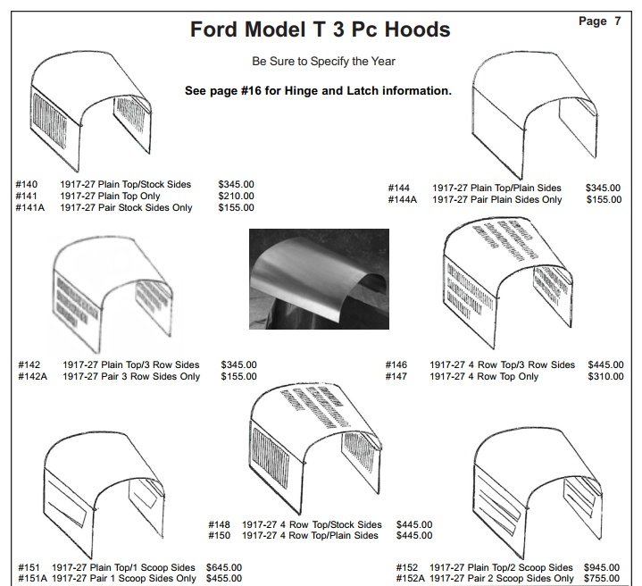

So if I have this right, the "improved" cowl where it mates up to the hood is still wider at that point than the '24-'25? But the radiators for the '24-'27 are all the same width?
If that is so, why does Rootlieb.com's catalog show all the same size hoods for '17-'27?: Tom
Fabulous pics!!

Tom, the wider brackets at the front frame crossmember that you marked in green are for the 26-27 front fender brace. The 26-27 radiator width is the same as earlier radiators. The 26-27 firewall/cowel is wider than earlier t's so the 26-27 hood is different from the earlier ones. The Rootlib catalog page you posted are hot rod 3 piece hoods, not stock 4 piece hoods. The earlier hood will not for the 26-27 body. You are over thinking this and have received some conflicting advice.
- Posts: 4084
As Jeff posted you won't need the front bracket unless you put on 26-27 front fenders.

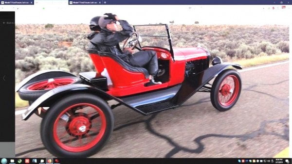

Assume you are trying to build this one:
The owner used the Improved Open car body cowl, and likely has coil box on motor as there is no gas tank on the rear so this one uses the cowl tank. If you are going to put a gas tank on the rear, elevate it for gravity feed. Motor mount coil box is best design with sealed lid, or if using other than Ford ignition, that's left off anyway
Fenders are Rootleib speedster mounted directly to the frame rail. No hood shelves needed as no hood sides. The hood is two piece hinged upper original Ford, high radiator needed to match hood contour to the cowl/firewall.

Tom, looking at the chassis dimensions in the ford service bulletins, the body mounting brackets on the frame are in different locations for the 26-27 model t, so it will not be a simple bolt on modification to put a 26-27 cowl on a pre 1926 frame.

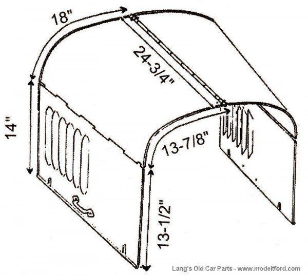

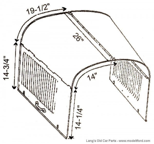

And below are from Lang's showing the dimensions on the 1924-25 car hood verses the 1926-27 car hood. (Note Lang's uses 1923-1925 -- but the early 1923 cars actually used the same size hood as the 1917-early 1923 cars. The handles were no longer riveted to the hood starting in 1920 but instead were fastened to the hood without a separate rivet -- causing a "hole: to appear where the rivet was on the earlier hoods. (Ref: page 235 of Bruce McCalley's book "Model T Ford.") Note Lang's also sells just the one-piece top hoods for speedsters.
Their part number for the 1924-25 car hood NO114
For the the 1926-27 car hood NO116
For the 1924-25 one piece top NO141-23-25

Rather than just guessing and possibly giving Tom the wrong answer, I thought I would add his question here. In an e-mail he asked, " ...about the front (radiator side) measurements for
those 2 hoods. Why is the radiator side on the '24-'25 13 1/2" vs the
'26-'27 14 1/4" when both can use the same radiator?"
Note he is asking about the front of the hood which is 3/4 inches longer on the side panel than the 1924-25 hood. And the top front of the hood is also 1/8 inches longer. [Side note the rear panel edge is also 3/4 inch longer -- but that one should be due to the larger cowl on the 1926-27 cars].
Reposted from above -- from Lang's catalog:
Tom correctly points out the the 1924-1927 cars use the same radiator. And the nickle radiator shell is listed in the Price List of Parts from 1925-1927 as the same part number.
So far the only item I have found that is listed differently is the stud that the radiator mounts to. A scan from Bruce's Comprehensive Encyclopedia is shown below. For any commercial use -- please contact Barbara McCalley or to order a copy of the excellent 2 CD disc material see the posting at: http://www.mtfca.com/discus/messages/822076/844722.html
You can see that the 1926-27 stud has a different part number 3929B2 and Factory Number (Drawing number) 1162C than the 1920-1925 stud which has part number 3929B and Factory Number 1162B.
Unfortunately the length of the stud is NOT listed. However in Lang's Old Car Parts 2019 catalog they have the illustration shown below:
"IF" the photo shows the two studs at the approximate scale, then perhaps that extra length on the hood is due in part to the extra height the radiator is mounted?
But I don't have an "Improved Car" to check out that theory/guess. So if someone who has both a 1924-25 and a 1926-27 could check why the hood panel is 3/4 inch longer in the front that would be greatly appreciated. Or if someone knows the answer and doesn't have one of those cars to compare -- that would be great also.
Note -- "IF" it is the radiator studs that cause all or most of that 3/4 difference -- then using the 1920-25 studs to mount a radiator on a 1926-27 car may throw the hood alignment off. Again -- this would be another time when using the parts from the same year range usually makes assembling the car easier.
Respectfully submitted,
Hap l9l5 cut off
Hap l9l5 cut off
Hap l9l5 cut off
Hap l9l5 cut off
Kevin Pharis
- Posts: 1656
- First Name: Kevin
- Last Name: Pharis
- Location: Sacramento CA
My rememberer is telling me...
The frame rails on the 26-27 are thicker gage, and the front crossmember may be attached differently, other than that... I don’t see any reason for the longer radiator mounting hardware. The only additional part in 26, is the lower radiator apron.
The dimensions along the front edge of the hood are different due to the 26-27 radiator shell being tapered outward to better align with the hood shape. The 25 and earlier radiator shell sides are perpendicular to the front face. Same radiator, with the addition of the upper extensions to hold the upper mounting screws. Approximately 3/8” wider per side

Thought I should chime in here. The fenders, aprons and boards are 10-11 torpedo. Your 15 frame is perfect for this project for the following reasons. The front crossmember does not need to have the ears trimmed, as well as already having the 3 holes in place for the front fender iron to bolt to the side of the frame. The torpedo fender requires the forged type fender iron, not the pressed steel 26-27 type. The running board brackets on a 26-27 frame all need to be relocated to work with earlier fender patterns. Your 15 frame only requires the rear r/b bracket be moved ahead till the brackets are 17 3/8” center to center. We have rear double arm fender irons (butterfly irons) that mount into the later style crossmember (either stock or dropped) to complete the mounting proscess of torpedo fenders to a mid year frame. My suggestion to set things up would be to set the frame up on horses and mount your radiator and shell. Then fit the front fenders, as the fender flange needs to be behind the radiator and following the inside edge of the frame going back. Then you can trial fit the 27 cowl and see where it locates and what needs to be done to mount it. If you work from front to back it seems to work better getting things to fit. Any questions let me know. Good luck.
