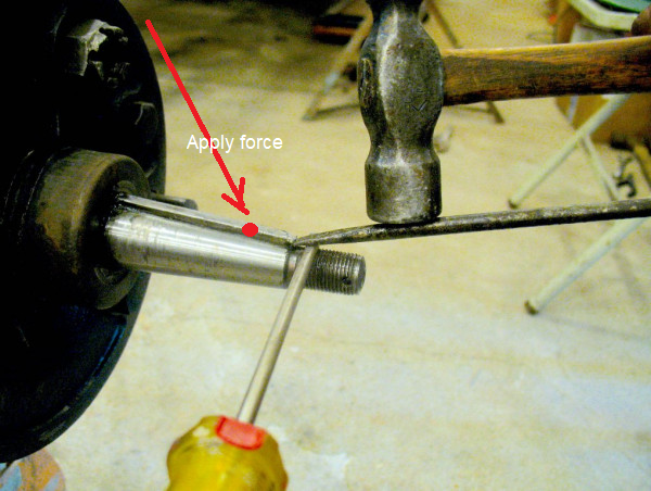

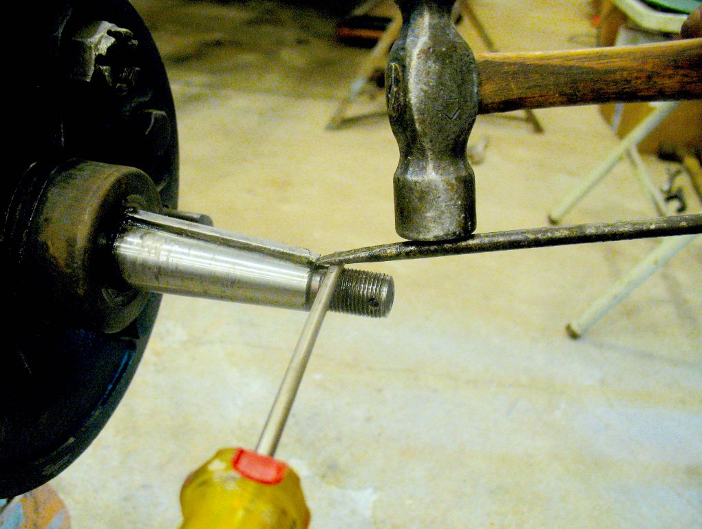

Key stuck: How to get it out?
Pound a screwdriver under it and pry? Nope. No go. Clamp on Visegrips to whack with a hammer. Failure. Cut a slot in the end and try to pry it as the photo shows? It's going nowhere. Turn it red and let it cool? I'm afraid that would ruin the axle shaft. Any suggestions?

- Posts: 6590
Re: Key stuck: How to get it out?
How a bout drilling a hole or making a notch in the key an applying force outward

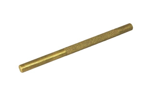

Quickm007
- Posts: 1202
- First Name: Mario
- Last Name: Brossard
Steve I have the same issue tonight and I used a little brass punch and work really well without any damage. I just hammer the key with the small Brass drift punch and the key fall down without any damage. Hope that help.

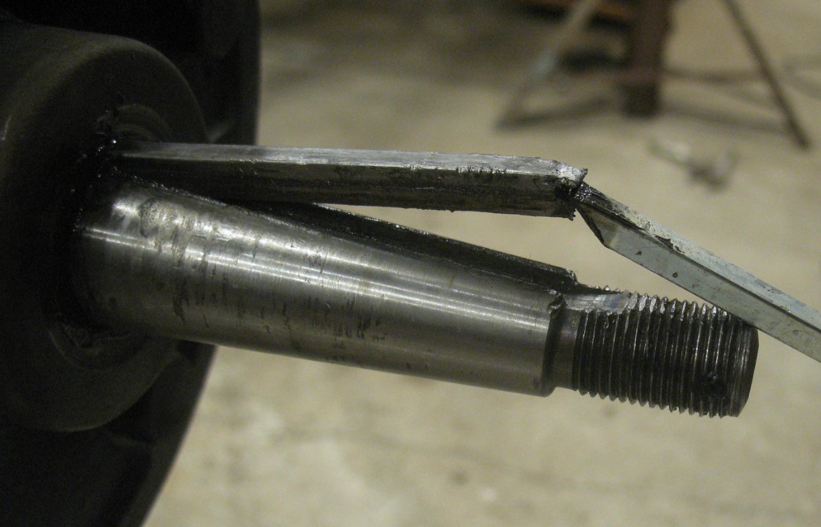

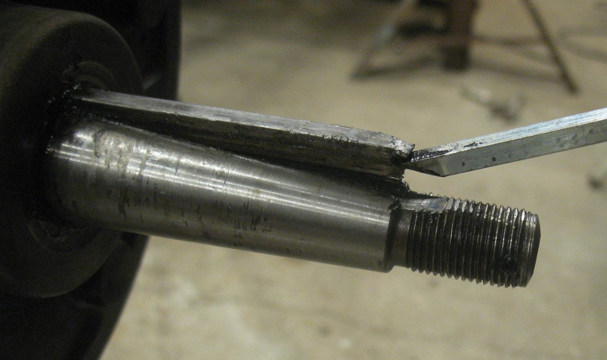

Topic author - Posts: 7411
Thanks to all for the suggestions. I started with the one that seemed simplest and I didn't need to go much further.
I sharpened a piece of 3/16" key stock and tried driving it underneath. That didn't work any better than when I tried it with a screwdriver. So I stuck the point in that slot I had cut in the end of the key and whacked down on the stock behind the angle with a BFH. That pried the key up and the rest was easy.
