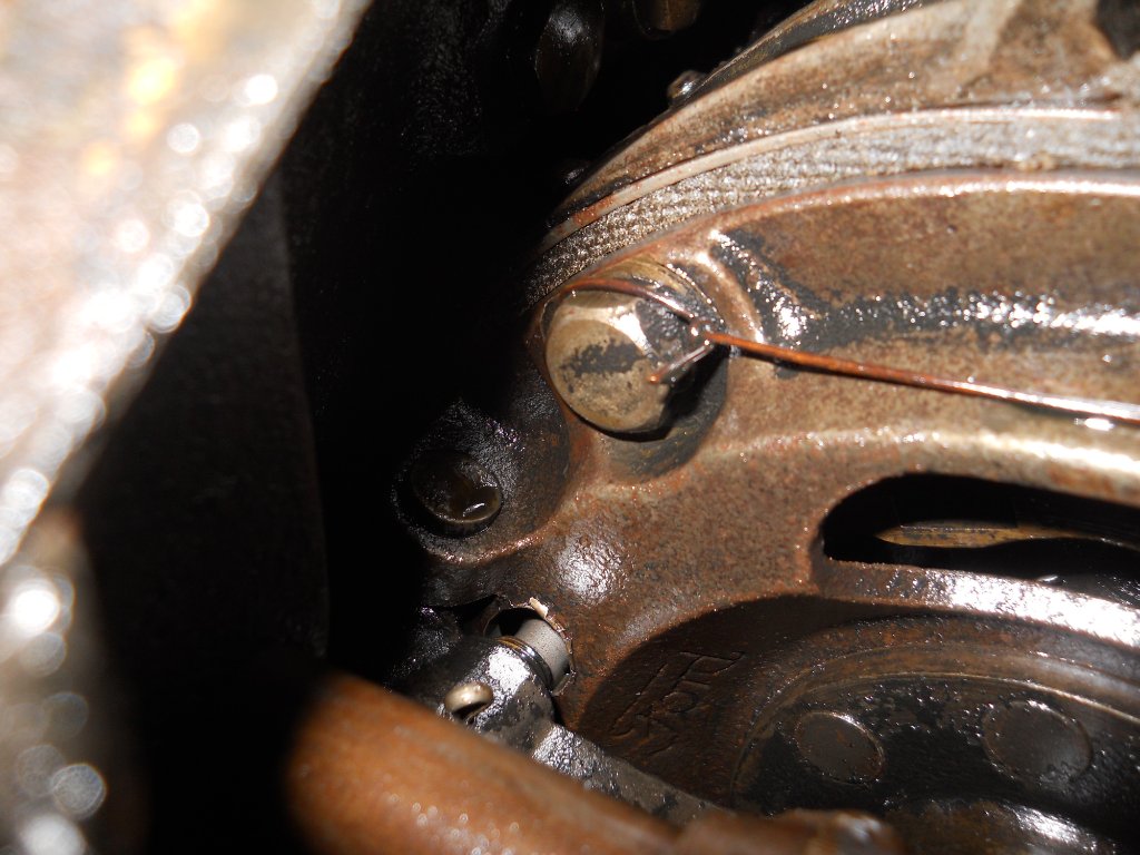

:cry: This is really not what I wanted to see! When backing up I had been having a real clunk coming from the transmission U-joint area. I was thinking maybe it was babbitt thrust bearings still and sound was being transmitted up the driveshaft or worn U-joint, so I started putting together another rear end as a replacement while I rebuilt the one that was in the car. Doing a little investigation work to check the transmission I found this;
The hole where the clutch pin comes thru is really worn and the adjuster in the finger is only riding ether all or less then 1/2 of it depending on direction the transmission is turning. This is something that really don't need right now, because I know when I pull the engine it's going to need a lot more then the drive plate replaced. It's a tired engine, but runs pretty good. While it does run on magneto, am pretty sure the wrapping are coming off the coils without having to see it and am afraid to see the mains. The amount I will be driving it, guess I might just have to bandaid till things get better. ;)

Mark, if you find an earlier three pin ring they are larger, may have been what was suppose to be in there instead of 25 and up pins, I see this all the time. Model T's are all the same through the years RIGHT?

If you are going to change out the rear axle you could fix the bad transmission output shaft driven plate at the same time. Frist get a good output shaft driven plate with good clutch spring and clutch fingers, etc. You could reuse your old spring and stuff if good. Also get a ball cap that matches the new output shaft diameter. You will have to pull the hogshead so you may want to get new bands also. Drain the oil and pull hogshead, being careful about dropping anything, remove the ball cap and driven plate with spring. Replace with new driven
plate, spring, and new ball cap. Make sure the clutch ring pins are good and go threw the driven plate holes, safety wire bolts. Install bands, hogshead and oil, check over everything. Install the rear axle with wheels, and adjust for free netual hand brake if needed and you are back on the road.

Matt; Are you saying you can remove the drive plate with the engine & pan still together?? Correct me if i am wrong, but i believe you would need to lift the engine off the pan some also. There isnt enough room to clear the output shaft otherwise.

Pretty sure that yes, you would have to lift the back of the engine up to clear along with now having to replace the pan gaskets and front seal. Not something I want to do while engine is still in the car. Even if I did not do any more work then replace the drive plate, check the thrust on the 3rd and maybe the 4th main, could at least see what things look like and start a list for later.

You may be correct Mark and in that case it is, pull engine. I had narrow brake drum transmission and a 4 dip pan and had the clutch pins stuck on the inside, not going threw drive plate. Don't know how that happened the clutch instslled highth was correct at assembly. Was able to loosen drive plate and rotate clutch ring to realign pins with holes. I thought it would tip enought to clear. In that case it worked because I only had to reach the clutch ring.

You need a egg shaped bushing to fit the wallered out hole.

LOL Or weld up the pins to fit the holes! As it is, I am going to make one out of two assembles.

I wonder why one couldnt make some sleeves to press fit over those late smaller diameter pins to keep the pins centered in the larger holes. No disassembly required. A patch fix to get thru this touring season.

Once everything gets settled I am going to send an output shaft to Gene so it can be cleaned up and 4th main fitted. I will reassemble the output shaft to a good drive plate when I get it back.
