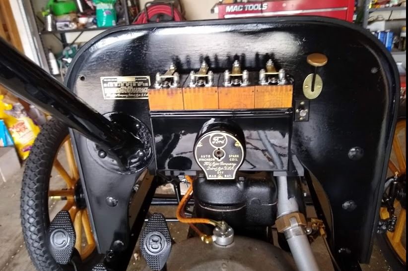

I got a 15 firewall from Snyders in early 2019 when I was restoring our 15 runabout. I was very happy with the quality and fit. I did have to sand a slight taper on the edge to fit more easily into the cowl piece, but that wasn't a big deal.Erik Johnson wrote: ↑Fri May 14, 2021 10:26 amLang's and the other vendors do sell wooden firewalls but they are not correct as I posted above. They work, but they are not correct.

Re: Firewall drawings/ schematic 1915
I don't believe you need to modify the firewall for a starter. I put a starter engine in my `15 T. Original firewall. Didn't need to modify anything. Engine also had `26/`27 pedals. It fits! I would have never thought so either!Hardie wrote: ↑Fri May 14, 2021 7:16 amGreetings from Canada. Wishing everyone good health and safety in these interesting times as our early "T's" are make their way through their second world-wide pandemic.
