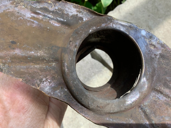

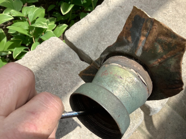

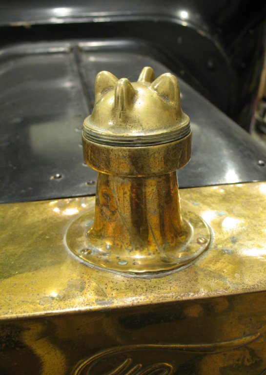

If you are losing radiator necks because of ornaments, you need to find some better roads to drive on. I cannot comprehend a neck loosening up from that. A neck, at the minimum , should have a rolled edge on the bottom, to trap the top tank metal before soldering. Perhaps someone is skipping that easy step? Originals were done several ways but always had a rolled seam, not just set in place and soldered.
Plus rivets for several years.

Re: Berg's Radiator Neck
The early ones were riveted instead of rolled! I salvage a lot of necks to display ornaments on, and just did one yesterday. If the necks aren’t rolled into the top metal, OR the top metal isn’t rolled into the cap, they aren’t going to hold up. I’ve seen them both ways, I’ve also seen aftermarket rads also riveted, and rivets hidden under the steel shell.
This one has the top panel rolled into the neck, THEN soldered.
Tim, I’d think about taking it all the way off and then rolling the seam before soldering. It’s doable.
